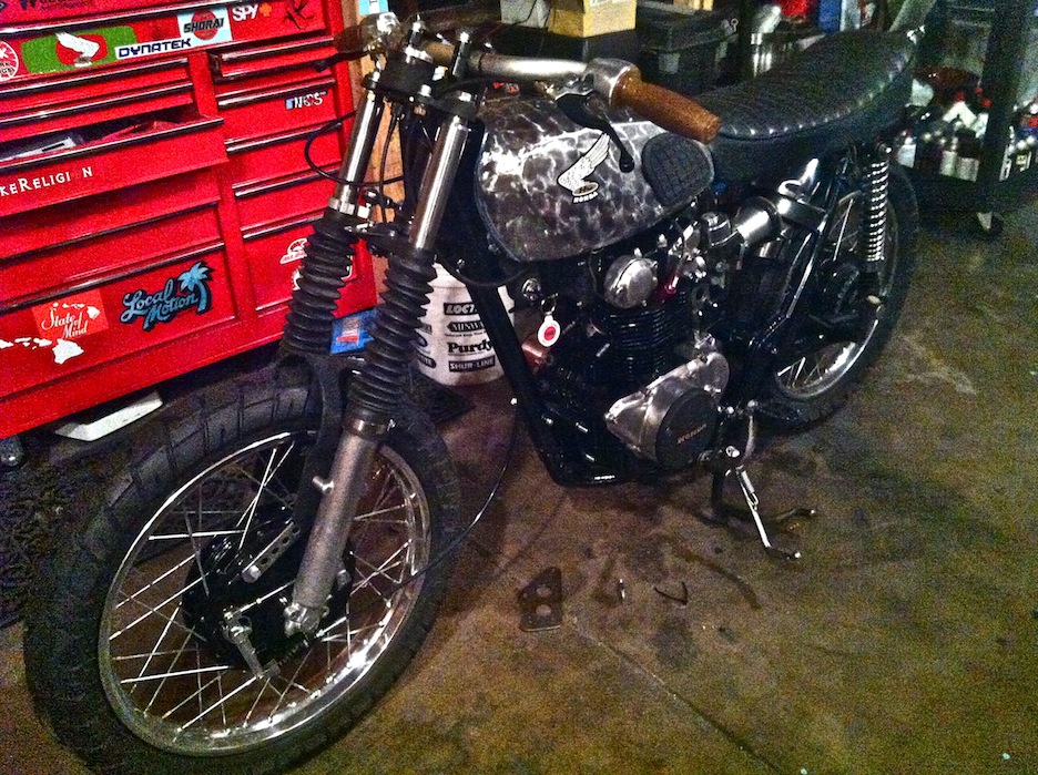

so, after hours of trying to learn wtf i am doing, and much frustration, sweat, tears and blood...things all paid off. Ran a compression test after buttoning her up last night and both cyls came to a nice 148psi...pretty content as it doesn't get much better than that. Now that i put things together tho, i have decided to pull some cosmetic changes as i am not liking the overall look of the bike. thinking of ditching the gold and going with an all silver/black/white and brown combo, the emphasis being on the silver, which will be bare metal. anyway, here's how she sits this morning, still haven't put the pipe's on, that might wait till after my mini-vacation... also going to ditch the headlight, run a smaller bottom mount headlight so it cleans up the top of the forks...then reposition the top signals to some p-clamps.
Cheers,
H

Re: 1970 Honda CL450 (project kickass)
one of my fav builds. what is the yellow stripe on the headlight again?
nice work dude, one can tell youre an artist by your builds. ;D
I agree with the smaller headlight suggestion, but I dig the knee pads...

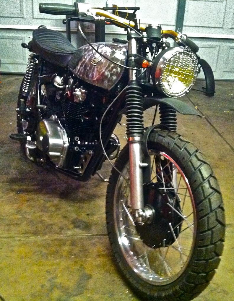

Well after i got the engine put back together and working with some good compression numbers, i decided i wanted to completely change the cosmetics of the bike, so i'm in the process of doing so. Removed a shitload of paint, got some nice POSH carmel grips...which i love...going to shorten the seat and reupholster it to brown leather...then find a front fender that is nice and shiny and crop it to about a foot or so long for the front (if anyone has one that will work, let me know). All in all, i'm happy with how things are shaping up.
I have to say " Man Thats looking Good " Henry . Nice work on the bars and are you looking for a fender to paint or want one thats chrome and nice ?
Thanks Scott, and i'm lookin' for a shiny chrome fender...something real smooth and clean.
