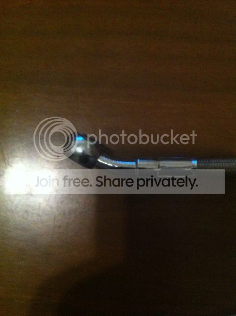

I want to use these gaiter clamps to secure the lower lip of the gaiter and locate the brake line. I had to take pliers and open the cable loop to install the brake line in it. As soon as I started to bend it it chipped all the chrome plating off it. So I will probably strip them and powder coat them black and buy a couple more brake lines that are a bit longer and then cut off the ends, feed the hose through the clip loops and then install my own reusable banjo ends in the correct position. Part of the wrong brake line issue is mine as these lines are suppose to have the ends the same on both ends, but mine need to be opposed by 90°.
When I received the lines I was impressed with their quality for inexpensive ($5.99 shipped) Chinese brake lines. They are DOT approved and sheathed in clear plastic.Unfortunately they didn't pay attention during assembly and one of the ends is clocked 45° from the other end and the line can't be twisted to mount it.
When one end is in this position.
The other end is in this position.
Actually, as mentioned above, they need to be clocked 90° from each other for my application. So I will need to cut one end off each line and replace the end with a $15 fitting on my $6 line.

One step forward and two steps back, or so I thought. I take the new brake line fitting and go to install it. I cut off the banjo fitting on the new hose and, WTF is this? I've never seen a teflon hose lined with another metal lining. I'm now thinking I just wasted a hose that I can no longer use and will need to order some -3 line and another fitting to just make a new hose.
Put this one aside for a few and go to install the new shorter rocker box inspection caps, they are still too tall to clear the carb. So I will look for a pair of carb spacers. I then go back to the brake hose brake line and grab a pick and see what's up with that lining. As I pry on it the end of it pops out, leaving a standard looking teflon lined braided line.
Apparently I cut the old fitting off so close to the base that I actually cut off the tip of the steel tube that goes inside the teflon hose and was now able to complete the install of the new fitting. Move 2 sets forward again.
