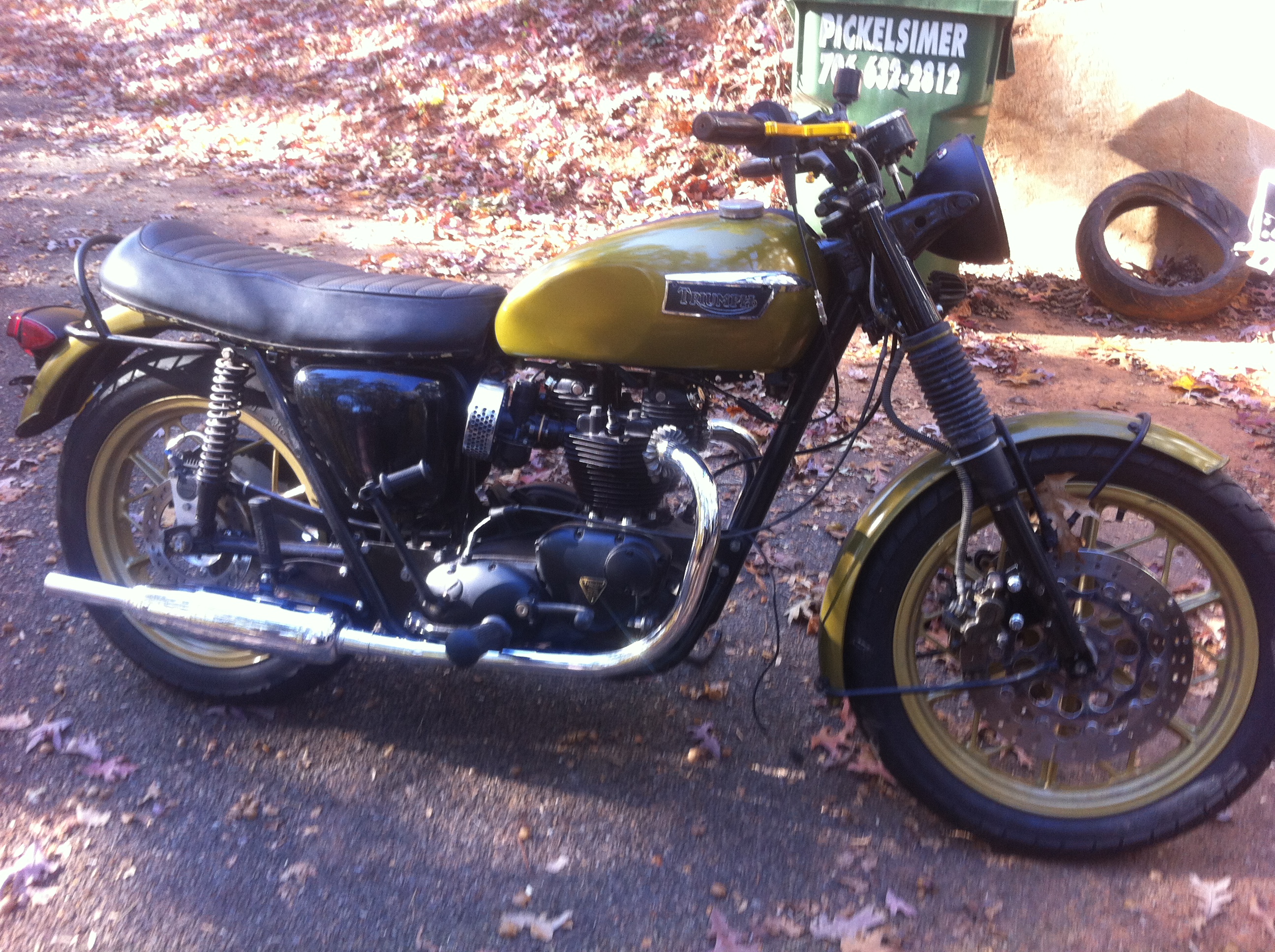

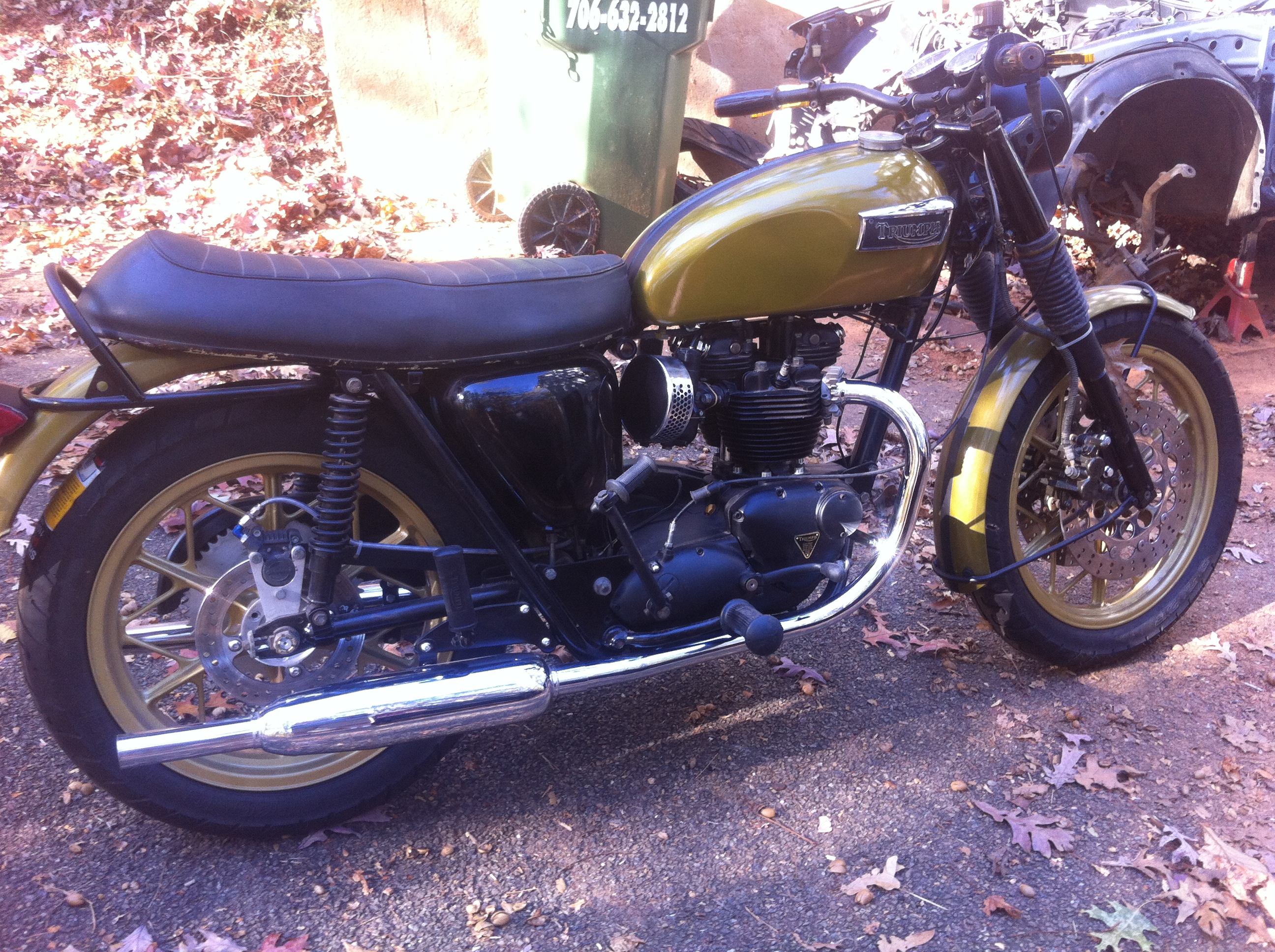

Right after my last post I moved my powder coating operation to Ocala, Fla. for 5 months. Big mistake, after aggressively pounding that territory with advertising and hitting every car show, cruise in, bike shows, etc. of which there are many, after 5 months I had averaged $169/month. Couldn't even cover the expense of letting my Ga. house sit empty. Never got to a point where I could consider renting a home down there. During my last month there my Dad passed away at the same time Mom was diagnosed with pancreatic cancer and hasn't been given much time past Christmas. After coming back home I am literally starting over here at home with my PC operation. So I basically blew the whole year. I've added a spray chrome process to my line. Anyways it's time to get back to finishing the build. Here is where it currently stands and just needs the last 100 little tidbits done to complete the build. Should have it ready for spring riding.

Looks great man... my Bonnie is a blast to ride.... spring can't come quick enough.
