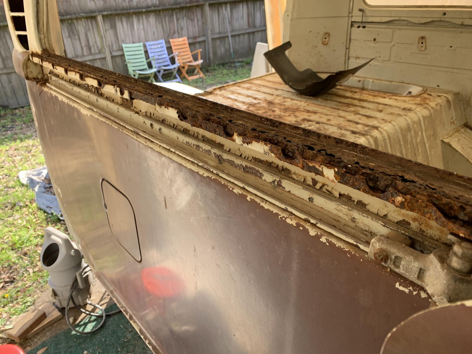

Managed to get the interior cleaned up, the rest of the Westfalia bolt on stuff removed and the slider cover/drivers side cover removed. Those covers gave me a fit, especially the slider cover as the darn retaining strip was rusted so badly it was basically fused to the window sill. The other side is pretty rough as well but definitely better than the passenger side.
I think I am going to have to drill out the spot welds and remove the retaining strip in order to fully repair the sills. Its roached pretty badly Has anyone done this before and have any pics to share?

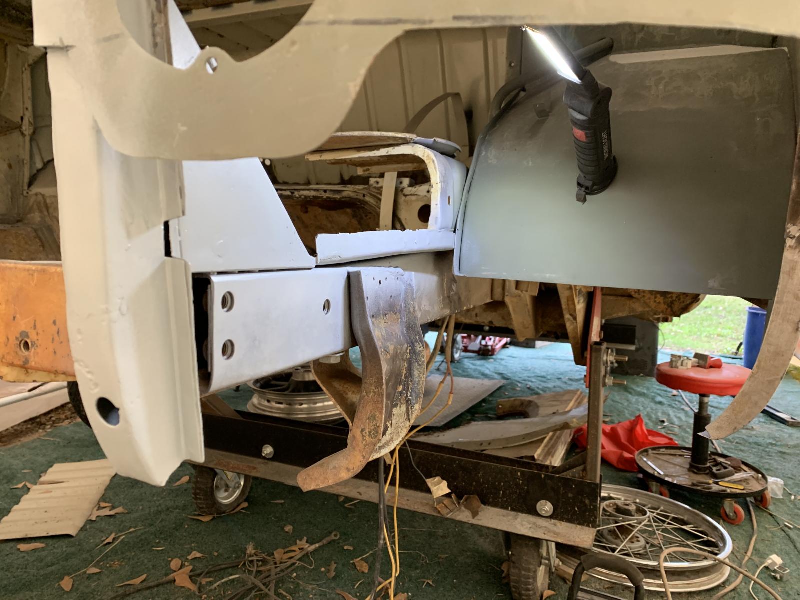

Still chipping away at the passenger side rear corner. I was going to leave it, but the inner wheel well panel was a bit rusty and mangled at the end where the wheel well attaches to it. So I cut that bit out and fabricated a small piece to replace it. If anyone sees this and needs to do the same, they plug weld the absolute crap out of this portion of the inner wheel well to the air cleaner stand. I'm talking like a 3/4" diameter weld. It was an absolute pain to get out.

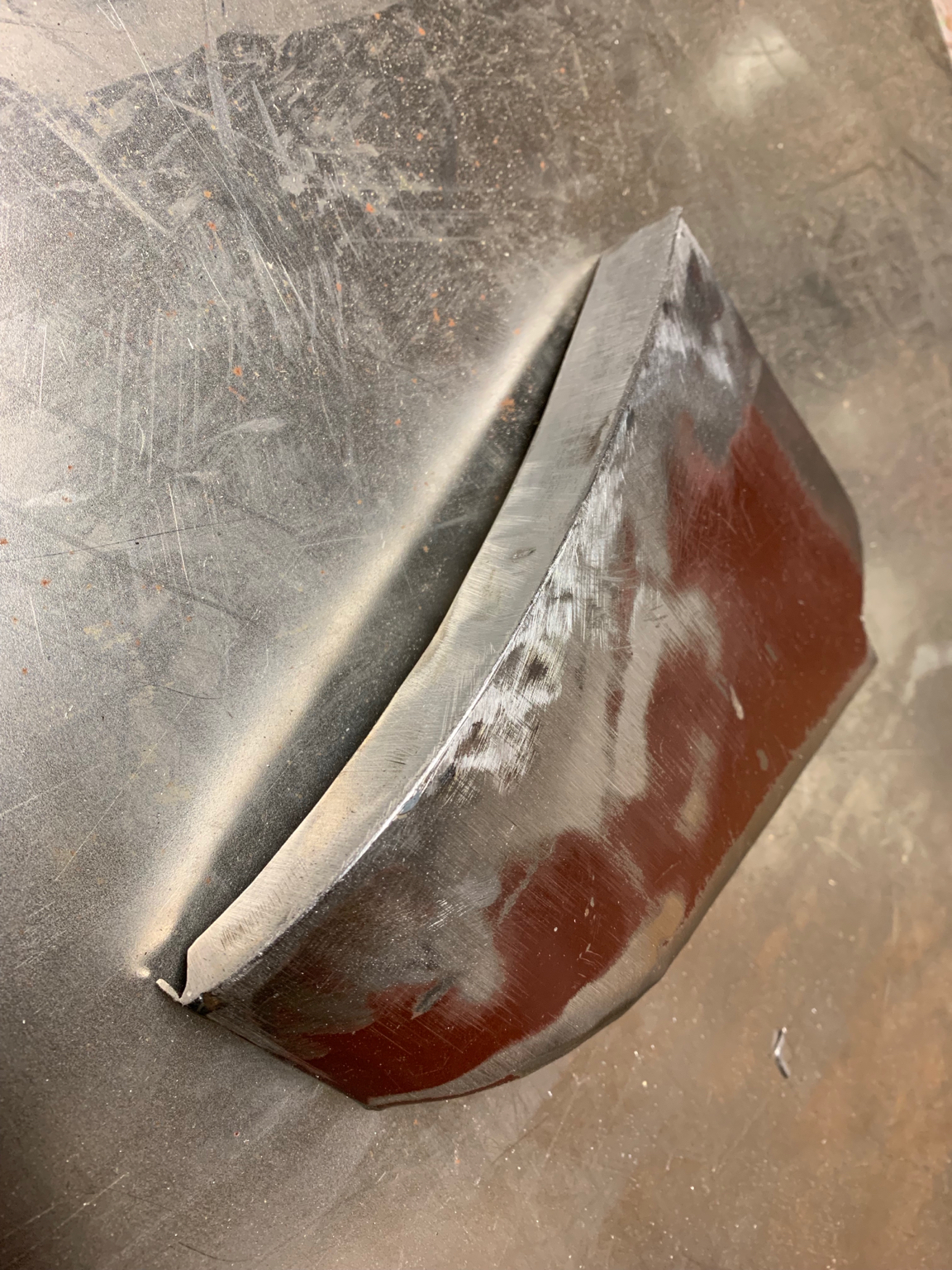

Sunday I made a repair section for the "D" pillar ( I should clarify I have no idea if this is what its actually called but I'm going with it). I dont have the tooling to stamp the raised section into my piece, so I left it out. I think its only purpose is to help with alignment when they were fitting the panels at the factory, so I didn't see the need to build a stamping die for it. Came out pretty well once its been ground down but I think I needed some more heat on this particular area. Just have a few pinholes to touch up and I'll be ready for the corner.

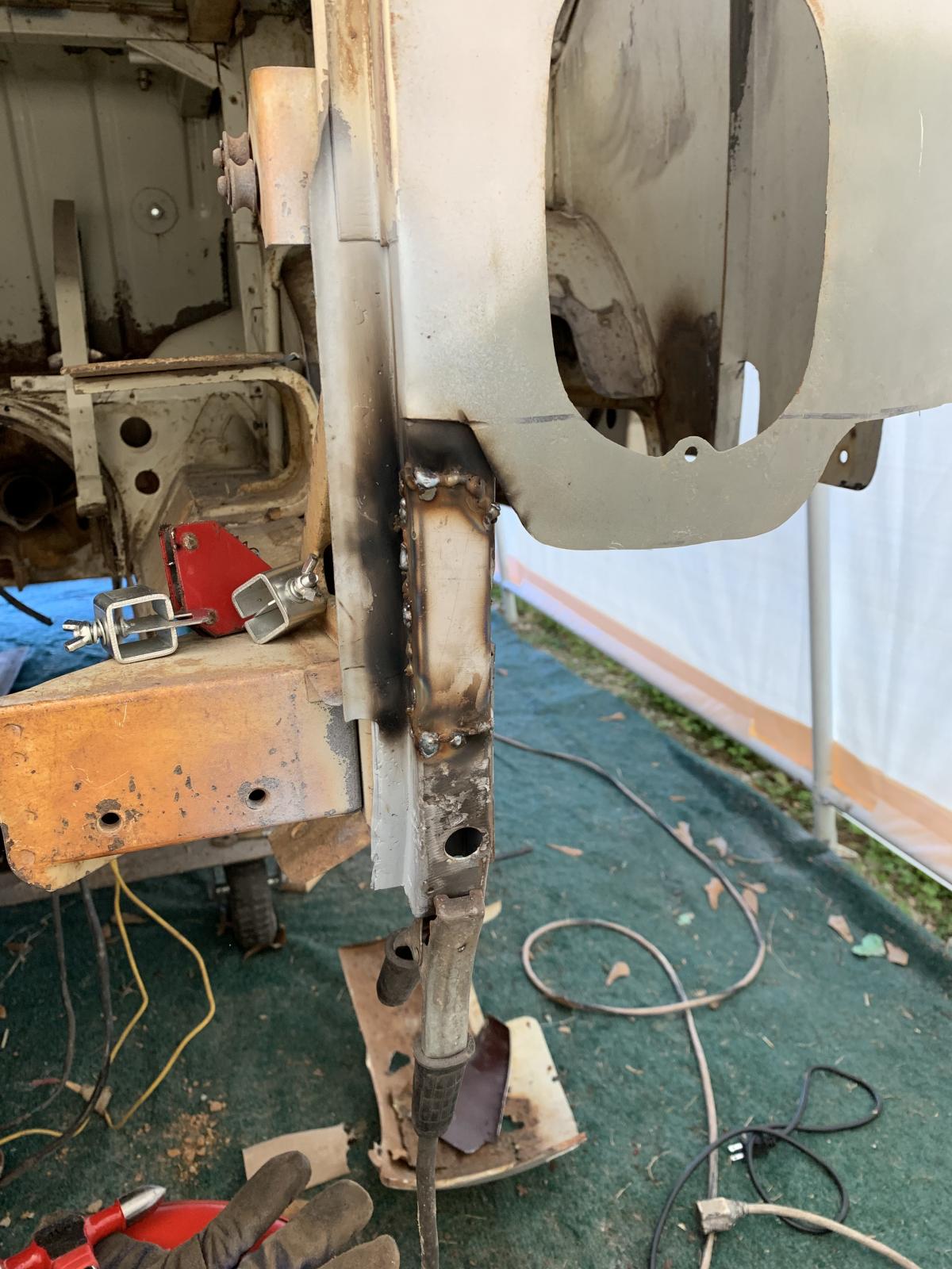

Last night I cleaned up the ugly welds on that D pillar repair and filled in any spots I missed. Some of these repairs are pretty challenging to get good welds on in situ. No pics on that yet.

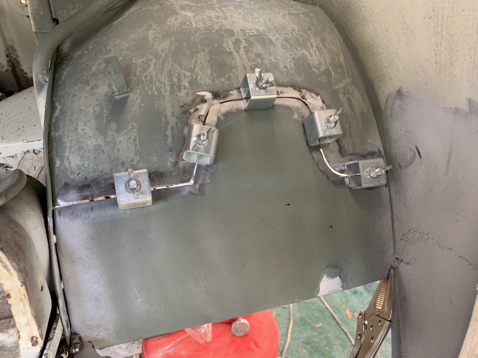

More time into these crappy repair panels. The rear wheel arch repair section had the wrong profile and a 3/8” too short flange for the seam when it came. I’ve already got a few hours into adjusting the wheel arch return, and I tried to weld a thin strip into the inner flange. Well I put too much heat into it and it turned into a mess, and then I discovered that the profile wasn’t exactly right.
So I cut off the botched flange altogether and hammered the profile to match the new rear quarter. Cut a couple of strips out of 20ga and welded them onto the corners. Much cleaner and should make welding the seam go a lot smoother. That notch at the bottom is actually how it looks from the factory, not crappy fitment

The past couple weeks have been a lot of prep, welding and grinding. I finally got the rear wheel arch repair section as close as possible to the correct profile. Got it welded in and ground down, I'm pretty happy with the way it came out but the profile of the lower curve on the wheel arch is still shitty. I'm going to have to cut a relief and re bend it but I'll wait until I get the rear corner in so I can align them.
Spent a little more time adjusting the wheel well repair piece I made a month or so ago. Prepped the areas around it and got it let in.
It absolutely sucked welding this piece in. I spent about 8 hours inside the wheel well/batter tray area. Welding from the wheel well side wasn't terrible as I can actually sit up in there, but squeezing in past the air cleaner stand with a welding lid on is just too tight. Anyways I got it welded up and cleaned. Still have a few porous areas on the inside that I may go back and fill or just hit with fiberglass filler.
Spent a few hours yesterday getting the frame and engine bay sheet metal prepped for the battery tray to go in . One of the spot welds on the frame gusset had rotted out a good size hole, so I drilled it out about 1/2"x3/4" and patched a piece in there. I welded up another hole on the sheet metal lip by the air cleaner and replaced a piece about 5/8" x 1-1/2" at the very end where it was pretty crusty. I need to cut a small strip for the wire clamp and replace that, the original one there for the taillight wiring had one of the arms break off when I was removing the harness.
