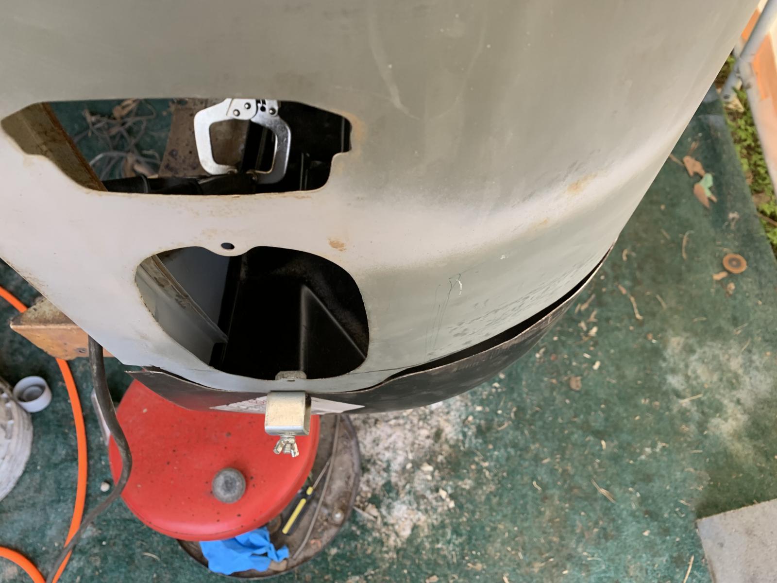

Not a whole ton of progress this past week but I did get the rear corner and battery tray mocked up. The battery tray fits pretty well its going to need some more adjustment before its all welded in.

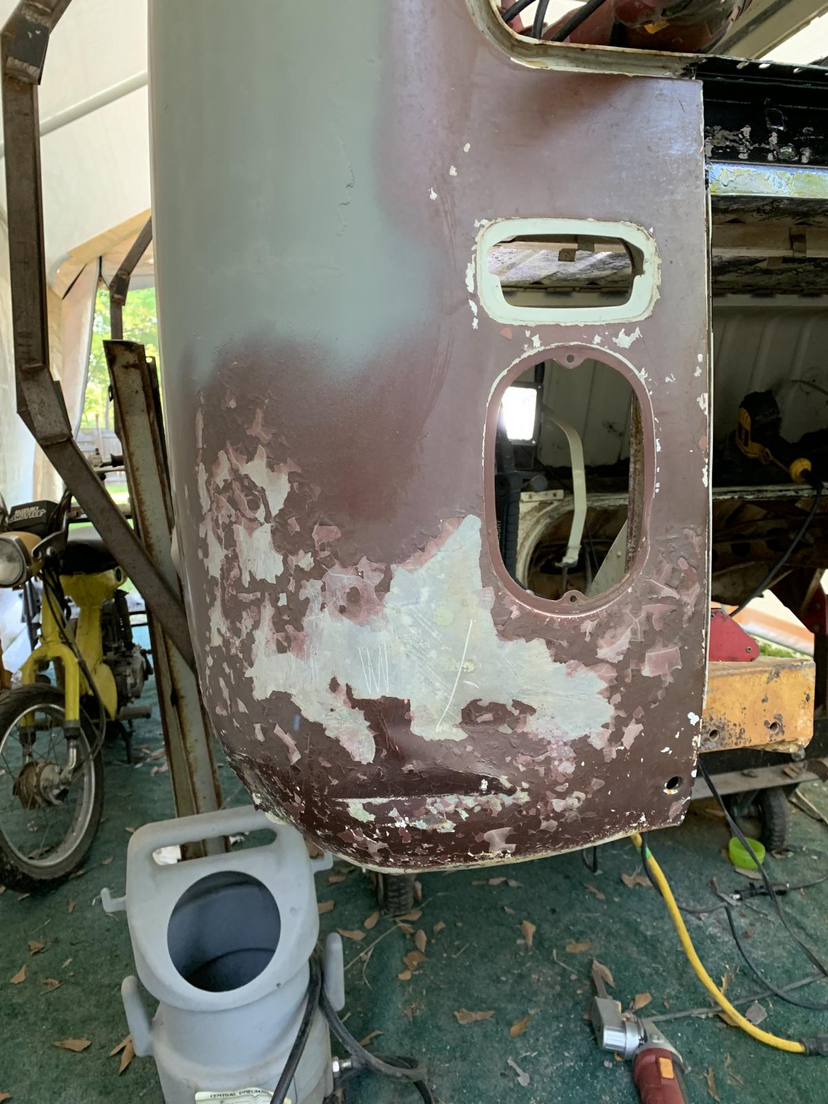

Having some issues with the fitment on the rear corner repair section. This corner had been pushed in pretty bad and I did a lot of work with the hammer and dolly to get it to where it is...but I think that the OG metal still needs to be stretched out more to meet the repair section. I think the metal here is work hardened and I need to anneal it before I can stretch it some more...since it kind of stopped stretching at all while I'm hammering on dolly.
I'm still pretty novice at this stuff but learning as I go so any advice is appreciated.
I also welded up the 4-5 holes up near the belt line that they had drilled for their bondo to grip to :roll:

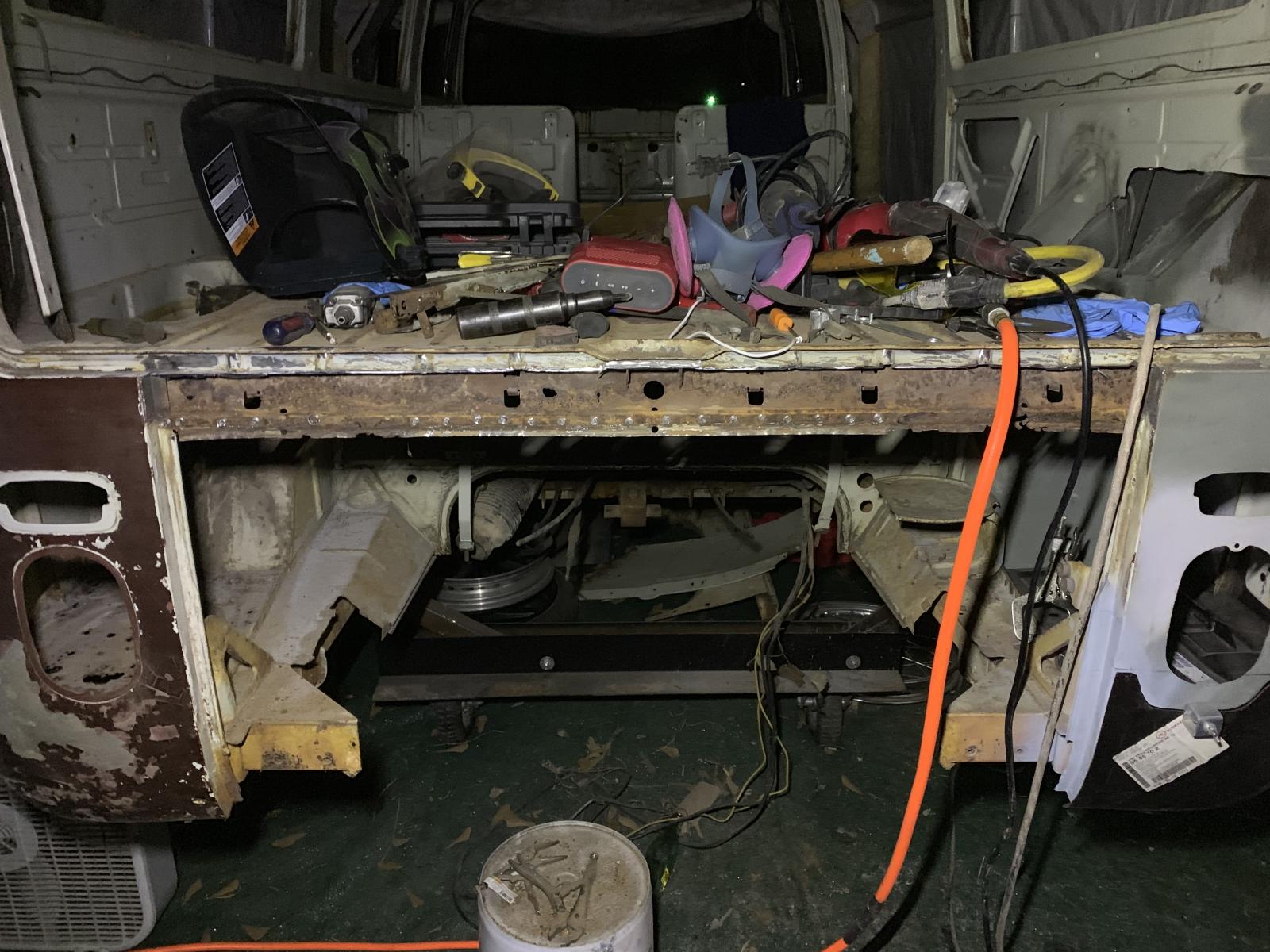

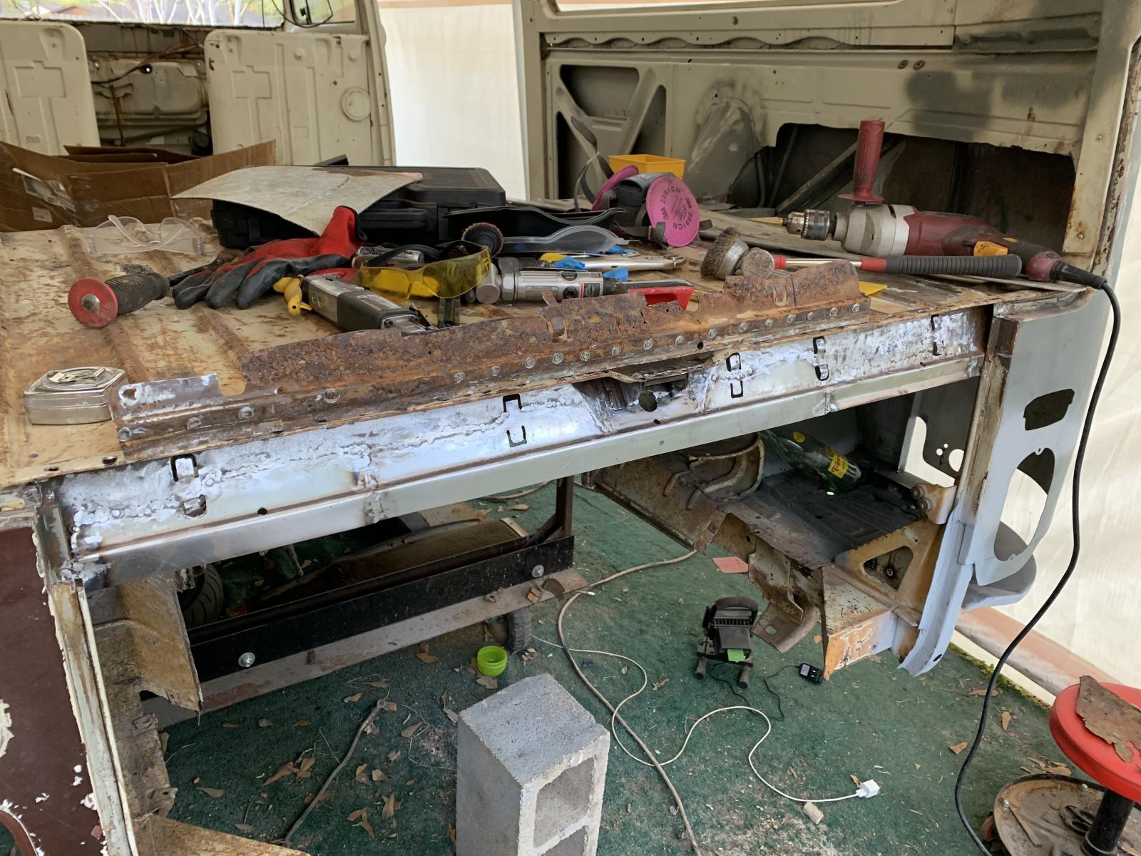

Last night I took a break from working on the rear corner and started cutting out the rear hatch support crossmember. This piece is stupid. Tons of spot welds along the bottom which wasn't too bad but the kicker is that the seal channel section is spot welded underneath the package tray edge lip. This was clearly not built to be taken apart :lol:
So I ended up just cutting along the seal channel so I could get a Roloc in there to clean up the paint and locate the spot welds. I'm eyeballing the location and marking them on top with a sharpie. I think I'll drill from the top right through and use plug welds to weld the repair piece in because I don't think I hate myself enough to try drilling those spot welds out from underneath! :D
I have some work to do on the inner support there so once I get the rest of the metal removed I'll clean that up and get it squared away so I can weld the replacement in.
Other than removing the original panel this repair should be pretty straightforward. And its especially nice to be able to stand up and work on the bus for once.

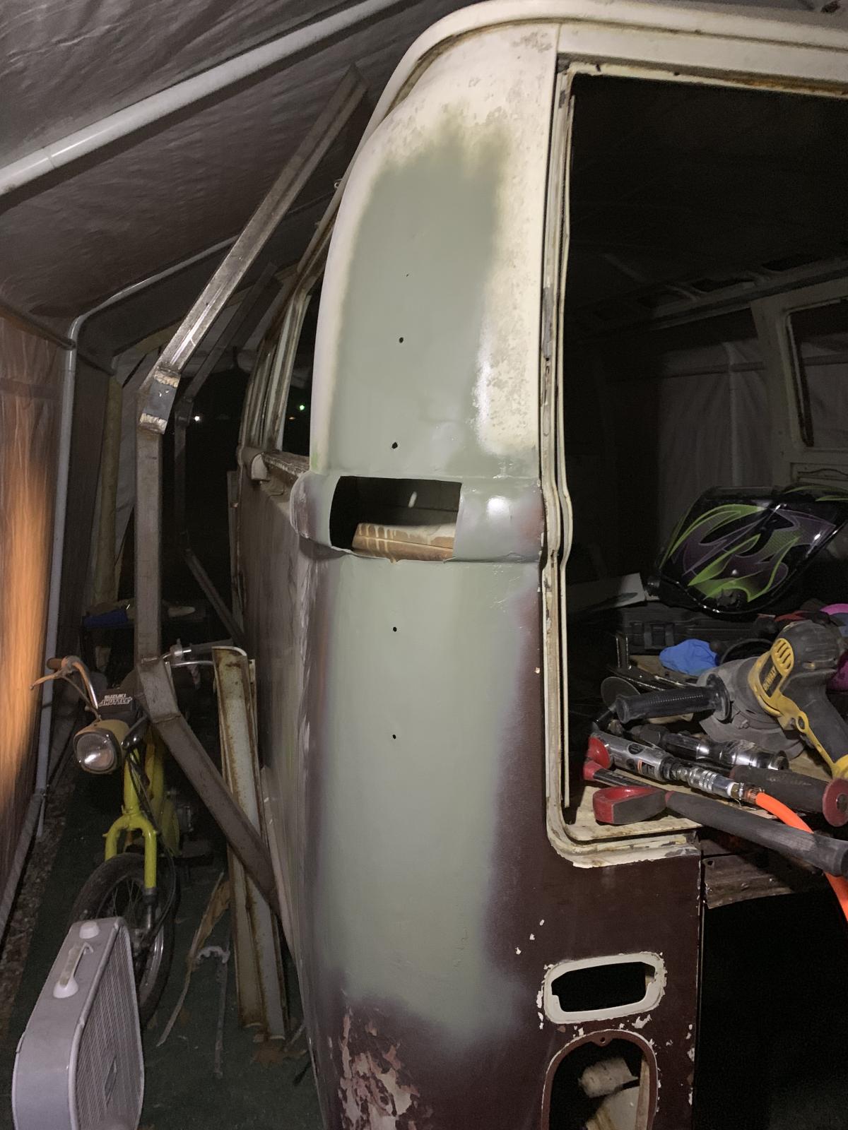

We hit a local VW show and swap meet on Saturday and I got motivated to do some cosmetic stuff. This big dent on the driver's side corner has been bugging the crap out of me. First I welded some studs and tried to slide hammer it out. The mashed in belt line really had the dent locked in, so I couldn't make any progress without cutting it out. I have some donor metal That I'm going to weld back in there once its as straight as I can get it. Having that 3" gap makes it a lot easier to get a dolly up inside the fresh air vent. Once I was able to unlock the creases on the 4 corners the dent started coming out pretty well.
Straighter and minus some belt line.

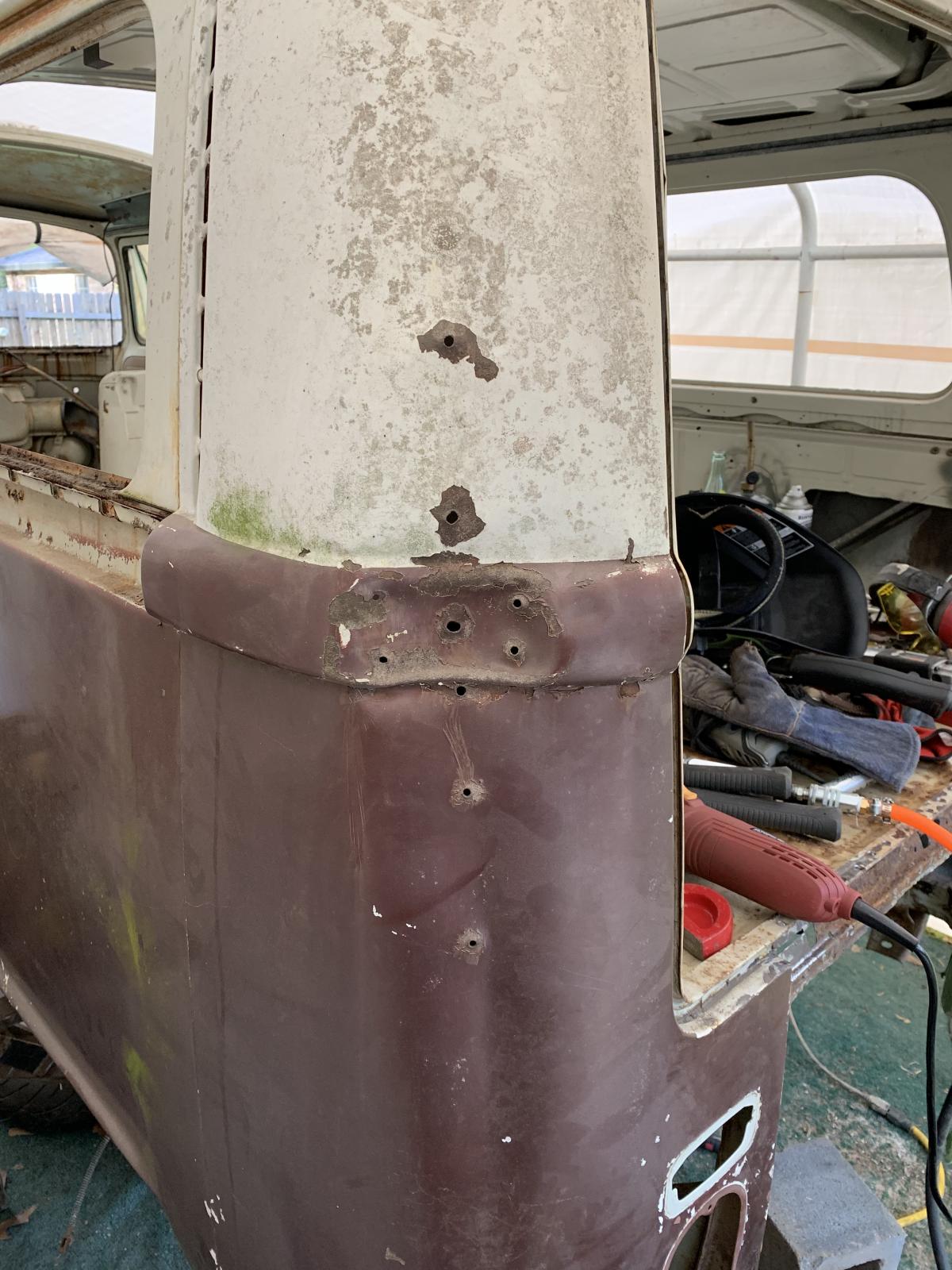

Then I turned my attention to the driver's side. This was pretty much the only area with bondo on the entire vehicle, but judging from the inside the damage didn't look too bad.
Propane torch and a 3" scraper made quick work of the plastic, then I hit it with a flap wheel to strip the remaining crap off. I had to do some work straightening the rear wheel arch corner section but I was able to keep it intact on this side.

This is the method I use for cutting body panels (when I can). I'll roughly sketch out a line on the Bus to where I can see the ends of the line with my replacement panel over top. Then, I clamp the panel on in a few places and then transfer my line over to the replacement metal. I use the body saw to cut through both pieces of metal (OG and the replacement) at the same time. This leaves an identical cut line on either side of my joint, eliminating the need for adjustment afterwards.

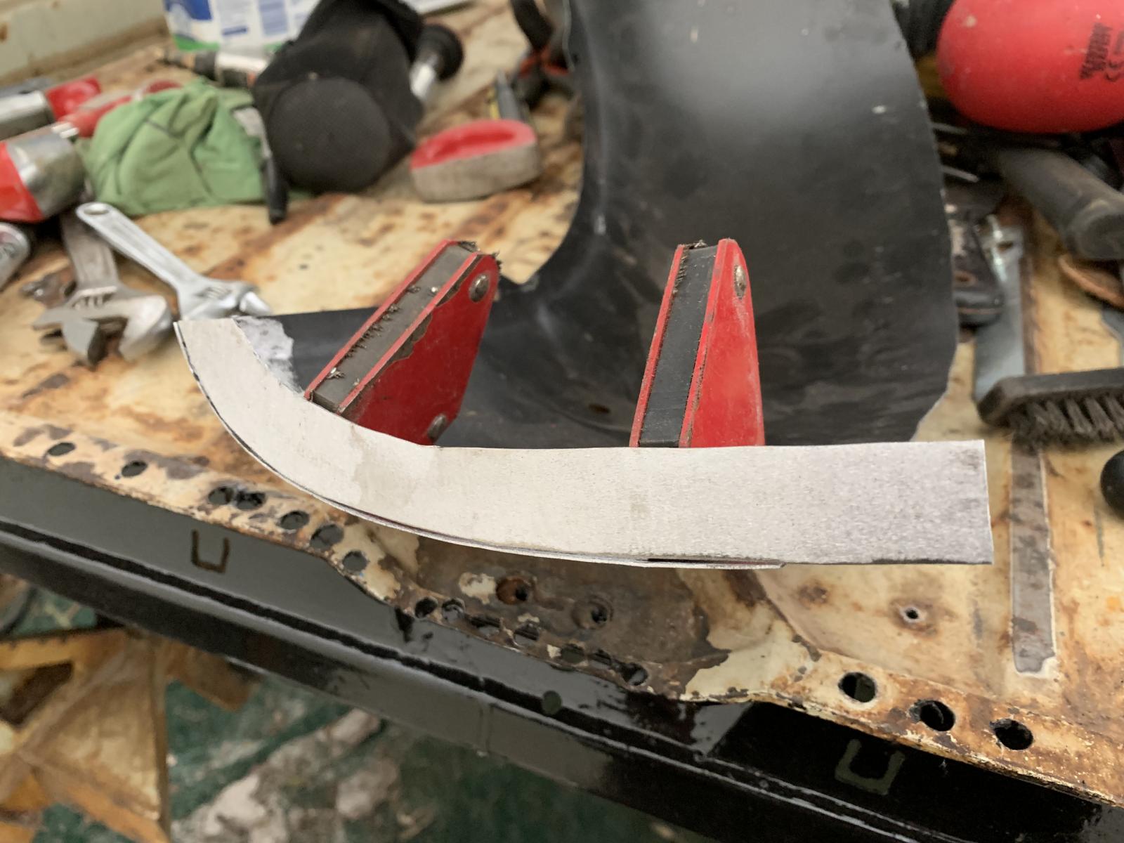

I mocked up the panel with butt welding clamps and scored a line on the inside of the panel where the flange joint needed to be. I trimmed the panel and then transferred the curve to a piece of cardboard and made a template for my flange. Cut that out of 20 ga, refined it a bit and then welded it on.
Tacked in place, I had to fight this one a bit (again) due to previous damage on the OG metal. I had to stretch out the OG metal a bit and shrink in the replacement metal to meet.
