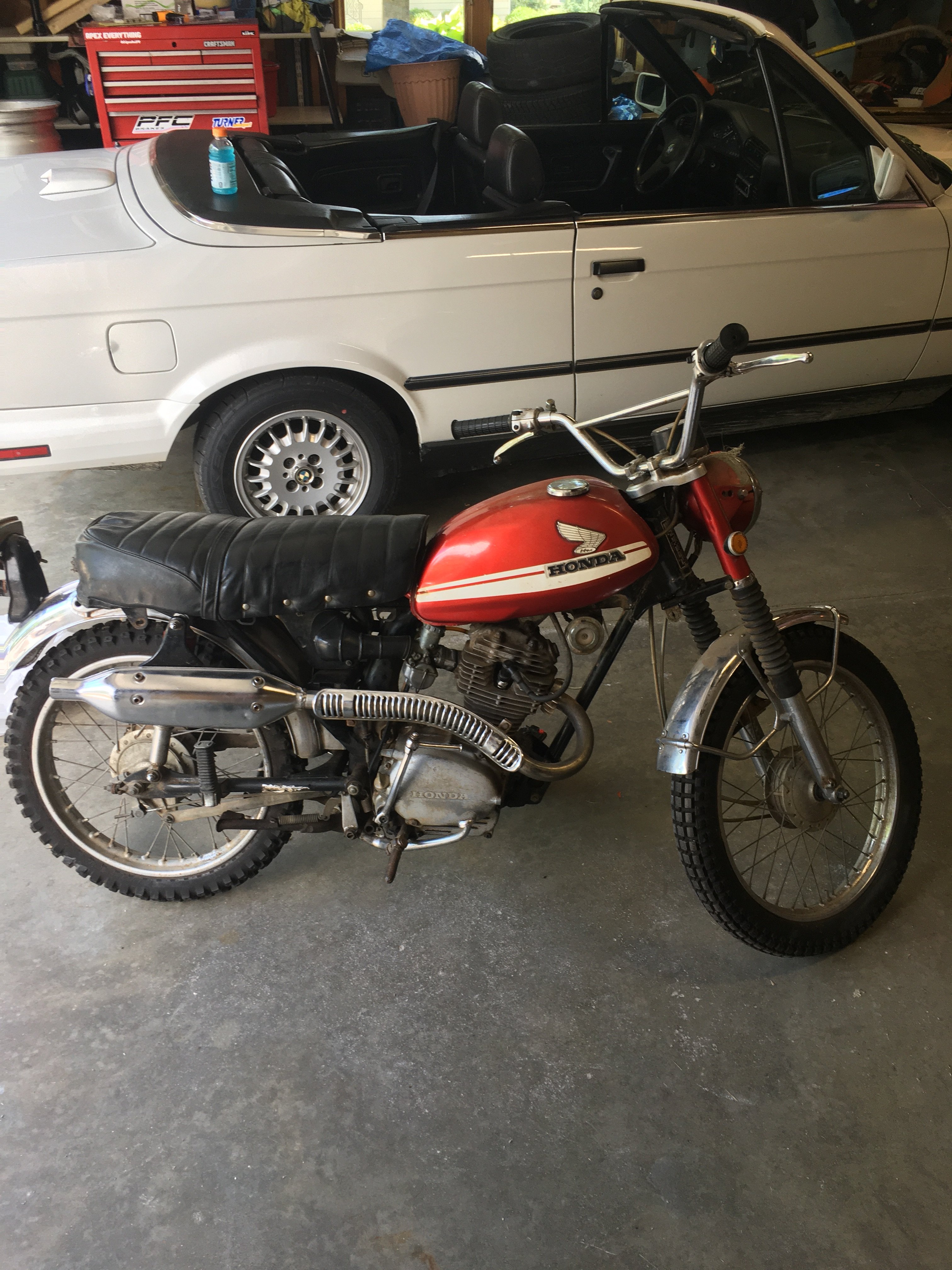

Some of you may have seen my posts in the engine section of the forum asking for help but I thought it might be kind of fun to make a build thread too. I don’t know how much I’ll actually update it, and I’m sure most won’t really care as this won’t be a special or high cost build, but it might be cool for me to look back at one day. The bike: it’s a 71 cl100, build date of 4/70, so it already celebrated its 50th this year, which is kinda cool to me. This is my first bike, and I bought it from a friend who got it for free and didn’t know how to work on it so i got it for a whopping $20! I cleaned the points, got a new coil and some new floats, cleaned the tank with a vinegar treatment, and it now runs good enough to drive. Probably gonna do a carb rebuild here soon too. Planning on this bike being just an off roader for now as I don’t have the money to register, insure, and buy all of the gear I need as I am going off to college soon. So since I have the off road gear, for the near future I’ll just have some good (although I imagine slow and uncompetitive) fun on the trails. Thanks for looking!

Fear not, every build on here is special in it's own right and many aren't high cost, your bike will be interesting and anything you do might help or inspire somebody else in the future.
That's a great looking little ride you have there! Pretty good looking for a 50 year old.
My thoughts exactly - you're in good company here mate

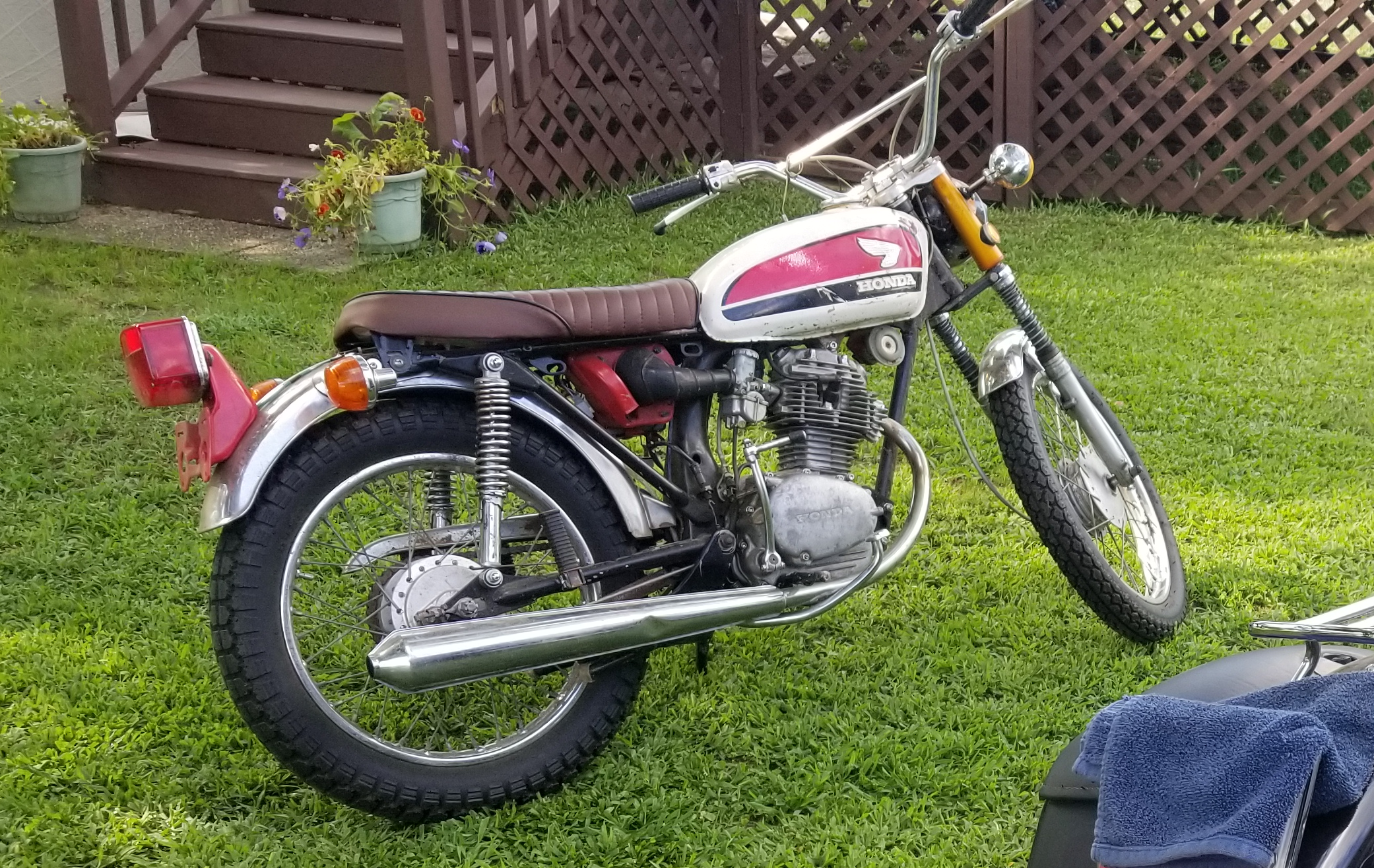

Mines also a back yard fun toy for now, til I get brave enough to tag it.

That’s a great looking bike! Where’d you get that seat in kind of like that? I updated the rectifier a couple of days ago and it definitely helped
Thanks! Is the seat comfortable? Mine is kinda ripped I wouldn’t mind a new one and that’s a pretty cool one.
I originally didn’t like the look of the high scrambler pipe but it’s grown on me so much. Mine is not in the greatest of condition though. Big hole where the guard used to be, which I imagine is not helping the performance.
Before I got it home I was coming up with all sorts of ideas to make it look cooler, and now I love it so much the way it is I don’t think I could bear to change much! Has anyone ever tried to make custom side covers for one of these? I’m thinking of fabbing up some sheet metals ones because I’m afraid of buying plastic ones and bouncing it off of a tree

Haven't really ridden any distance to say how comfortable.
Playing in the back yard on it is ok.
I'd like to see what you come up with for the side covers. Besides being different from those on the CB and SL bikes, the right side cover gets baked by the pipe a little. It's not easy to score a good used one.
