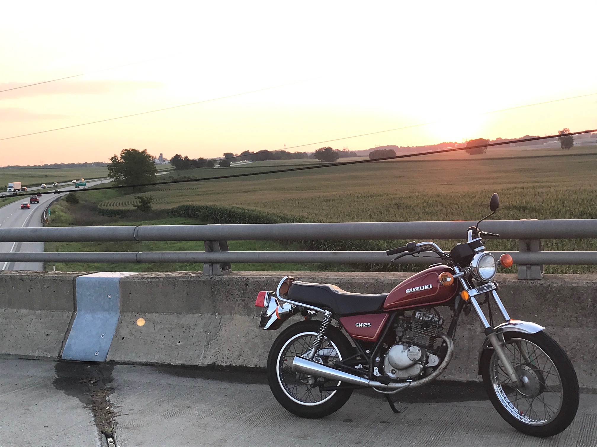

Good stuff man.. My daily town-hopper atm is a 1982 Suzuki GN125 and the more I ride it the more I love it... so much fun to bomb around the back country roads.

I agree 100% man... It is a lot of fun. This is the first bike I've had that I can honestly say I've pushed the machine to it's limits... it's fun bombin that little bike through the Amish back-country at 65 lol

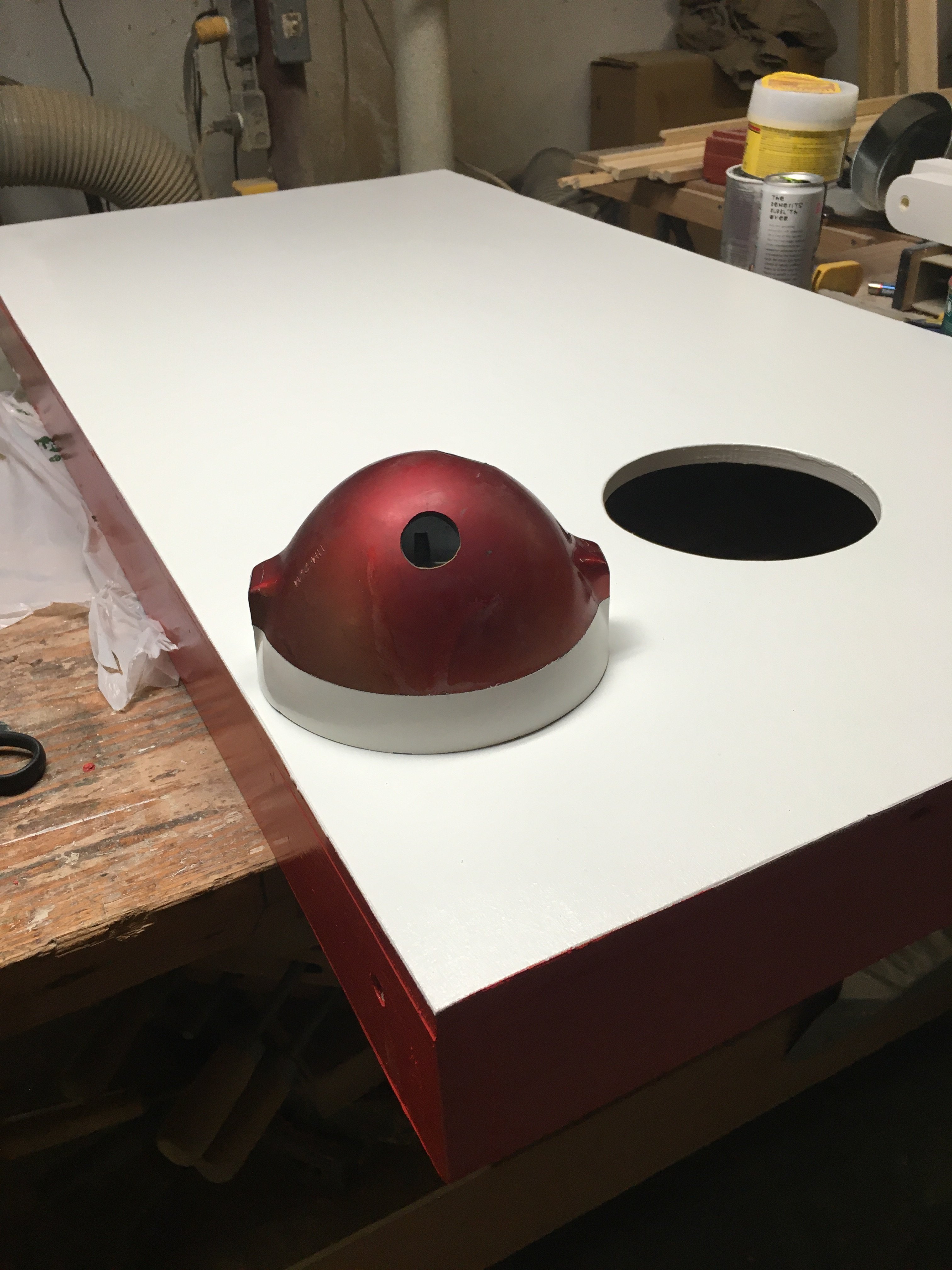

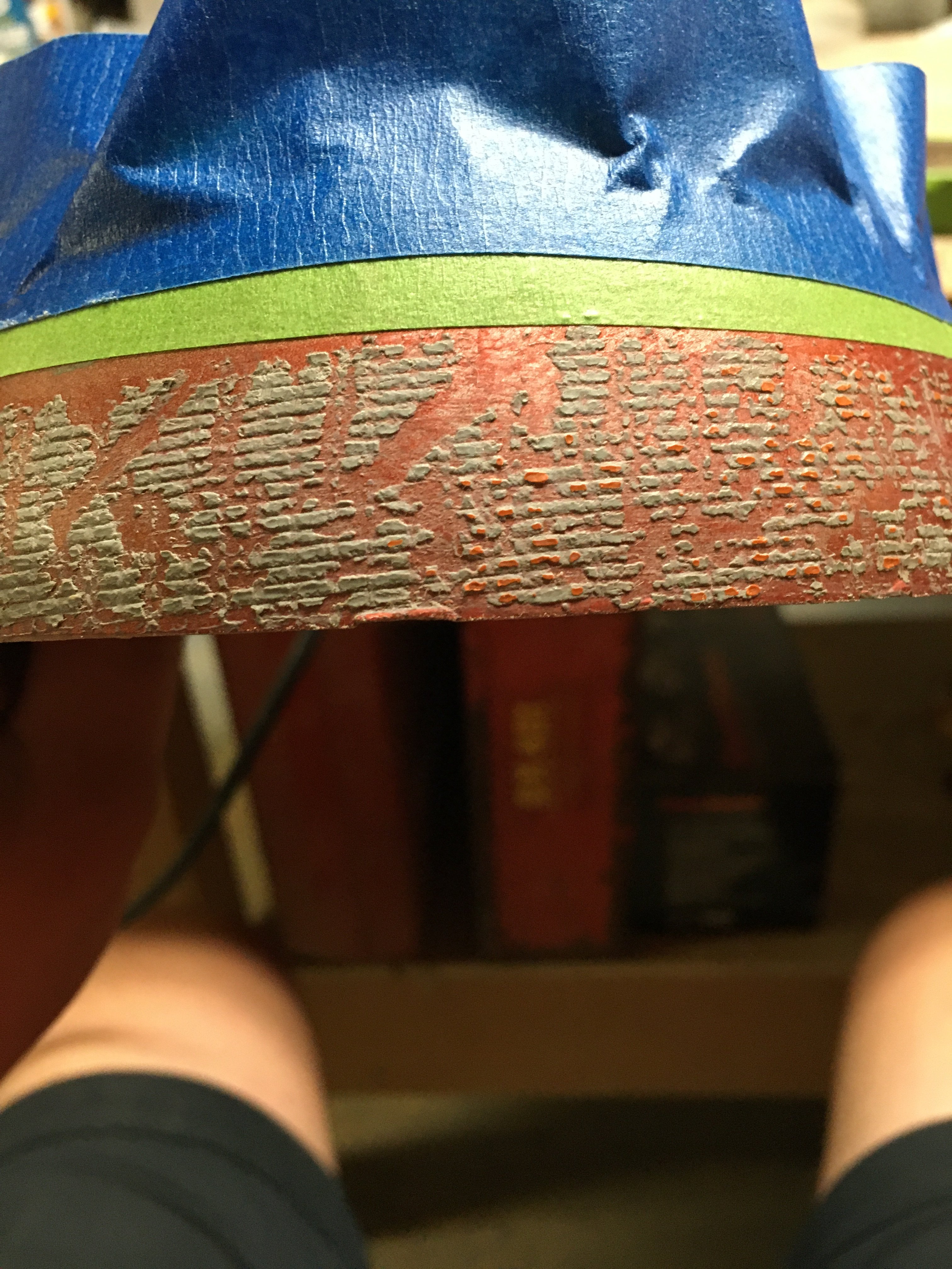

Small update. Just been trying to clean things up and get the bike to presentable condition. Not looking for show quality, she’s a survivor after all, just something I can hop on and not worry about. I spent a few hours the other night re-wrapping some sections of the wiring harness and tucking it up near the frame out of sight. Polished up the wheels and fenders and ordered some the rubber mounts for the tank that were missing from the bike. Then today I pulled the headlight case off the bike to repair a bunch of cracks in it and try to clean off the tape residue from decades ago that was there to hold everything together. So I plastic welded it back together. Next I tried to clean the residue off and couldn’t find anything that would do it so I decided that since that part of plastic was so faded and messed up anyways I would just sand off the residue and paint a 1” ring around the case in white to accent the tank.
so I sanded it clean and then after some shitty masking and paint prep I sprayed few coats of primer and a few of the closest white I could find in the basement and ended up with this as the end result
You can actually see in the picture that my mask lines weren’t too great and and I didn’t actually fix the cracks on the outside just from the inside, also the white I picked was definitely a little off from the white on the tank, but all in all not to bad, and the tape residue is gone so I’m pretty pleased. And finally a pic of it on the bike-
Not sure if I actually like the look of it or not, but it’s better than it looked before. Plus if I decide that I really hate the look I’ll find some color matched paint and do it right and bondo it and use clear coat, but at this point the chances are that the bikes gonna run through branches and brush and be in the woods so I don’t see any point in dumping a ton of time into paint work.

Nice work! The bike is looking better, for sure.
Maybe someone who actually knows something about painting will chime in, but my guess is a quality vinyl tape would conform to the spherical shape of the headlamp bucket better than masking tape, and leave you with a sharper edge. Check out the rattle-can bling thread, I bet they've discussed it there.
I'm curious to know how your headlight bulb works out. I hate the look of LED, too, and switched my bikes' lights back to incandescents. Except for the speedo gauge lights- those are a hundred times better with LED.

If the headlight case cracks again, repair the cracks with ABS plumbing cement and fiberglass cloth.
I’ve done some fiberglass work before, which was my plan for a permanent fix later on, but never tried plumbing cement. What’s the benefit there?
I have a roll of vinyl masking tape but couldn’t find it last night so I just made this work. I also pulled the masking off before the paint was very hard so the edge was kind of rubbery, so I’m sure if I had waited longer I might’ve gotten better results. I would love to do some custom paint at some point but I have come to love the paint on this bikes tank. I also have access to professional level equipment so idk if I’d do rattle can or not.

And as far as my little GN125... It hums all day at 60-65 on the amish back-country roads man... You cant baby these little metric singles.. They make all their power up high in the RPM range so you gotta ride it like you stole it haha
ABS cement melts the ABS and it re-hardens after with the mesh bound to it. The regular epoxy doesn't stick the same.

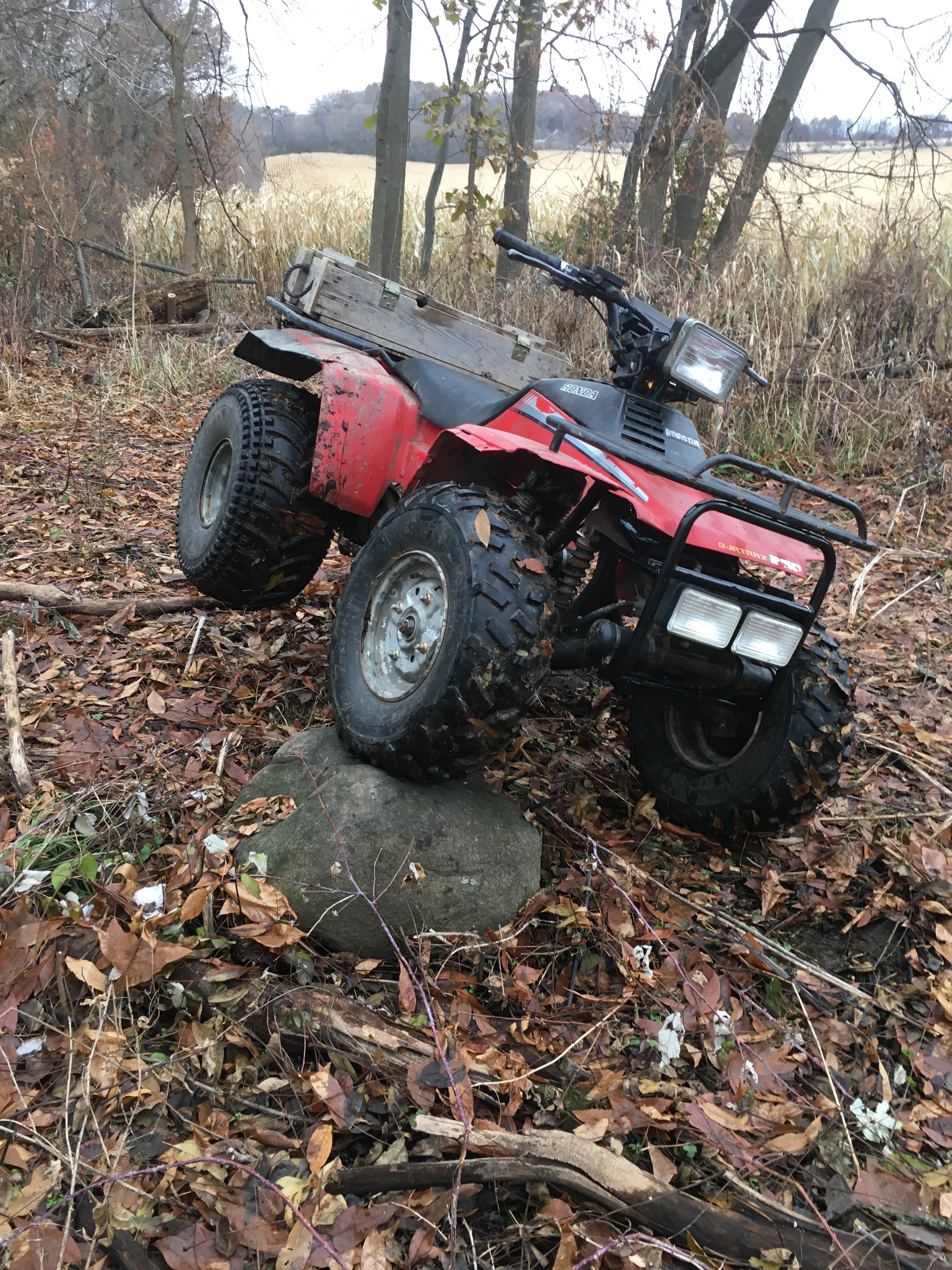

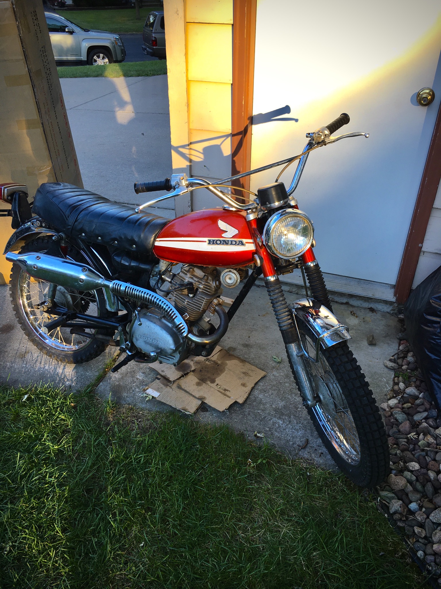

So not a whole lot to update on this bike. I put the rubber gas tank mounts on and a new air filter, but other than that it’s about the same, though I did pull the swing arm and paint that one day. It didn’t really need it but it was a little beat up looking and I was pretty bored.
And here’s the bike as it sits now. As you can see by the cardboard under it it has a small oil drip. Not sure yet where it’s from, but also not going to worry too much about it so long as I keep an eye on it.
I also trailered the bike out to its home for the foreseeable future at my uncles. As much as I want to get a street tag for it it just doesn’t make sense to do it at this point in my life. So instead, trails it is. I played around for a while on the trails at his place, and the bike did pretty well. I did find however that it still has some strange idling characteristics. Sometimes it’ll idle slow, sometimes high, sometimes it runs away a little bit. I thought I solved this with the new gaskets and whatnot but it would seem not. I plan on using the brake clean vacuum leak test to see if it’s a leak in the intake system still, or an unrelated problem. Also found out that as I expected, it needs to be geared down, but I’m having some trouble finding info on sprockets, so if anyone knows where I might find the right sprocket with one or two less teeth(front obviously) please let me know. And finally I found that I need a skid plate. I suspected this as well due to the low ground clearance. I also wouldn’t mind stiffer rear springs, but I don’t have the cash to throw at a set of all new shocks. But all in all it handled the trails well. It was able to keep pace with my brother on our 1984 TRX200, pictured here:
This atv might i add is stupidly capable off road, despite being 36 years old and two wheel drive. Hopefully I can get some stuff done on the bike this winter, however I leave for my junior hockey season soon so time that I am both home and able to get in the shop is going to be pretty limited. But my goal is to get all the things outlined in this post done this winter and then this spring my brother and I will load the atv and the cl on the trailer and go camp and ride for a weekend. So yea, that’s about it for now
