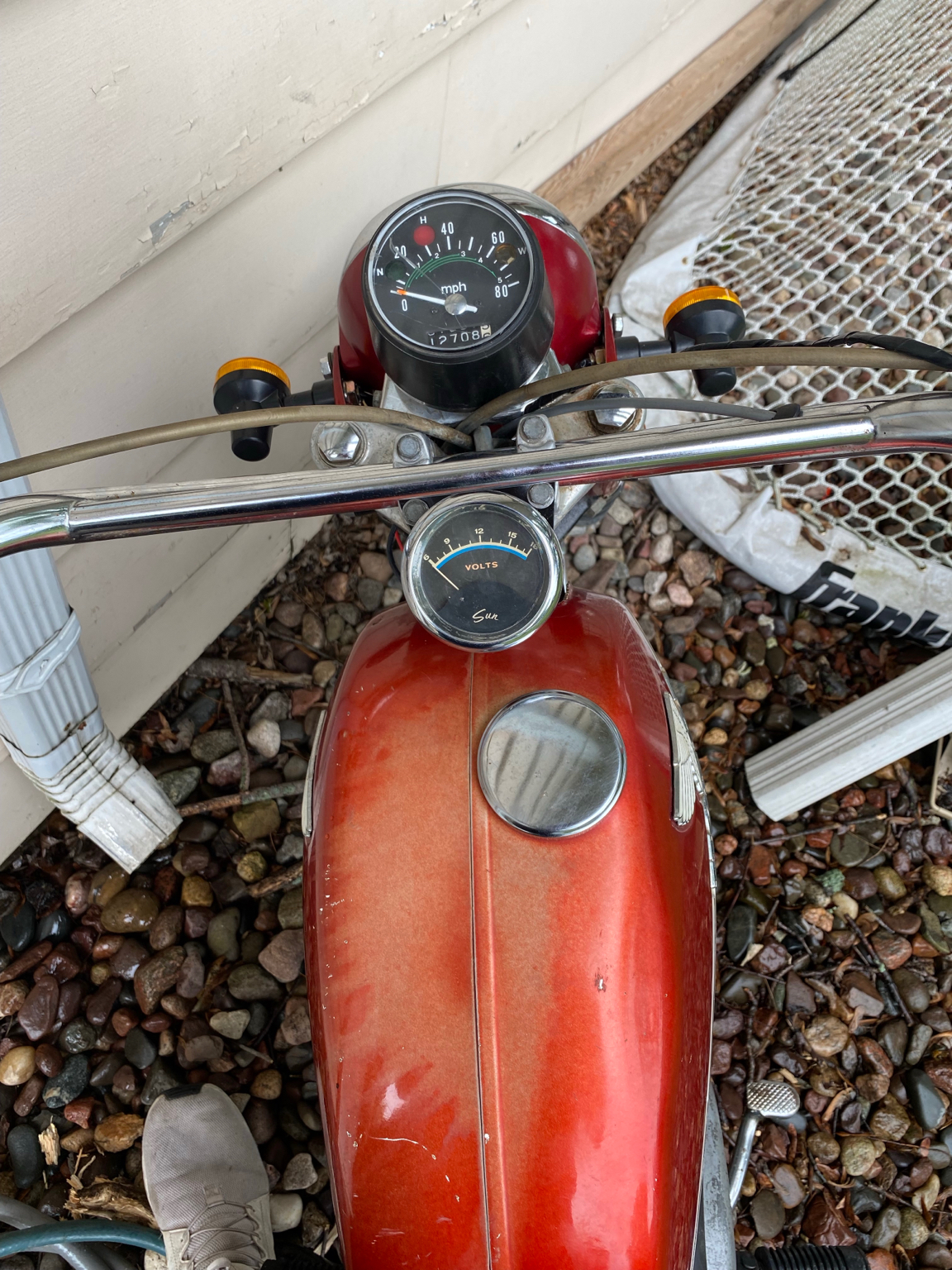

I also mounted up my new voltage gauge today. I think it turned out nicely. Looks a little goofy maybe, but better than a digital in my personal opinion.

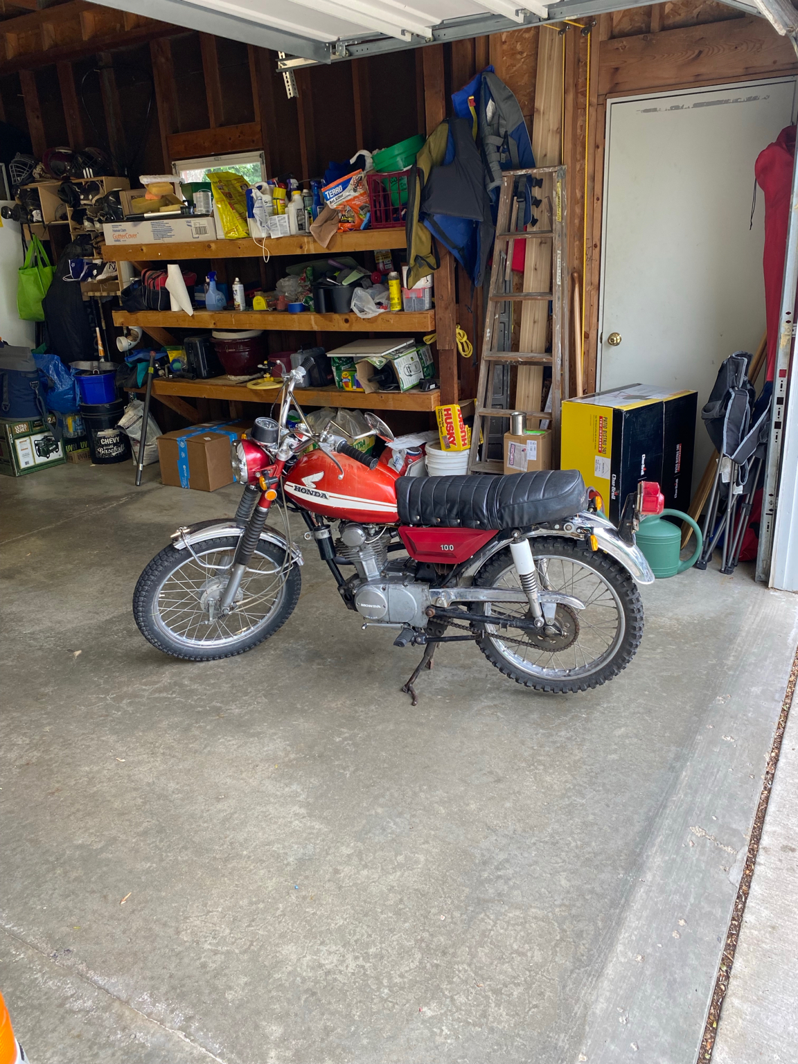

And this is how she sits in her current state. Nothing spectacular, but I think it’s cool. I built another custom side cover for the left side, and put 100 badges on both sides, similar to what would have come on the bike. Both covers are definitely 10 footers, but someday maybe I’ll put some nice paint on them. It’s just been tough to get a decent match to the original from a rattle can. I still need to do exhaust shields. I am pretty pleased with how this bike is turning out for my first try at any of this stuff. I have a little experience with small engines and fab work, but this is my first go around with anything motorcycle related. Plus, purchase price included, I’m probably into this under $500 for everything, including cosmetic stuff, so that’s a nice bonus

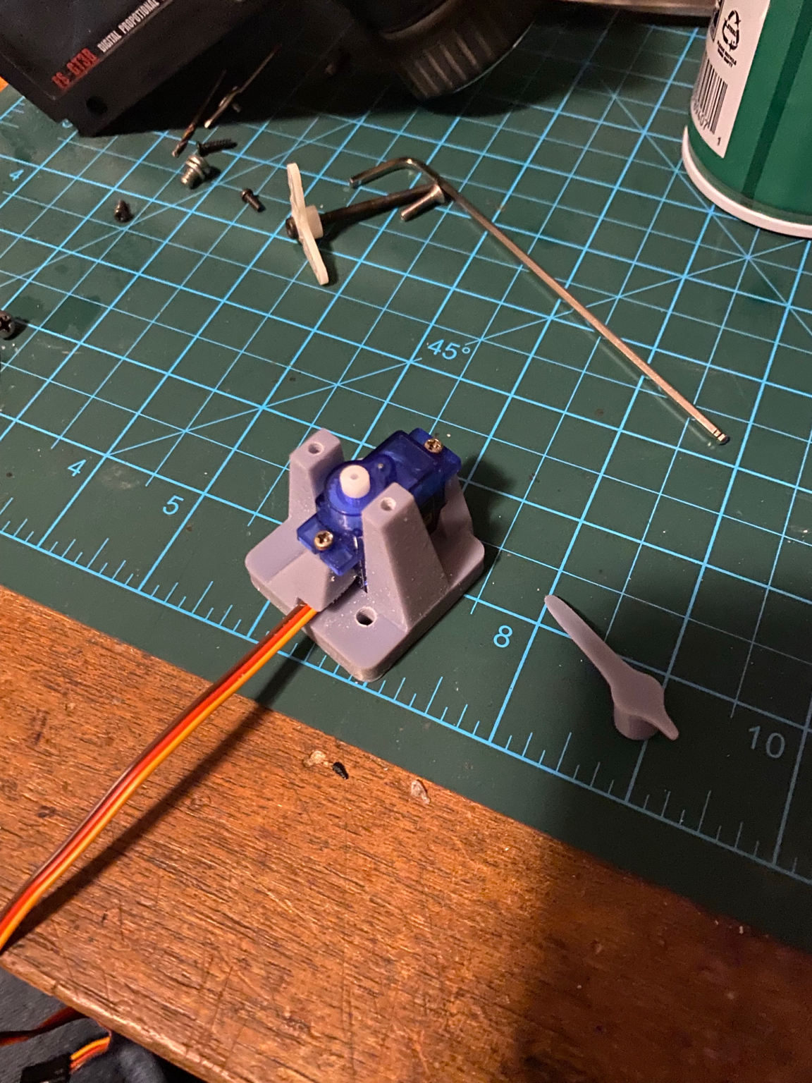

So the bike has been in storage while I’ve been at school and I haven’t really had the time to work on it while I’ve been home for break, so it’ll likely just sit until I can get it home during the summer. But I do have a new set of bars for it, and maybe a new seat coming as well, so those will go on first thing, but my plan for the summer is mostly just to ride it, and figure out the electronic ignition. If I can figure that out the next step is installing a tach. This motor doesn’t have a pickup so I’ll be using the same magnet that the ignition is using to send a signal to an Arduino that will control a servo in a repurposed speedo housing. I recently acquired an sla 3D printer so that will allow me to make the necessary parts for the conversion. I’ve already made a servo mount and the needle for the gauge, though the needle needs some tweaking. Overall I’m pretty pleased with the quality of these prints being that they’re pretty much my first attempts. I also have a new face drawn up to show rpm instead of speed, however I’m having some issues getting it to print. The issue with these resin style printers is that the print can sometimes stick to the resin vat rather than the build plate, and that’s my issue right now, but I will try again tomorrow and see what happens. A small price to pay for how much detail the resin provides though if you ask me.

Got the gauge face to print today. Turned out ok. The numbers need to be moved and made bigger so you can actually see them, and I realized that the servo only has 180 degrees of rotation so I need to redo the locations of the graduations so that the servo can cover the entire range of rpm, but for v1 I think it turned out ok. Obviously in the pic there’s no paint on the gauge or needle either so it’s a little tough to see everything but with paint I think it’ll be fine

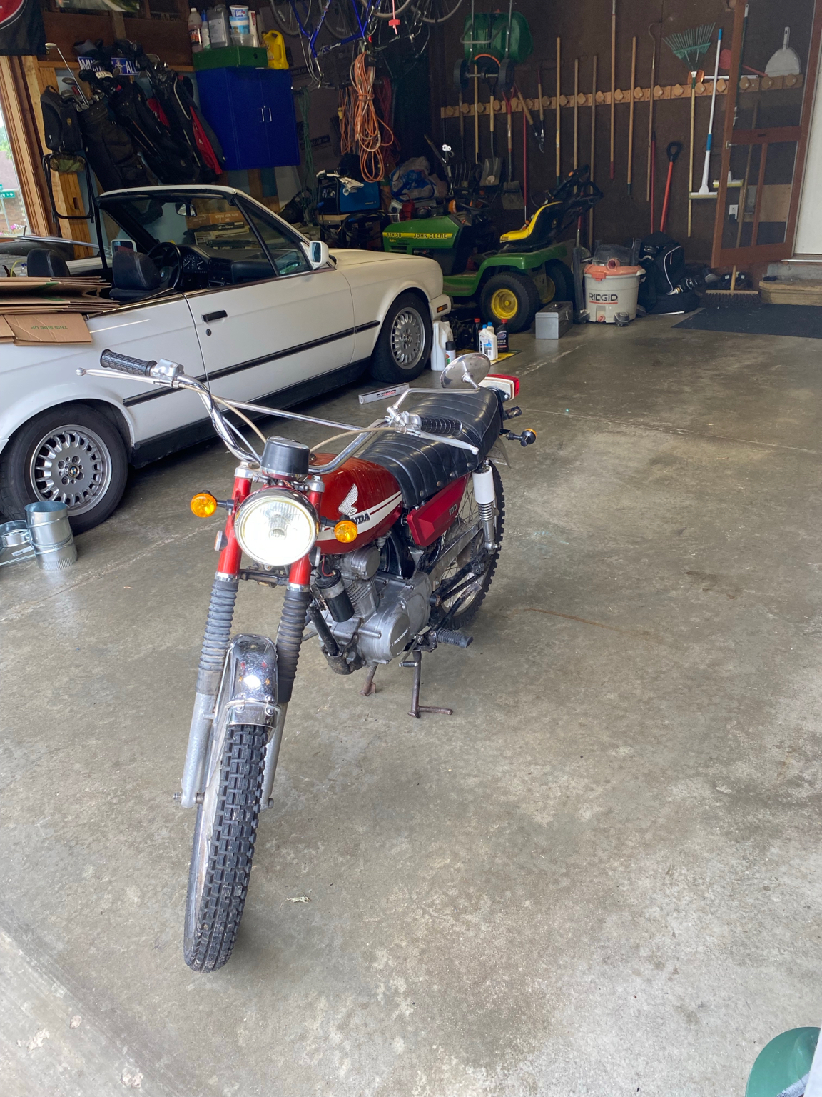

I was able to get the bike out of storage this past weekend for the first time this year, and unfortunately the battery was completely dead and the reg/rec had puked. Thankfully I knew the rec was going so I had one waiting, and the new battery is on order. With the new rectifier the bike was able to start and run even with the junk battery, and it seems to be running well. I need to replace the copper exhaust seal and do a valve set, but I feel good about where the bike is mechanically. That said, I installed a smaller front fender and flat bars this weekend too. I like the bars, looks wise and comfort wise, but I’m not sure I’m entirely sold on the fender. I think with a seat it would complete the look. I also have front end parts to convert to a disk brake, so hopefully I can get to that this summer. I’m just happy to have it home!

Nice little bike. Mignt help visual balance if the rear fenderwas bobbed also. But, would improve ridability if the front gave better protection.
The improvised fix on the handlebar is pretty cool, was wondering where you sourced that new front fender? Glad to see this little bike back out
I have considered doing something with the rear fender as well, and I actually got a rear at the same time as the front, but it didn’t fit at all. I may chop it up to make it work yet though. I don’t want to chop up the original though. I think that would also require changing the tail light too, and I don’t have any idea what direction I’d go there. Might draw up some ideas in cad though. In terms of the front fender, this bike is hardly ridden right now anyways, much less in poor conditions, so I’m not terribly worried about the protection as of now. I will however swap back to the original if I do any off road
Thanks! I sourced it from aliexpress I think. Paid like $.72 for the fender and $10 to ship it lol. It’s shockingly higher quality than I was expecting. The rear fender that I bought at the same time is far worse however so it may just be a crapshoot. It’s listed as a “cg125” fender. You can also source them on eBay
