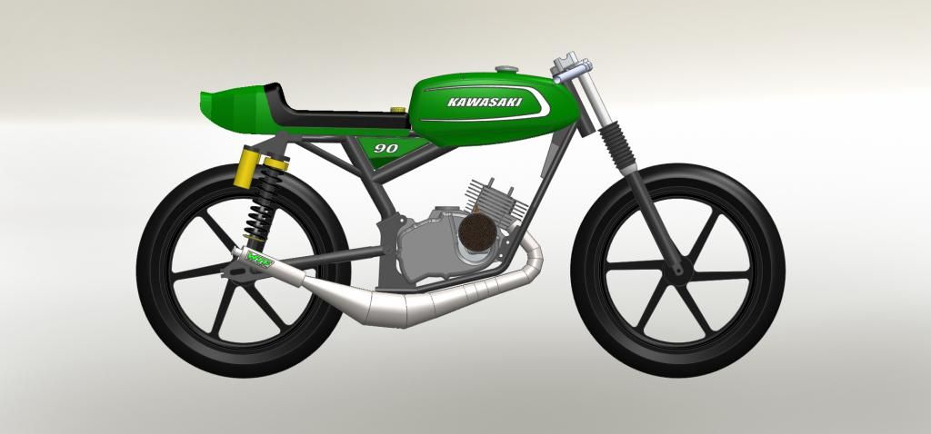

Due to a change in pipe shape, I decided to keep it simple...

that pipe has a lot less going on than your previous designs. a lot less sections. would hydroforming be an option now? would this current pipe clear the stock center stand and foot pegs/rear brake lever?
Hydroforming would be cool thing to explore but I'm tooled up for the segmented style at the moment.
This pipe will require removing the stock pegs and side stand, I plan to box in the rear of the frame and make brackets for the rearsets below the swingarm.
My bike never came with a center stand so I can't confirm... Maybe you have some photo's?

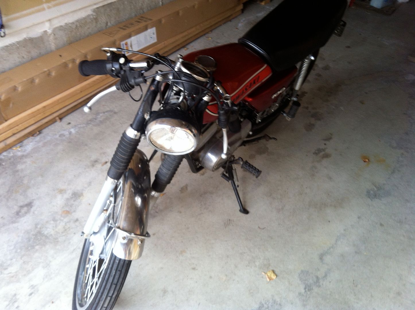

'75 G3SSE. Nice shape, but way to factory for me. ;)
Stripped the turn signals and used drag bars because I didn't have a set of drop bars.
Finally got the drop bars off a buddy.
Sorry for the weak pics. Poor lighting in the garage. :D
