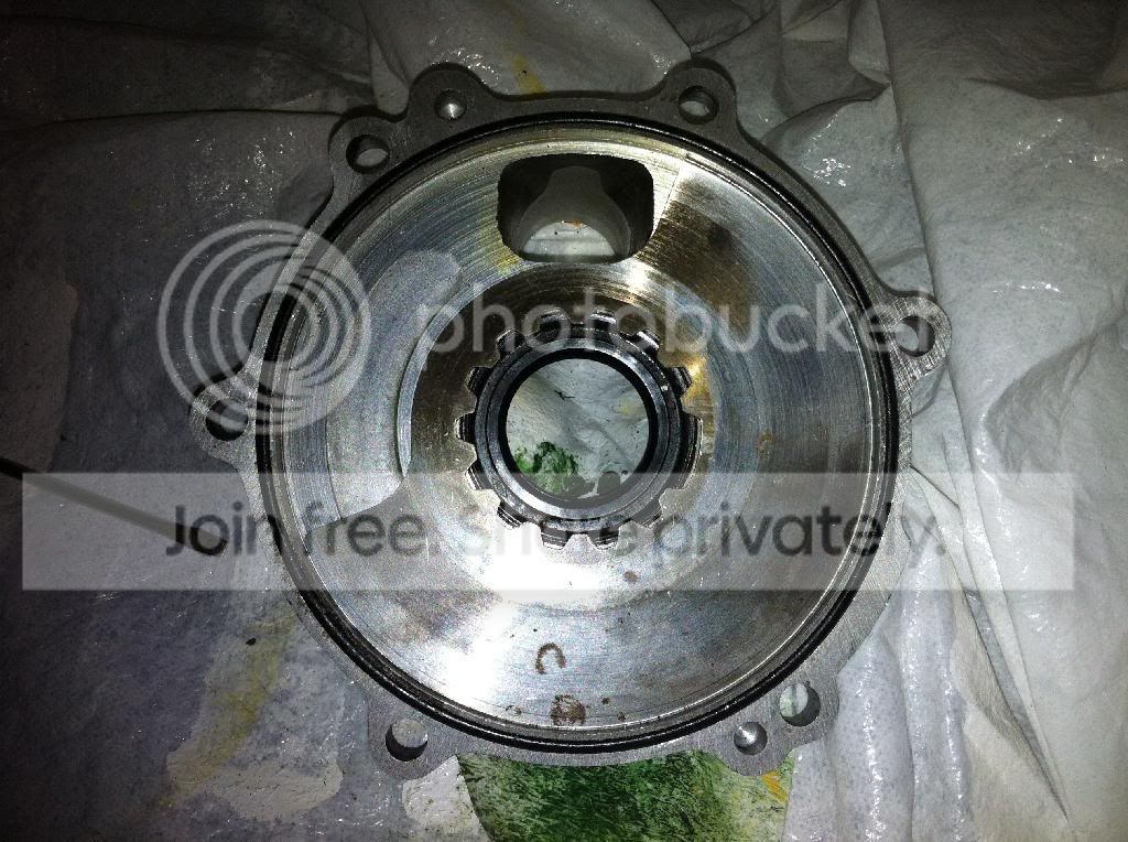

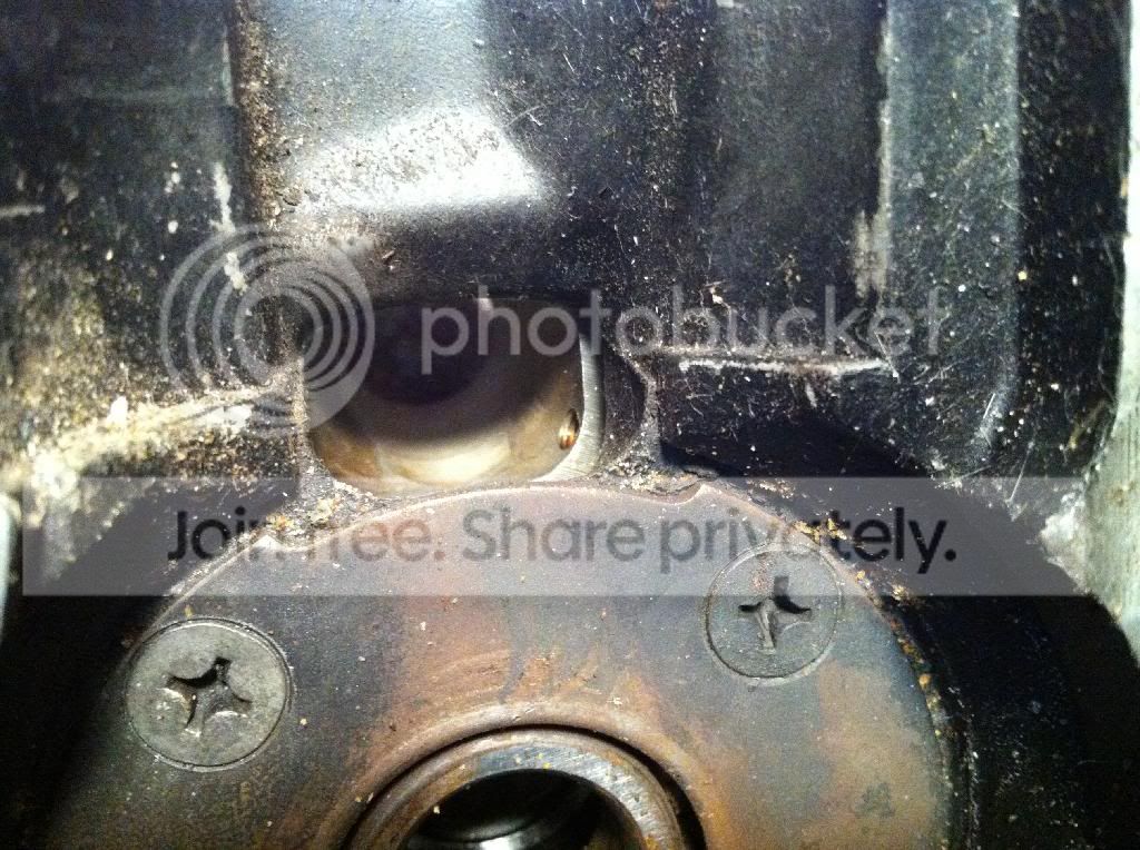

I got started on the motor over the holiday's by shopping on eBay...
The stock cast iron 3 port 90cc cylinder was upgraded to a G4TR 5 port cylinder. At the same time, I bought some cases from a 1993 KE100, mainly to save some port work time to adapt the different cylinders...
