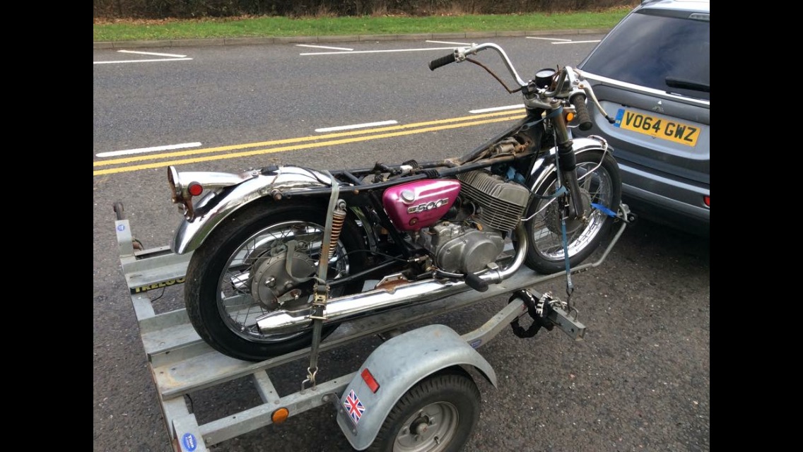

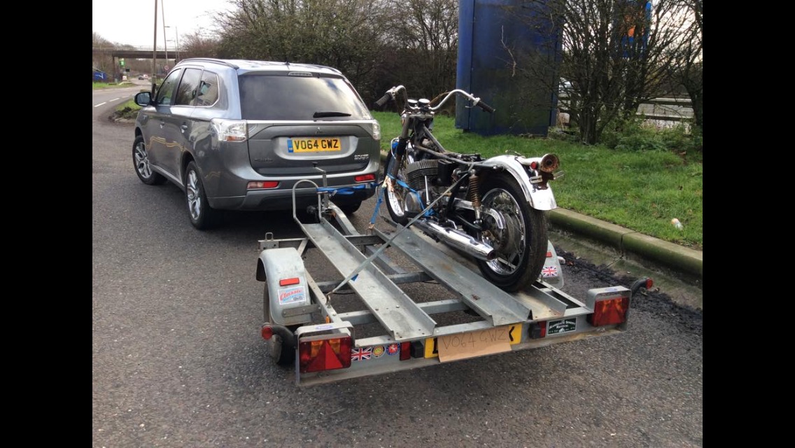

Iam in the UK down in Kent, and some months ago came across an import non runner T500 project.... I had been in search of a two stroke project bike for some time. Very much inspired by one of the guys T500's at our local classic bike club I decided to buy this one and have a go myself. I drove to Brighton and collected the bike. I wonder what people thought on the motorway while I was driving home with this on the trailer!?
Tank is in the boot. No carbs. Engine loosely assembled. No Pistons...... :/

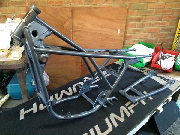

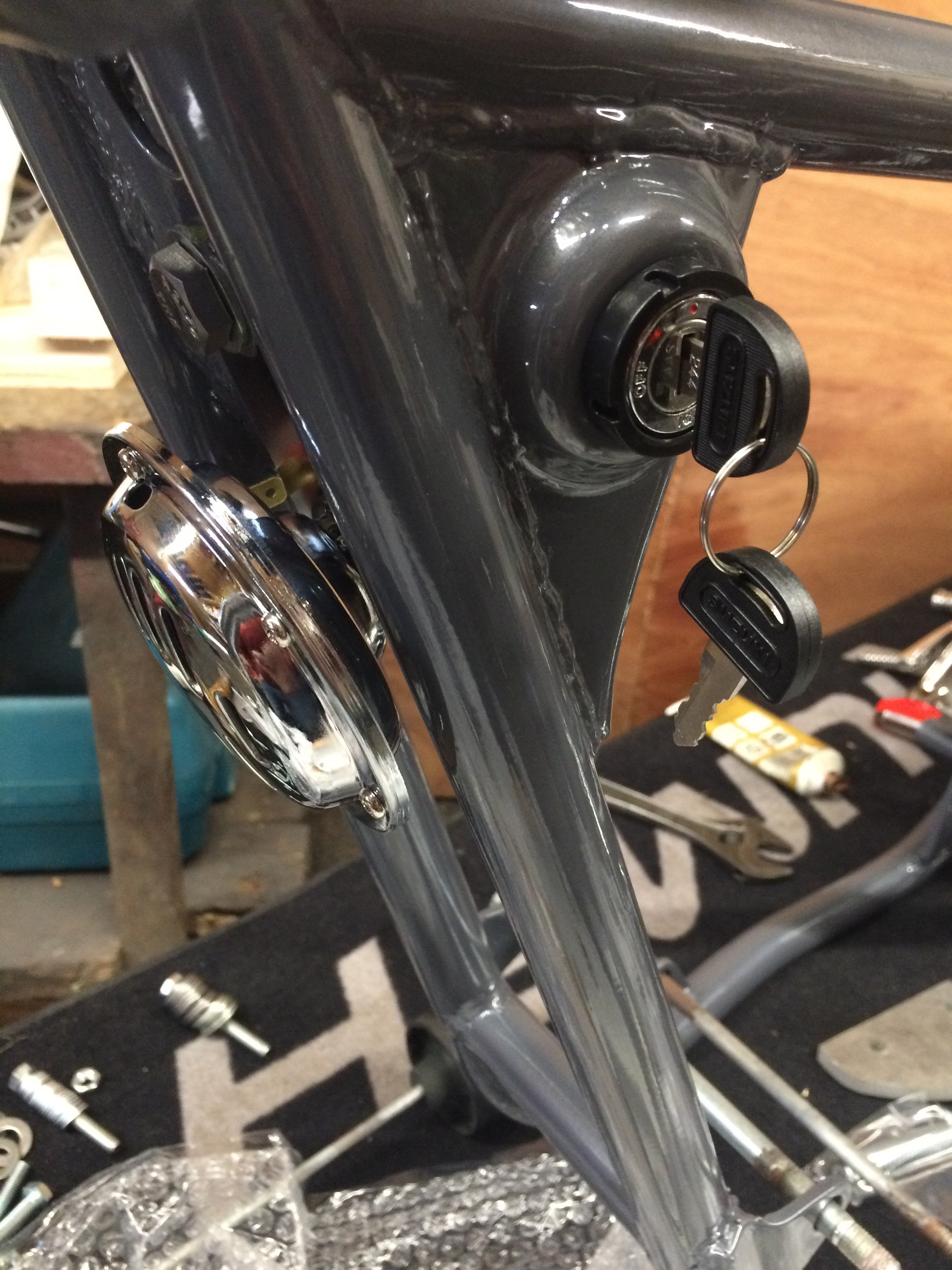

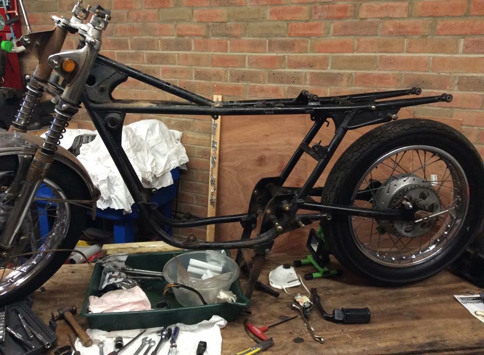

Since getting it home I began stripping it down to the frame. I wanted the race look and so cut and ground down all the unecessary brackets such as centre stand, pump holder, oil tank brackets, side cover etc... I sourced some steel tube and made the diagonal bars, then welded them in place.
The frame, swing arm and lower yoke all then went off to performance Powdercoating near Canterbury, Kent for blasting and powdercoating.
I chose a graphite grey rather than the usual black for frame colour.
Before and after Powdercoating :)

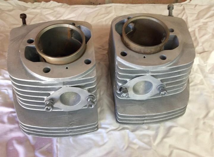

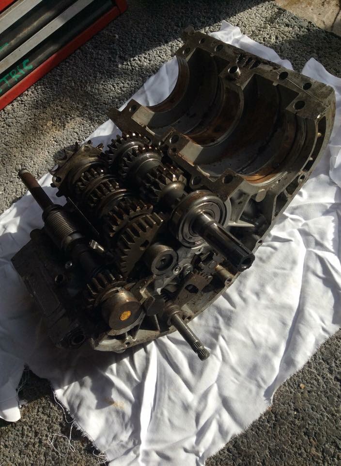

Stripped the engine. Needs some work to get it back running. This is prob my biggest job here...

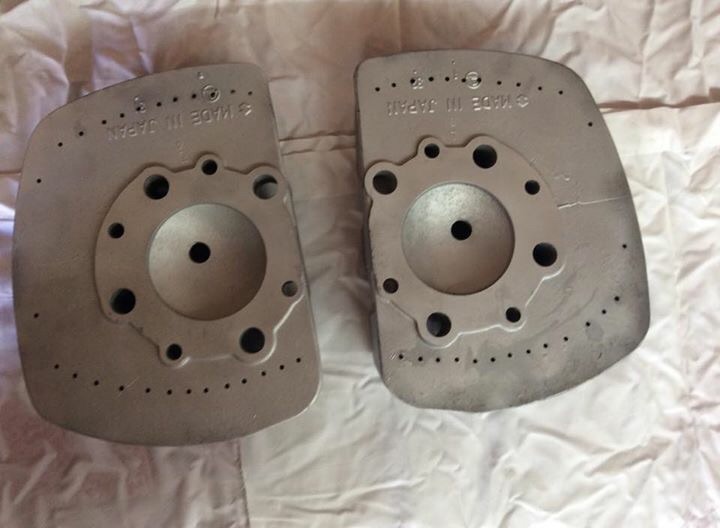

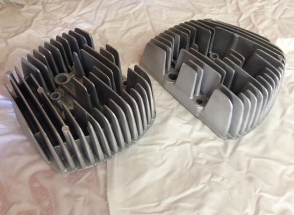

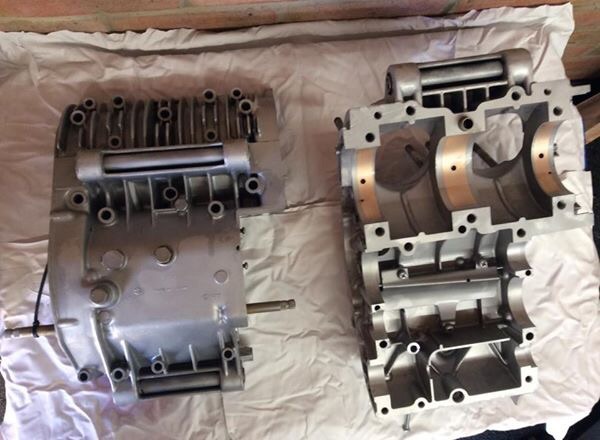

Bit of time with the vapour blaster at work and the cases look much better!
Looking clean once again!

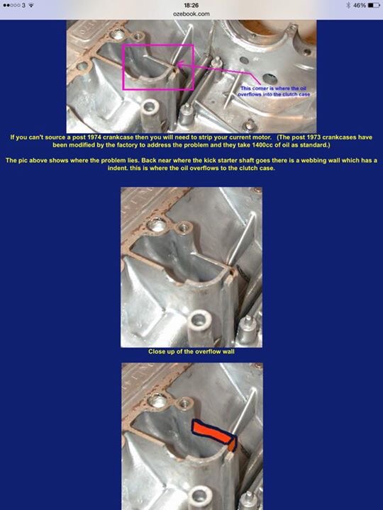

Oil dam mod.... Made it out of some Ali sheet

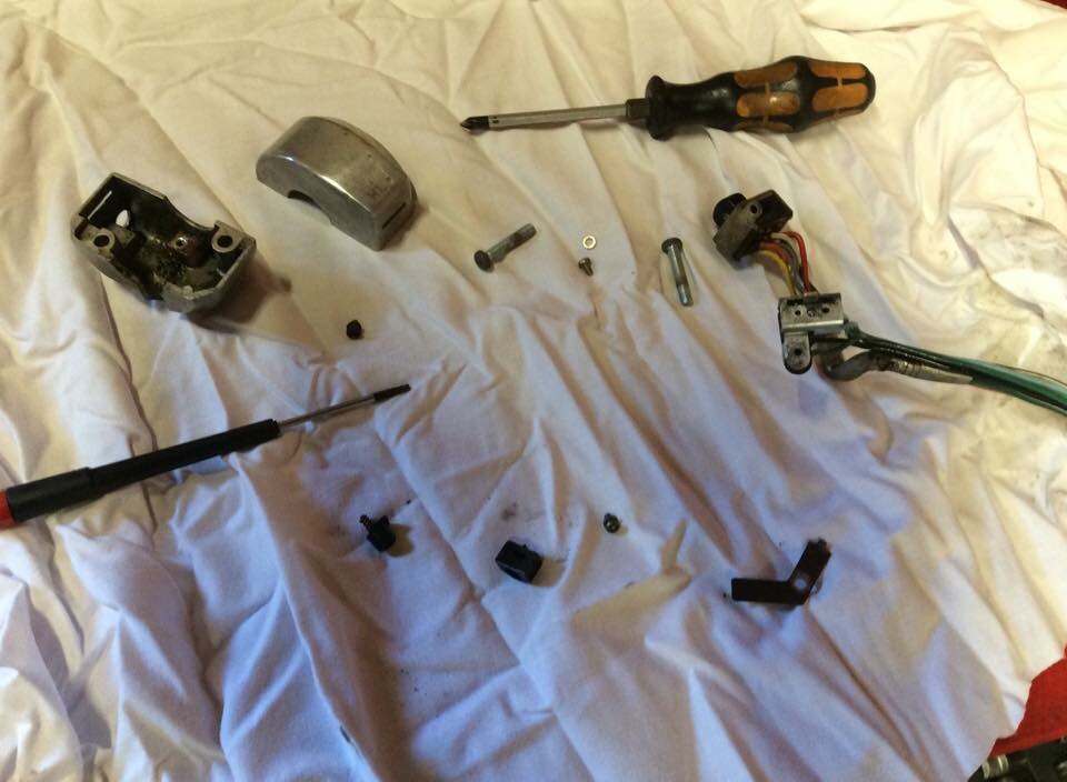

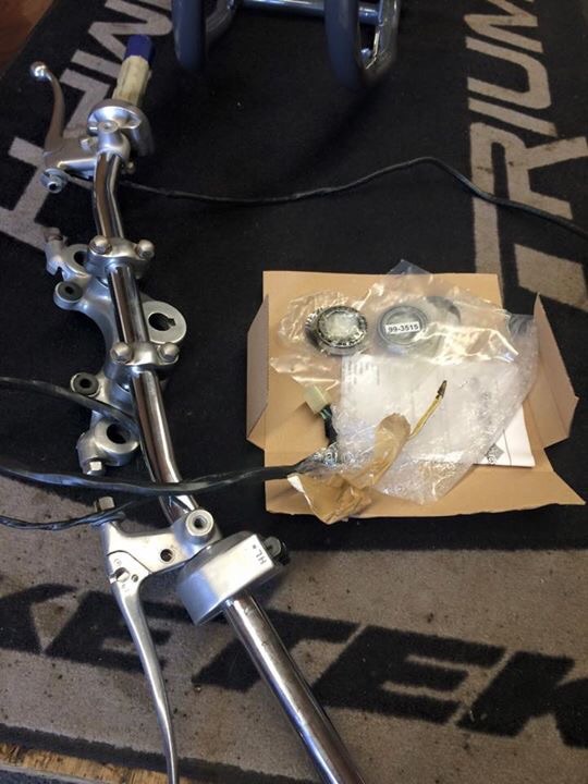

Seized old switch gear. Bit of time cleaning and greasing then a bit old wire wool to polish the top yoke

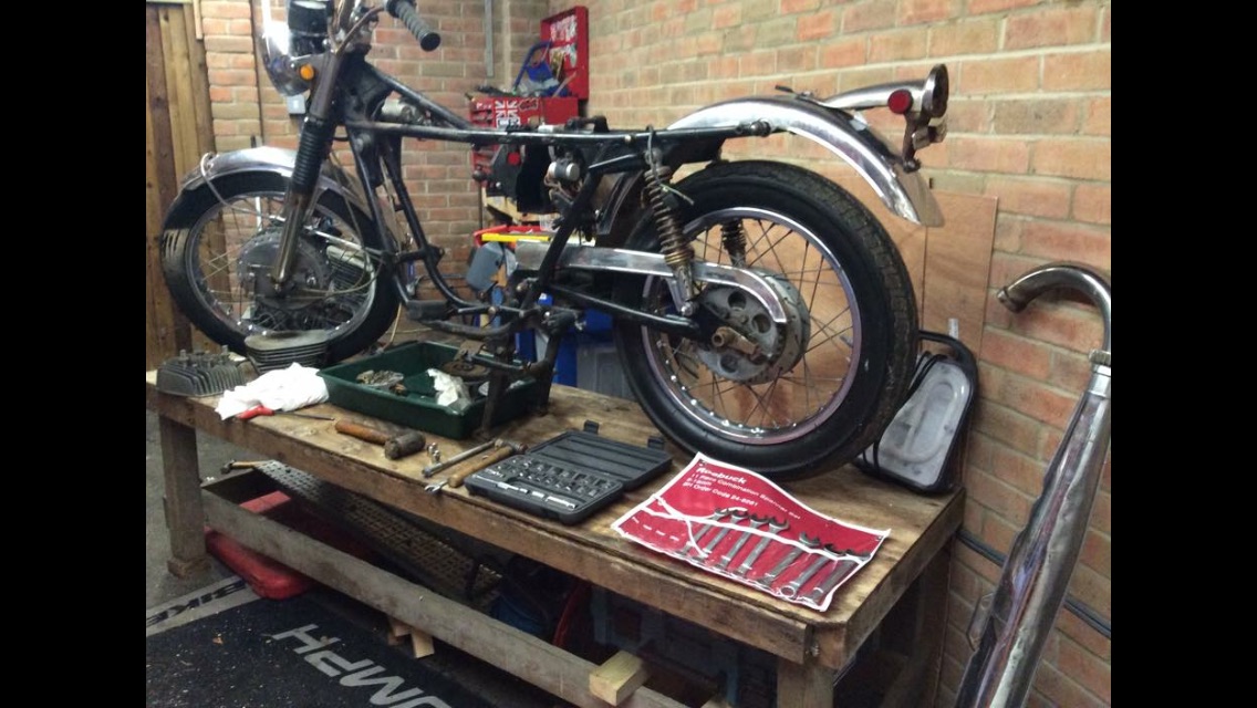

Now the fun bit starts. Bolting shiney bits back on!

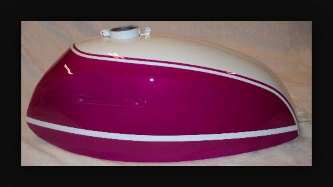

Another one I love. I wish to keep it recognisable as a t500. I think the tank pattern is important but am undecided on colours. Part of me wants to keep it the candy lavender as that was its true identity but I in a way prefer the Orange.... Opinions welcome!
Like this.....? Continuing the theme along the seat unit
I love both the purple and orange metallic but would choose purple being that it was that way stock. Going to be a sweet build and I will be following the progress.
