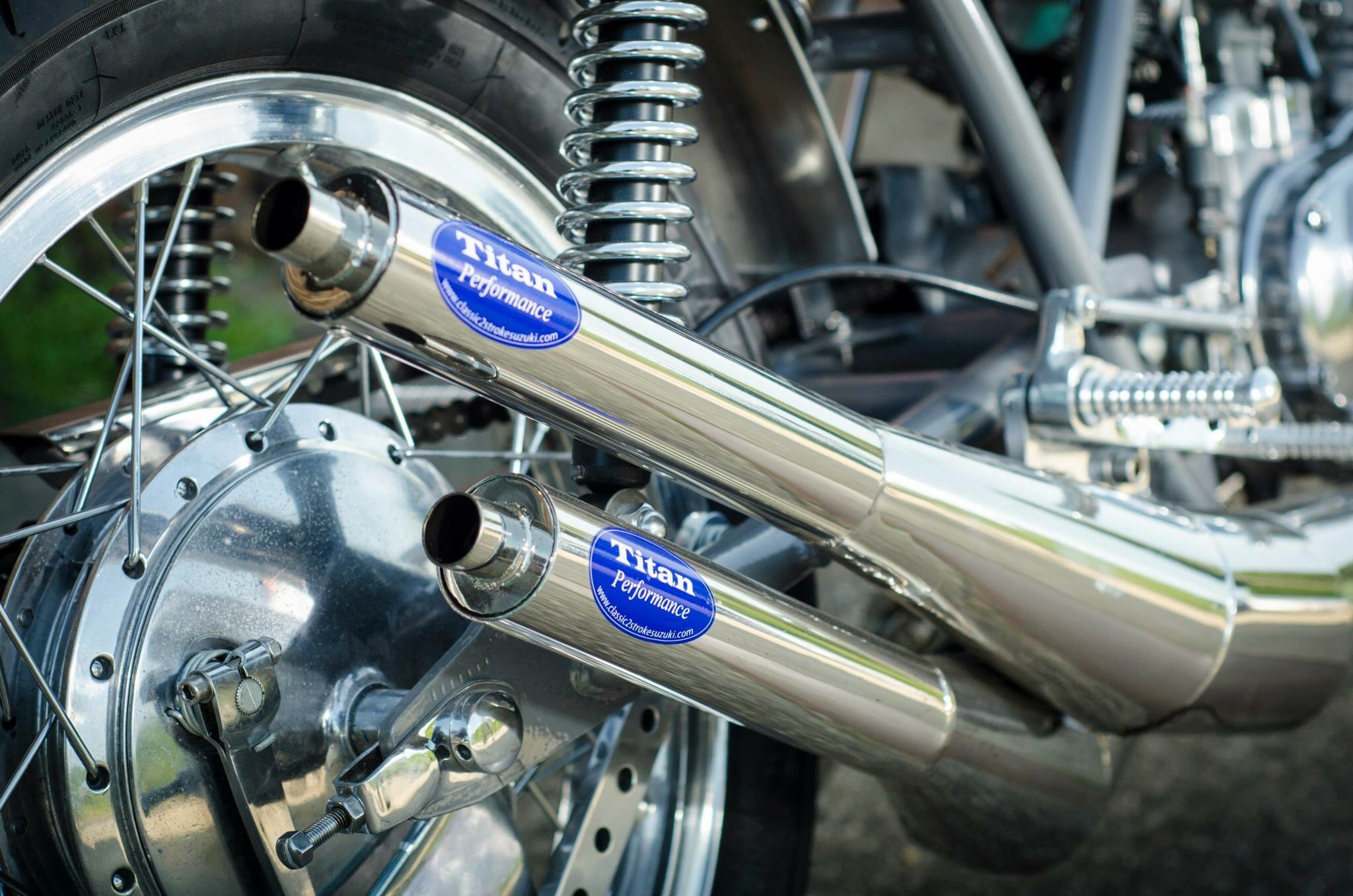

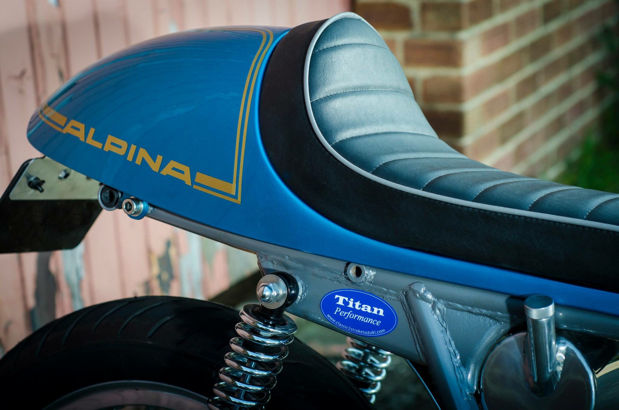

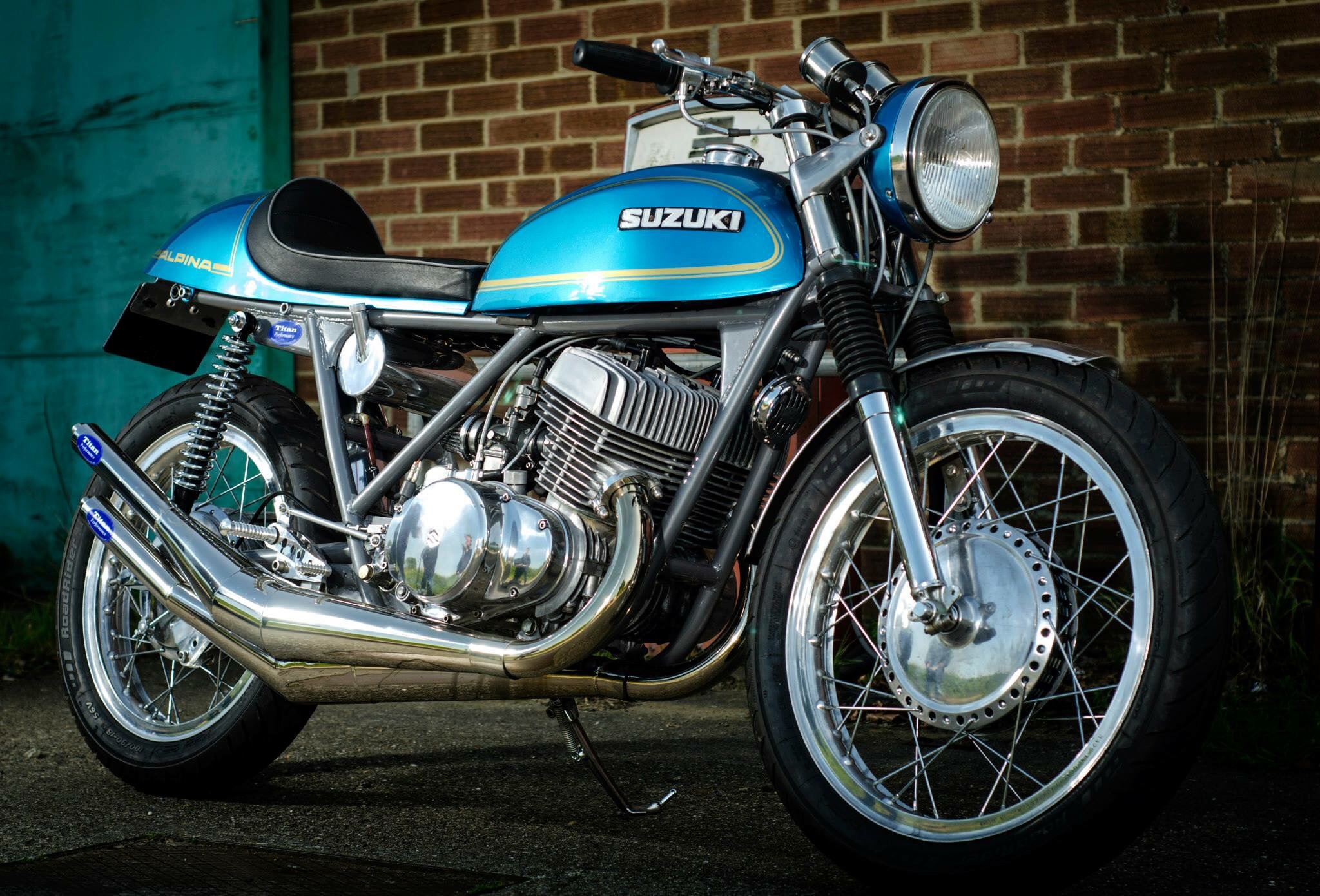

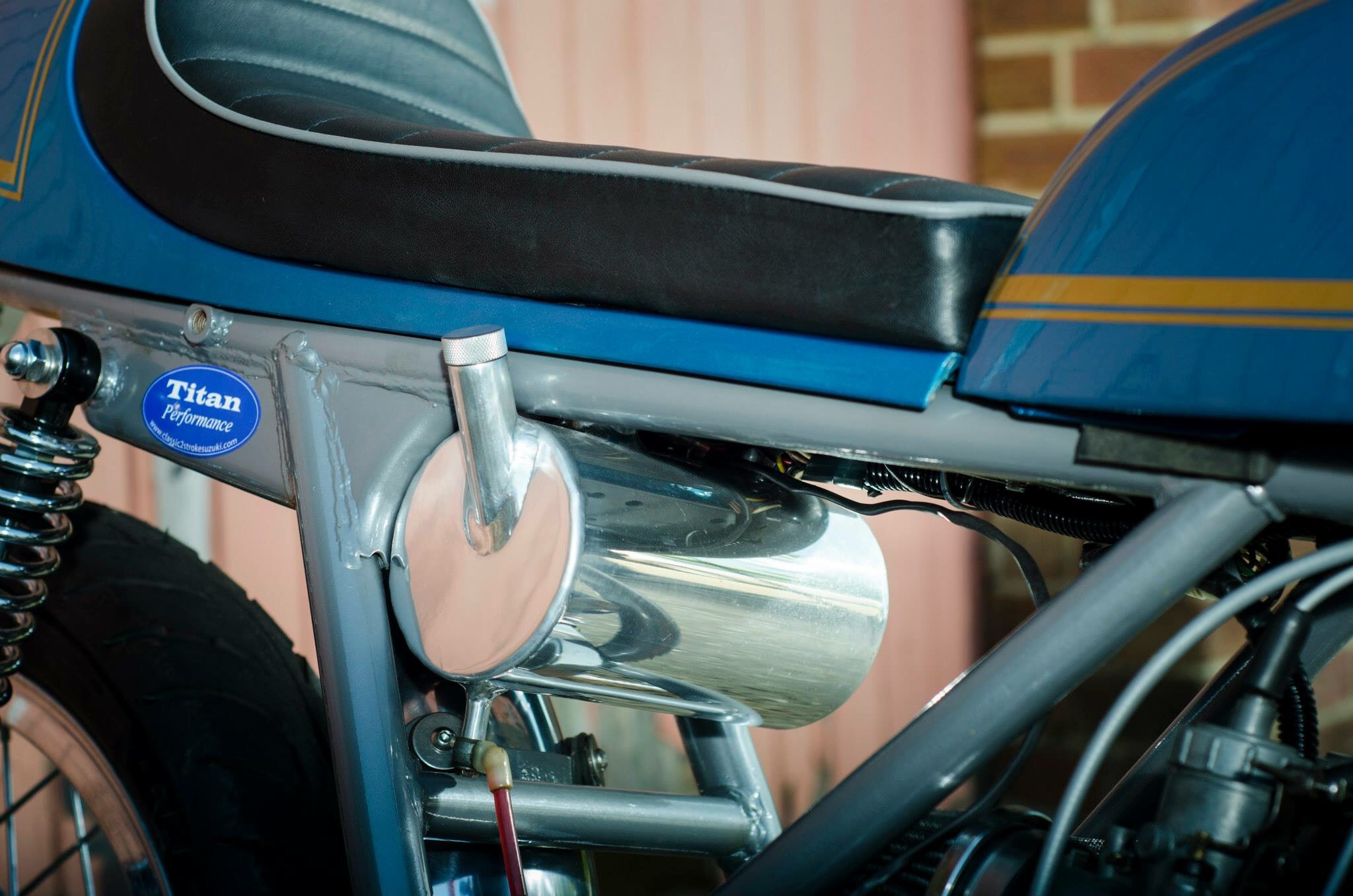

Hi Paul, small world hey.
Here's a few of those pics that got me wanting a T500 in the first place! It's all your fault lol
Anyone thinking of building a T500, don't forger to check out Titan performance website too!
Iam going to get a set of pipes from Paul and Tim when the time comes, probably one upswept pipe each side.

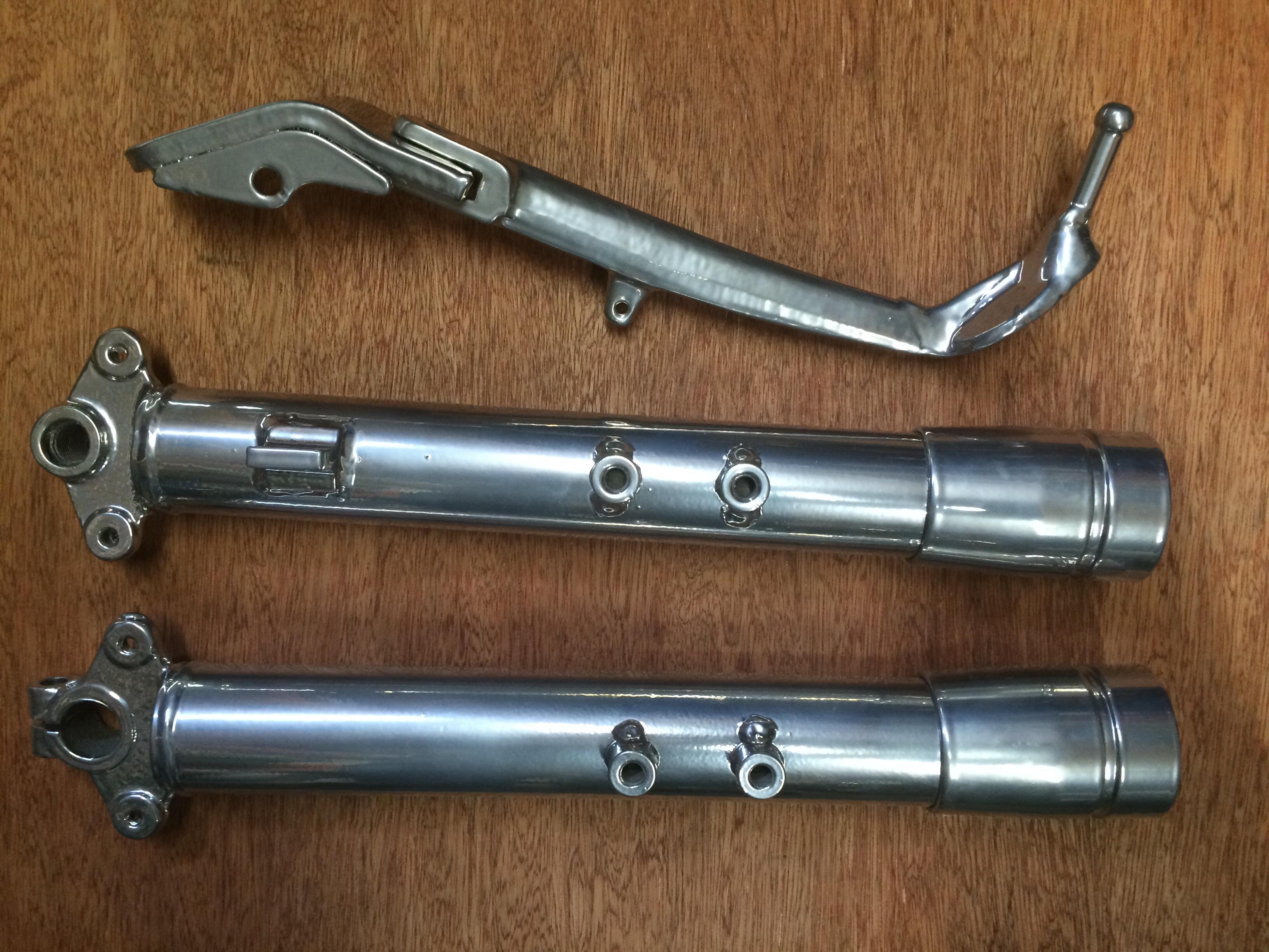

Just picked up some bits I had powder coated chrome. I have never seen this effect before so it was a bit of a gamble as to how well it would come out.
Here are the steel rusty old chrome fork legs before....
Here they are after Dan blasted them and finished them in the chrome powder coat. He also did the side stand and bracket too. Iam very pleased with the result! It is more like a polished Ali effect
One fork done. I managed to damage the new fork seal on the other, doh!

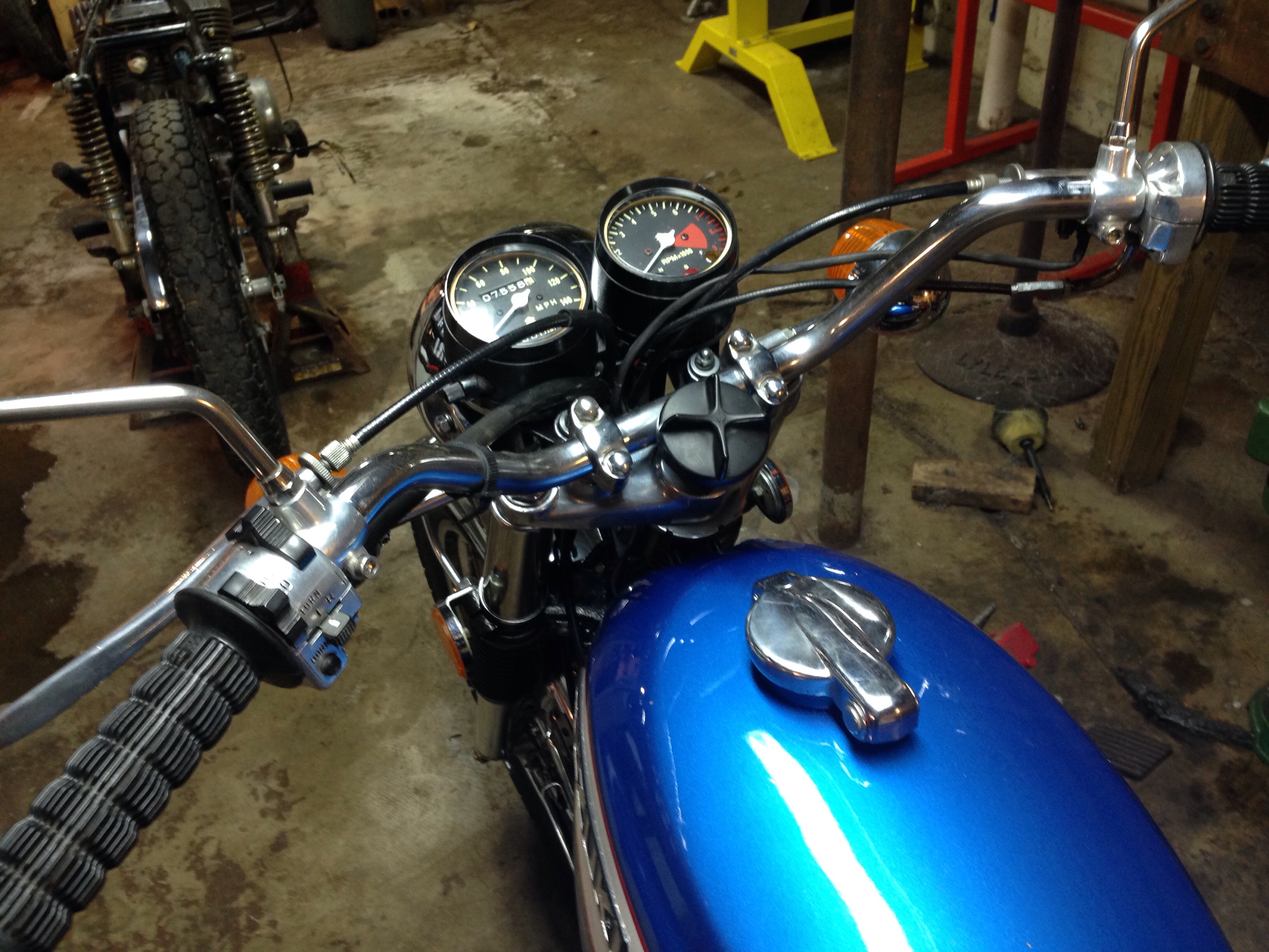

Ok opinions please.... Damper re fitted or not? Are they any good?
I say keep it since you are maintaining the period look of the bike. I bet it works fine, though you can always add a hydraulic version later if you feel it is needed. I am especially partial to these bikes so I am following along - hopefully you will inspire me to get back to work on mine! (project # 637 - too many projects!).
I would also keep the damper, they work ok and the adjusting knob covers up what would be a hole int the stem, so the bike looks better, in my opinion.
I kept mine, your not saving anything by taking it off that front end was designed in the 40's
