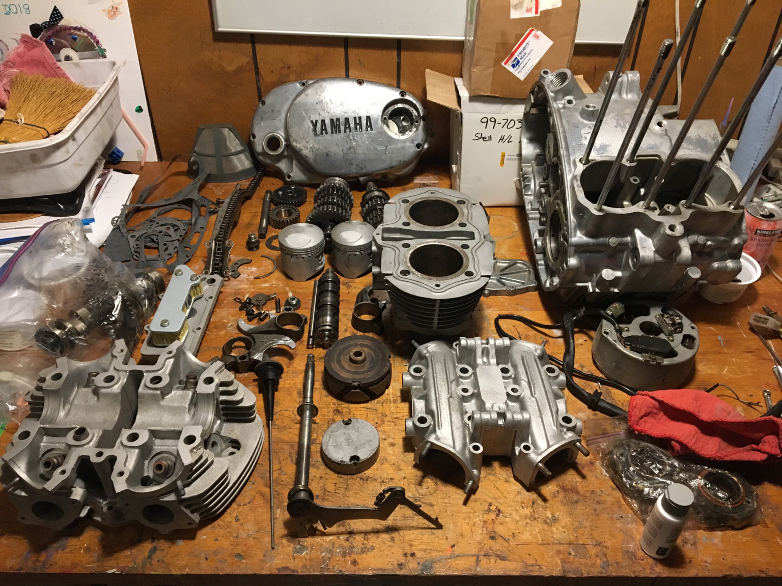

Well, the shit show begins. I’ve apparently become the guy that buys bikes completely disassembled by other guys who can’t put them back together.
Lots of vapor honed parts and it appears as though every bearing, seal and gasket has bee bought for the whole bike.
Pause.
I’ve decided to take this motor and put it back together for an assessment. I assume this was the parts motor, or he bought parts for this motor. I’m not sure. Regardless, before I go and dig in with Legos that may or may not have all the pieces, I prefer to find some known quantifiers.
