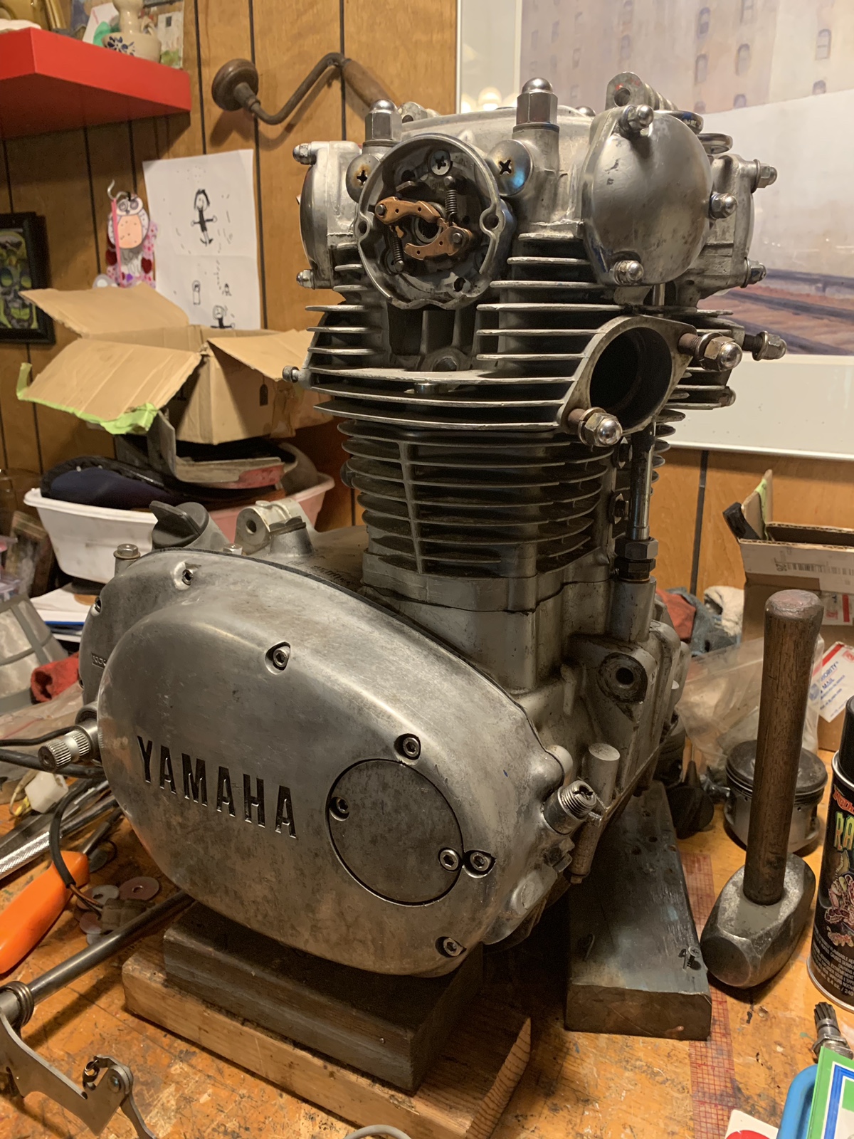

I’ve decided to take this motor and put it back together for an assessment. I assume this was the parts motor, or he bought parts for this motor. I’m not sure. Regardless, before I go and dig in with Legos that may or may not have all the pieces, I prefer to find some known quantifiers.

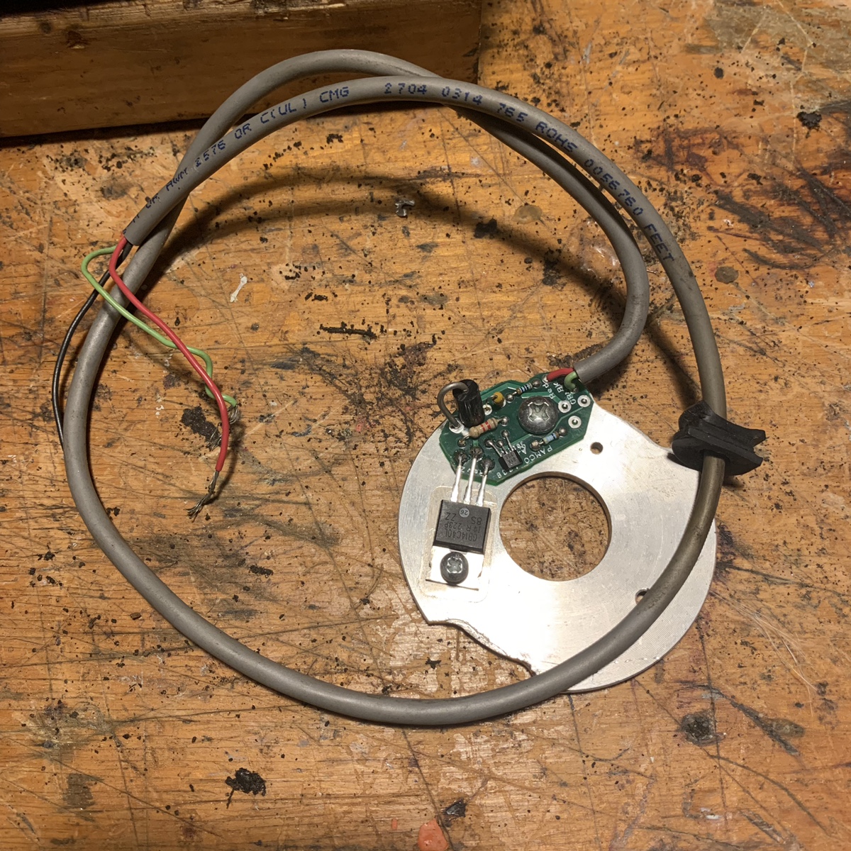

Motor is mostly together, but it’s missing half the components for ignition. No cam, no advance rod, no box for the electronic ignition. I’m thinking I’ll fork out for the XS Charge or Boyer Bransden kits.
Hughes Hand Built has some nice stuff.
I've used his PMA kit on 2 650's. it's not cheap but very nice and does a great job.
He's got a CDI kit with the PMA as well but I haven't run it.
Mike's XS can sell you the advance rod and perhaps a replacement rotor. No black box used for the Pamco system that uses stock advance retard.
