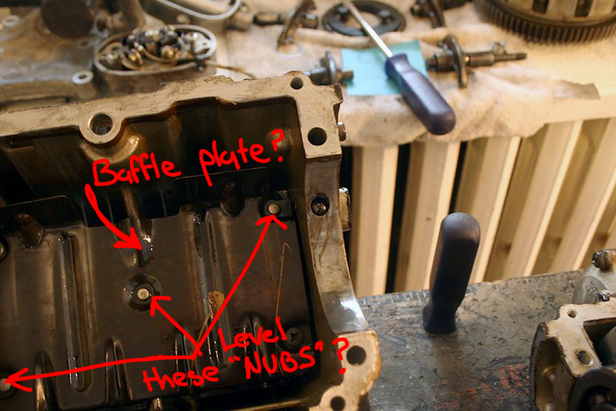

You may want to consider making the baffle plate removable. In stock form, it's bolted and peened to the bottom case half making it difficult to clean out the debris at the bottom of the oil sump. I did this to mine. Level the small nubs then drill and tap the holes for M6 bolts.
Not really necessary though. Assuming any large solids are removed, what's the worst that could happen? Imagine the condition of the bottom of some of the cases of daily riders.
are you talking about this??
that is what i did with mine , i thing i put in 10-24 screws ,it is just a simple detail project that costs nothing and ,makes for feel good,starting out with a spotless interior :)
I figure I would have to level those nubs to get that out! I'm going to try and avoid that and let it soak over night. The engine is actually pretty clean at the bottom so I'm confident I can get it clean under there. If I can't I may take your advice Dr J.. thanks again guys.

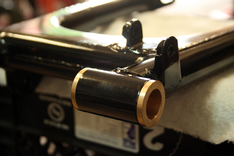

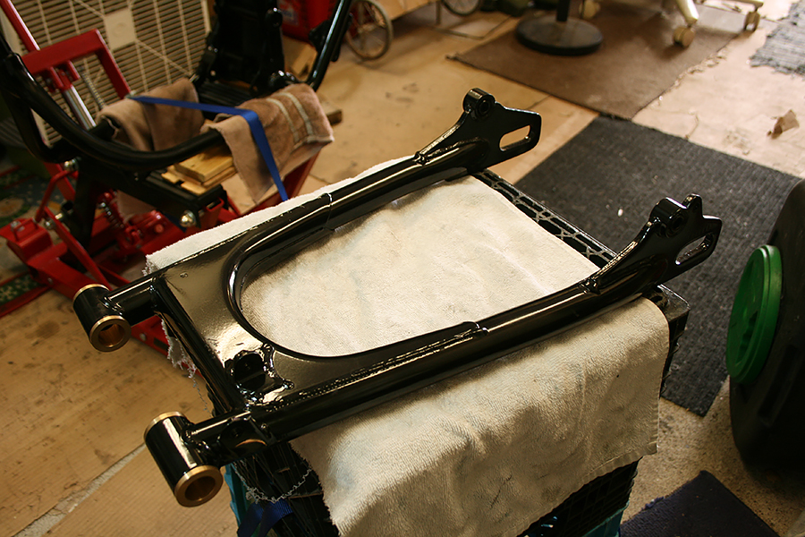

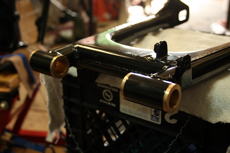

I am going to install my new bronze bushings and collars into the swing arm this Saturday and was wondering about the proper greasing procedure. I've got a plan for squeezing them with an all thread, some washers and nuts and just wondered if you pre-grease the collars and bushings OR pack the grease once fitted OR once fitted, use a grease gun to fill the inside?
Can someone please advise?
Thanks!

you dont really need to worry too much about greasing untill final assembly,a light layer of grease when pressing in is a good thing as is lite greasing on assembly the grease fittings are fine for greasing after assembly
if you go to the likker store that sells dry ice for a few dollers you can get them cold enough to go in by hand

Yeah before you press them in, leave em in the freezer for a day and it'll just be that much easier. The all-threads is probably the best method for that sort of press fitting.

Great advice! Ok thank you.

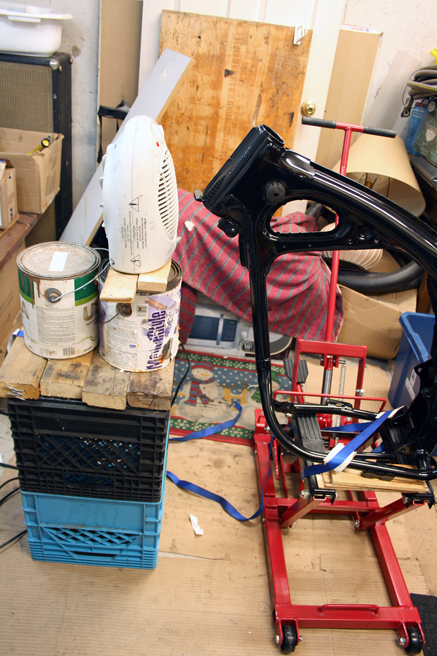

A lot going on and wanted to write an update as to what’s been happening. My laptop died on me! So I am without editing software to finish the next video installment at the moment.
I am still waiting for my top end to come back from Bore Tech.. getting really antsy to start putting that motor back together! Mostly because I don’t want to forget where everything goes! haha I stupidly stripped a screw holding the starter motor in place on the upper crankcase so I will need to tap that and get that out somehow before I send these cases to get vapor blasted. I’m not exactly sure if the starting motor can safely withstand the blasting process or not, maybe someone can advise? I ordered a JIS screw driver but it’s been a damn month and still not shown up! Invest in a JIS screw driver if you want to take this bike apart!! Can’t stress that enough. Don’t be an impatient douche like me!

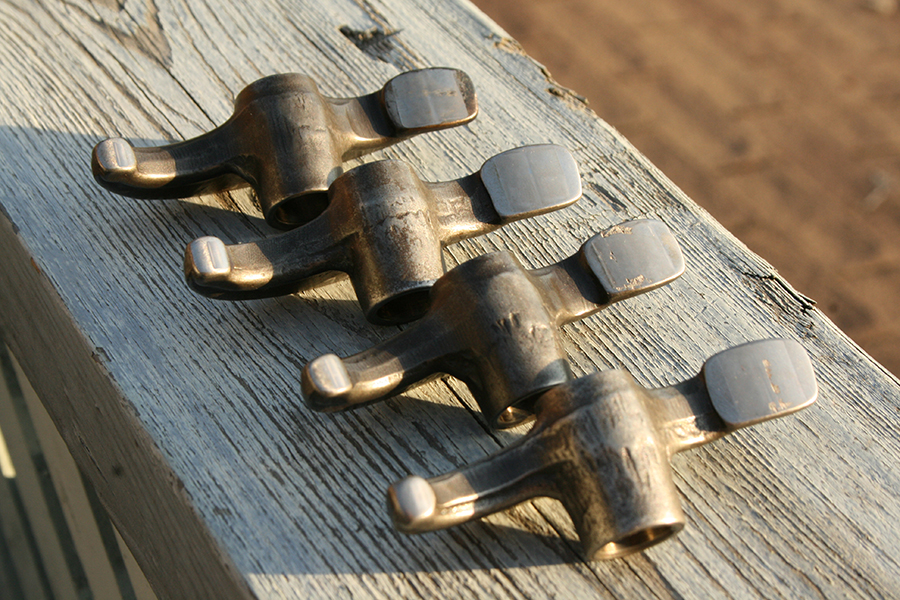

I also realized that since I am getting a hard faced cam it would make sense to hard face my rocker arms also as they were looking a little beat up. I mailed those off to Megacycle Cams about 4 weeks weeks ago and am hoping to get those back this week.

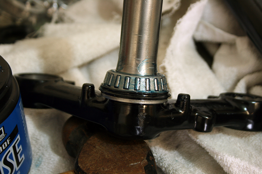

I installed the All Balls tapered steering bearings into the frame and steering stem and will share with you my struggles with that in another post, once I get the video done. I also installed my new bronze bushings into my swing arm using an all thread, some bolts and washers and it worked beautifully. I came to the realization that I needed new dust seals for the swing arm axle bolt, so I am also waiting for those to arrive before I attach everything to the frame. Also on a recommendation from Apex, I would like to upgrade the zerk grease fittings on the swing arm axle bolt before I put all that together, so that’s high on my list.
I also sealed my aluminum engine cases using a product called Shineseal. The whole process took about 3 hrs to do and about 12 hrs drying time. I will also go more into detail about that in a future post.
My new Race Tech springs and fresh fork tubes from Forking by Frank showed up last week! So I will soon rebuild the forks. I am also waiting for my upper triple top to come in from Cognito Moto before I can start putting the front end together, but it’s getting there!
High on my agenda is painting the wheel hubs. I ran into a major wall working on those. My plan was to clear coat them but I realized right before I went to take them that there are rubber bushings in the rear hub! They won’t do well in the baking process that the clear coat requires. My options were to remove them and replace them or leave them in and use a clear coat from a spray can.. I decided on taking the can route! I looked up how to remove them and started the process but I knew it would be a huge pain in the butt and I would damage them significantly. I tried looking up replacements online before I went ahead with that and they were pretty hard to find. I did eventually find them for about $17 US a piece (4 in total). PLUS shipping & import charges which I am finding out recently are quite significant! Also the little pieces behind the bushing that seal the inner hub are literally not findable.. I scoured the interwebs!! But to no avail. I called my friend Rob for some advice and he said to look for a spray clear coat for Mag Wheels. Sure enough I found this stuff, did some research on the results and was very satisfied. So I bought a few cans and I will spray these hubs soon, install the new bearings and brakes and get these darn wheels built! I am very excited to see the Buchanan rims and spokes come together on these hubs!
Lots going on and will post that video as soon as I get my laptop fixed. Back to work!

Just a quick update. After an 8 week wait, I have received a big ass goody box from the fine folks at Bore Tech. I will update with pics and video later. I clear coated the hubs last week with "Dupli-Color Clear Coat for Wheels" and was NOT very impressed with the results at all. It said in the instructions to leave it for 7 days to cure, so tomorrow I'll go back to the workshop to check it out. I am hoping that the paint will have settled and become shiny over time.. if not I am afraid to say that I will be buffing these parts out again! Probably.. we'll see. If I know myself that is probably what is going to happen. If they look good I plan on installing the bearings and lacing up the wheels.
