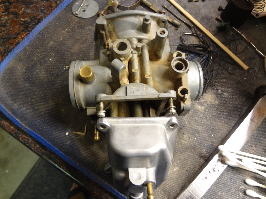

I received my K&L Carb rebuild kit today. I am wondering how to go about removing this brass piece on the left. Is this the seat that holds the needle? Im wondering what the jet or ? On the right does. Should it be removed to be cleaned? Thankyou
Yes, they both need to come out
Neither of them are needle jets.

How do I get the darn things out? I am wondering if the one on the left is the seat? Does it have an o-ring around it? It should pull right out correct? Pliers should work, I'm throwing it out in place of the new one. The other only has a small hole so im not sure what to use. I do not have a manual but it seems as if now would be the time to find one.lol thank you
left is seat for shut off valve.
right is primary main jet discharge tube
You remove slide and push out from top using a chopstick or similar. Using a screwdriver will damage it
Holy hell batman! The seat wouldn't budge. I said the heck with it and grabbed a pliers and it still wouldn't come out. I decided to get a tap that was the correct size and hold the sides with a pliers. I made a few turns with the tap so it was screwed in fairly well. I grabbed the end of the tap with a linesmans pliers and gave the pliers a couple of small taps with a hammer and it finally came out. To be honest I was getting desperate. The seat would turn but I couldn't get a good enough grip to pull on it. I tried the chopstick trick with the primary discharge and ended up shoving the shaft right through the chopstick twice. I kept trimming back the chopstick and trying it over and over and it finally went. Now to get the chopstick out of it. lol That was a good way to spend a couple of hours. At this rate I should have it going by spring. Geez!!!

Yep, that's the way I remove shut off valve seats ;D

Primary tubes can be a lot tighter than that, it's barely oxidised at all compared to some I've done :o
