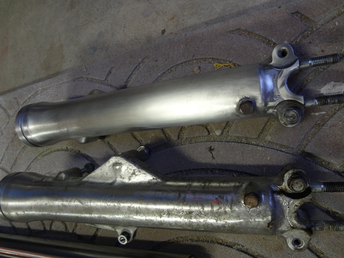

That thing was a pain! Is this bolt stainless steel? I kind of buggered one of them up taking it out by hand. I moved along and started sanding my lower forks. Now Im not sure if I want to go painted or polished. Heres after 400 grit. Man what a difference. Now for another 2 hours on the other side. lol

I like the polished. My concern would be rust. Can you cover it with something like a lacquer or clear coat?
Damian.
Clear coat can help, but I think your best bet with aluminum is just to polish it every couple of months.
True. I grew up in a body shop as a kid. There are lots of different paints and they all have their place. I have a friend that just cleared his polished forks with urethane. I haven't talked with him about it but last time I seen the forks the urethane seemed to be holding up. I was wondering if clear powder coating would work over bare aluminum. Anyone try it?
Still trying to figure out what I want to do with the fork lowers. I have a paint job in mind but how can a guy beat polished aluminum?

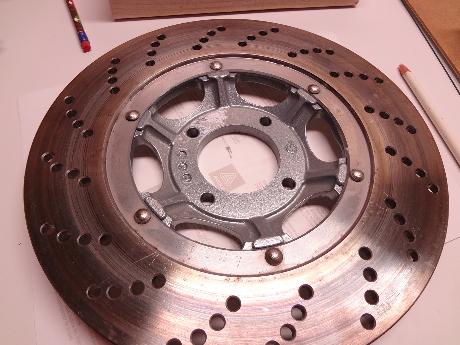

I had some time yesterday to get some paint on the fork tubes, back part of the headlight, and also went ahead and painted the rotor center. I found out the Epoxy primer I sprayed cant set for more than about 36 Hrs. before topcoating. I had to go back and sand my fork tubes, respray the primer, topcoat and clear. What a pita. Because I wanted these few parts to match with the tank, I had to go this route.

Im sorta puzzled...why go to all the trouble of painting the fork lowers?....Silver? why not simply polish em up and call em done? Even a half assed polish looks decent and would been like 10 minutes. total.
^Heeeelllllllooooo? I had to edit to add letters to express sarcacsm to proper grammar to
I had them polished and didn't like it. The only thing I would have done different would have been to polish them and then do the brushed look over it. I decided to paint them because I had some extra silver laying around and thought it would be a good color to paint the rest of the bike. Its also basecoat clear coat so it should last for quite a while too. I may change the rotor center to black or red but I want to get the rest painted to see if changes will be in order. At this point get the bike to a rideable, moveable state is my main concern. This winter will be my play time. Now Im hoping to find some Stainless spokes, drag bars/ cheap clip ons, and pipes.
