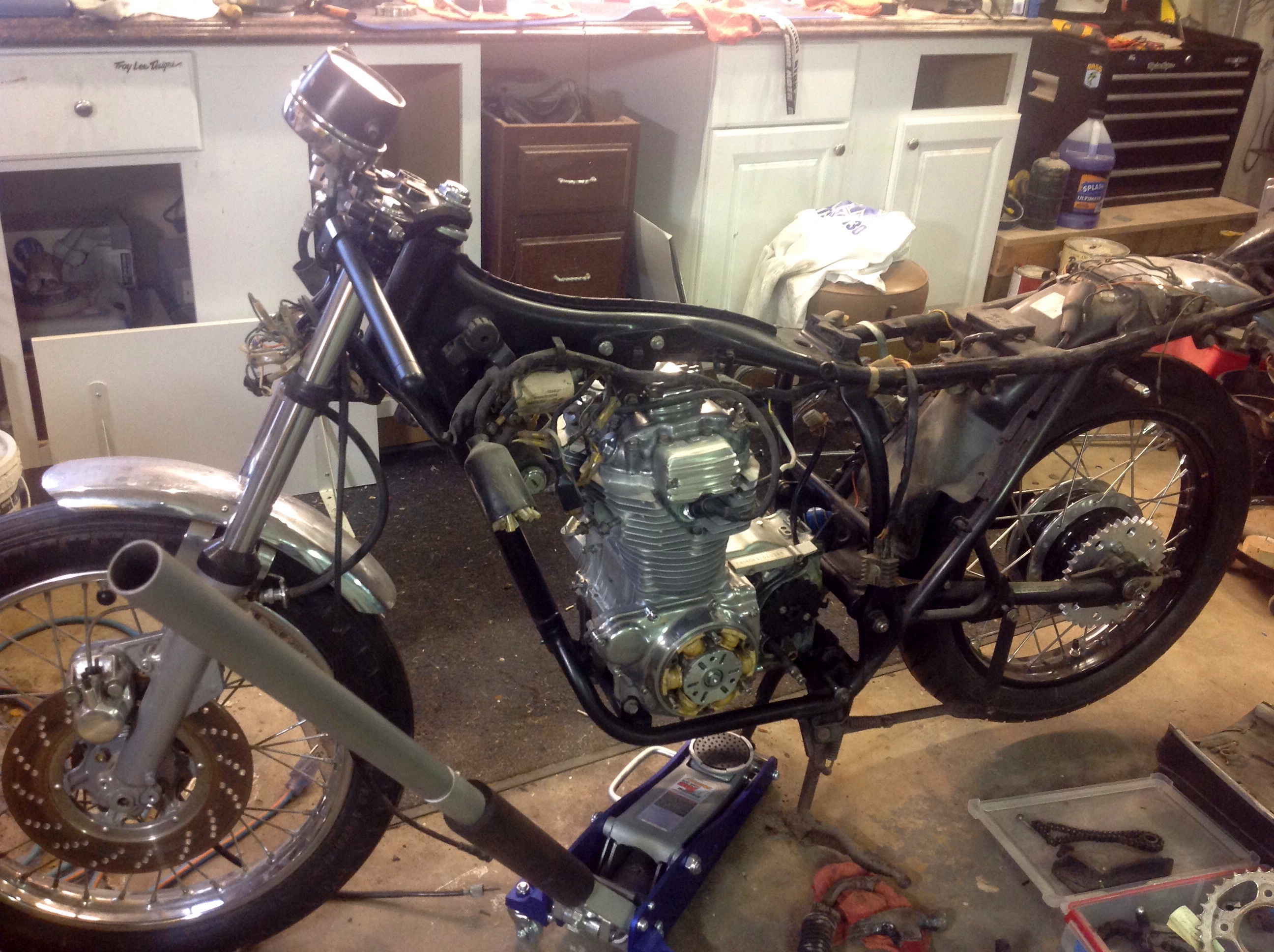

Forgot to post a pick of the progress.
Re: 1974 CB360 "Pickled"
I used some new coils meant for a yamaha xj650 I think? It's in my build thread, give me a minute. They were $28 for both and they mount in the stock location using the stock hardware.
