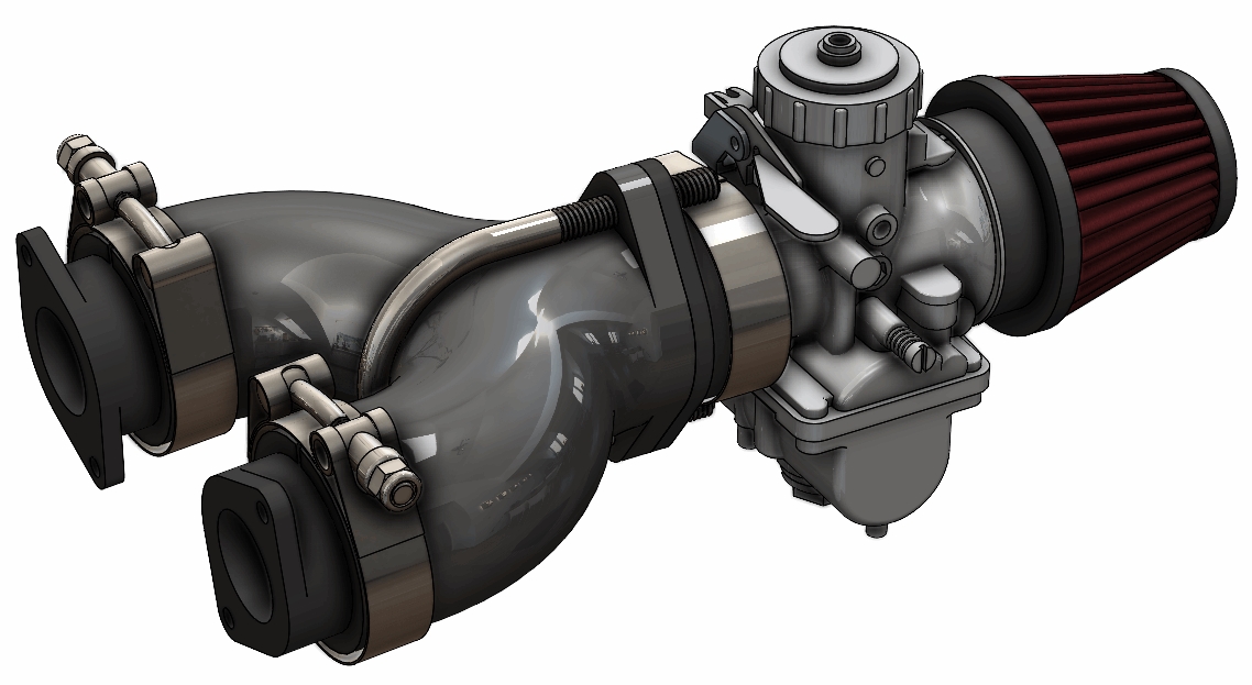

It is tempting. But I can imagine it would take a lot of trial and error to get it to run right (assuming you pick the right carb size to begin with.
Speaking of size, 2x the area of a 28mm circle is 40mm. However, even though the volume of air would be the same, the vacuum signal would be different because of the alternating intake pulses. This is why I was thinkin the TM36-68 might be the right size. However, this carb is generally run on larger displacement (500cc plus). Like I said, a bit of a guess.
I collect cheap VMs from swap meets and Ebay, or buy bodies from either place. I have tackle boxes full of the various parts. Combine parts on hand with whatever is missing from Niche or Jets R US usually gets me a good VM built and tuned for under $100. If I'm going single VM, I'd probably put a 34 on it. I think the 36 would be too big. I put 28s on my 360s with stock bore and 32s on the 385. I run a single 38 on my 79 XR500 (bored 530) engine. Twin 34s on CB750s. If PJ chimes in, he'll tell you he doesn't like the VM on this bike.

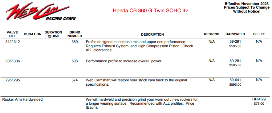

For the sake of posterity, here are the cam specs for Megacycle compared to the OEM Honda 360 cam as measured by Megacycle: (https://www.megacyclecams.com/):
Valve to piston clearance on the Megacycle cam is:
Intake - .043
Exhaust - .047
Cost for regrind on your cam is $500.
They intend to have the factory cam specs in their catalog, but they are way behind on updating their catalog.
Barbara was very chatty and helpful. A couple other recommendations from her:
1. In any motorcycle, run only Motul or Valvoline VR1 oil, but only use the Valvoline on dry clutch bikes.
2. Honda 360 rockers are notorious for being worn through. They will clean them up and re-plate the wear surface for $100/rocker.
3. If you need a 360 cam she thought there were a few in the shop that could be reworked.

Web cams can do custom grinds for less than mega cycle. When i had a custom cam ground a several years ago it was $150 cheaper

I'll eat Humble Pie if I'm wrong, but isn't the CB360 a 180 degree crank engine? If so, through personal experience and then reading up on it later, single-carb set-ups on 180 degree twins don't work too well due to both cylinders pulling one right after the other? Again- my apologies if this is in error.
It isn't that I don't like VM's on 360's just that I haven't spent enough time with them to get carburation right for most.
The ones sold as 'set up' don't have correct emulsion tubes or slides as they are 'too expensive' for re-sellers to swap out (around $100+ for parts, haven't seen guy making custom emulsion tubes @$48.00 + shipping on eBay for several years)
I have a modified set off early Suzuki (piston port)
I made new emulsion tubes for (then broke mini mill controller board) that work very well of my XS650~800 even if they are a bit small. I haven't made any since then as new mill/drill doesn't spin fast enough for 0.80mm drill bits.
I fitted Yamaha RD 400 to my CJ'400' as they are set up for a 'four stroke' motor (due to reed valves giving different signal compared to piston port)
Even with 26mm VM the CJ was good for about 120mph.
360 is a 180 crank so there are two firing impulses very close together then a lag before it happens again.
Personally, I wouldn't even entertain the idea of single carb on one, original CV is fine and can be modified for K&N or Uni filters (cheap pods are restrictive over 5~6,000rpm).
