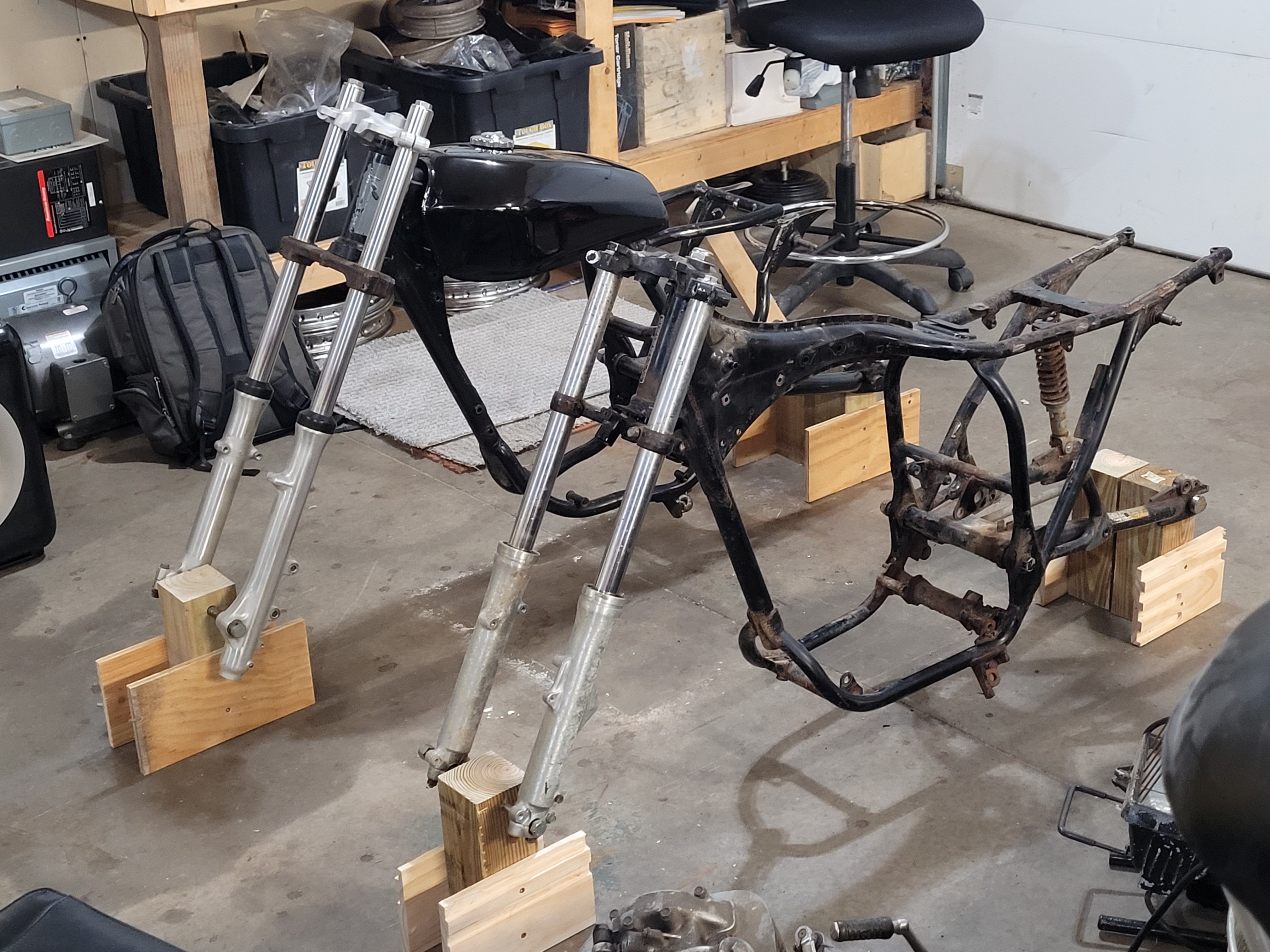

1974 Honda CL360 barn find

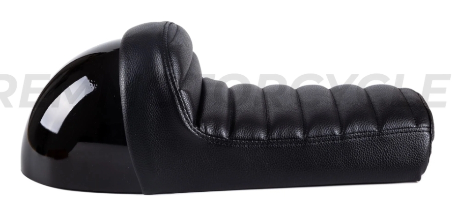

Seat has been ordered from REM Motorcycle (in France?). I have having it custom painted in "Traffic Red" and will have the black material and stitching. The bottom edge of the back of the seat is flat, but I'm going to see about trimming it so that it matches the upturn (25*?) of the RC174. Having a hard time finding seat loops that are 205mm wide. They are out there, but they aren't the cheap ones. I'm inclined to avoid lighted loops, preferring to put the signal lights on the top of the shocks. Maybe mount the brake light under the seat.

Oh, if you haven't painted frame yet and are going to change carbs this frame mod is worthwhile even though frame analysis shows steering head is weak point I know this is where flexing actually starts (paint flakes off and frame goes rusty)
it can't be used with stock air box and battery box though.
I weld in a 2x1 box section
Thanks for the tip on the frame. I have cut off unnecessary tabs, but I haven't yet prepped it for paint. I am definitely interested in strengthening the weak points.

That tail section/seat is pretty nice man
I hope so. Retail was $90 + $90 for custom paint. You can see some bad orange peel in the reflection on the stock picture above. I expect my custom painted "traffic red" to have better attention to detail.
