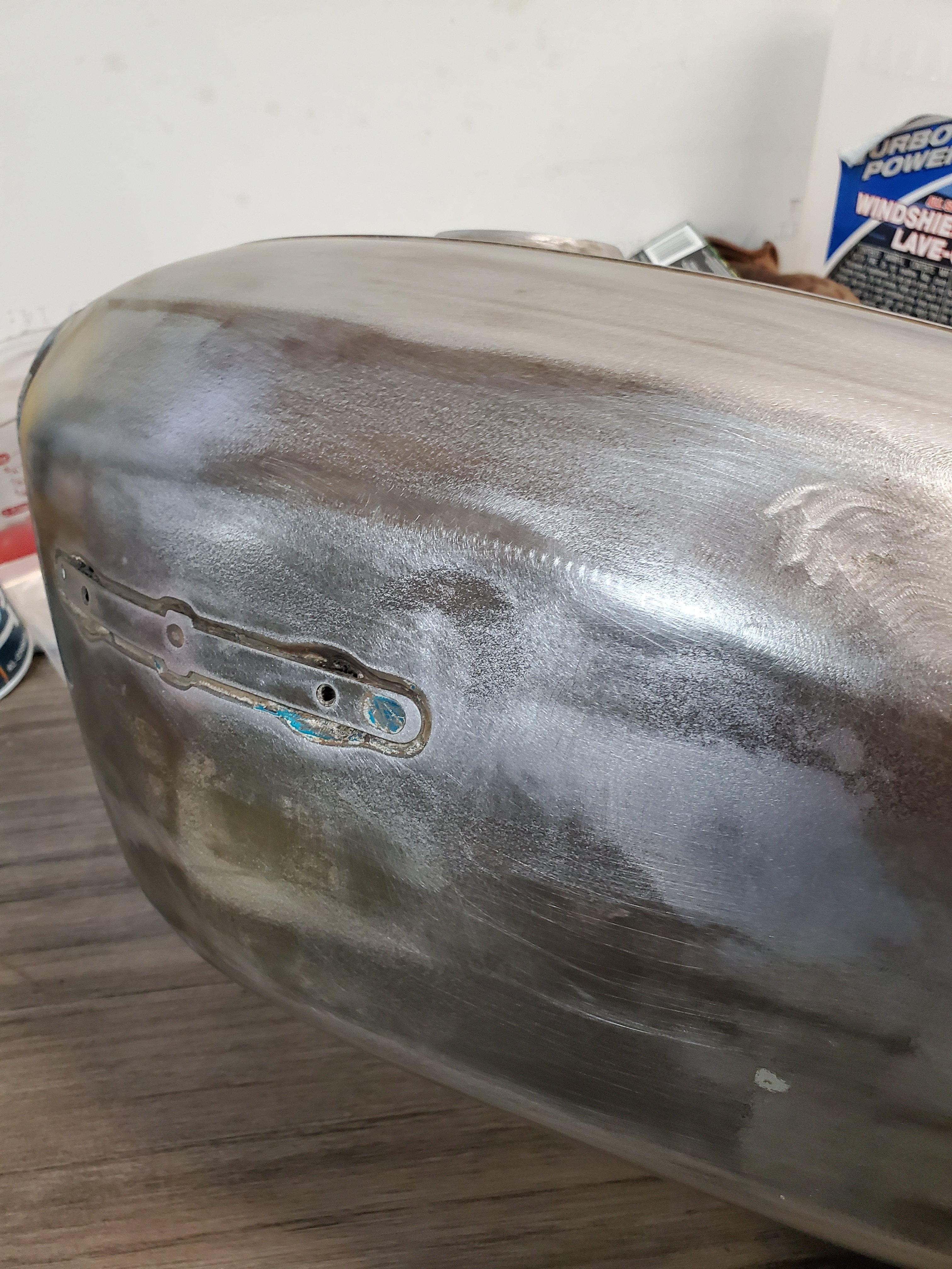

Sanding and fixing tank

Larger dent needs another coat. Small ones are all smooth except for one I'll put a touch of spot putty for a few little pin holes in the filler.

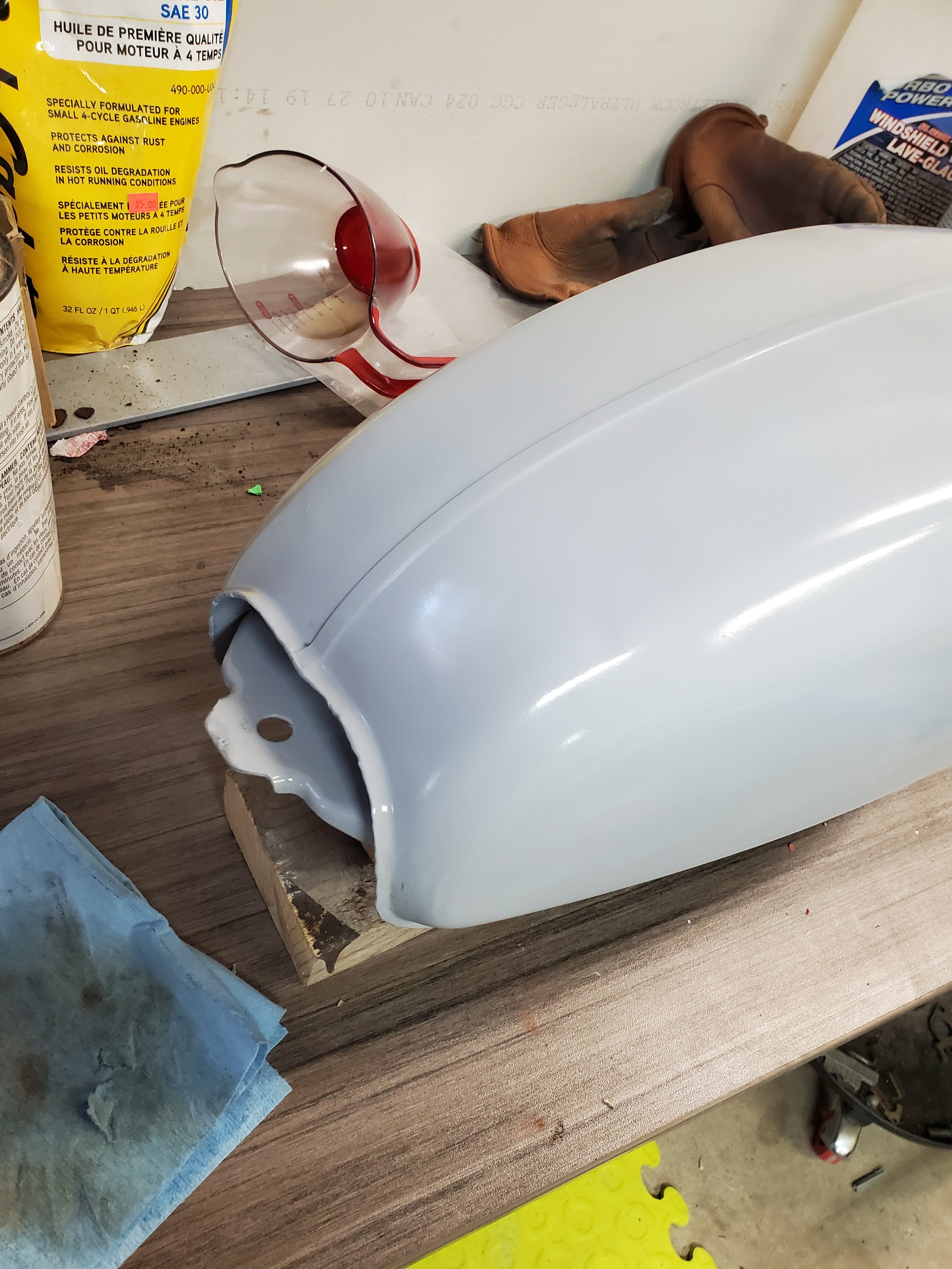

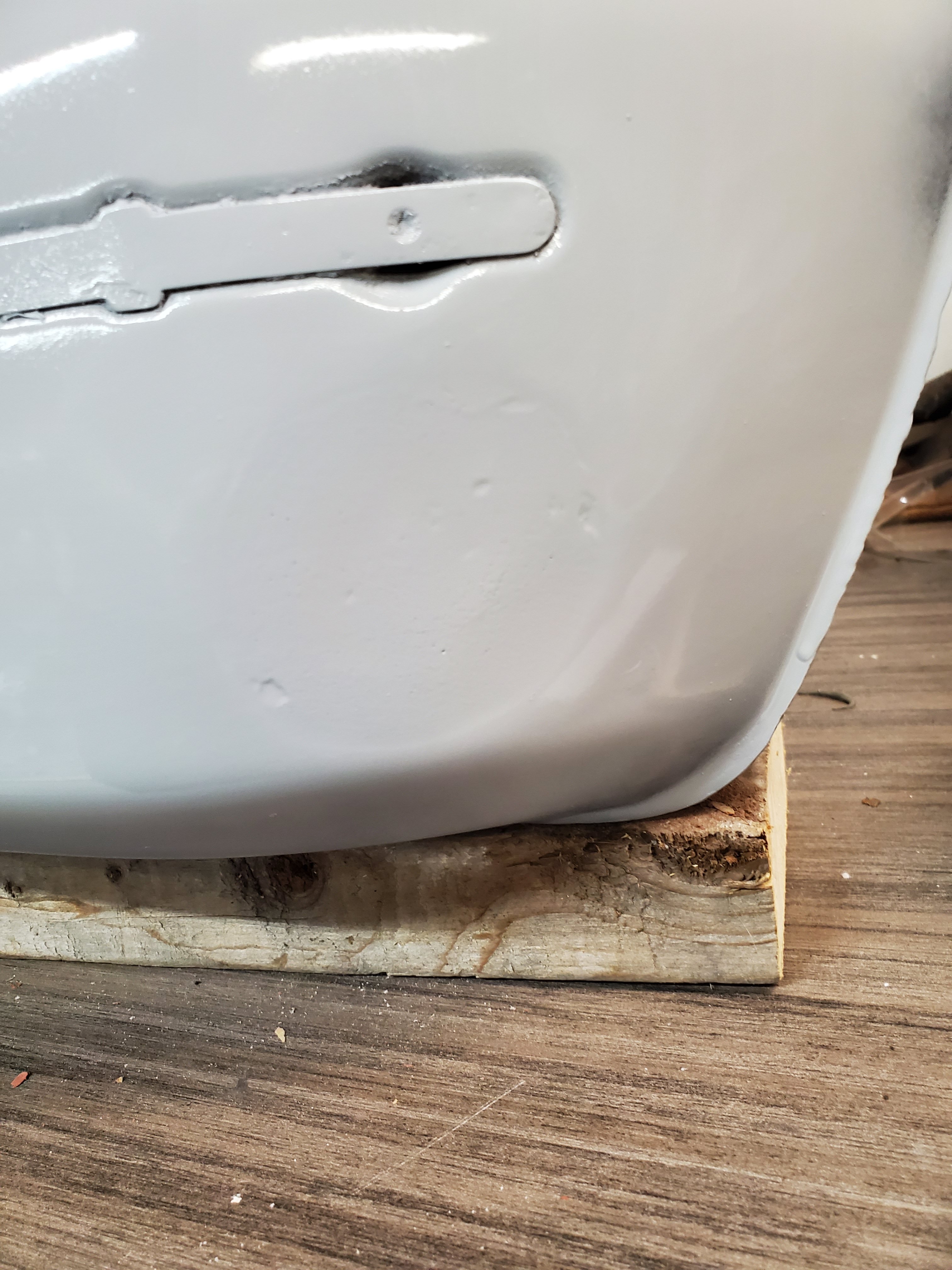

Was able to get a glide coat. Pin holes in the large dent the rest dissappeared. My spot putty is bad so need some new.
