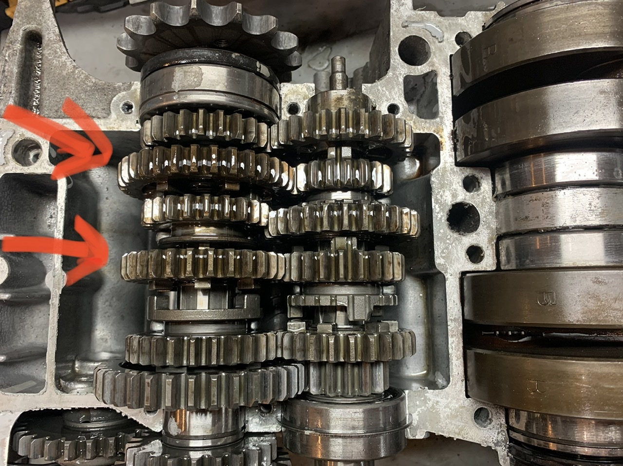

It’s been a blast to ride, except I spun something in the transmission. Any guesses before I pull the motor? Still does everything it’s supposed to, but with lots of noise.
May have isolated the issue to the main axle that holds the clutch basket, without pulling the motor. Still diagnosing, but I can spin that shaft with my hand and get the sound pretty quick and easy. Possible bearing, I would think.
Good news is that it's not hard to fix. bad news is that the motor has to come out and be stripped. It does sound like the double row bearing has collapsed or the inner cage is split, but it has to come apart to change it and to see what's wrong.
I added a video since you replied. No doubt I am pulling it apart. Does a change when shifting isolate even further? Just curious before I drop it.
I hope it’s really this simple, but two gears were dry as a bone. Not sure if various models or years have different dipsticks to make me read my levels wrong, if I’m stupid or if I lost oil somewhere. Nor can I think of any reason this happens besides low oil. The gears just lay in a pool of oil. Can’t think of why this was just two gears.
Slathered it in oil and everything got quiet. Not the end of the world pulling the motor. I get to check over everything. A better clutch is on the way. After chatting with another fella on Facebook who LC'd his engine, I am going to relocate the coolant pump to under the reed boxes. I can always go back to an oil pump now, if I want.
Proper, measured quantity of gear oil in my RD400c indicates WAY over-fill on the dipstick. I'm staying with measured quantity, but if it were the other way around, would use the dipstick. I would expect clutch problems before gear damage if they were installed with a good slosh of oil on them.
With the dipstick, don't screw it in to check oil level, just rest it on the case. It's hard to tell from the picture and video but some of the dogs look to be worn. Run it through the gears with the cases open and see if you can better determine the source of the noise. If a shift fork is bent, it might be pushing too hard against one or two gears. If the shift forks are OK, you may still have to shim the gears to get the right amount of clearance between each gear. In other words, if it tries to "over ingage" a gear it will make noise. There should always be a small amount of free play.
I had an RD400 years ago that was slightly low on trans oil and it made a similar noise but nowhere near as bad as that. And as PID says a little too much oil is a safer place that too little.
