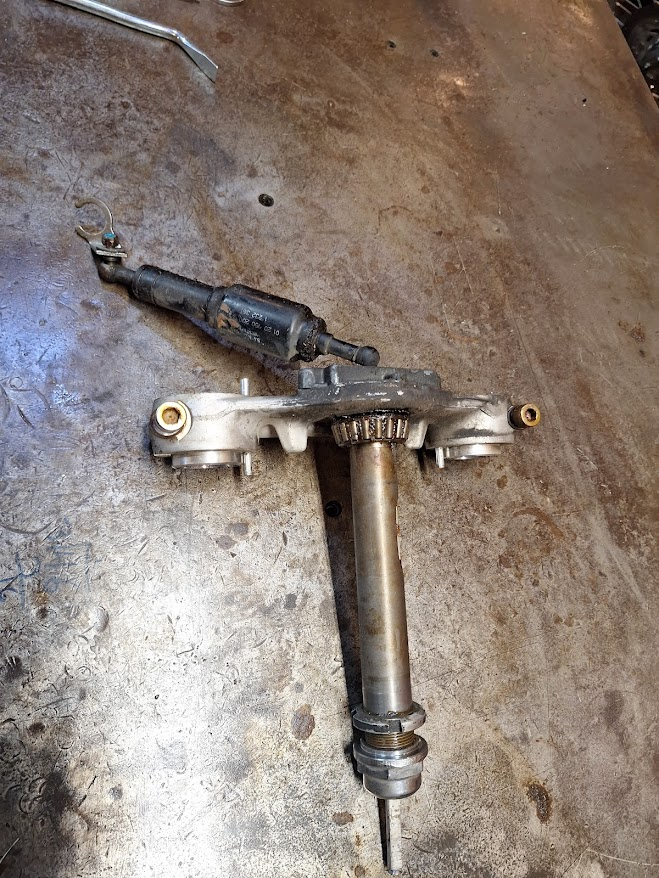

Back to tinkering on the airhead. Whittled a factory r90/6 bottom triple into a top triple. Mounted a set of euro bend /2 bars to them with modified factory bar mounts. This should stiffen up the front end a good bit over the factory stamped steel top, as well as looking way better. This will run in conjunction with a Telefix fork brace and a fresh set of progressive springs.

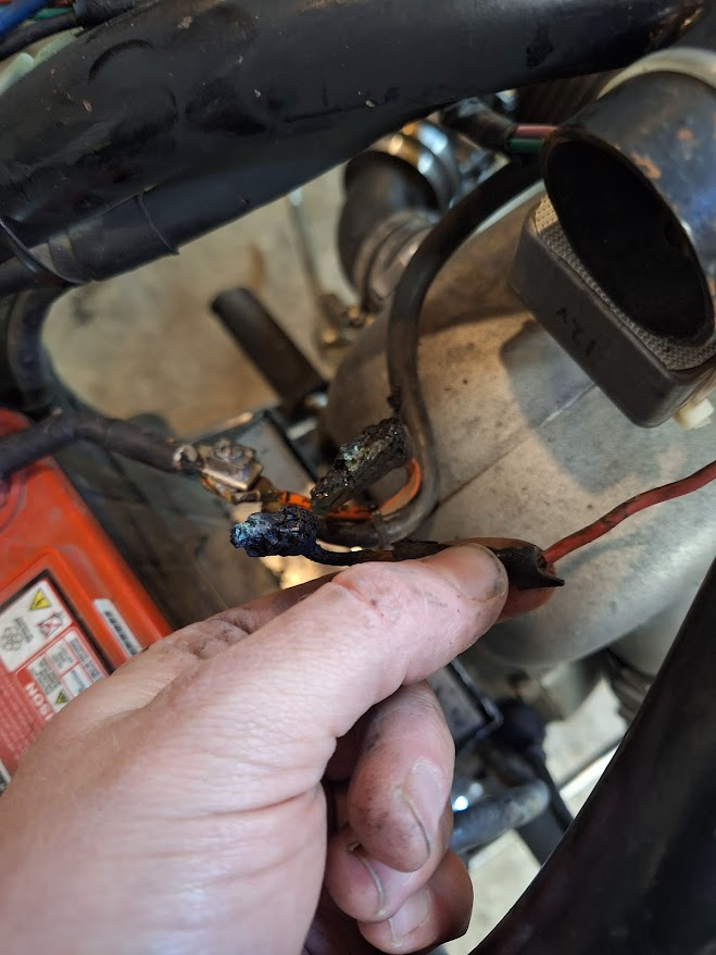

During my last ride at the end of the fall, the wiring harness turned british and let all the magic smoke out. Im guessing it was either a short that sent all the starter juice through the small charge wire, or a bad regulator.
Either way, this kit from Euro MotoElectrics is on its way..

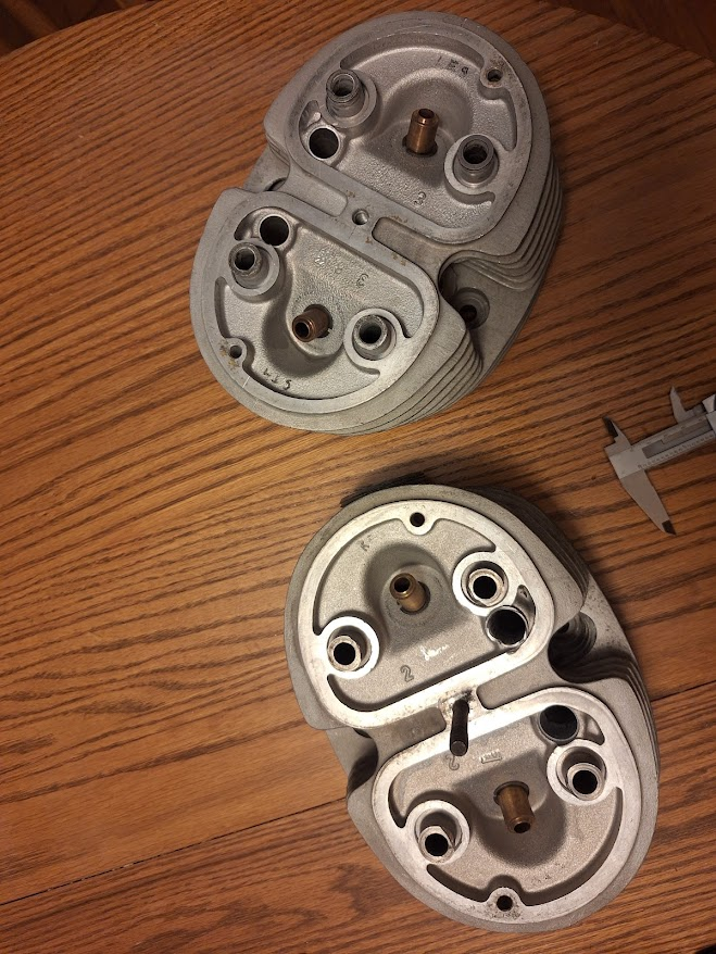

Its pretty much a complete charging and ignition upgrade, with a 450 watt lithium battery safe alternator, electronic ignition, r/r that replaces factory diode board and upgraded starter and coils. My order will be a bit different, as im using dual lead coils which will work with these dual plugged and ported r90s heads that I picked up recently.
The heads are at the machine shop as we speak getting fresh valves, valve guides and seats re ground.

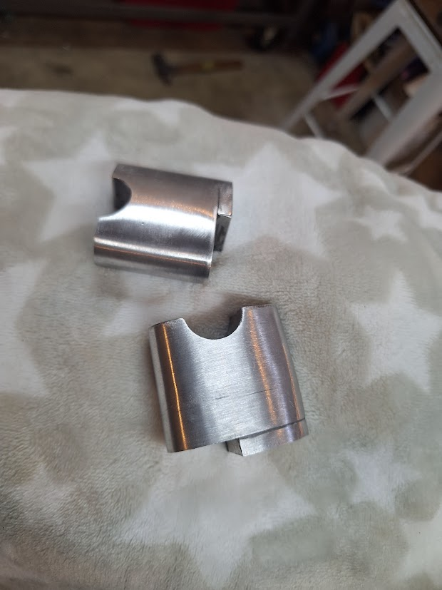

To fit these bars and keep the ability to service fork oil without disassembling half of the front end, I had to modify the stock risers. I epoxied 2 pieces of aluminum to the bottom of the stockers, then sanded, shaped and finished them. Someone looking close could tell they are multiple pieces, but im happy with them for a rider. I forgot to take more pics of the process, but you get the idea lol

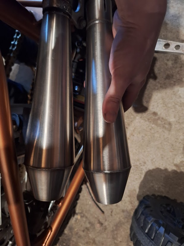

I also scored a set of "opened so used" but brand new cone engineering reverse cone mufflers. I ordered a length of tubing from amazon to make a few "mid pipes" to link them to the factor headers. This should prove to shed some real lbs, along with getting a bit more rumble. I have always felt like the bike is going faster with loud pipes after all ;) It turns out that they are the same muffler that i put on my bobber. Funny enough the ones on my bobber.... came off of an r90/6 that was owned by @Kanticoy.
This is also a case of "credit where credit is due". Half the reason I keep coming back to this bike is due to the time that @irk miller let me ride his r100/7 thorugh an afternoon of south eastern ohio twisties. This thing is an absolute riot. I cannot count how many bikes ive ridden, but this one is easily top 3. I've been nagging him about specs of his build for the last month, but Its piecing mine together into hopefully just as fun of a machine. Heres his video of why I wanted the same pipes. Mine will just be in closer to factory position.
