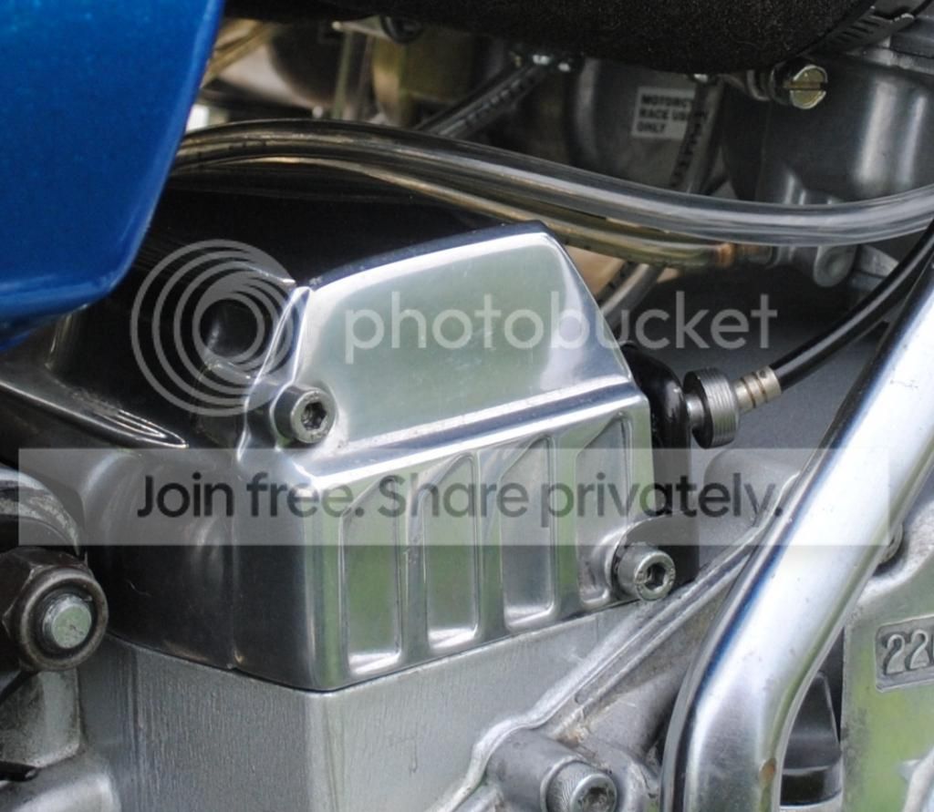

Hi nice bike i must say.. my question is with reference to the mikuni 34mm flat slide carbs you fitted how did you go about setting the oil pump calibration/carb settings, as i want to fit this style of carb myself but want to keep the oe oil pump regards gary
Gazza,
Oil pump settings should be stock. Oil is injected straight into the inlet ports and into the main bearings.
Jetting is a whole other issue though. :-)
Hello Gaza,
Teazer is correct, the stock pump runs off of the fourth throttle cable from the linkage as normal. One cable operates each carb as stock so everything remains essentially the same.
Pump cover & housing:
Carbs & throttle cables:
