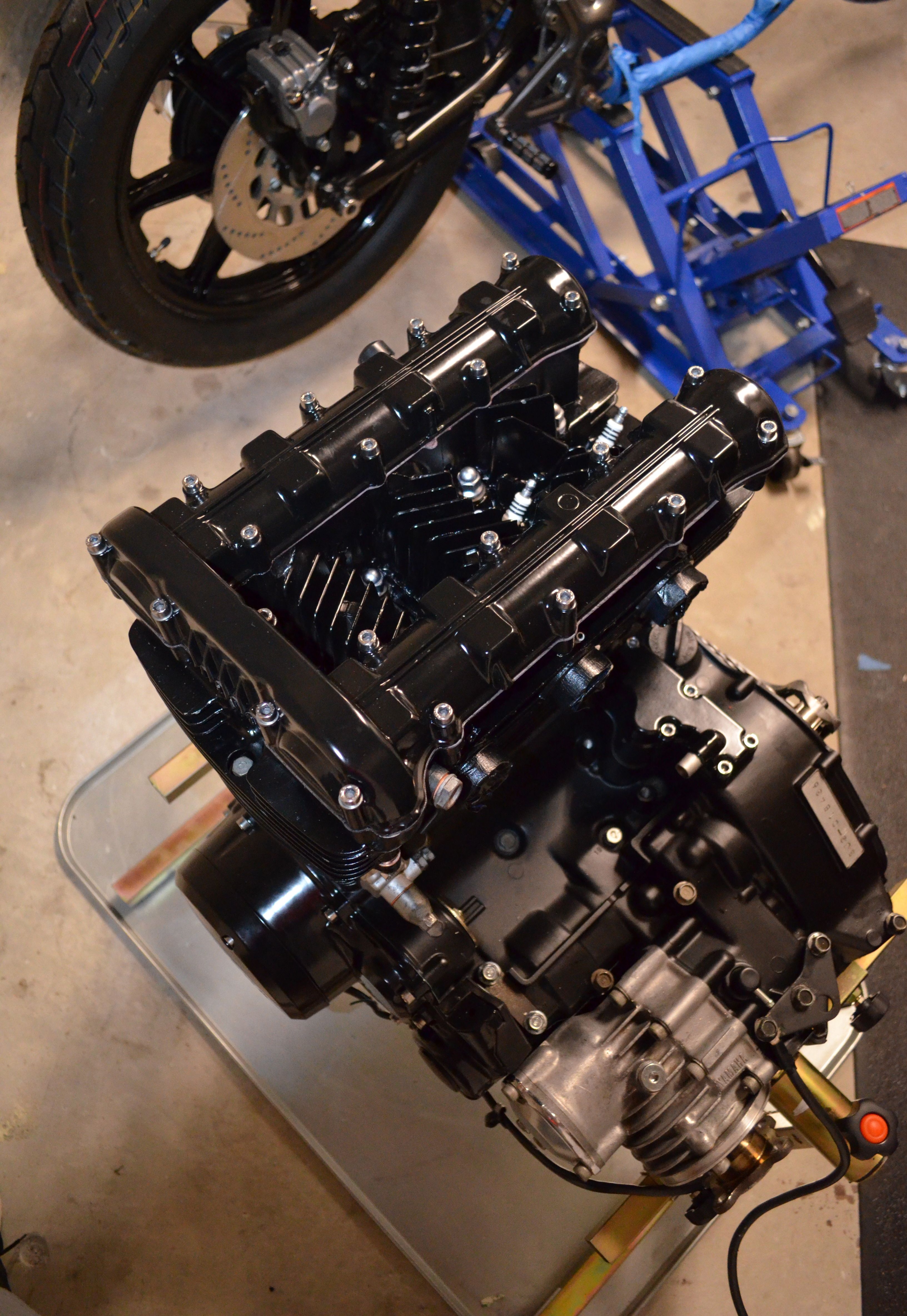

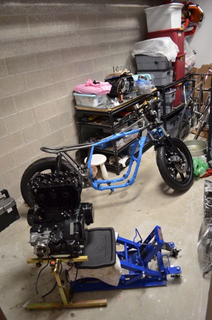

Today I linked up the cam chain and prepped the frame for the install. Tomorrow I hope to get the engine back in the frame. This is a momentous day for me. There is nothing like installing the last gasket in my gasket set.

Today the engine went in! It was easier than I thought it would be. One lesson learned: Use something stronger than 2 layers of masking tape to protect your frame. I did end up with a few surface scratches on the powdercoat. It should clean up fine, but it's still a hassle. What's left to do to get this sucker running. I'm going to try to get it running first, then get the wiring harness properly sorted out.
