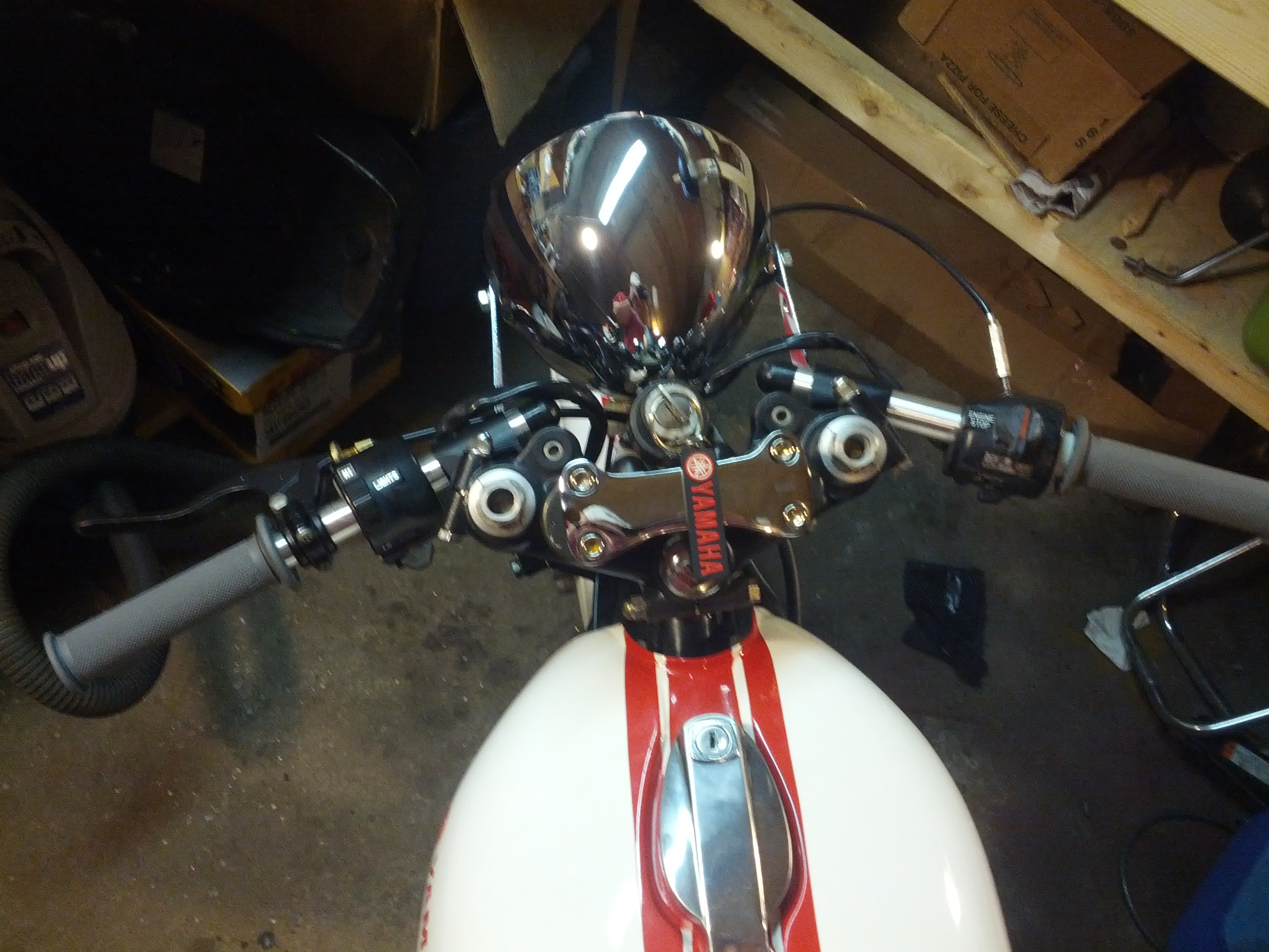

OK so I finally got my bike re wired how i want it and also some new clip ons. Well on my way to a daily rider.

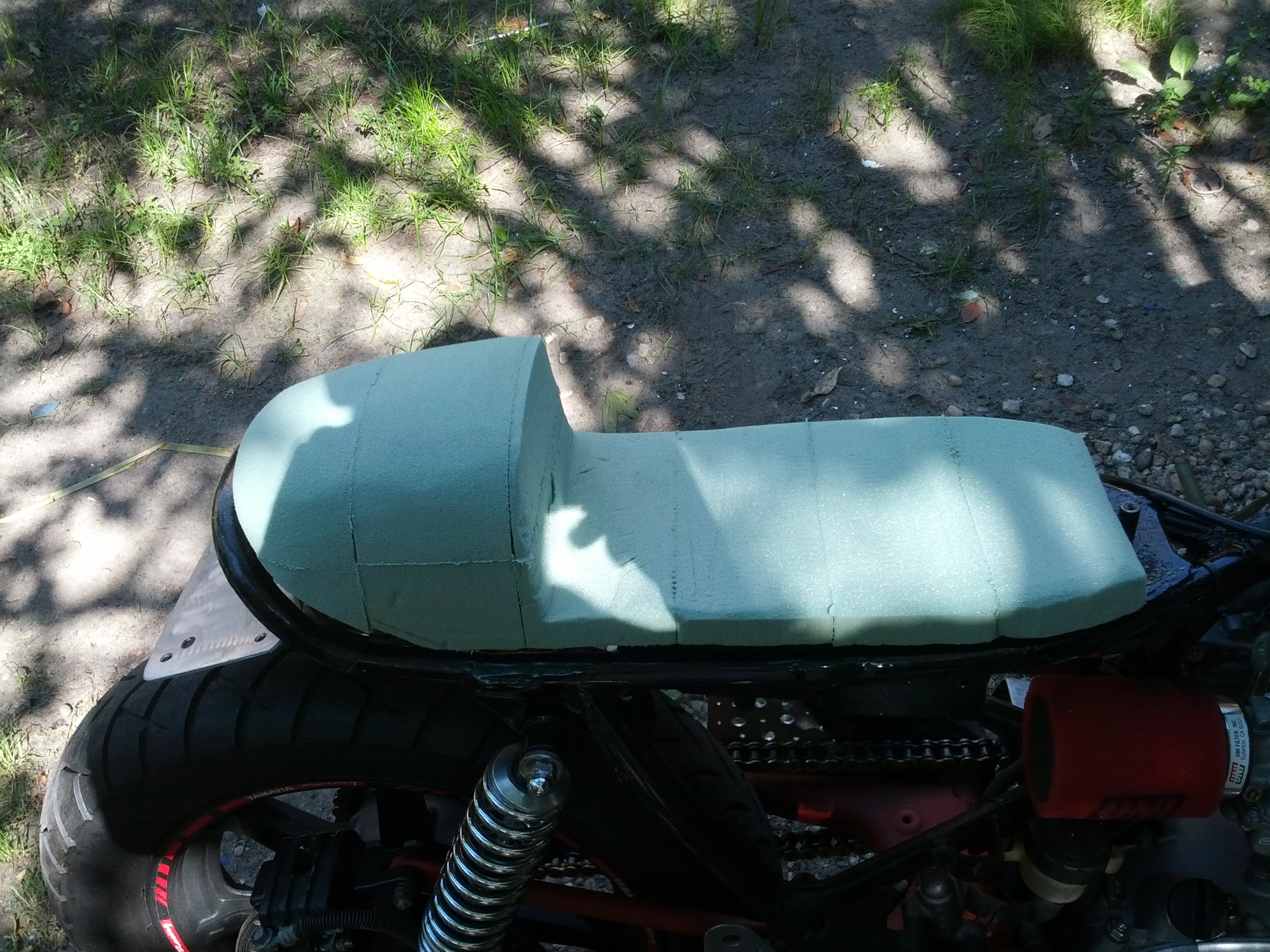

So the idea is to have two seats. Here's the mold for my fiberglass seat.
