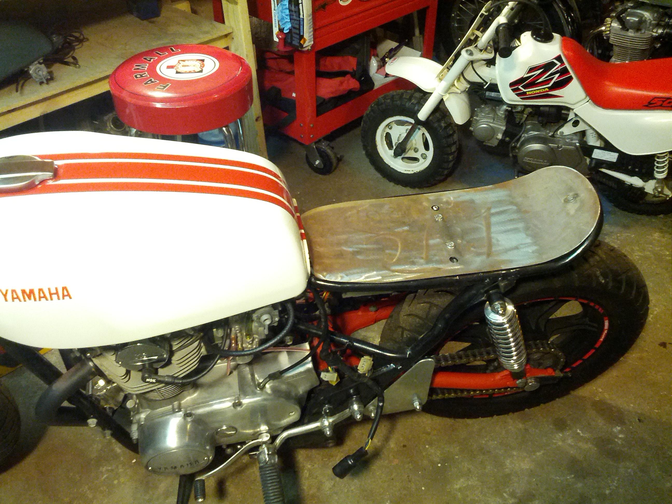

Practiced up on my welding and put my original seat hoop back on. Also put a plate on it for mounting my new seat/lights. Welds are not great but its the best I can do with a cheap mig welder and no gas. At least they are strong.
Used up my last flap disk the other day. I think it will clean up nicely though. Sure is hard taking everything apart and reworking it after I finally got to ride it at Barber for the first time. But I'd rather have everything done right and look right.

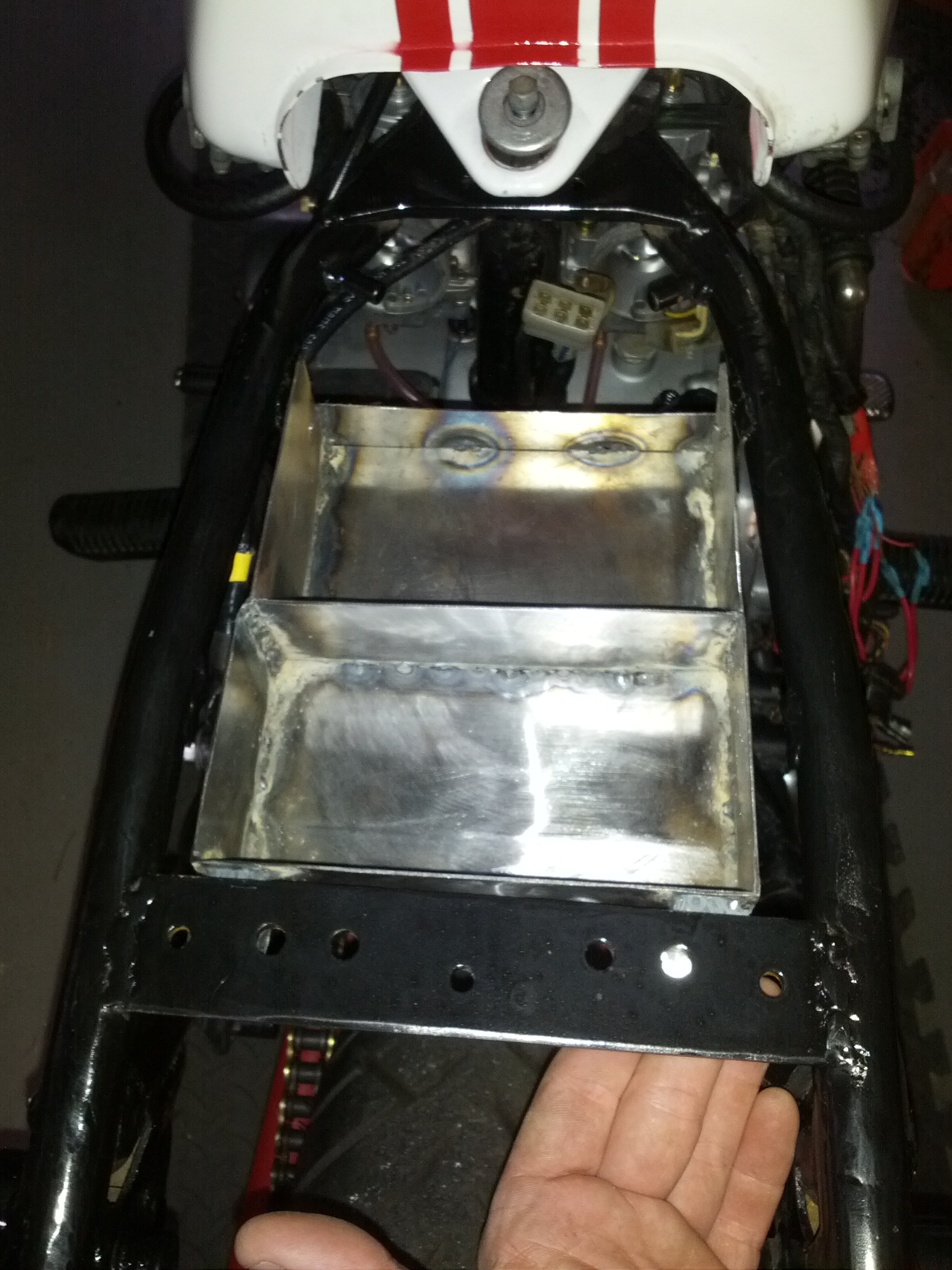

Finished cleaning up my welds and re did my brace. Also snapped a few pics working on my battery tray. Forgot to take a picture of the frame painted.
