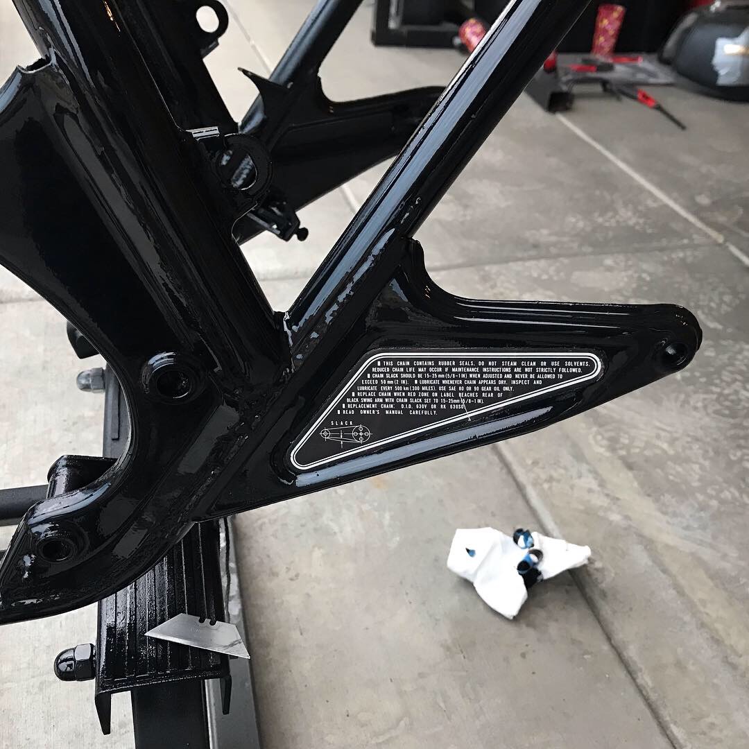

I looked high and low for someone local but they all wanted close to $150. I just went on amazon and bought one for $30 and had to tweak it just a tad to make it fit but not much. I’m finding Colorado has some crazy weather swings. One day it’s sunny and 55° then wake up to snow. Then two days later it’s sunny and still in the 50s.
I was hoping to be further along by now but it’s been hanging around 15°F (-9°C) during the day. I got a little grinding done on the hoop welds and got the basement warm enough to get the first coat of primer. I’m using Eastwood 2K Aero-spray epoxy primer. It looks good so far.

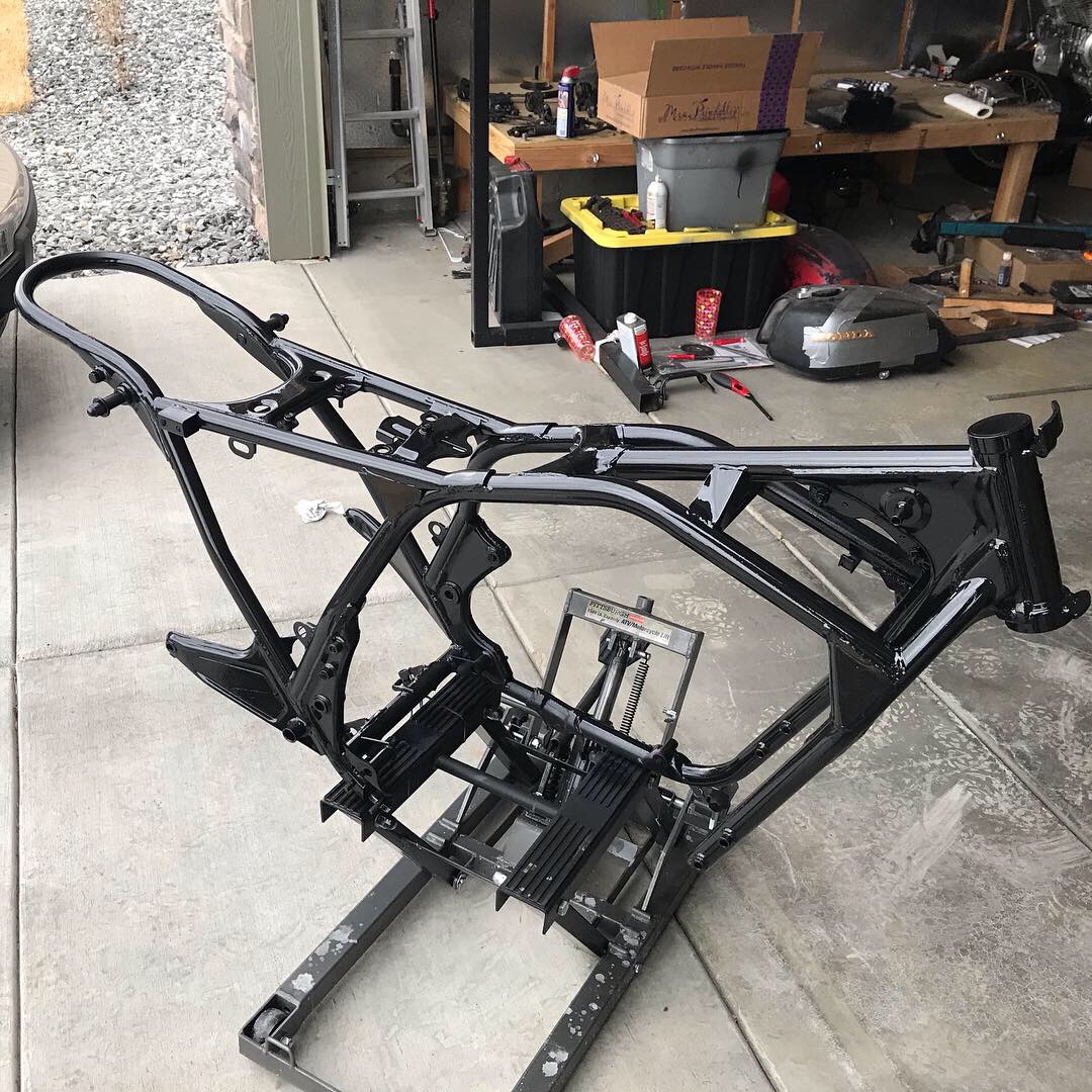

Paint is done! Time to hang the motor.

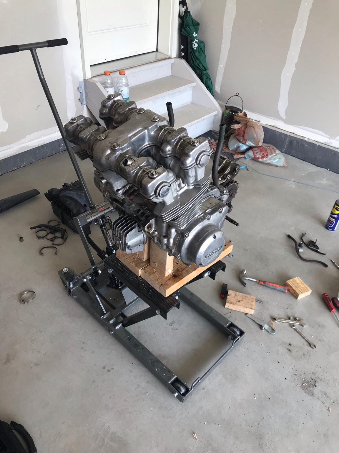

May I ask how did you fit the engine into the frame? I myself is working on a similar bike (1980 CB750F DOHC) and on the stage of mounting the engine. I will have a friend coming this weekend to help but I wonder if it possible to do it solo.
I took the engine out while the bike was on the center stand and used a motorcycle jack and a few pieces of wood to support the motor then slid it out the right side.
To get the motor back in was much easier because the frame was by itself after painted it so I had the motor sitting on the table and just lifted the frame onto the engine. Both times I was by myself.

Paint turned out great man. I understand the struggle of having to paint in a basement in the winter.
Thanks. I started the first epoxy primer coat in the basement because it was 3° then two days later it was 62° and blue skies so I finished up out in the garage. Denver has some crazy weather swings.

Thanks! Got the engine in (with a friend's help though). It wasn't that hard at all, just needed another person to help out lining up the bolts as I don't wanna scratch the frame paint. But you are so good and strong enough to do that yourself! Much respect.

The epoxy primer and paint laid down very well. It was about 55°F and 20% humidity but the the guy I called at Eastwood said I should sit the cans in warm to hot water for about 15 minutes before spraying. I’m very happy with the results. I cleaned the surfaces well but didn’t smooth out factory imperfections in the metal so any small bumps or ridges are from that not the paint.
