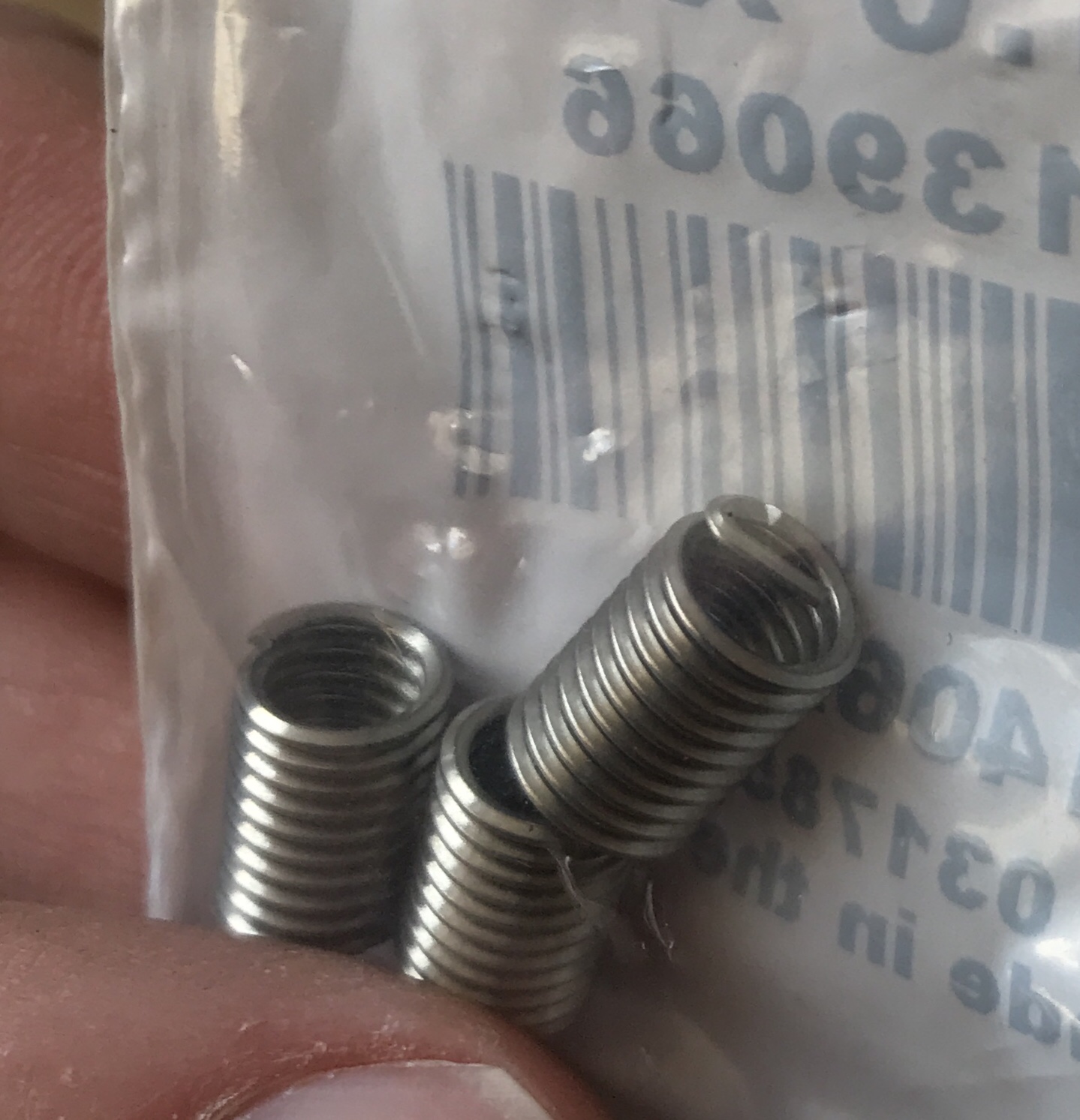

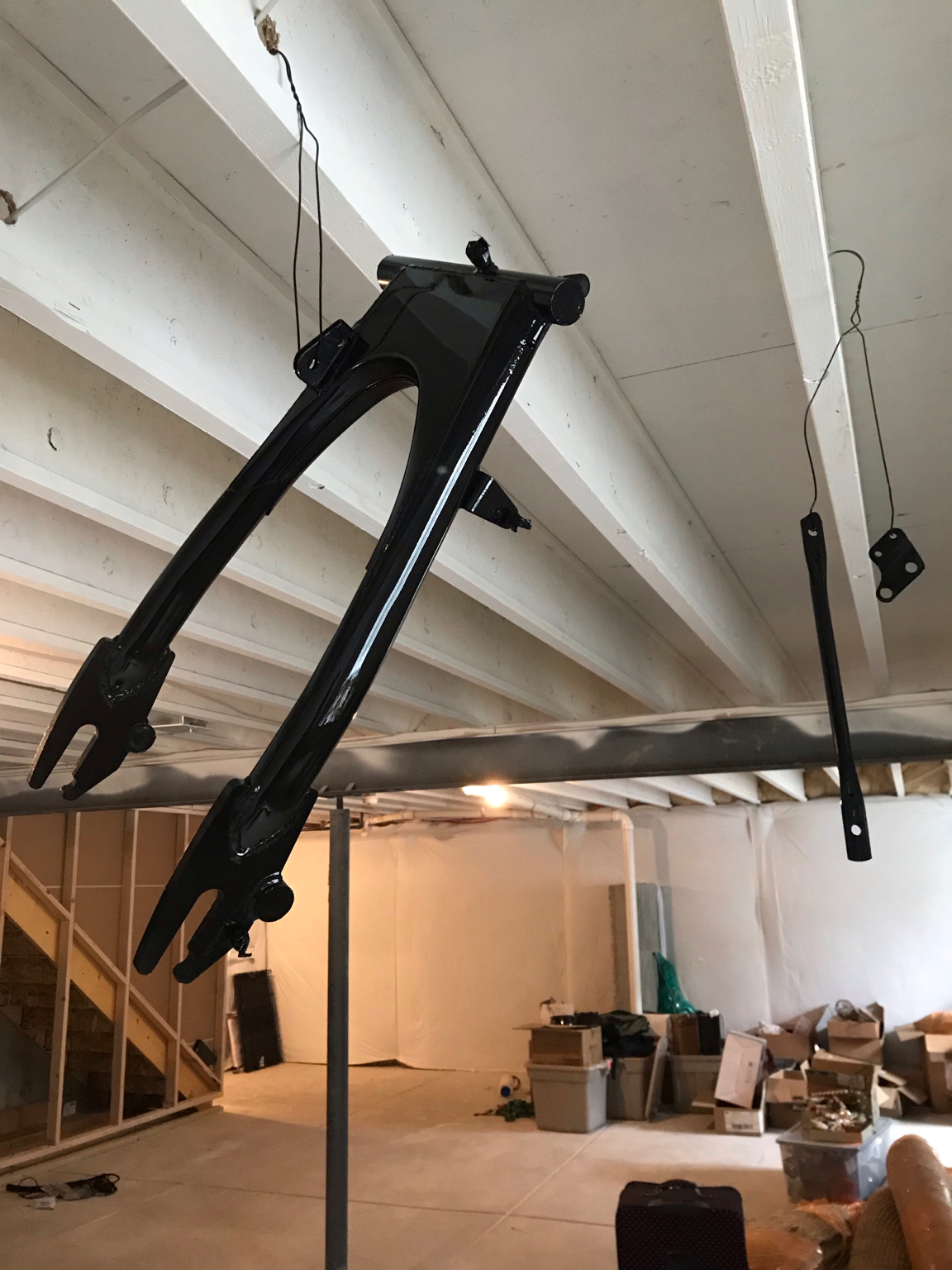

Like usual I had part of a day to get a few things done but nothing major. I stripped and painted the swing arm, lower fork clamp, rear brake, and some other small parts. I also had to repair a stripped thread in the head. I went with a heli-coil system. I’m also about to dig into the electrical system for the motor then on to the rest of the M-unit blue.

Shaping up very nicely fella. Helicoils are the business. I had to use one for a stripped cam chain tensioner thread - sweaty palm time but damn those things work great. Watching your (and a few other 750 builds at the moment) is an education as I'm working on a smilier bike right now too. Watching with interest!
Edit - I’m working on a similar bike. It’s in no way smilier.

Thanks. The color came out great but I’m already wishing I hadn’t used VHT. That stuff is garbage. I followed all the instructions for priming and painting and thoroughly prepped the metal before I sprayed the primer. It is not durable in the slightest and will chip easily. I dropped a small socket on the cam cover from no more than 2 feet and it left a chip about 5mm. The frame came out great and I couldn’t be happier. I used a 2K rattle can epoxy primer and paint. I sprayed a test plate with the left overs and it’s durable.
The vapor blasting is incredible. It micro peens the surface of the aluminum and closed the pores and gives a durable velvet look.

I used your build as reference more than once so thanks for that. Yeah the Helicoils worked as advertised. Too bad the tap and install tool are priced like they are made of silver. I think I’ll strip a few more threads just to get my money’s worth

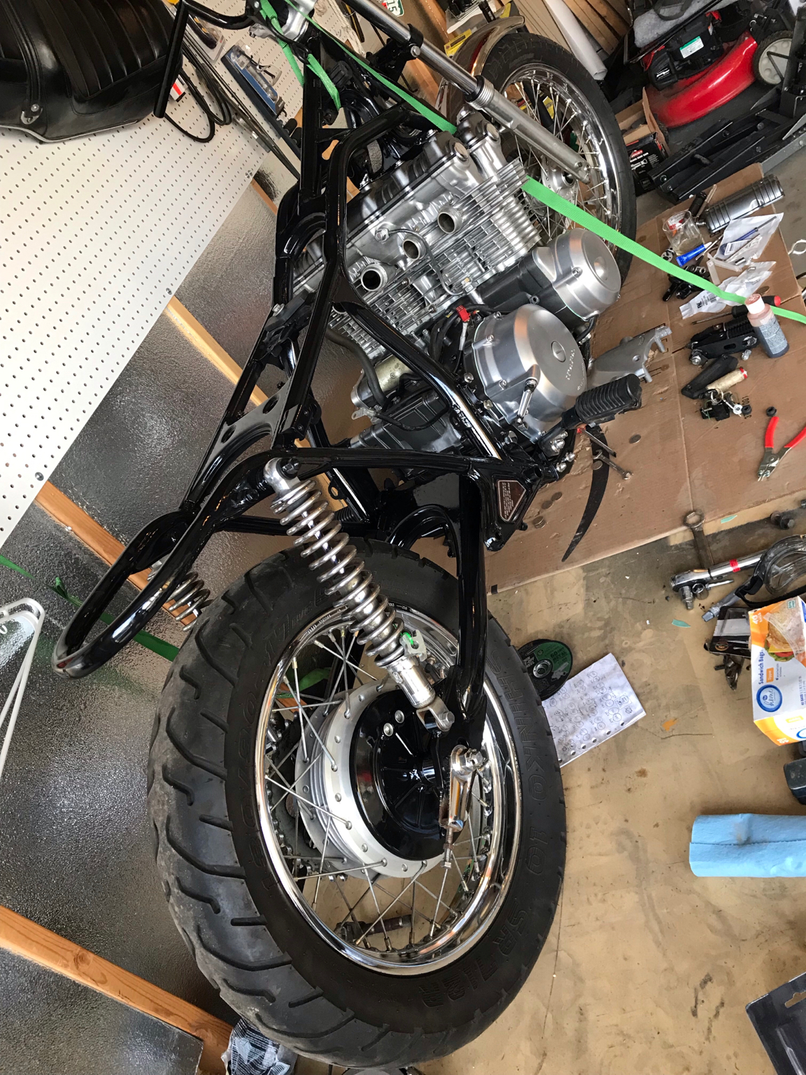

Starting to look like a bike again
Don’t judge me on my dirty rear shocks. They are the originals just holding up the rear until I decided which shiny new setup I want.

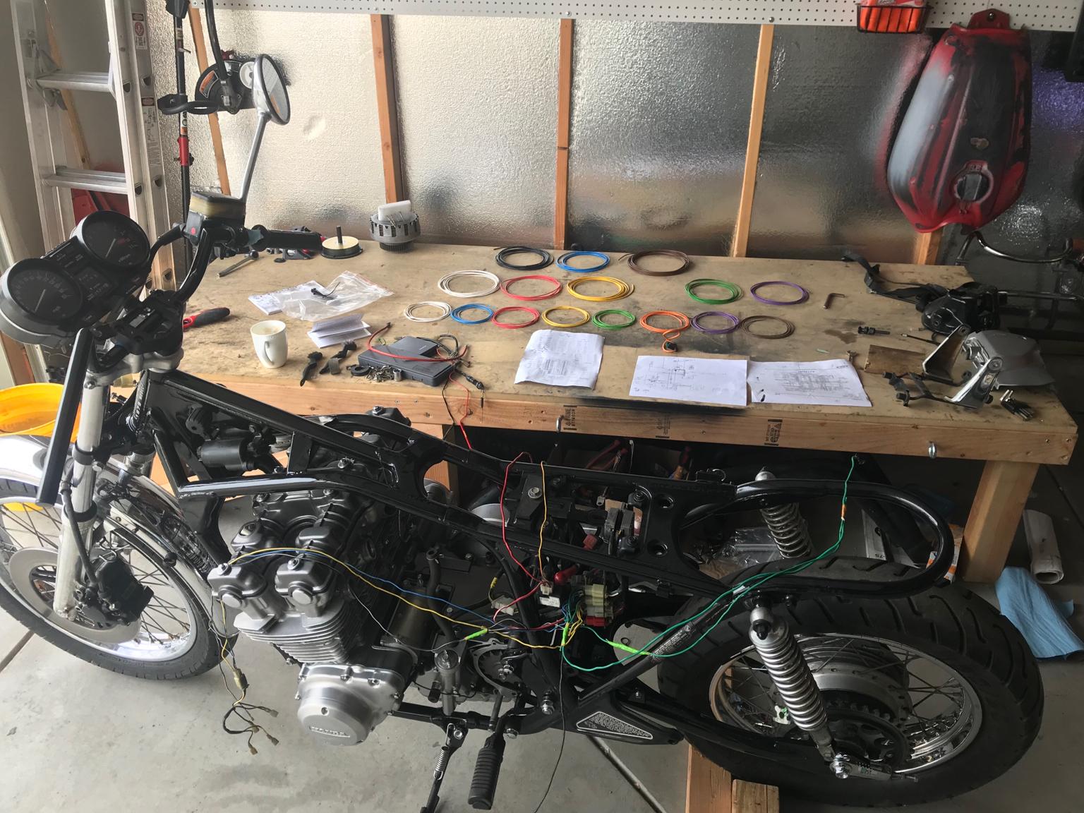

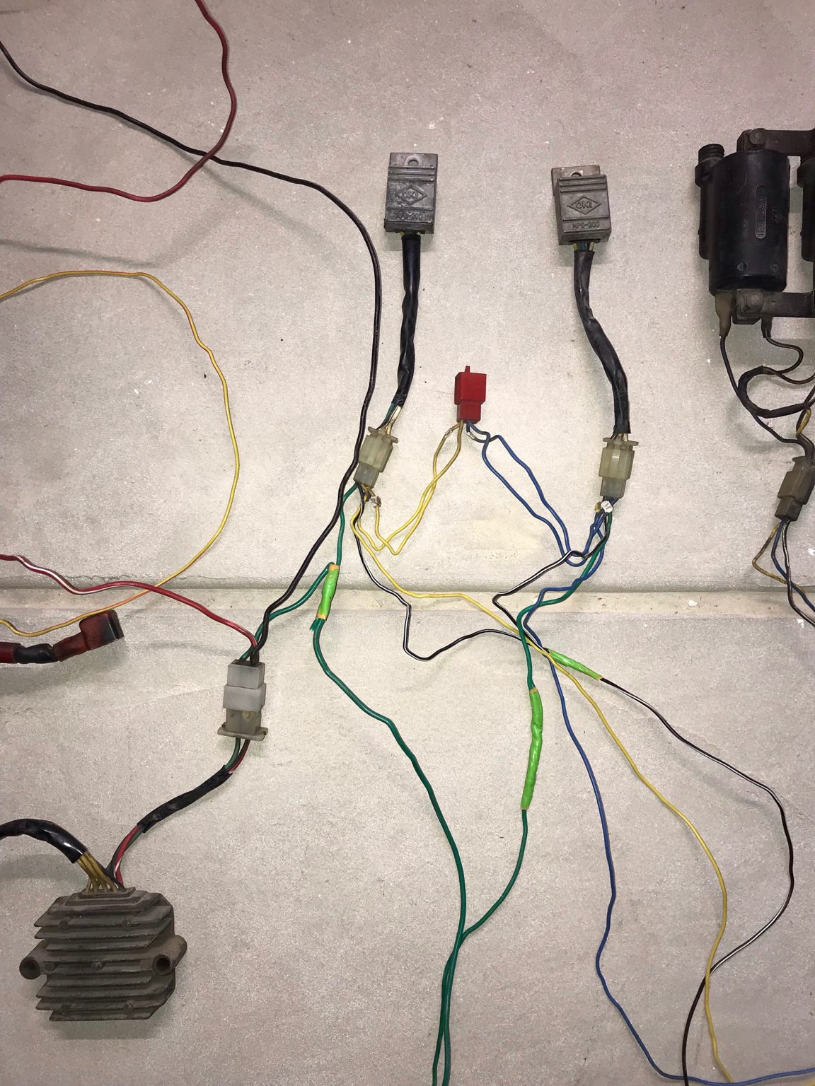

I’ve got the engine side of the wiring harness split away from the rest of the crusty old bunch. Won’t need the rest of it with the M-unit blue going in. That was an exercise in patience.

Nice, Honda seems to love to use way more wire and connections than required on their harnesses. You can slim them down a lot like you did.

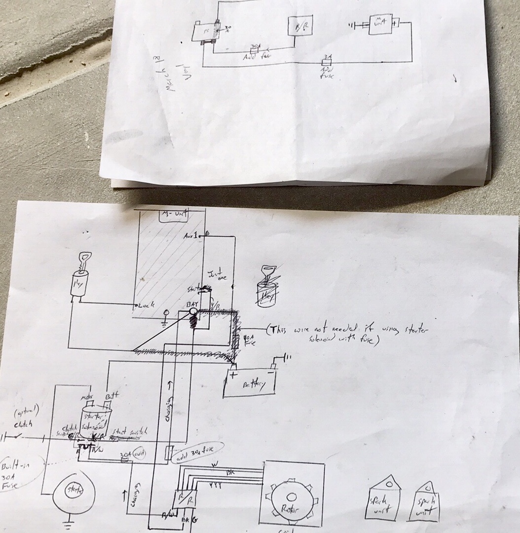

So I think I’ve got the wiring for the engine side of things all figured out. I’ve spent a lot of time looking through the electrical flow but if anyone sees any fatal errors call them out. This doesn’t include separate power distribution and grounding blocks that I’ll draw in later.
There are a few scribbles when I forgot where I was in the layout so it’s not as pretty as it could have been.

Good luck, it’s rewarding when all the switches do what you intended them to do

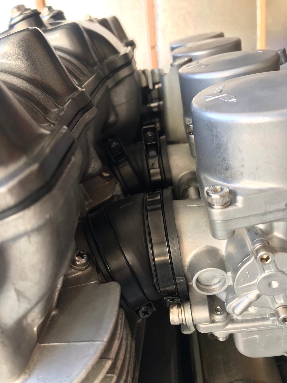

Got the new isolators and boots on and temporarily connected the M-Unit Blue. I wish the very first thing I did when I was working on this bike before the build was but factory fresh rubber parts. The carbs pop on and off SO easily compared to the rock hard crap that’s been on there since the 70s.

Well she fired right up without hesitation!!! New homebuilt harness works! The M-unit blue works! The engine didn’t explode! The rebuilt and vapor blasted carbs work! All this is such a relief. Now on to sourcing new controls, making the tank look pretty, and mounting the M-unit in a permanent location.
