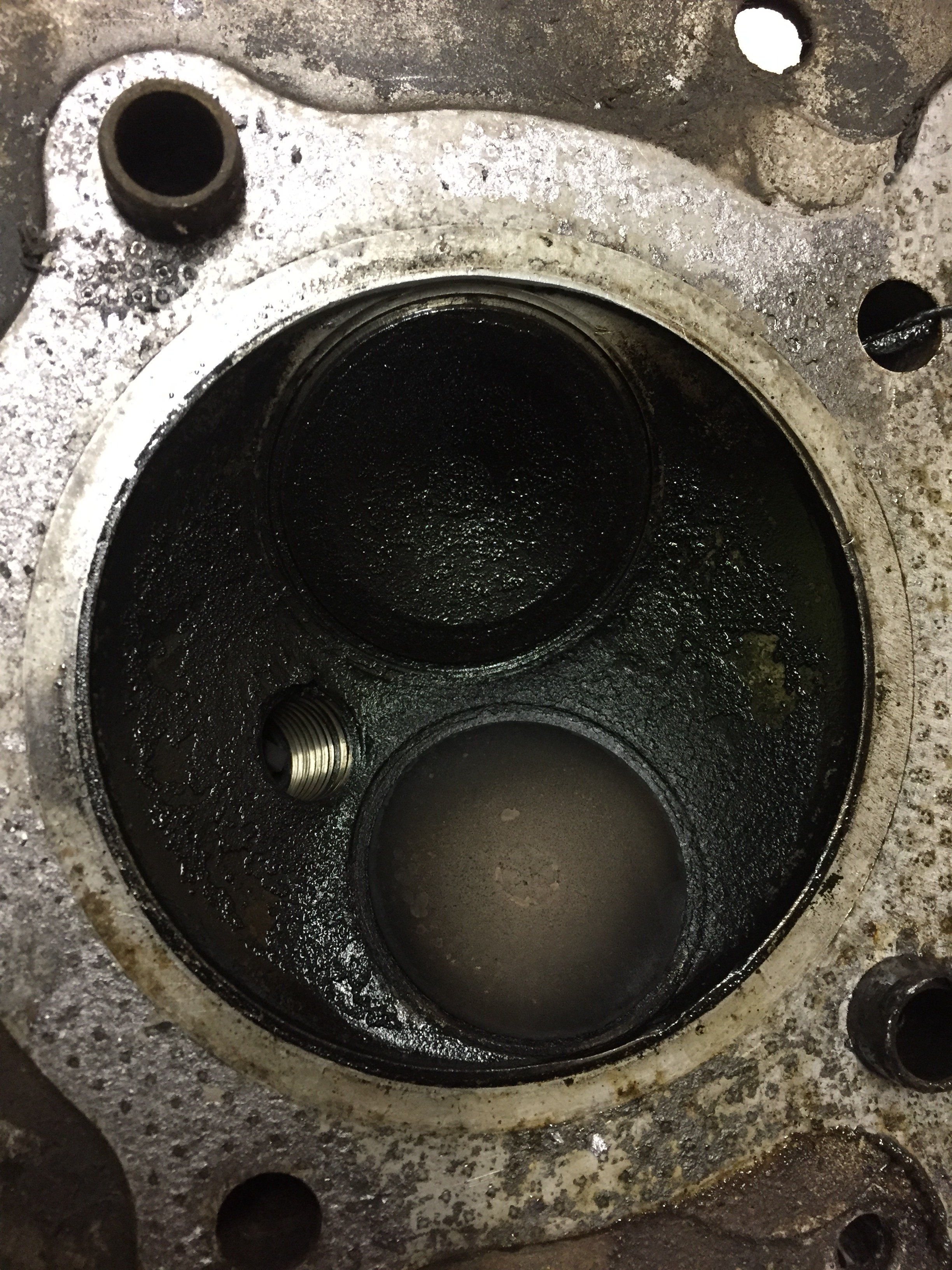

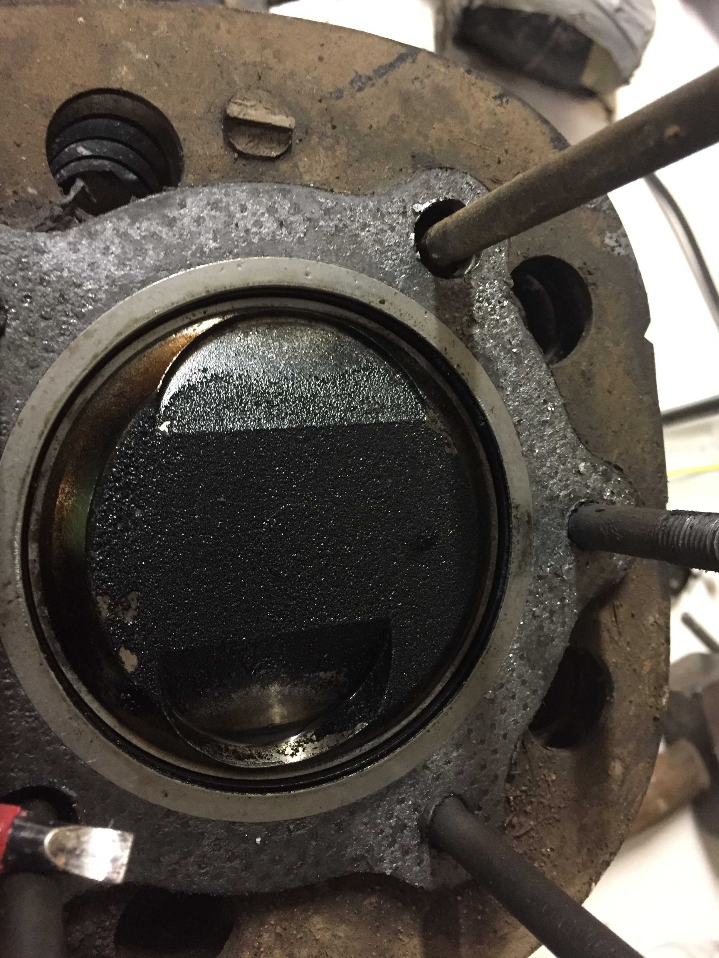

ok at first glance does anyone have any thoughts on how this looks?
valves and piston.
i will be replacing the valves as soon as i can find out what year my engine is.
also one of the springs have snapped on the valves so i will replace all of that also.
any thoughts on the colour of this piston and valves, seems to be very black.
i cleaned the piston very easily, and looks ok

hey thanks for the reply.
how do you know its 1976?
i thought 76 didnt have the compression window. but this one has it
in the picture mind you my eyes are getting old
the spark plug threads look awful pls check and make sure its my eyes and not that you need a helicoil
MCKAY34 said:
Does anyone know what year my engine is?
xt500 number: 1E6 - 302000
According to this, looks like 1978..
http://xt500.free.fr/technique/numero.html
Sent from my XT1563 using Tapatalk
The spark plug thread is all good!
Checking that list, why would you say it's a 79?
Because the 1e6 number is also next to the 76 model?
1E6-300101-310000 2H2XT 500 E 78... If your vin is 1e6 302000 thst falls in between those #s doesn't it? So 1978.. That's just how I'm reading it maybe?
yep! thanks exactly what i have.
yamaha finally called me back. its a 78 engine. and my frame is an 80.
thanks to everyone! problem solved, time to keep kicking on with the build.

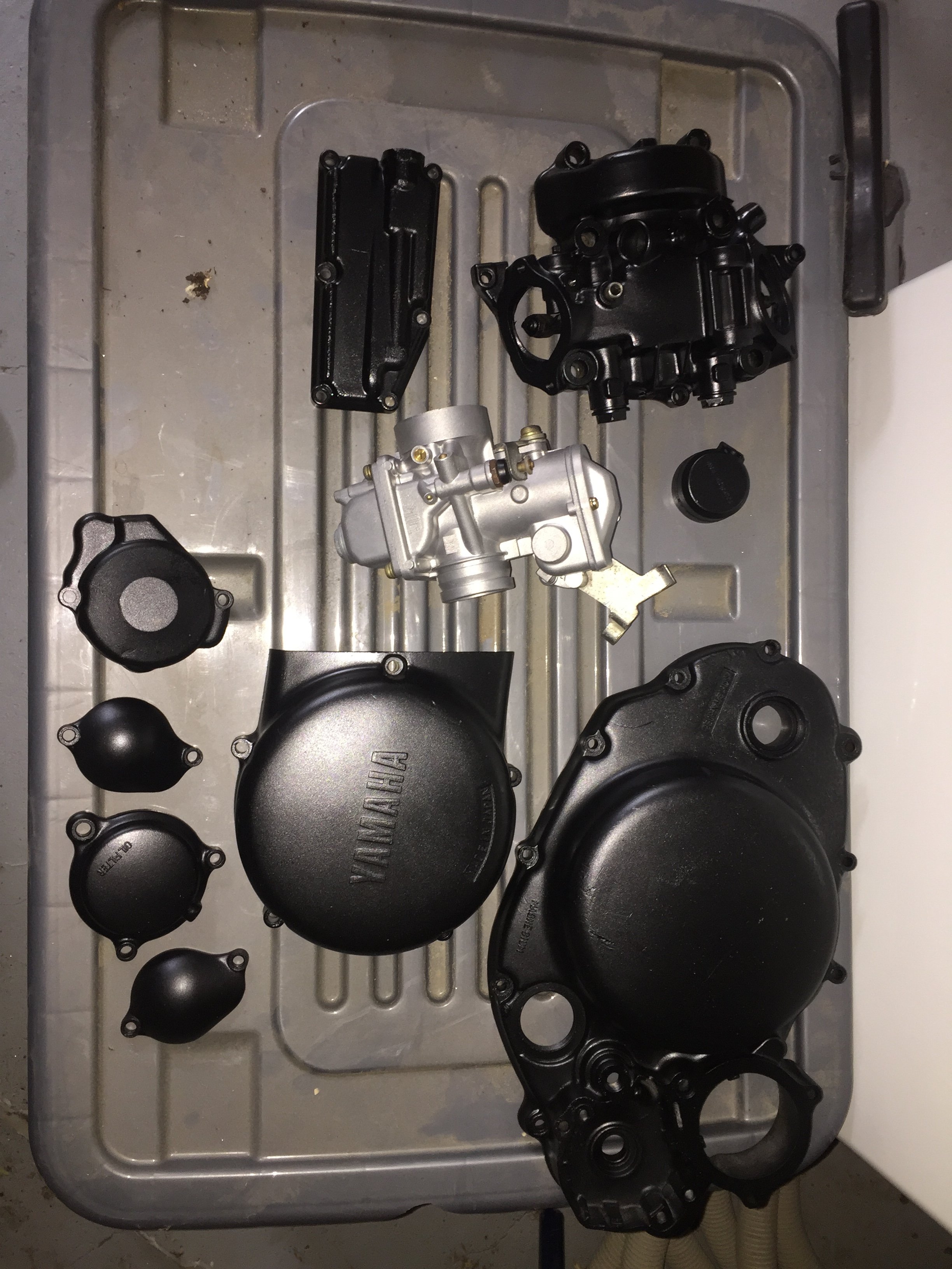

i have been waiting for parts to arrive, just been tearing more bits apart. did some painting while i have been waiting for parts to arrive.
did some painting while i have been waiting for parts.
going with satin black for the engine.
