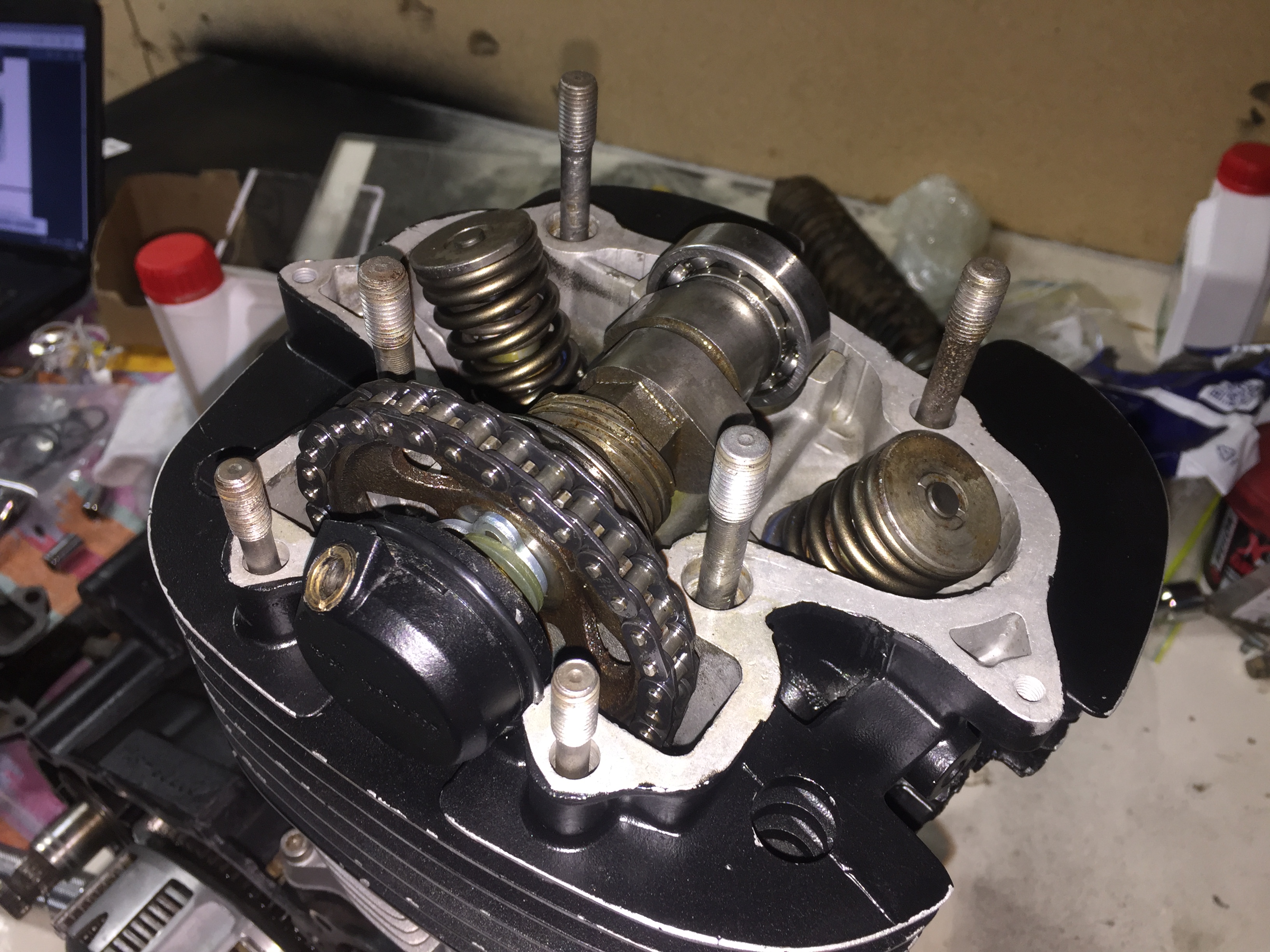

ok great news.
the new camshaft has arrived, so i will be reinstalling the new one today.
everything went well and installed with no issues.

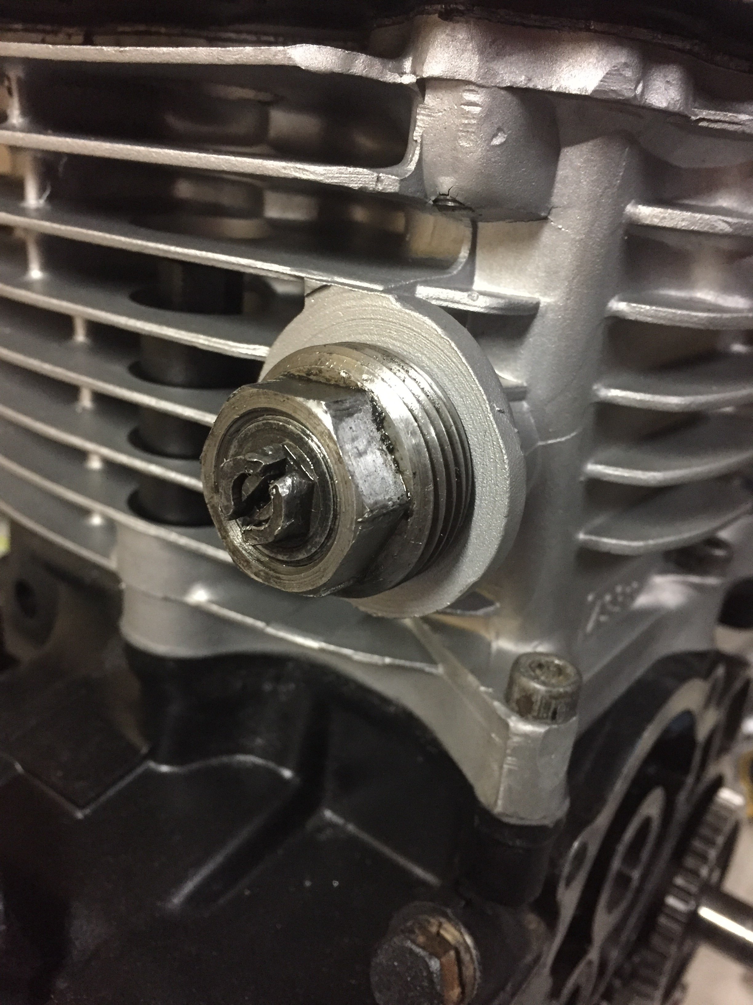

Ok so i need some advice please.
I am not sure how to install the cam chain tensioner, perhaps im over thinking it. im not sure how tight it needs to be.
so i just screwed the smaller one all the way in.
please have a close look at the pic, you will see what i have done. what is the general rule when installing these cam chain tensioners.
Any help would be great, thankyou in advance.
The smallest part in the very center is a floating rod. The 10mm nut outside of it is the adjuster. The big nut is the lock nut. You're not going to over tighten the 10mm to start, but when the bike is running you adjust it until the floating rod bounces 1 - 2mm.
Hi miller , that's great thanks for the info.
When you say "bounces" do you mean it will twist back and forth 1-2mm? And then I just adjust the 10mm nut either in or out until the rod does this?
When the motor is running, the center rod bounces in and out like a sewing needle. If it's loose enough, it almost looks like it's going to shoot out. So, you're adjusting until it protrudes no more than 2mm. You can stick a wrench over it and it will tap the wrench.
