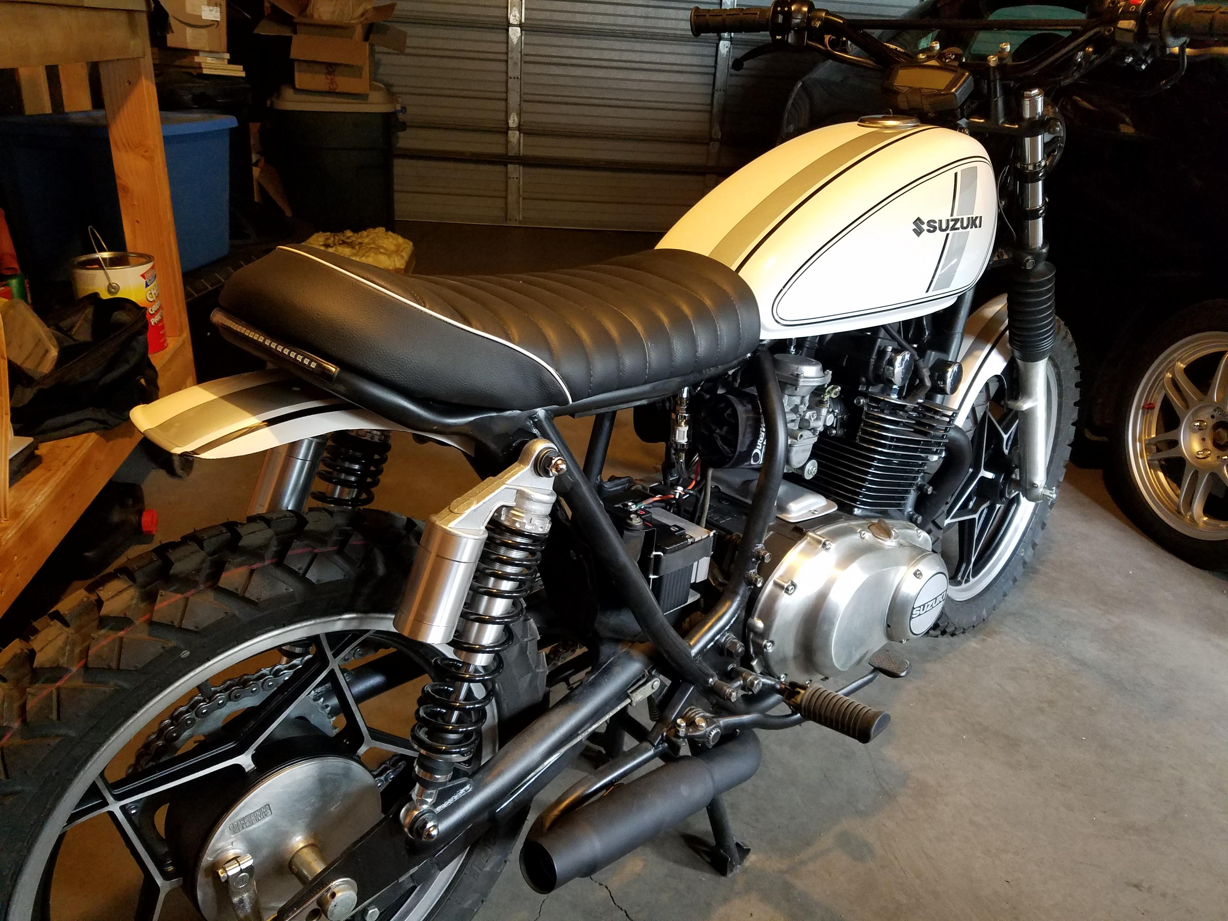

In other news, the carbs are rebuilt and back on the bike. I've done as much research as I could on tuning and jetting to predict what jets and jet needle shimming I'd need to do to run my K&N's with pre-filters and the MAC 2-1 exhaust with a shorty muffler.
Main Jets - For main jets I've got 6 options, sizes 135 through 147, and these are actual Mikuni jets. I am thinking that the 142.5 is where I'll start.
Jet Needle - When I took apart the diaphragms I noticed that there was no plastic spacer for me to remove, just a single metal washer about 0.5mm tall, so I am thinking a previous owner had fiddled with this already. I was planning to do just this anyway so I left it as is.
Pilot Jet - Stock is a 17.5 and I also bought a 20 and a 22.5 just in case. I've left the stock 17.5 in for now and will bump up if I run out of mixture screw travel.
Mixture Screw - I'll be starting with the screw 3.25 turns out
This tuning part has got me a bit nervous and I'm expecting the worst. The bike hasn't started since Nov. 2015 and it now has new electronics, filters, exhaust, oil, plugs, gas, carb o-rings and main jets, and the carbs have been dipped and fully cleaned.

The cosmetics of the bike are pretty much done, so at some point I hope to get some nicer shots outside of the garage. I'm forcing myself to hold off on final pictures because to me it still needs to run correctly before I can post "done" pictures. Tonight I'll be starting her up and seeing just how much of a mess I've got on my hands to tune up. I've never tuned a carb before other than adjusting the idle on a weed-whacker, so again, expecting the worst and may be posting lots of frantic "What does this sound mean?!?!" posts.
For starters, where does one plug their laptop into the carbs at to tune them?!?! ;)

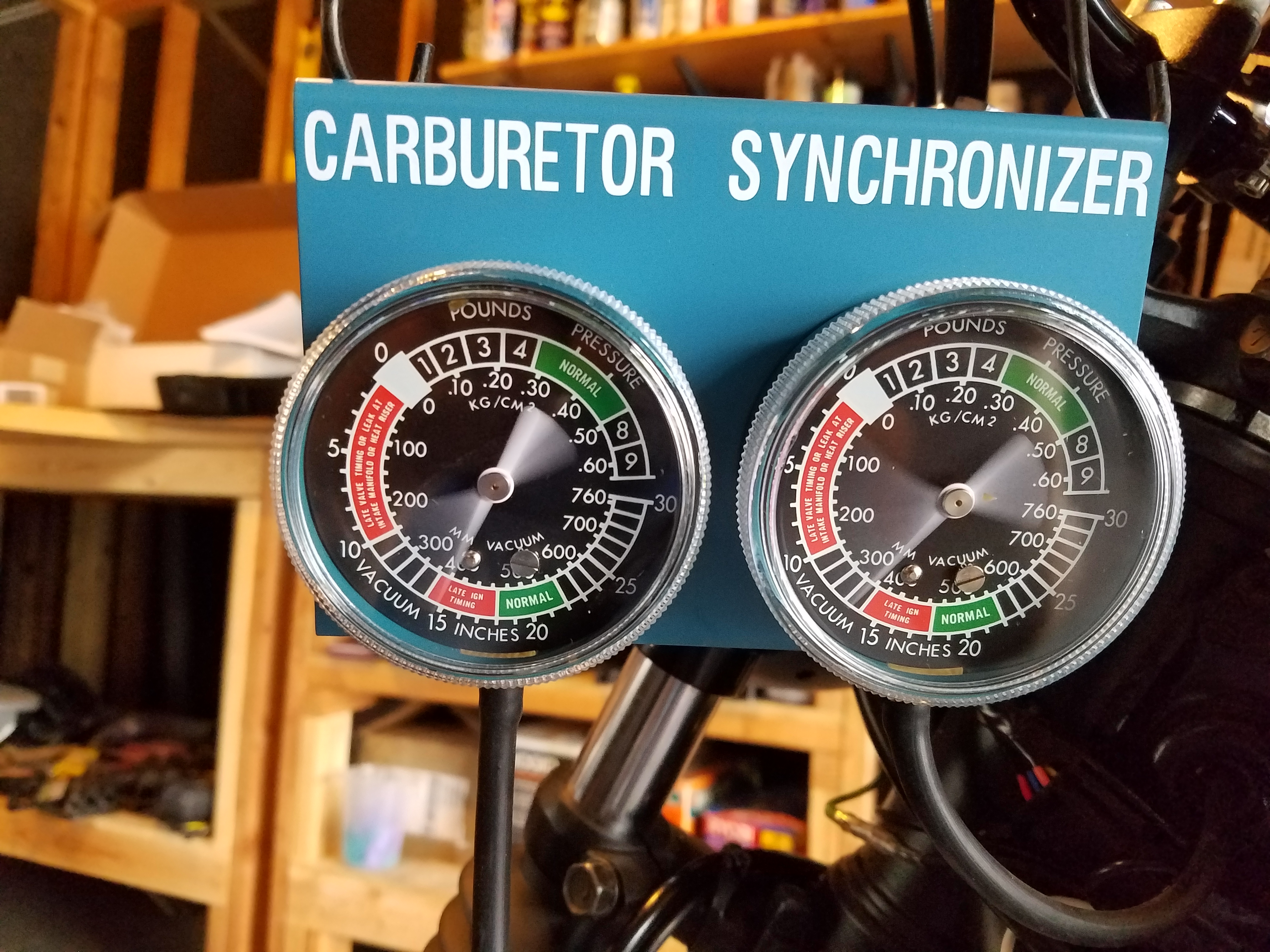

I've spent some time balancing the carbs. They weren't too far off but there was a slight difference. Attached are before and after pictures of the gauge readings.
