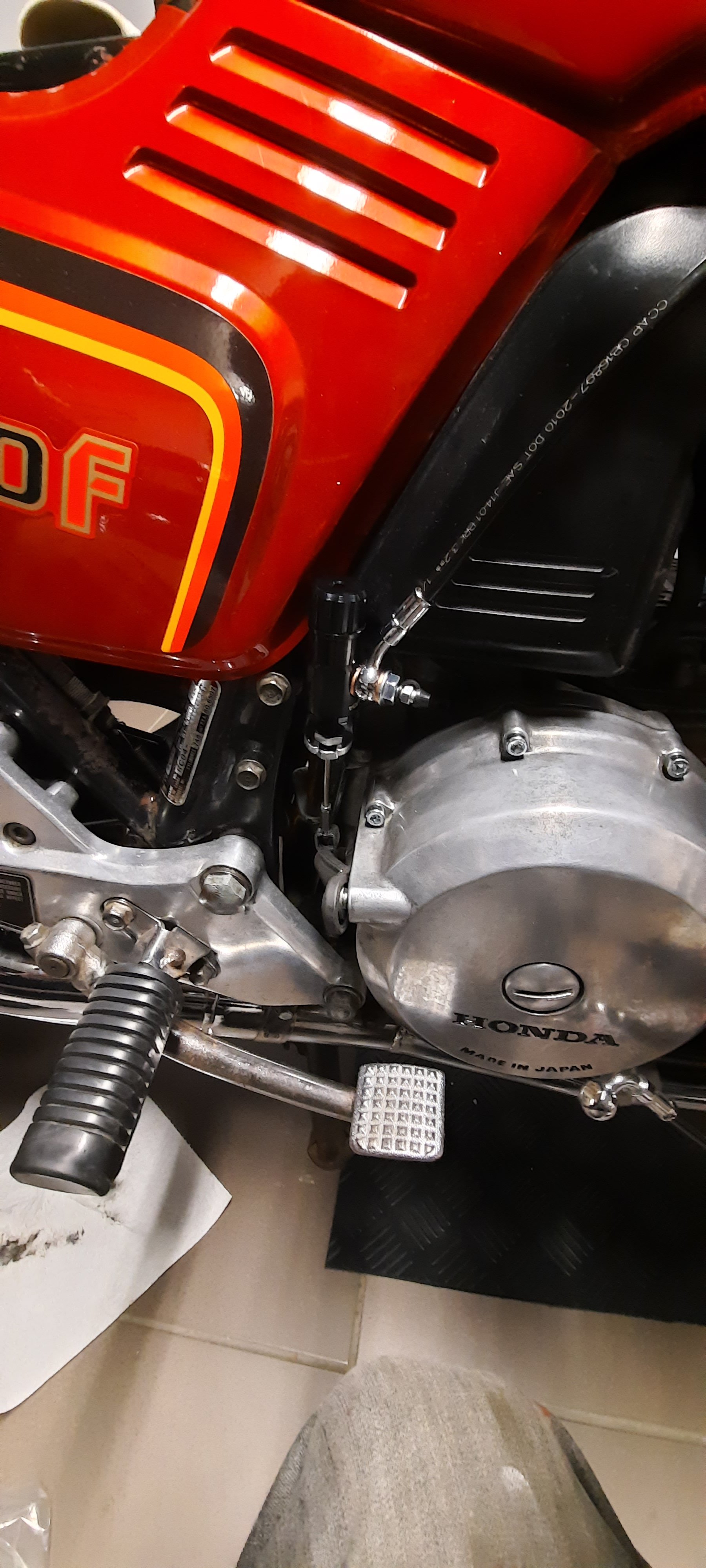

Got bored yesterday so decided to make a chain cover from some leftover aluminum I had laying around. Pretty happy with the result.

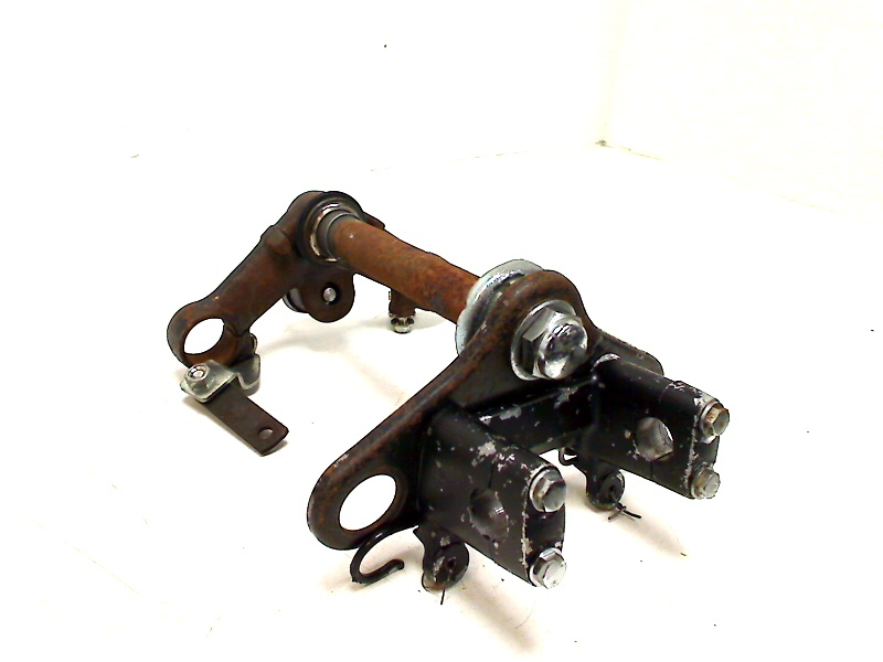

Also started on putting on an hydraulic clutch. Curious about how well it will work. Make myself a bracket to mount the slave cylinder so i didn't have to cut into the airbox and in case it sucks is easily reversible. Still have to route the hydraulic line and bleed the system, but will do that when I take out the wiring loom bacause I need to remove the headlight to do so.
So I got a bit busy last weekend, I hooked up the hydraulic clutch but the master cilinder had a pinhole in the casting, leaking oil everywhere and unable to build pressure. At this point i had it with this cheap sh*t and decided to just bin it.

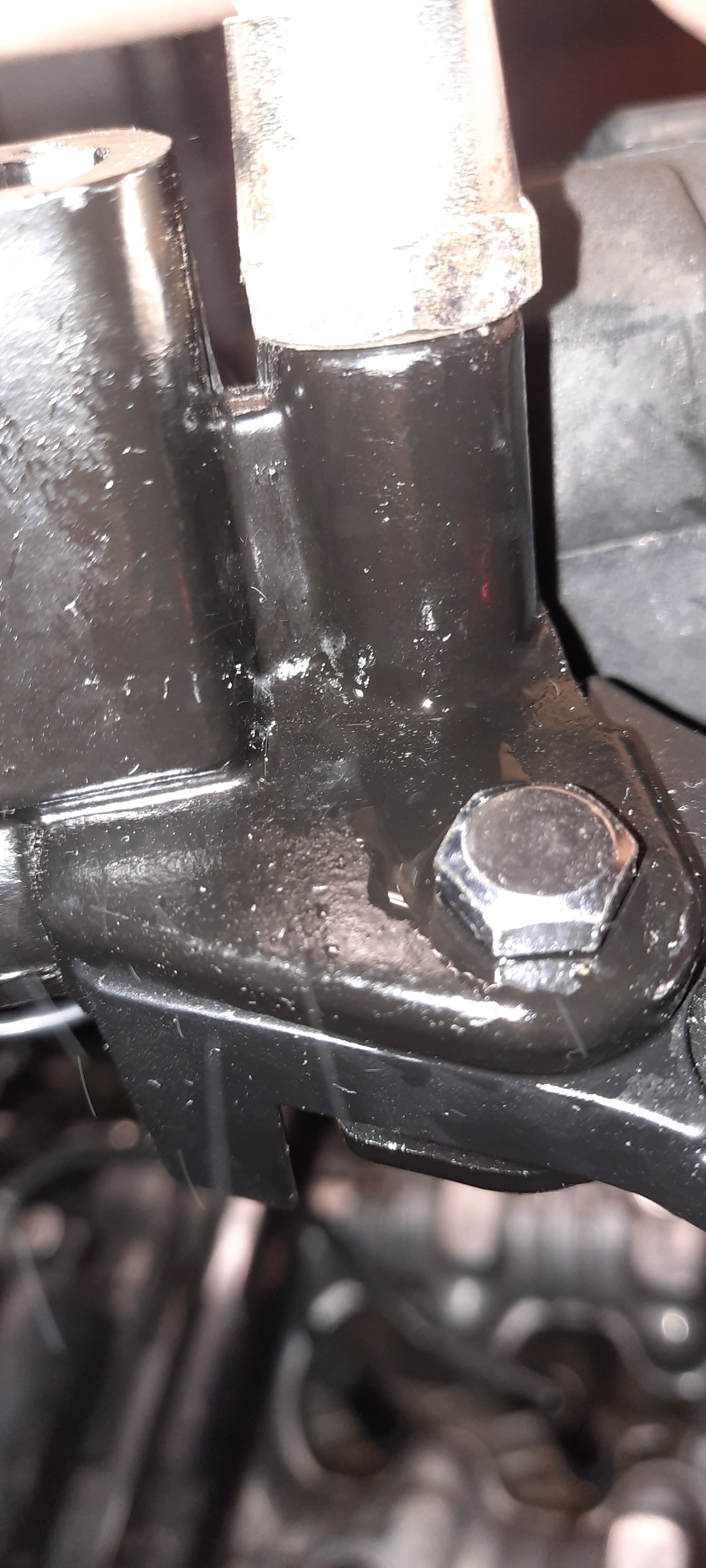

Since I had to take it out I wanted to do an upgrade and make the adjustable handle I had laying around work on this bike anyway.
The handle is of an cb600F but when fitted to the CB750F housing it sticks way to much forward, so picked up a honda NT650V handle, gave it some paint and put it on together with the original cable. Feels good at least having matching handles!

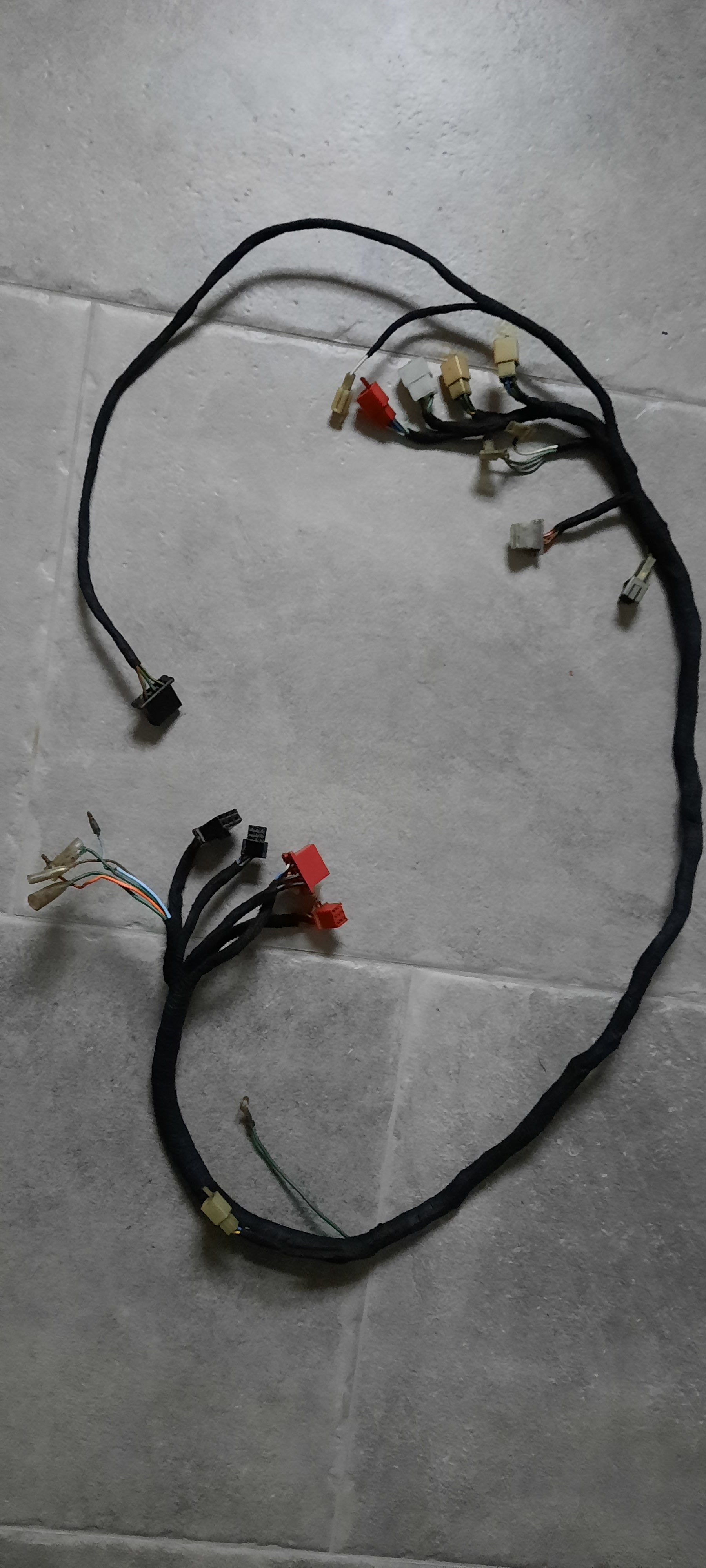

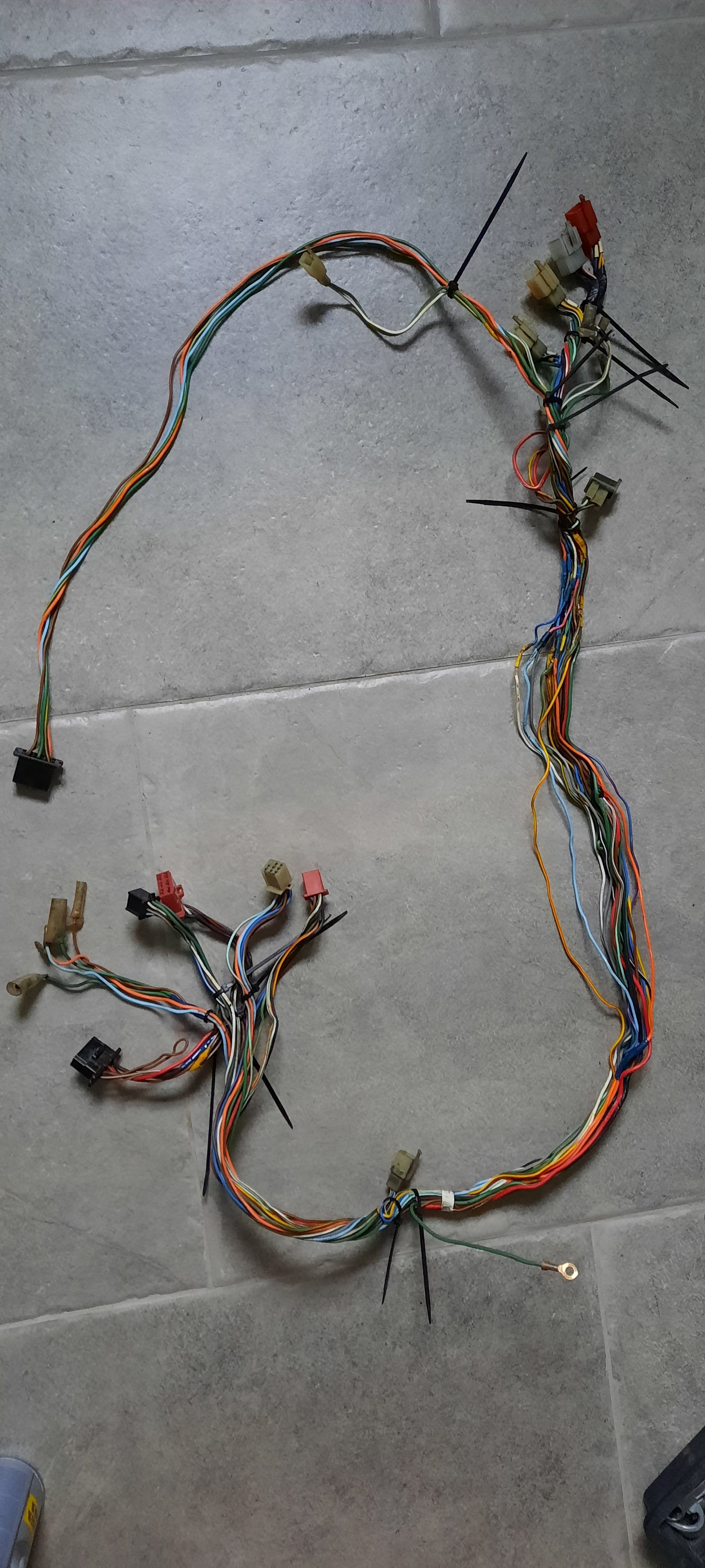

Also took the wiring harness out and stripped it down, found out why I had some bad connections towards the taillight...

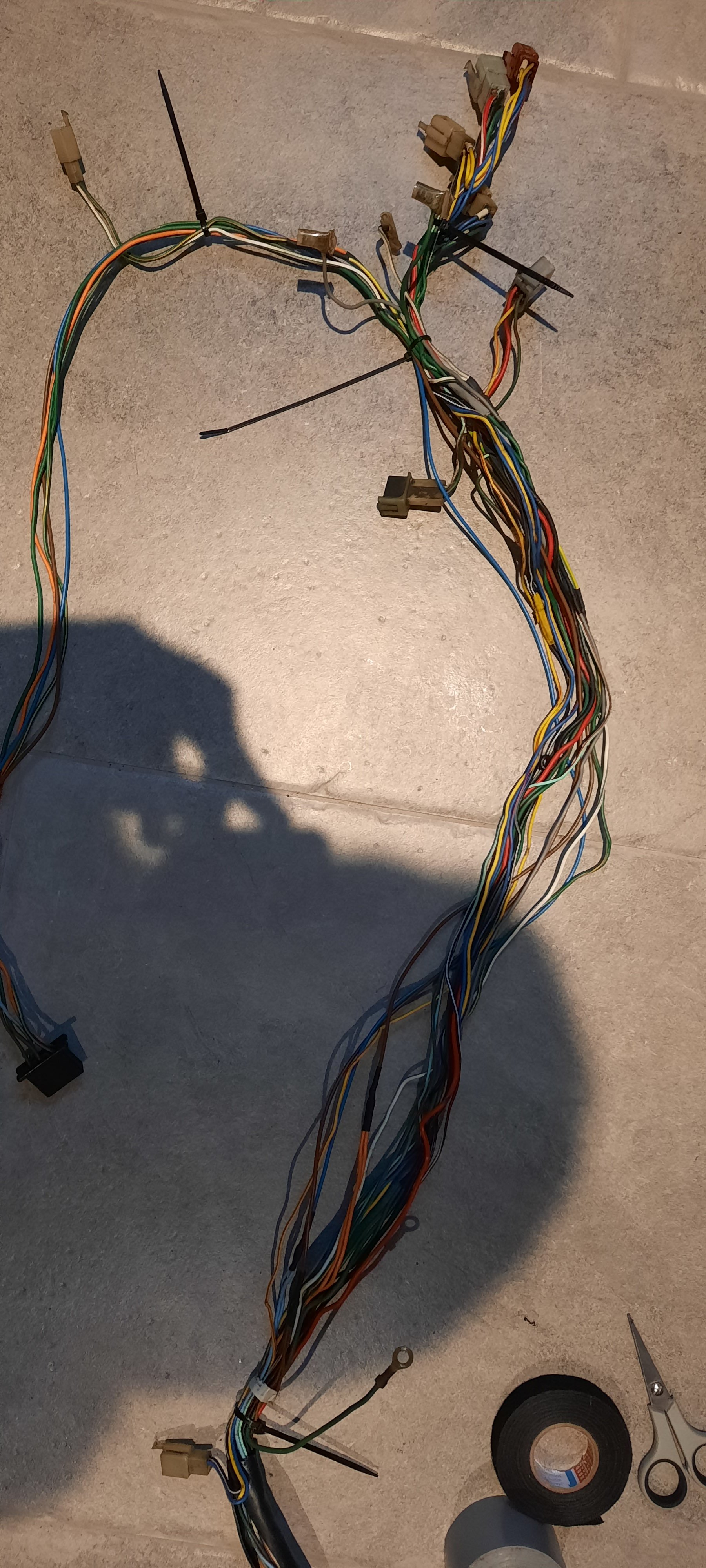

Some old twist & tape hackjob / bodge was revealed and fixed it with new wires, solder and heatshrink.
All taped in and ready to go back on. Connectors cleaned with contact spray
