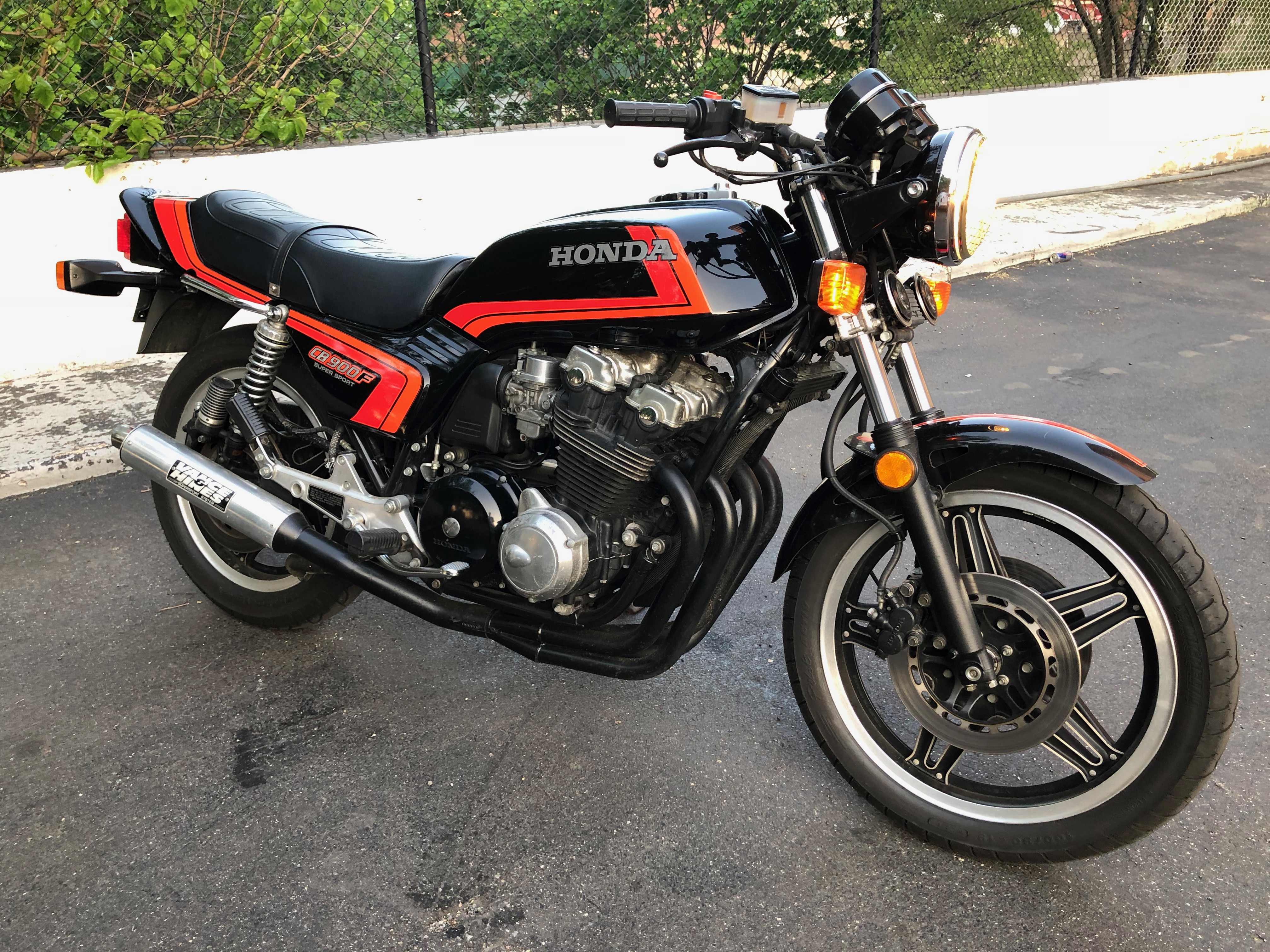

Picked up an immaculate 1982 Honda CB 900F with 8k original miles. The seller couldnt figure out why the battery kept dying. He changed the Stator, Rotor and Reg/Rec, still low charge, like 12.5 at 3k RPM.
Any ideas on what it could be? I enjoy riding, but with a wife and a few kids (one of them 3 months old) there's no way I can devote a lot of garage time to this. I had a quick look at the connections and all seemed well. If it comes to it, I will have to hand this bike off to my mechanic to fix, hes is kinda pricey but, I want to get this bike running right and have a decent budget (over $400) to devote to getting it hashed out.
Ive attached a pic of the bike.

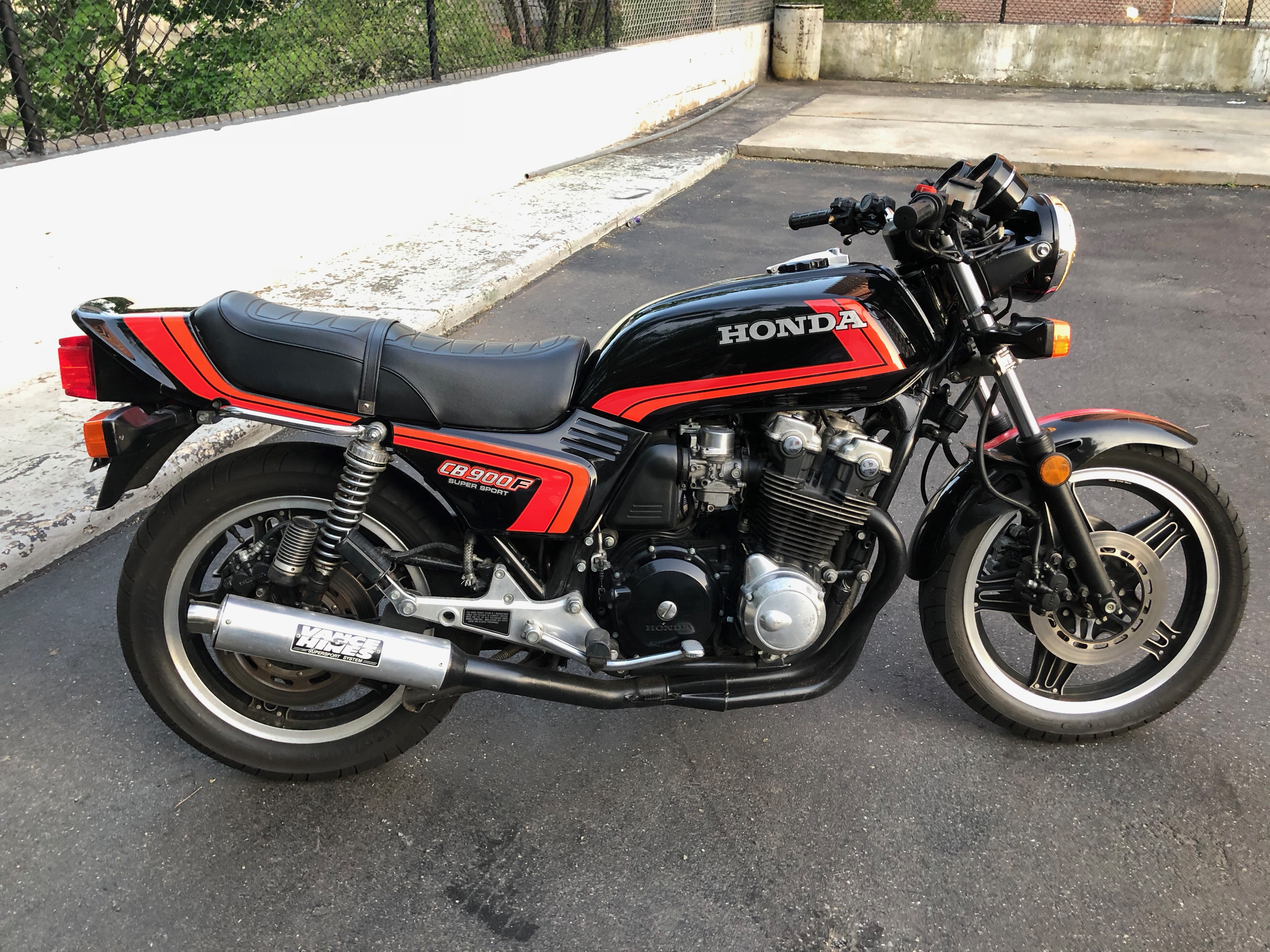

Checked the gauge, etc on the positive line. Its 12 gauge and seems to be ok. Guess its something else. Here are more pics of the bike. Can barely wait to get it running:

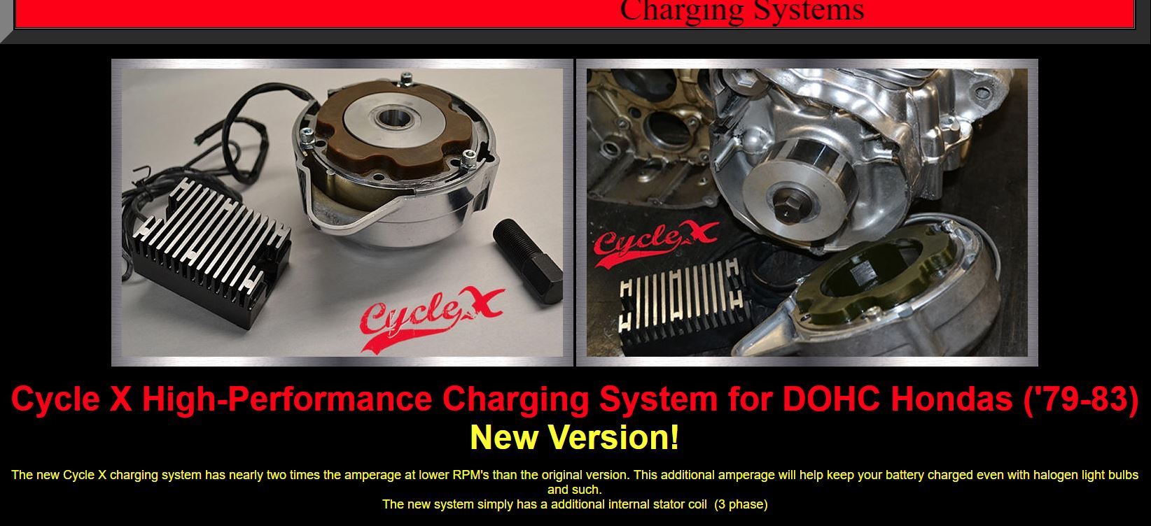

Im going to upgrade to this system.

That's not a Lucas 3 phase alternator is it? Looks just like the one I fitted to one of my Triumph twins back in time.
Cycle X made it. Not sure of the specifics but man oh man i cant wait to install this stuff. Comes next week.

that what the last two owners did and it didnt solve the problem. I chose this system because i'll have more amperage at low idle, a lighter rotor (stock is 4lbs, the new one is 1.7 lbs) no alternator brushes etc. Its like getting a new lease on life.
