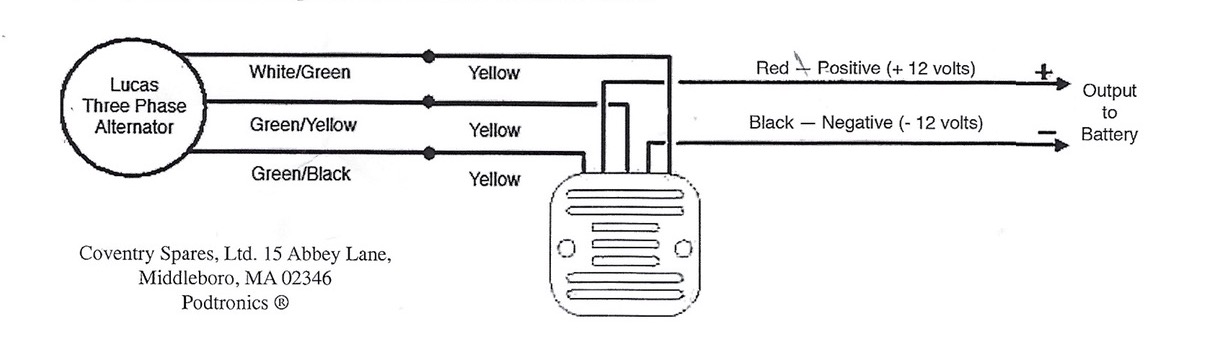

On my new regulator, there are only two wires going from the regulator to the battery connector,
red and black.
However, on the OLD connector going from the battery to the connector into which the regular connector plugs in, there are THREE wires, black. red/white, and green. What gives? Do I eliminate one of those wires?
And which does the RED from the Regulator plug into and which does the BLACK from the regulator plug into? I hope this makes sense.
Is there a green wire somewhere else? I would be concerned that the R/R is not the correct unit for your bike if it doesn't have a green wire.

I should have said, its a completely new unit which replaces ALL of the charging system. Though it says Lucas, its the Cycle X system. See below:

Sonreir said:
That's fine then. Two wires for new unit is what the diagram shows.
So, as someone advised, and Im just asking so others might benefit, the black wire (in the female connector from the battery) gets capped off and the RED from the Male connector on the new regulator goes to red and white , and the BLACK to GREEN with the black capped off?
If it were me, I'd bypass the harness.
From your new unit, ground the black wire and run the red wire to the battery positive terminal or the hot side of the solenoid.
Ok will do! Ground to the chassis i presume?
