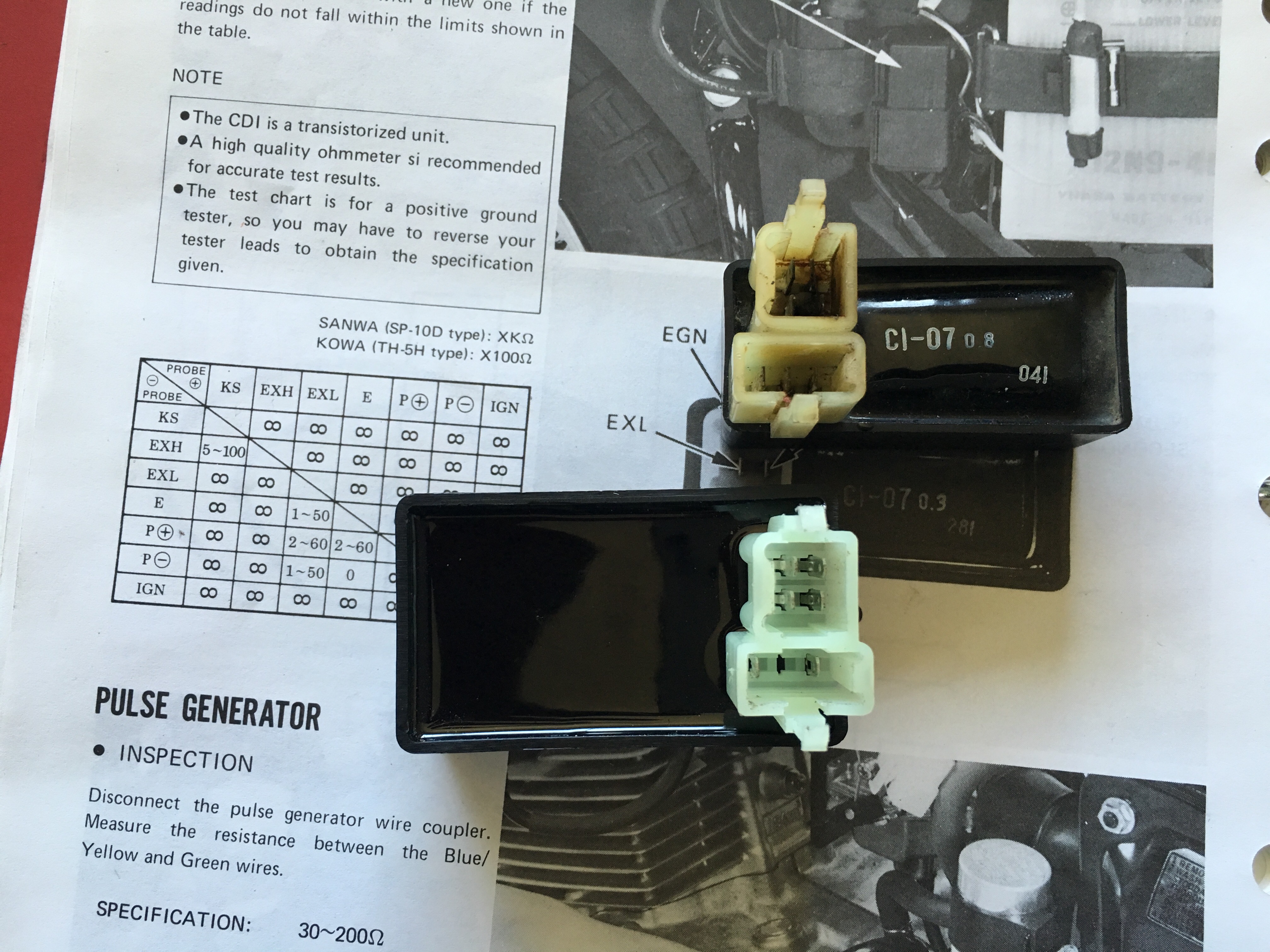

Has anyone tried an aftermarket CDI that they can recommend? I cannot find one that is 7 pin. The one I received is 6 and I still think it's not correct cause I am not getting spark. I know coil is to spec now since I review the manual and tested.
http://www.ebay.com/itm/CDI-MODULE-BOX-HONDA-CT110A-CT110AC-MOTORCYCLE-CM200T-CM200TC-TWINSTAR-wo-Elect-/151755355997?hash=item235552f75d:g:-OsAAOSwVL1WDDcW&vxp=mtr
or post a picture of your original box and i will see if i have one i know is good
It's the one at the top of the image that is 7 Pin not 6. The one below is not correct.
I have a 7 pin from a 1980 CM200T that I'm not going to use. Can't tell you if it works, the bike had a frozen motor so I never tested for spark, just ripped it out and swapped in my 250 motor with the 250 harness. I can send it your way for the cost of shipping if you want to give it a shot.
Thanks to CALfeRacer for the CDI. Plugged it in and it fired right up. Good to know that the new one offered by Amazon is incorrect by stating it works for the bike. Appreciate the help by everyone and especially CALFeRacer for giving me that CDI!
