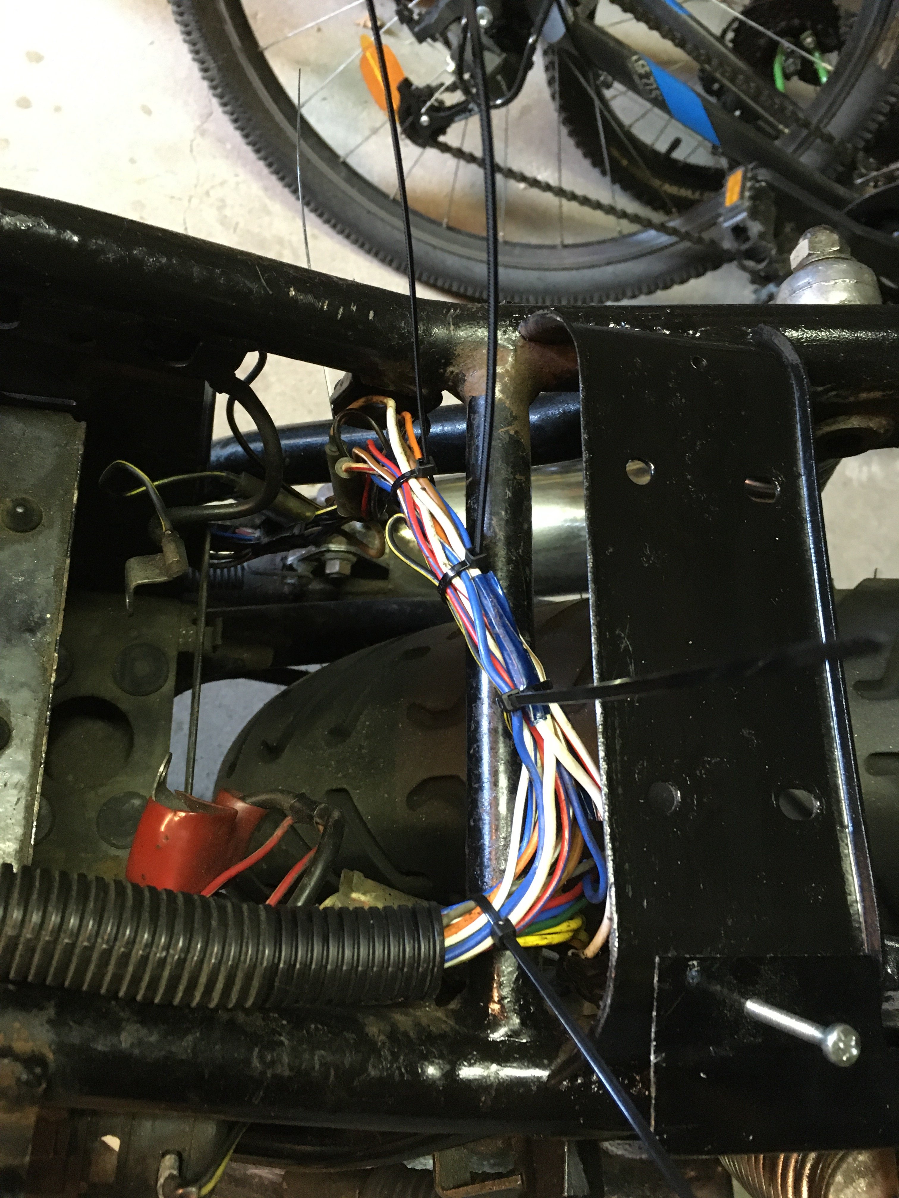

cleaned out the wiring and rearanged it.
i will first test all the functions of the controls and stuff before i re-tape the wiring.

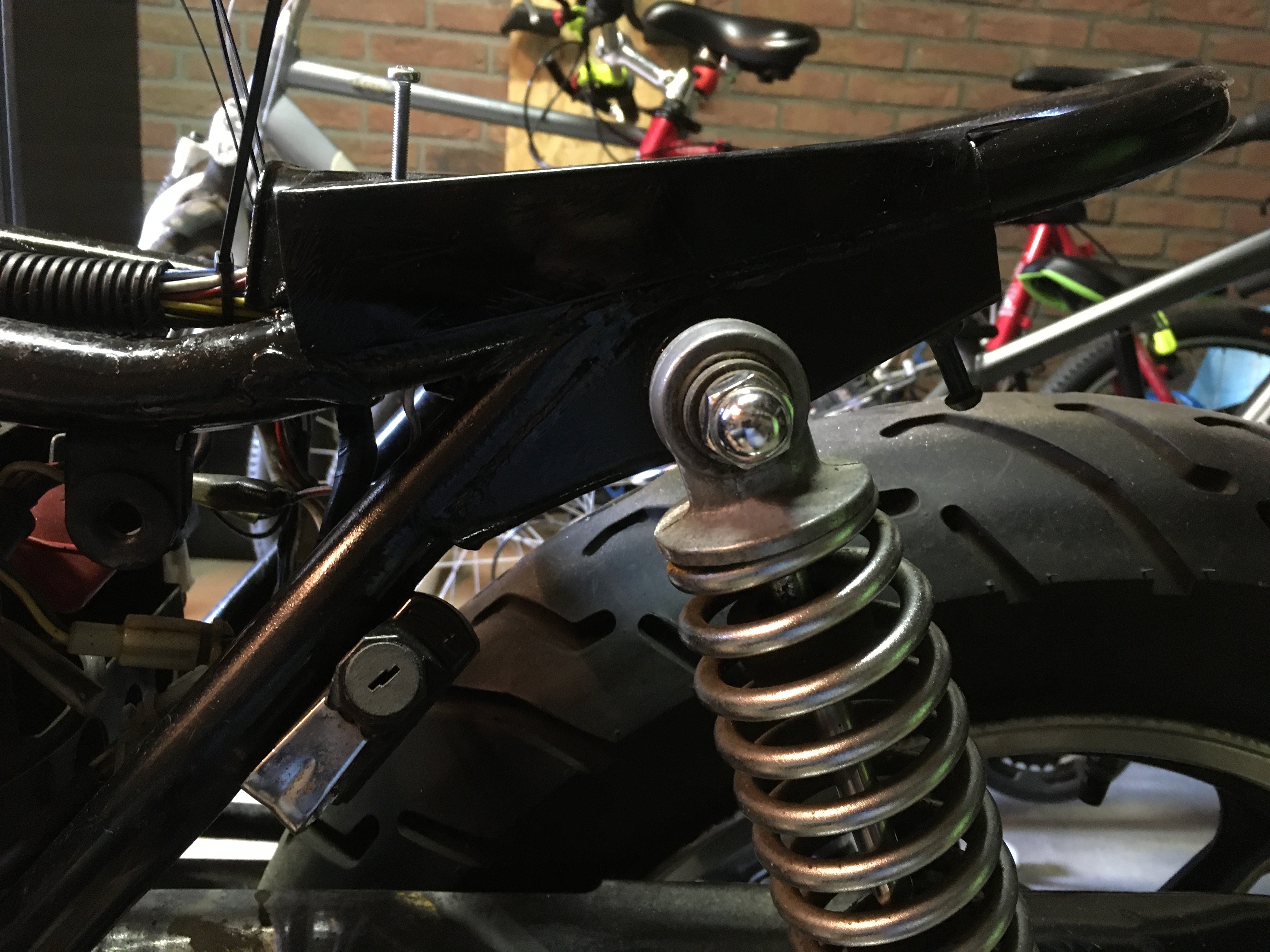

painted the rear to get rid of some scuff marks, cleaned the rust etc.
bracket to close the gap at rear of the bag.

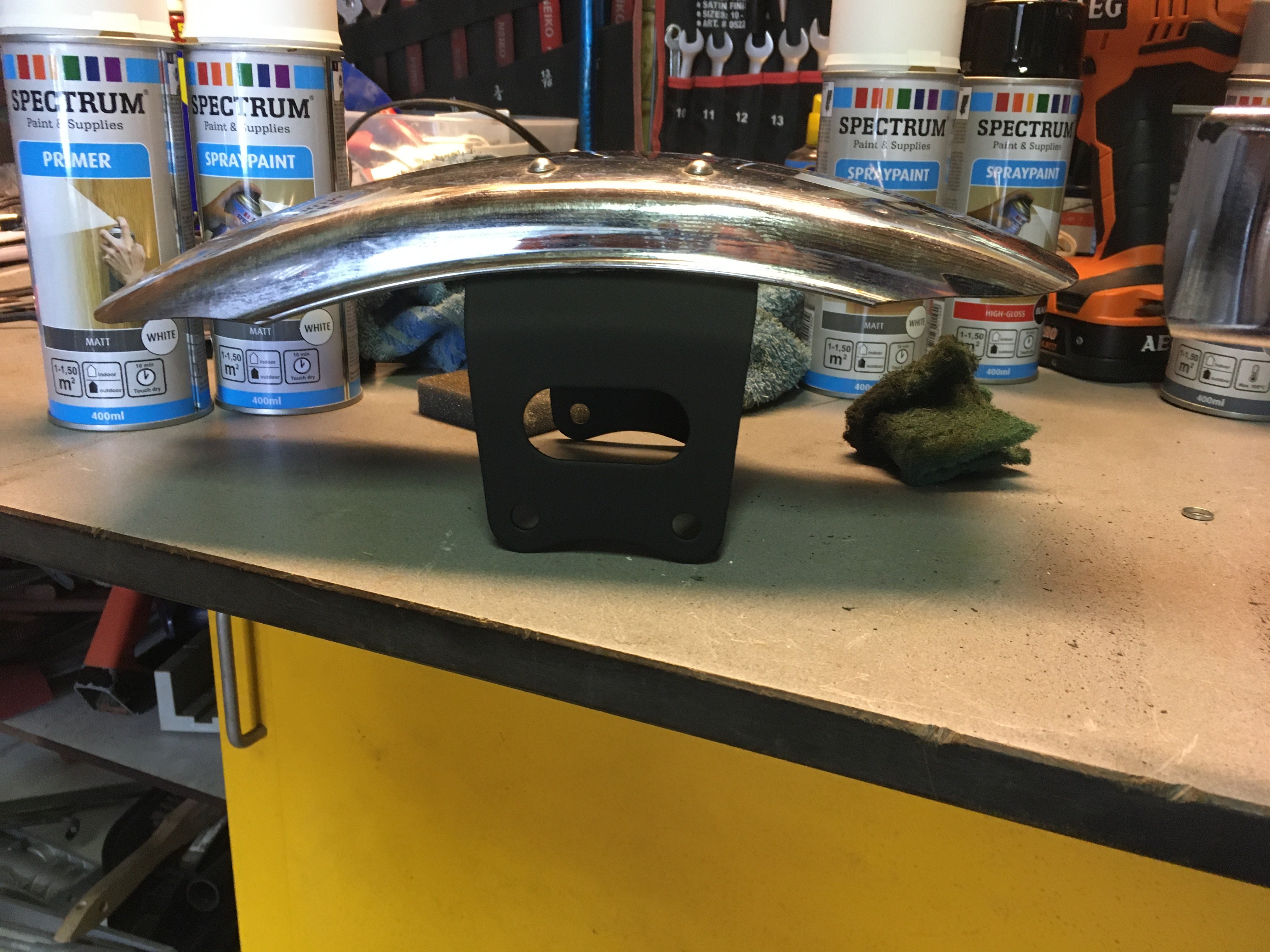

since the rear fender had to come if painted the brakets
buffed out the rear fender a bit.

wiring is ok, re-taped most of it already. had the bike running but it didn't idle properly.

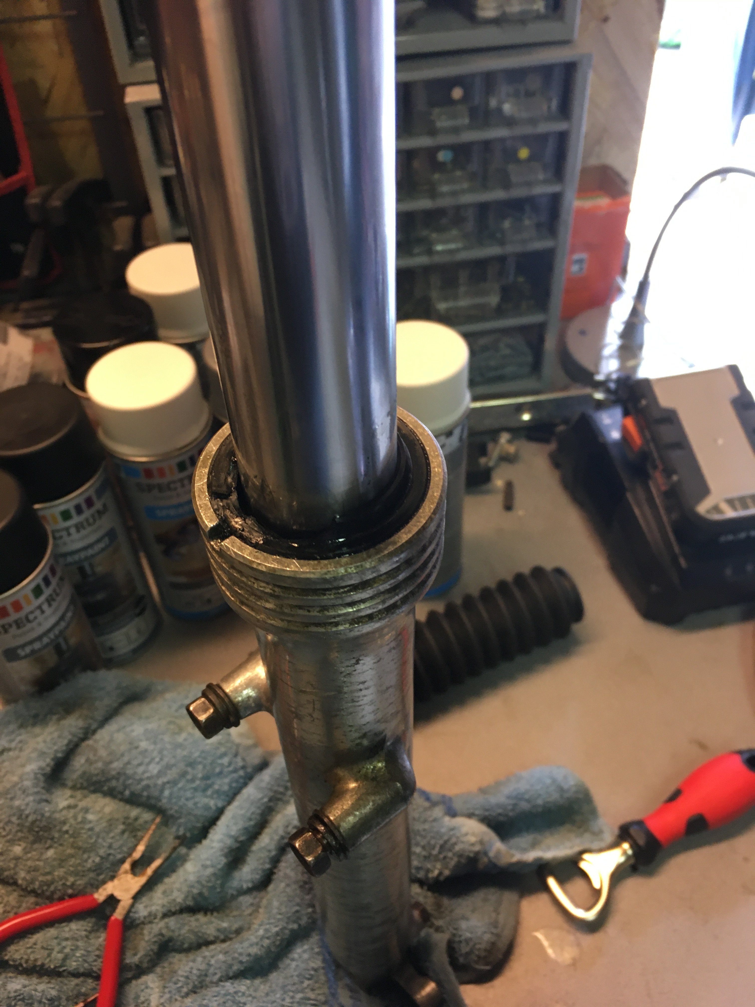

removed the right fork and dismantled it.

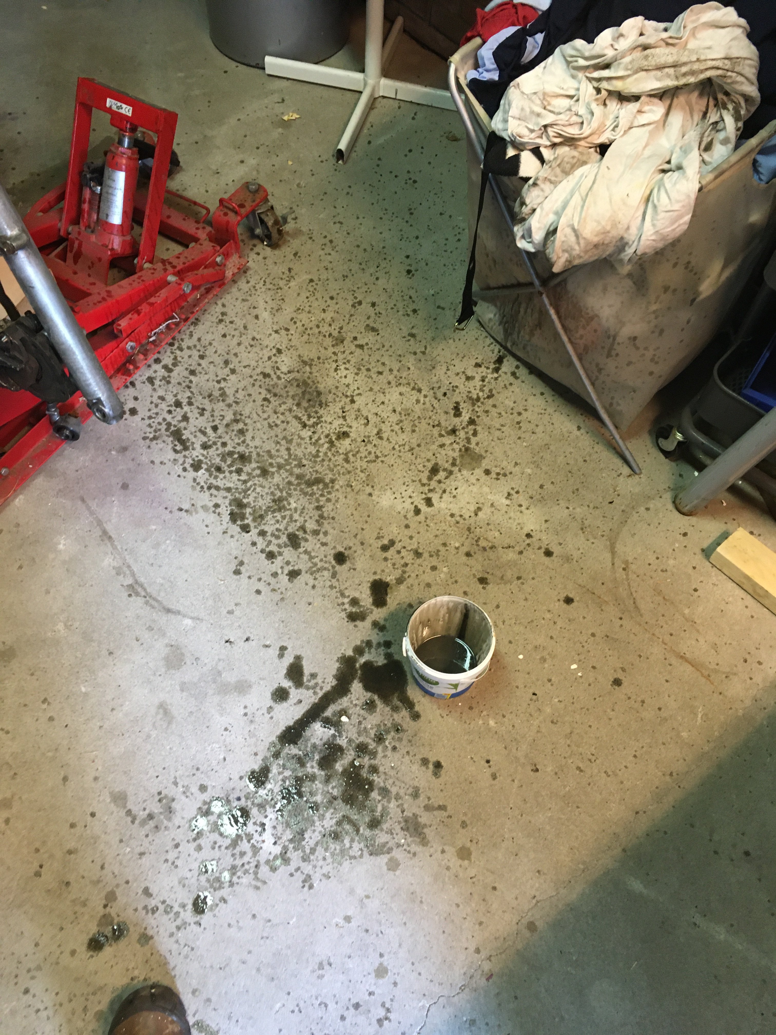

before loosening the lower bolt i wanted to drain the oil, lesson learned during this exercise: release the air inside the tube prior to opening the oil drain screw!
my idea was that if the seal is leaking, the air is already out, somehow i was wrong!
not sure how to call this:
on the plus the oil drained very quick, if you can call this oil, smelling it didn't remind me of any oil i'm familiar with!
top seal was a @#%?! to get out, the oil sealitself popped out easely by the use of 2 screwdrivers.
have this scratch on the inner tube, i'm now polishing it out. in the hope that with the new seal it won't leak anymore.
also painted the lower part in a flat black.
new parts ( seals, dust capes and oil ) should arrive prior to the weekend so then i can assemble this one, should be sufficient time to let the paint harden out, after that the other will be foreseen with fresh oil and a paint job.

disassembled the other fork.
seals come out easy, ones you have done one the other is much easier to dismantle :)

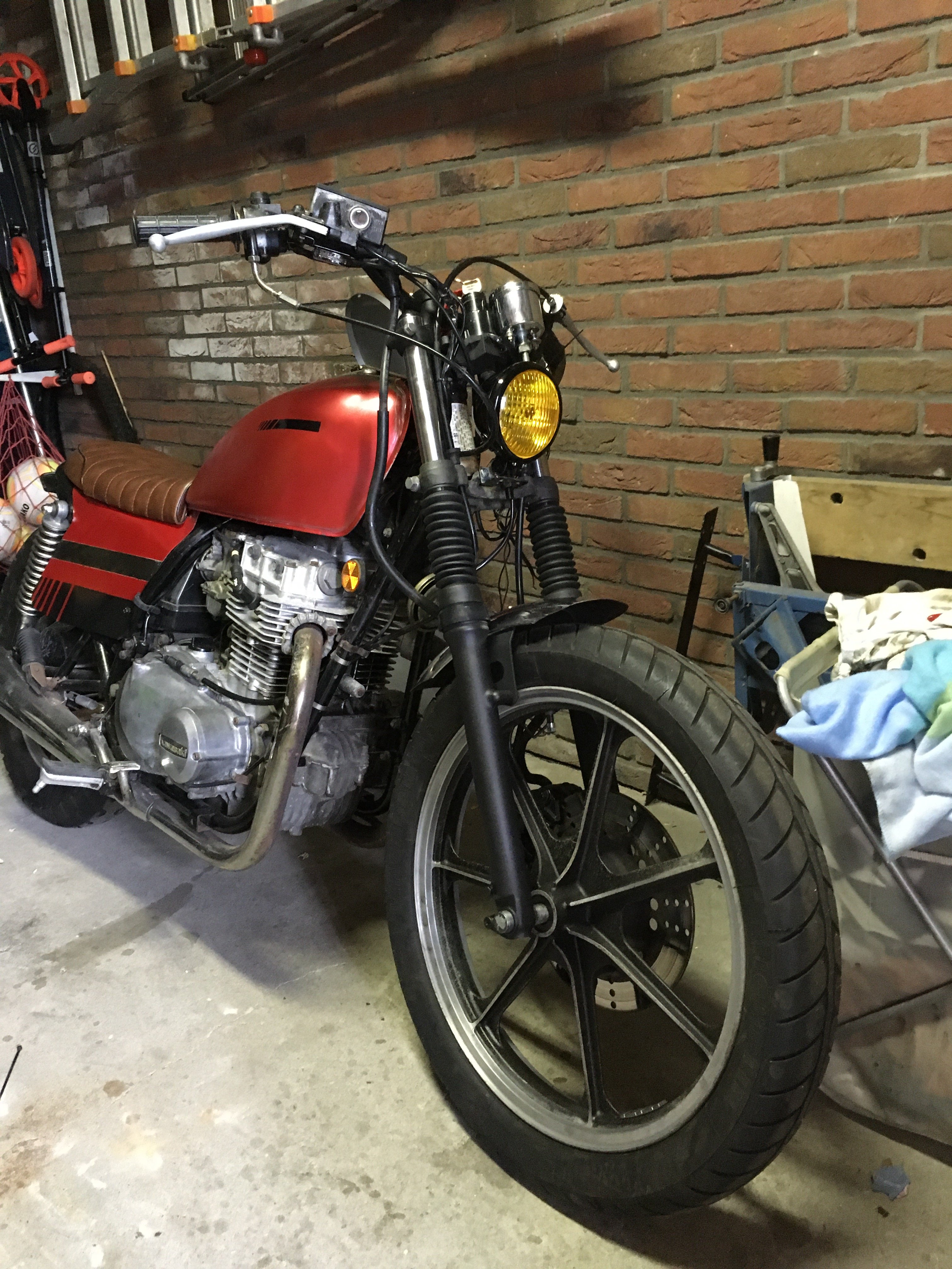

front end rebuild, new blinkers installed and new headlight installed
still some minor details on the to do list for the front end but that can wait.
new intake rubbers for the carbs are also in so that's next on the to do list, then get it properly running and then go from there.

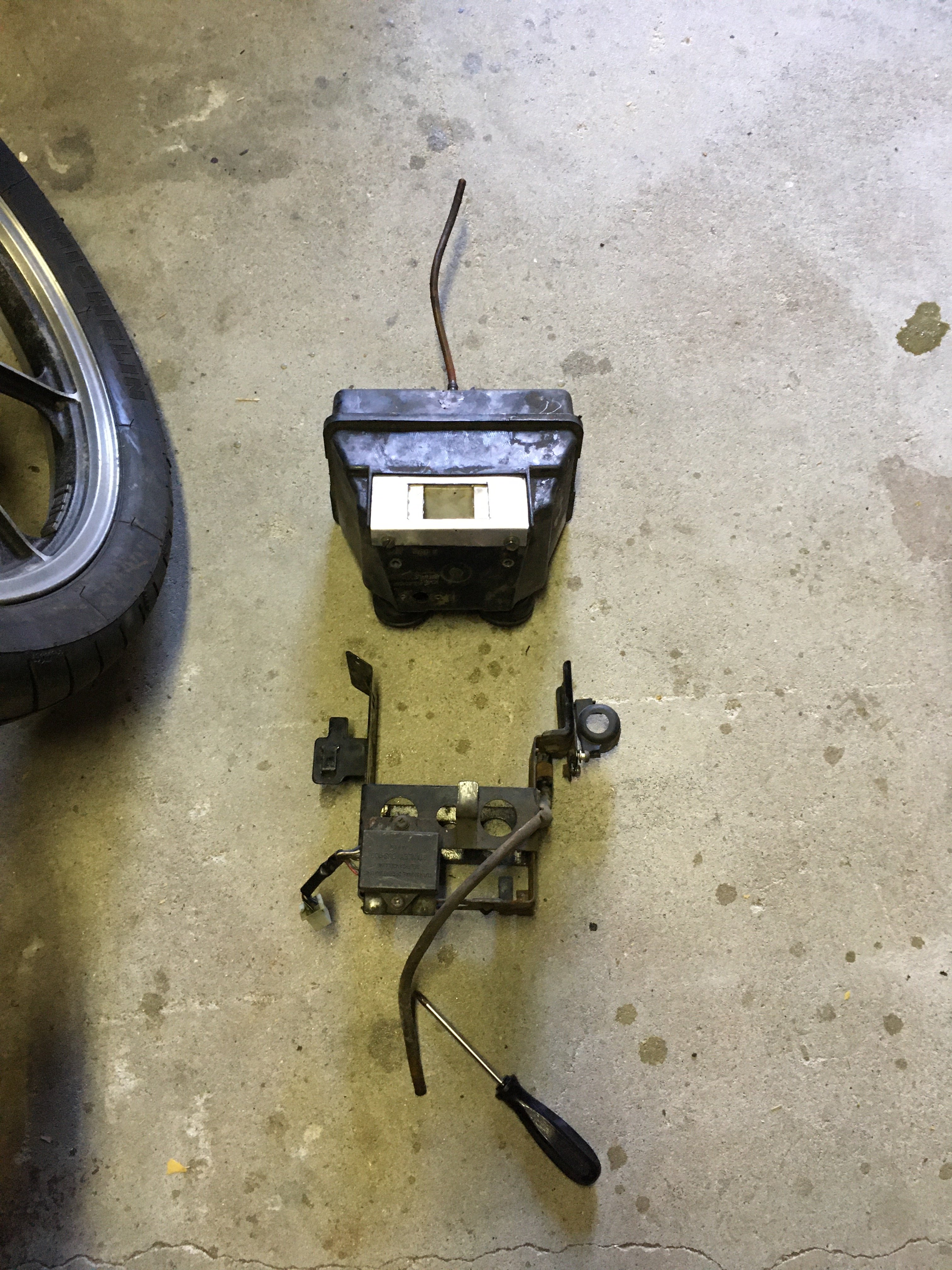

pulled out the air cleaner box and battery tray to get to the intake rubbers
already cleaned the air box, battery tray needs a cleaning and a paint job. However rectifier is locked in solid with the screws. WD40 shall hopefully sort that out.
