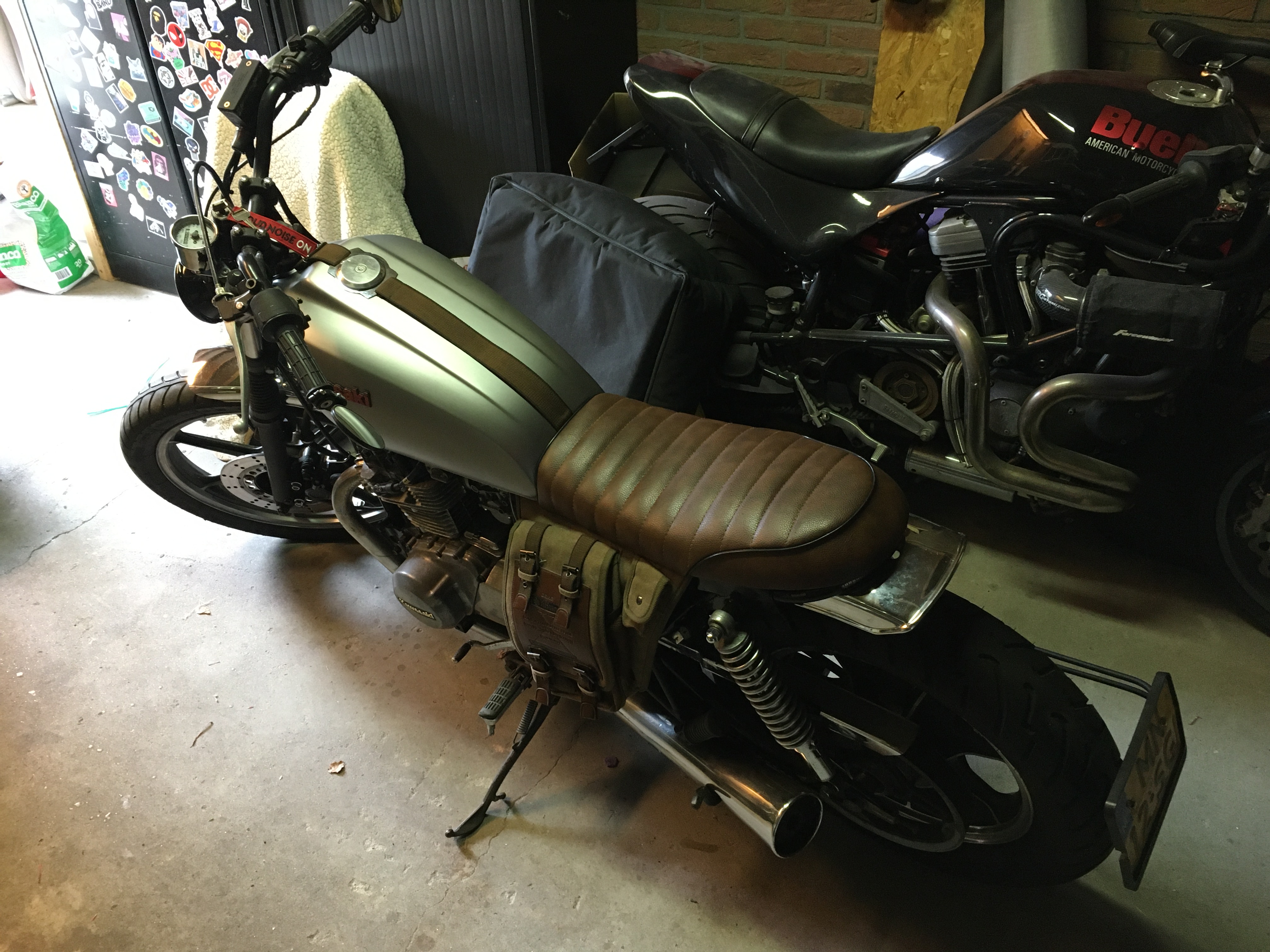

1983 Kawasaki LTD 440 brat/tracker
done with it for now!!
new paint scheme, now it is time for the weather to improve and test her out.
it's still a low cost built and she showing her age, which i'm totally fine with!

It has been a while, did some minor adjustments on the bike. Made a heritage badge, refitted and secured the gastank. Adjusted the mufflers so that these aren’t rubbing anymore. Currently she’s running only on 1 cylinder. New plugs are on the way, hopefully a quick fix.
