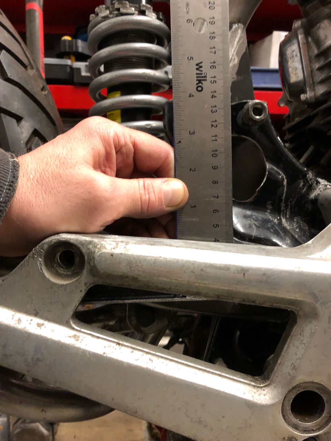

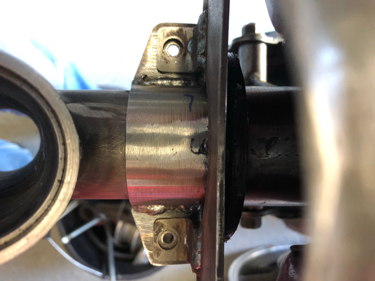

Today I managed to fabricate the left hand top shock adjustable mount so I could actually mount the shock and test out the angles. When on full comprehension the shock is as near as damn it at 90 degrees to the swing arm pivot, it is tight to the frame but there is 5mm of clearance (the perspective of the picture doesn’t show this).
I loosened the spring off to enable the shock to go to full compression and then did it again without the spring in place. I might move the lower shock mount back by 5mm yet still. Anyway disaster adverted.

Having listened to the views on here, I decided that I would extend the lower mount of the rear shock. So I made a soft metal clamp to grip the damper rod in the vice. I then attempted to unscrew the lower mount, but it wouldn’t budge, so I apply heat, but still it wouldn’t budge.

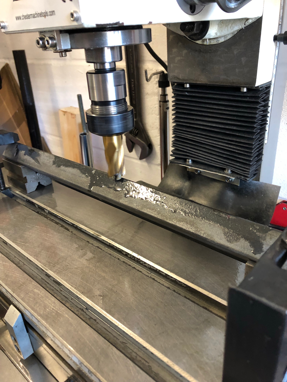

So giving up on that I decided the only way to remove the mounting eye would be to machine the mount casing until I could see the threads.

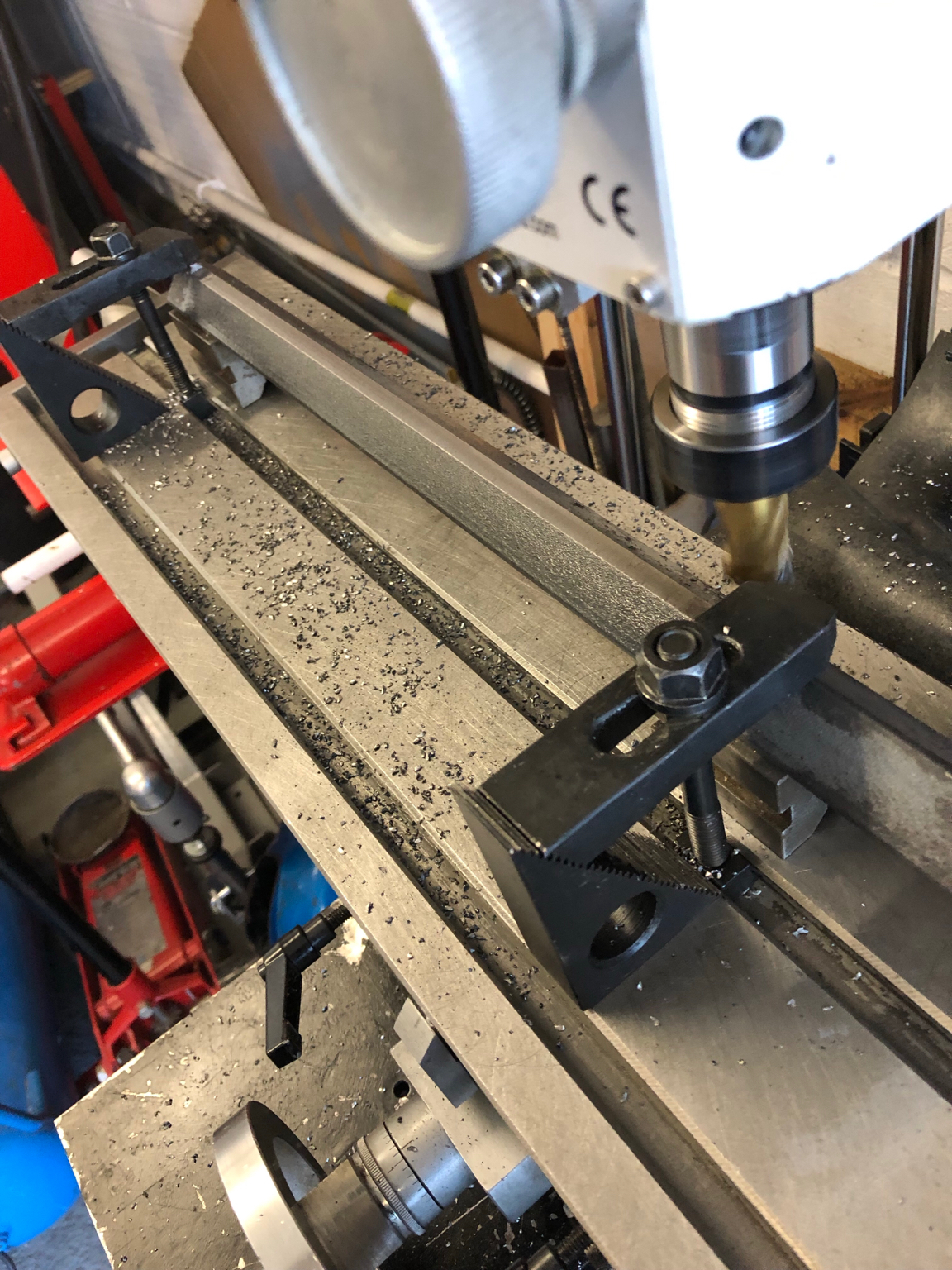

Mounting the shock on my mill, I measured the damper rod to ensure that I didn’t cut to deep before exposing the threads.
So I milled to the required depth and still couldn’t see any threads. I decided to go a bit further, but still no threads. Anyway after some more messing about I’ve found the reason I couldn’t find the threads. The reason being is that there isn’t any. It appears the lower mount/eye is fusion welded onto the rod. At first I thought it was an interference fit. But when I got another shock of the same type, it was clear to see it was only welded onto a 3mm washer. I find this quite surprising.

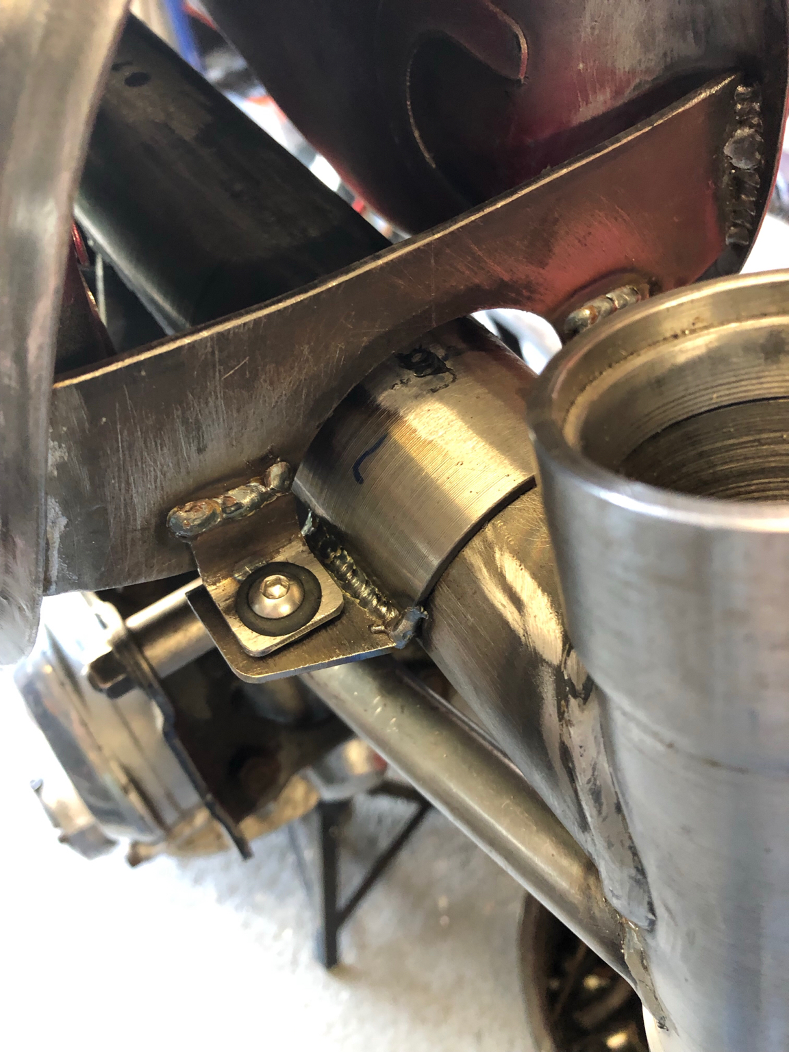

I’ve decided to move onto getting the rest of the bike sorted as the rear suspension was taking too much time and affecting my motivation. Although I’ve called my project a Cafe Racer, I’ve decided to make it a Brat Tracker. I’ve mounted the handle bars.

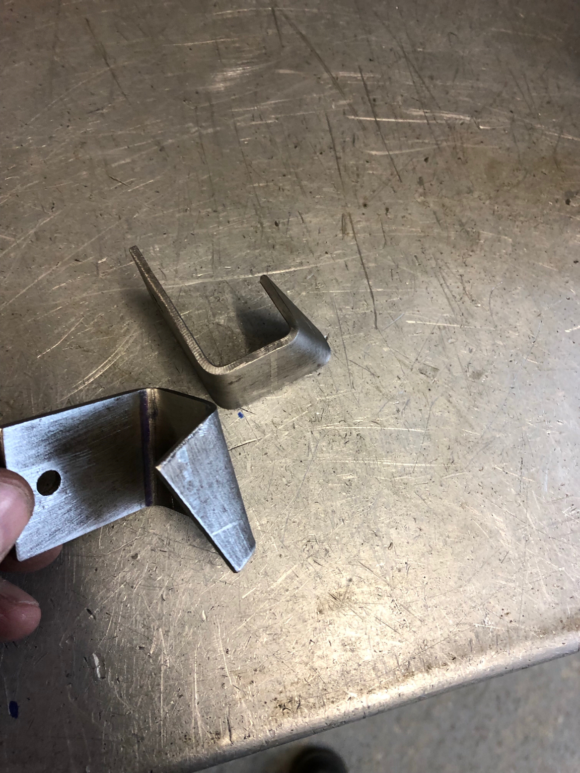

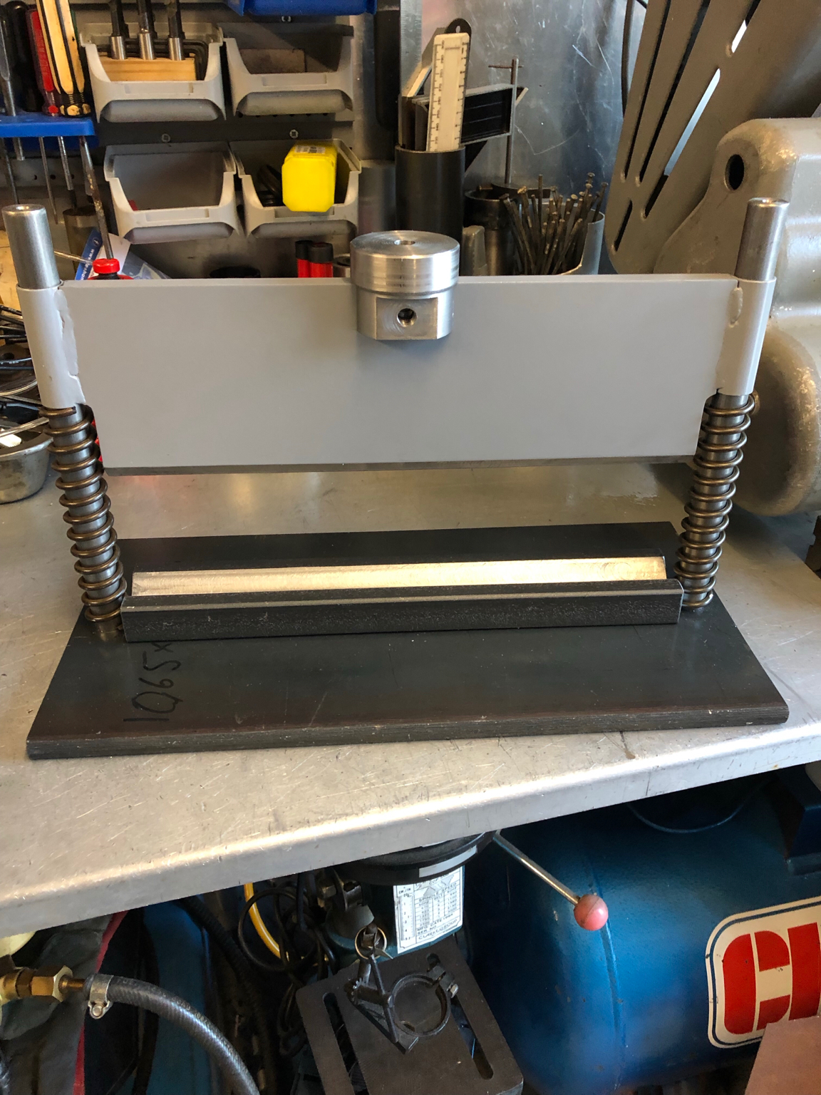

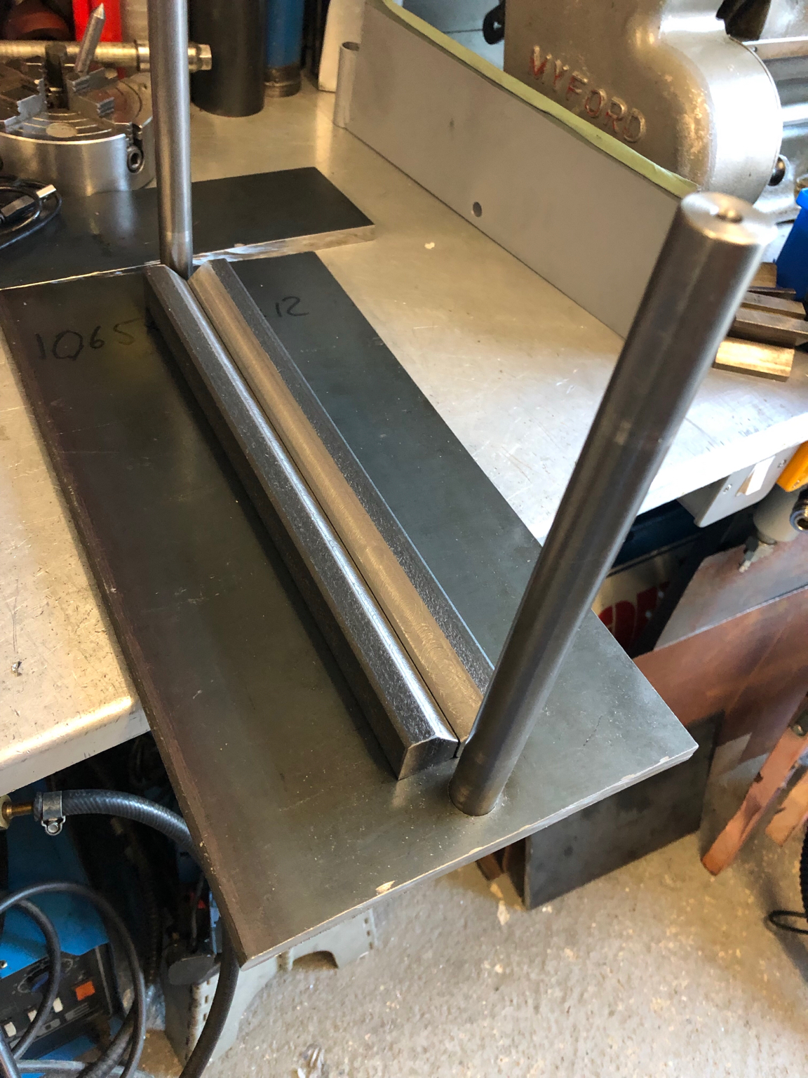

In order to make brackets and other stuff, I need to bend plate and stock. Getting fed up with using a vise and hammer to bend things badly, I’ve make a press brake.

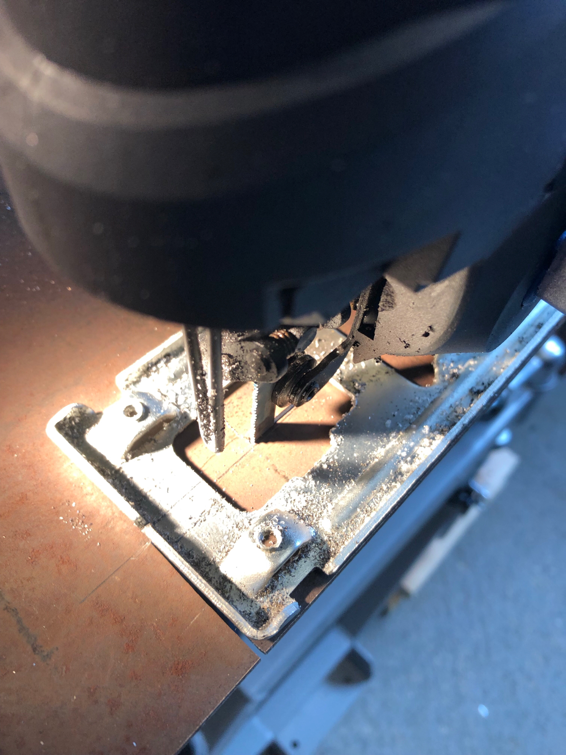

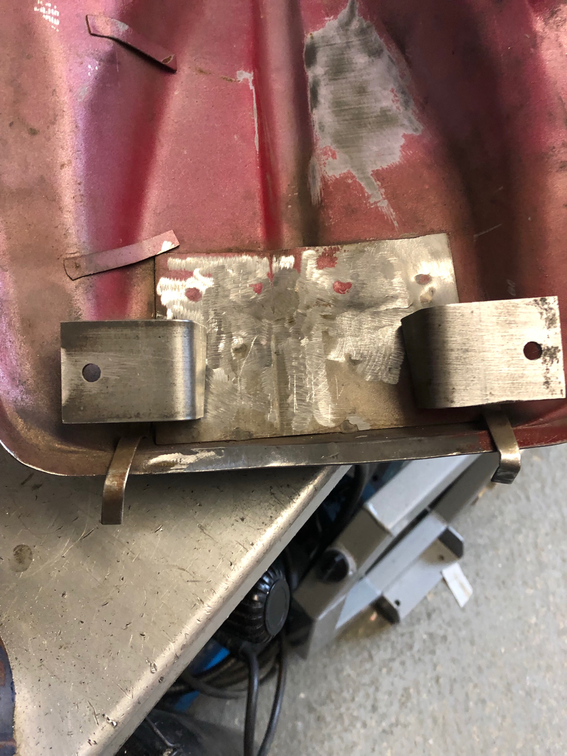

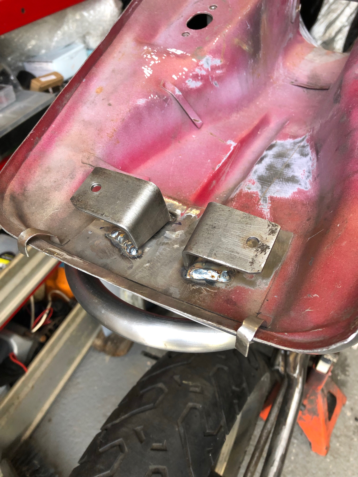

Cut out some 2.5mm plate for rear mounting brackets for the fuel tank. Bit more finishing to do and then weld onto the tank. Really pleased with the press brake as I can turn out quality parts.

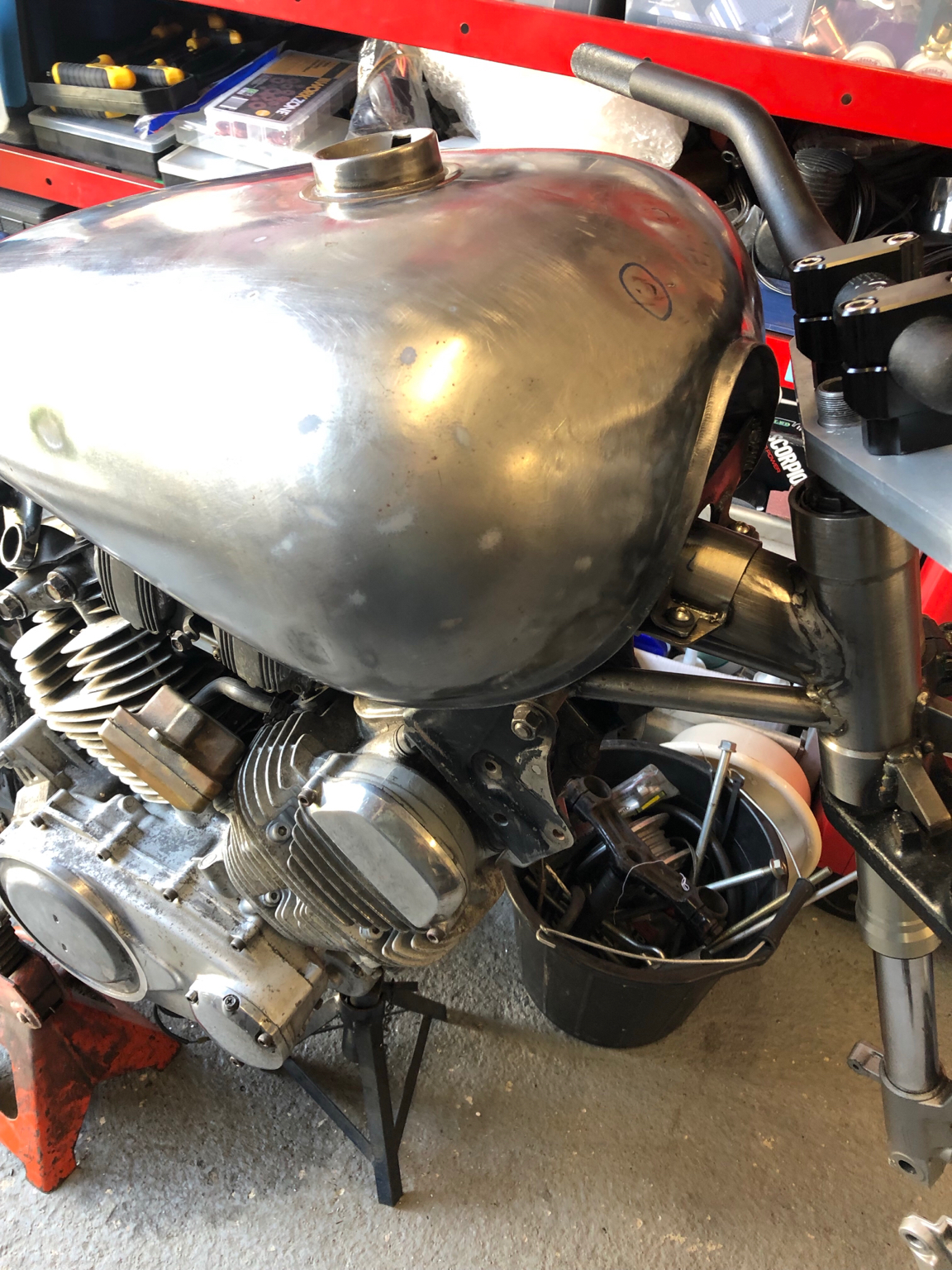

I’ve welded the mounting brackets to the tank and made some mounts and brackets for the front of the tank. I was going to use the original mounts on the tank, however these were in the wrong place for what I wanted and they were not even symmetrical, so the tank sat on the piss. Hence I’ve made a load of new mounts.
Now that the tank is mounted, I’m going to build the exhaust and make some rearsets.

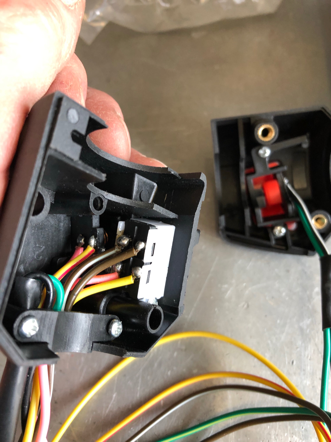

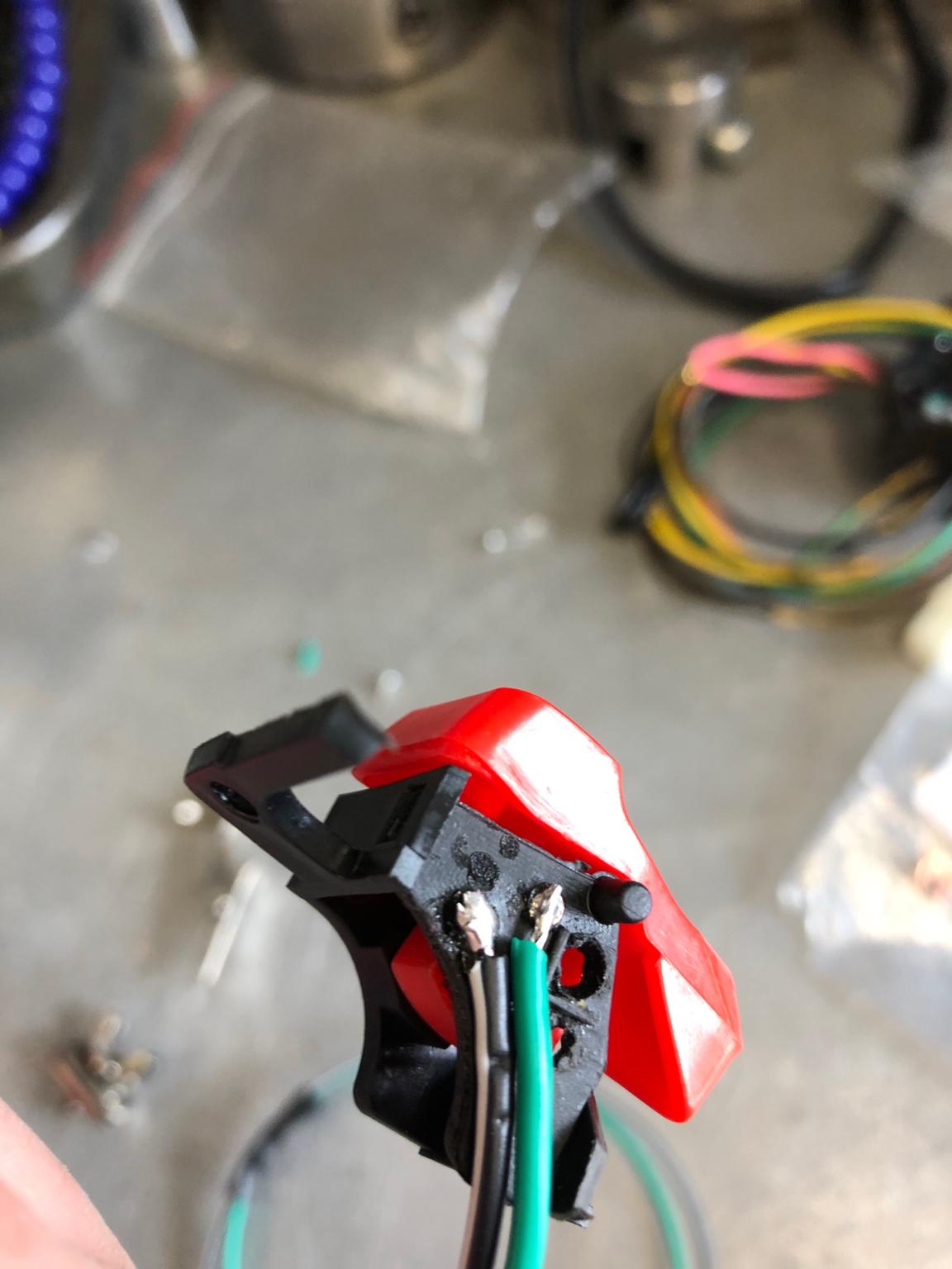

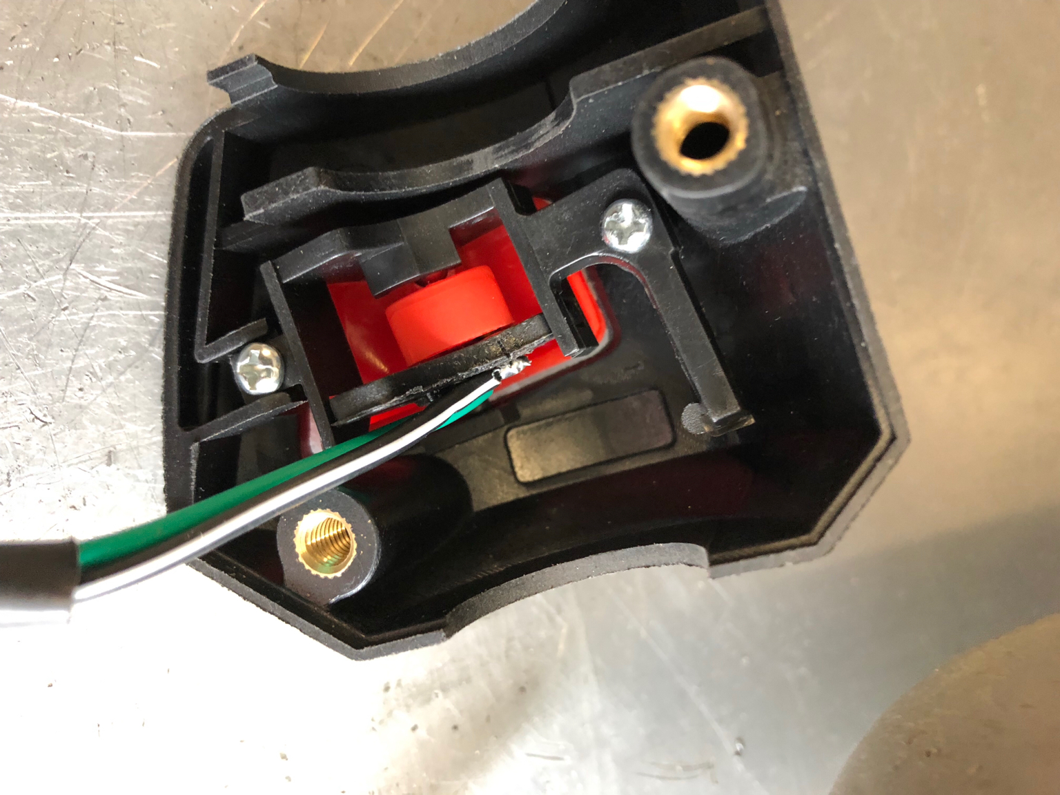

Decided to do some fiddly jobs today. I’ve rewired the switch gear. It’s cheap Chinese, but I’m impressed with the quality, near as damn it to Jap switch gear. The reason for the rewire is that the kill switch was arranged to make the connection when in the off position, which some systems use as they earth out the ignition system, thus ‘killing’ it. However on my set up I want it to make the circuit when in the run/on position.
The internals allow for the repositioning of the contacts. I removed the original contacts with a view to re-using them, however this was not to be.
To make new contacts, I ordered some copper rivets, which fitted perfectly, then just soldered the wires onto the crimped rivers. All works a treat now.
