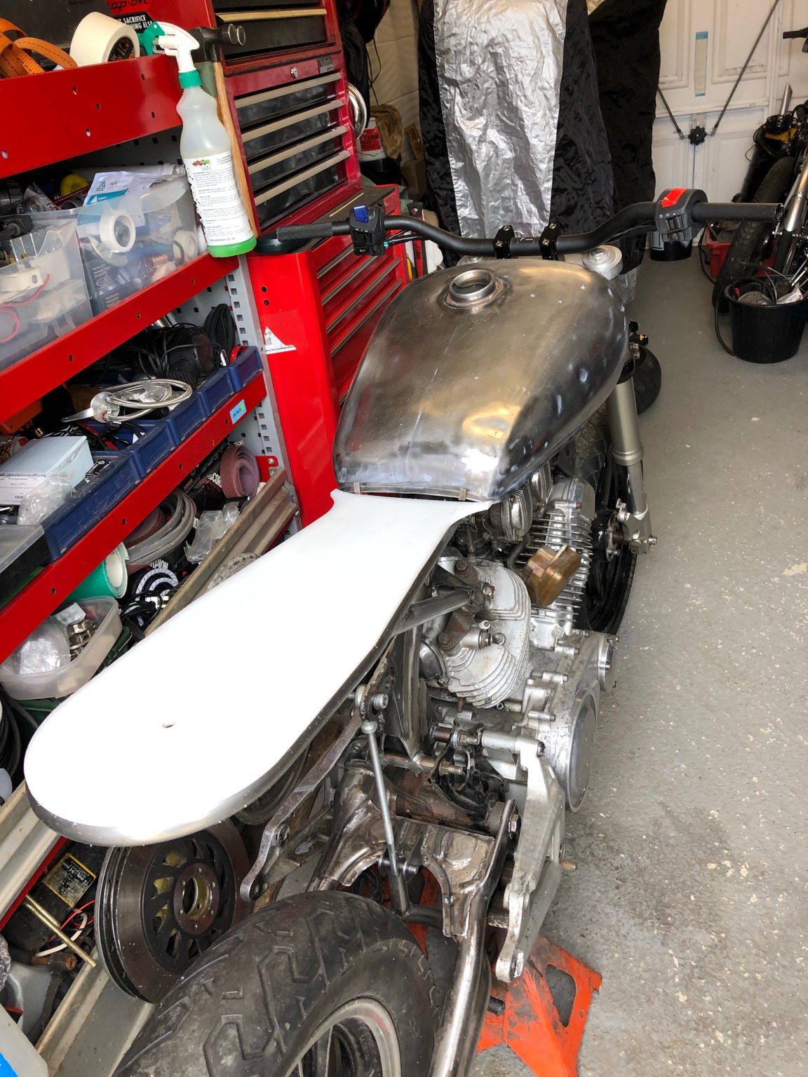

1983 XV500 Cafe Racer

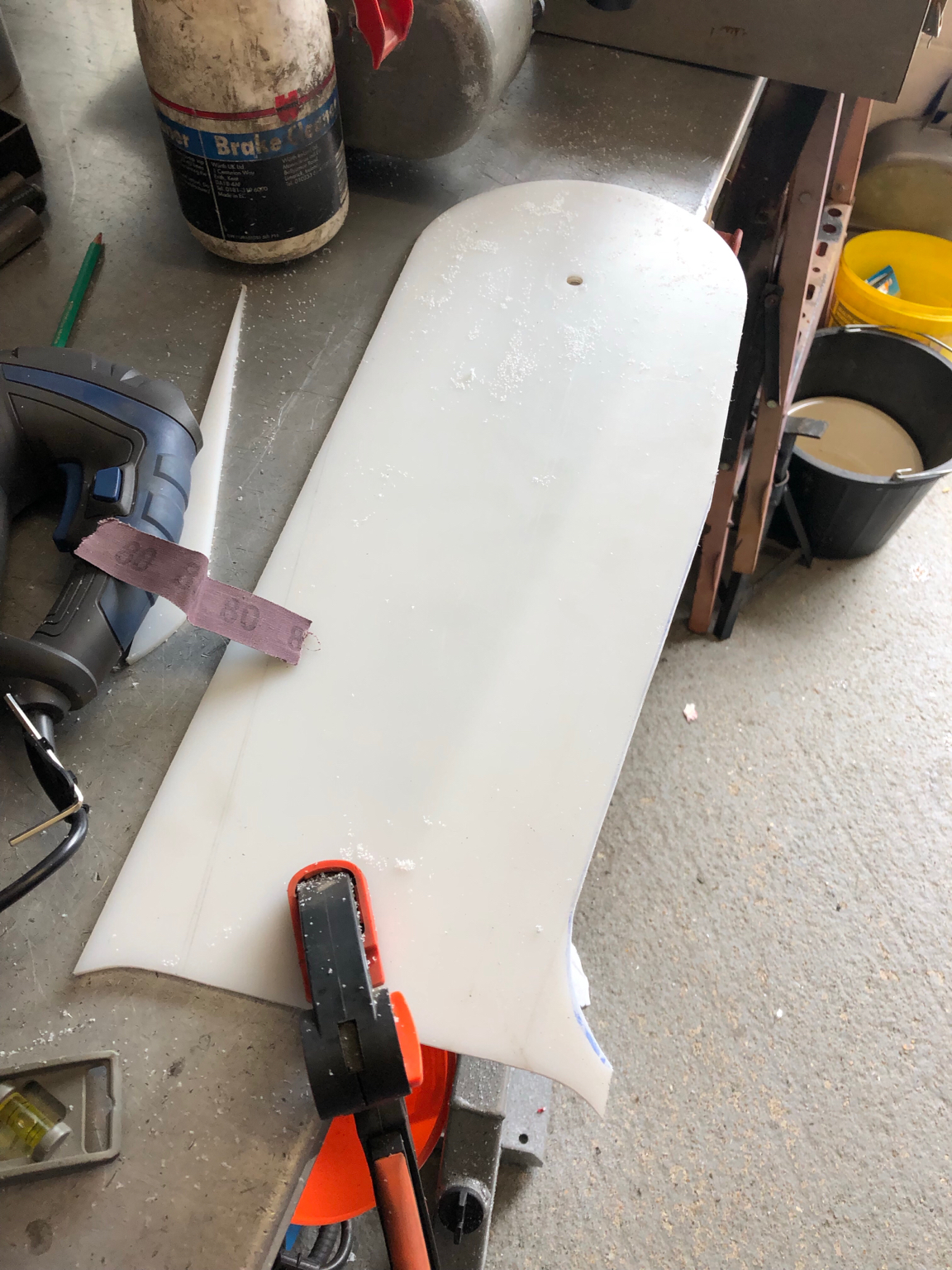

Did some work on the seat pan today.

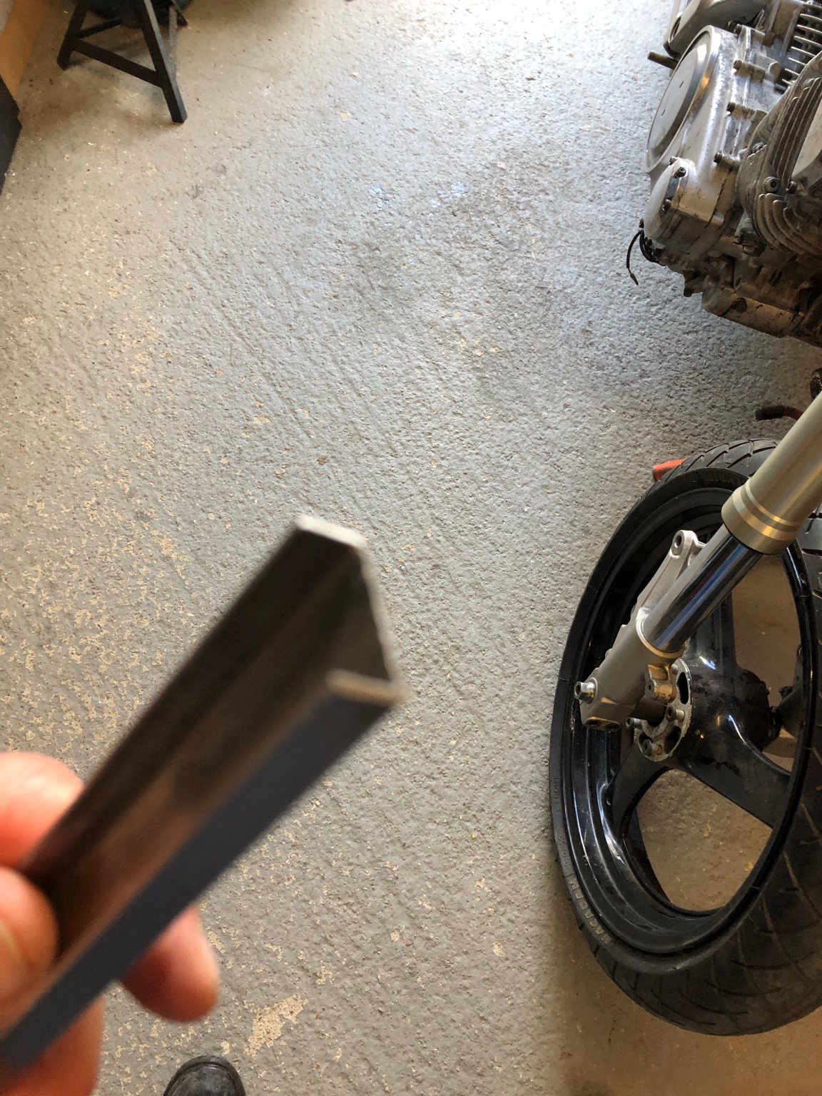

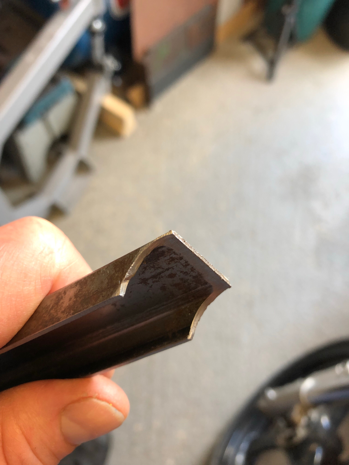

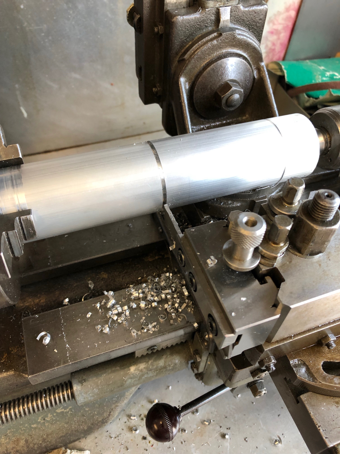

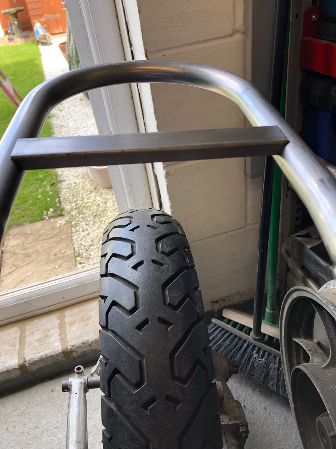

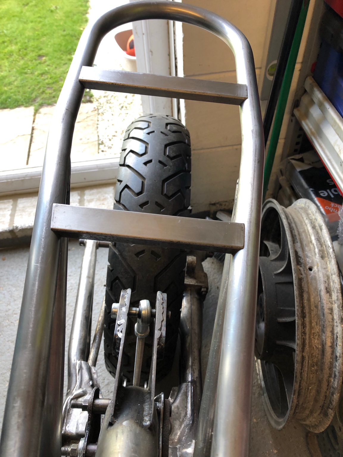

Made the seat mounting spars today. Used some box section and sliced it in half, then shaped it to fit using a end mill the same diameter as the subframe tube.

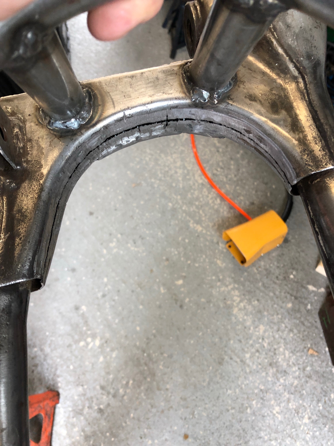

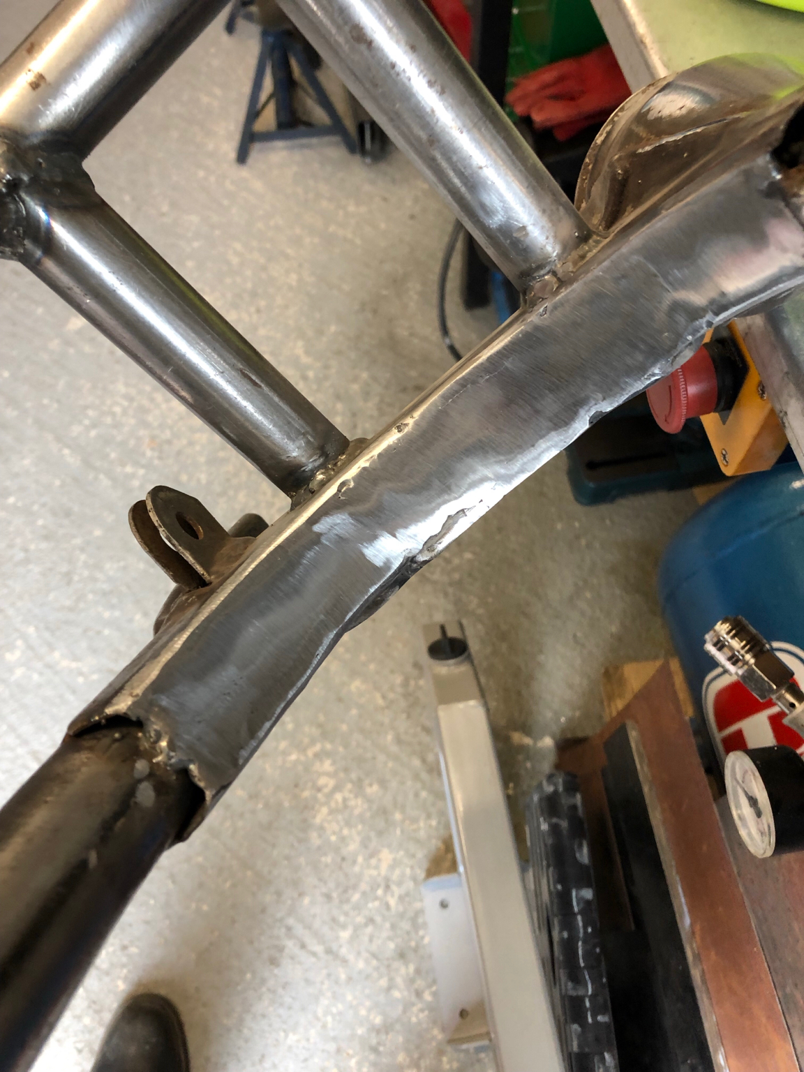

I’ve cut the ‘joining rib’ off and I’m going to weld in a flat piece to tidy it up.

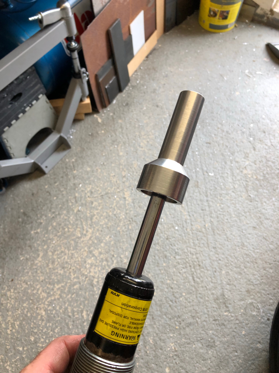

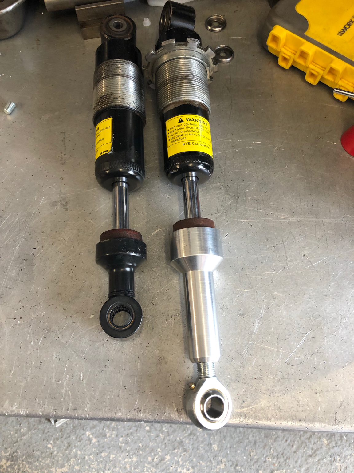

I’ve remodelled the lower shock mount on the swing arm and also manufactured a new lower shock end/mount.
Awesome work.
How does the new shock mount attach to the shock shaft?
The original was spot welded on. I was going to cross drill through the mount and the shaft and use a roll pin. However I’ve now drilled and tapped the shaft and used a screw up through the centre which is accessed by taking out the rose joint. I’ll post a picture later.

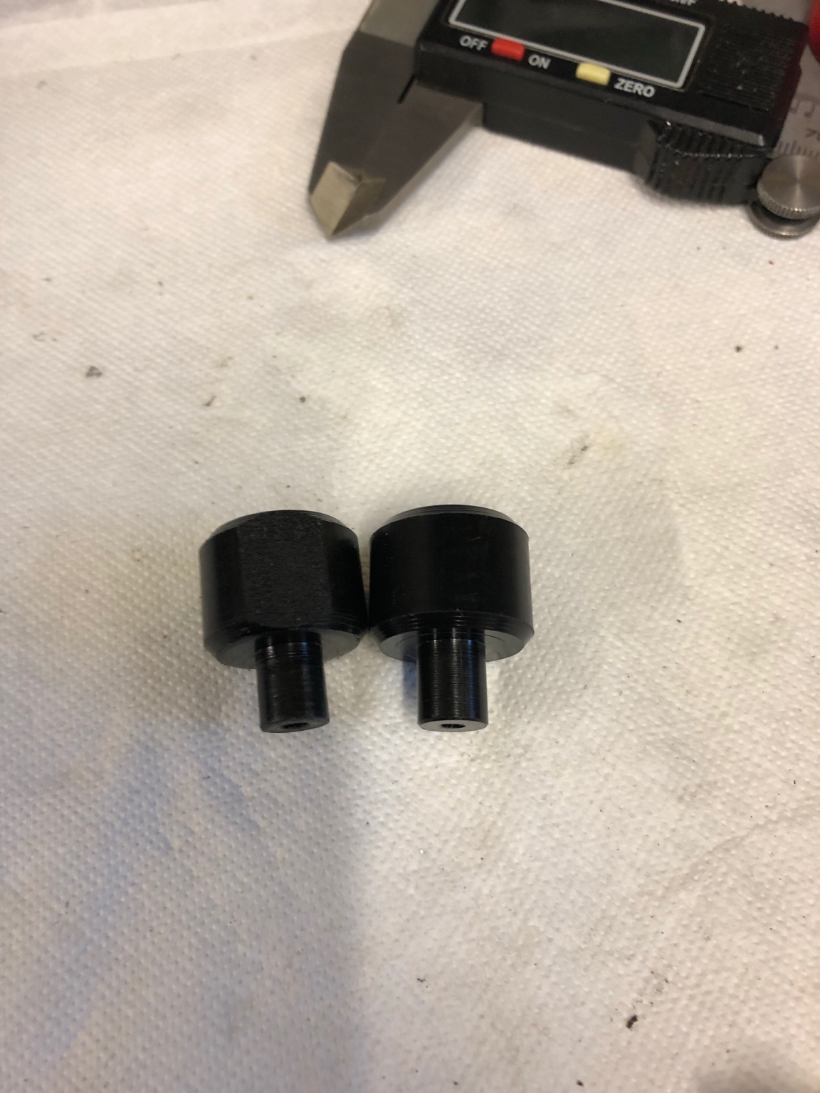

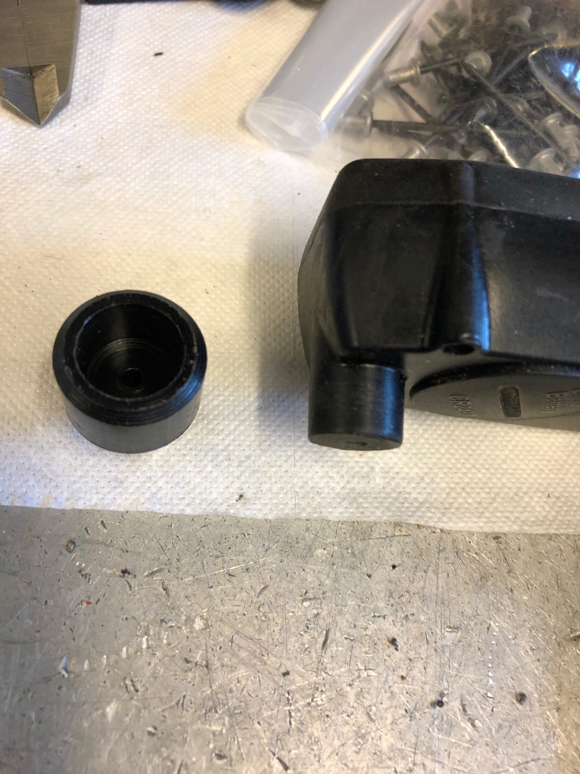

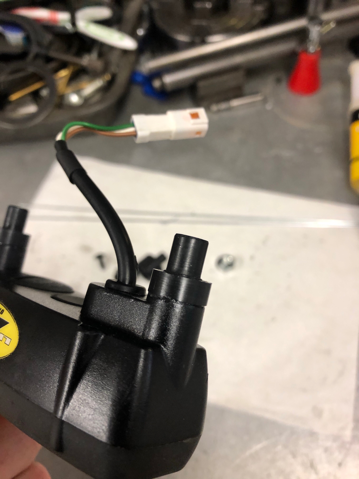

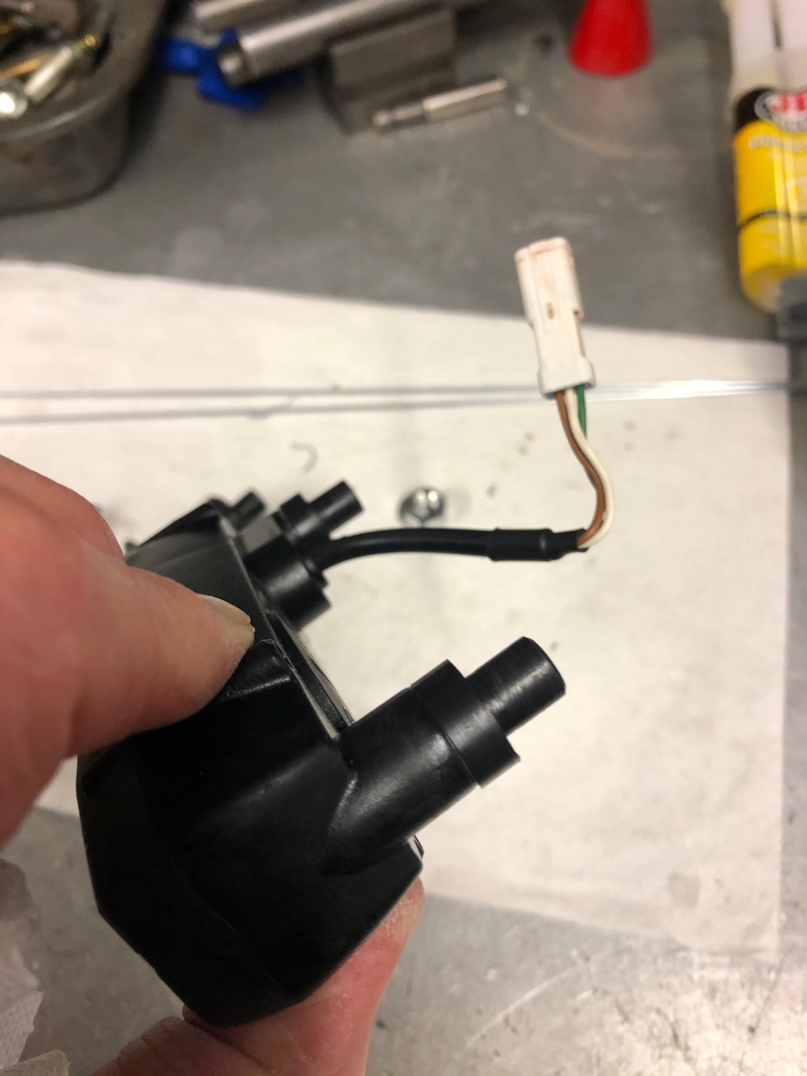

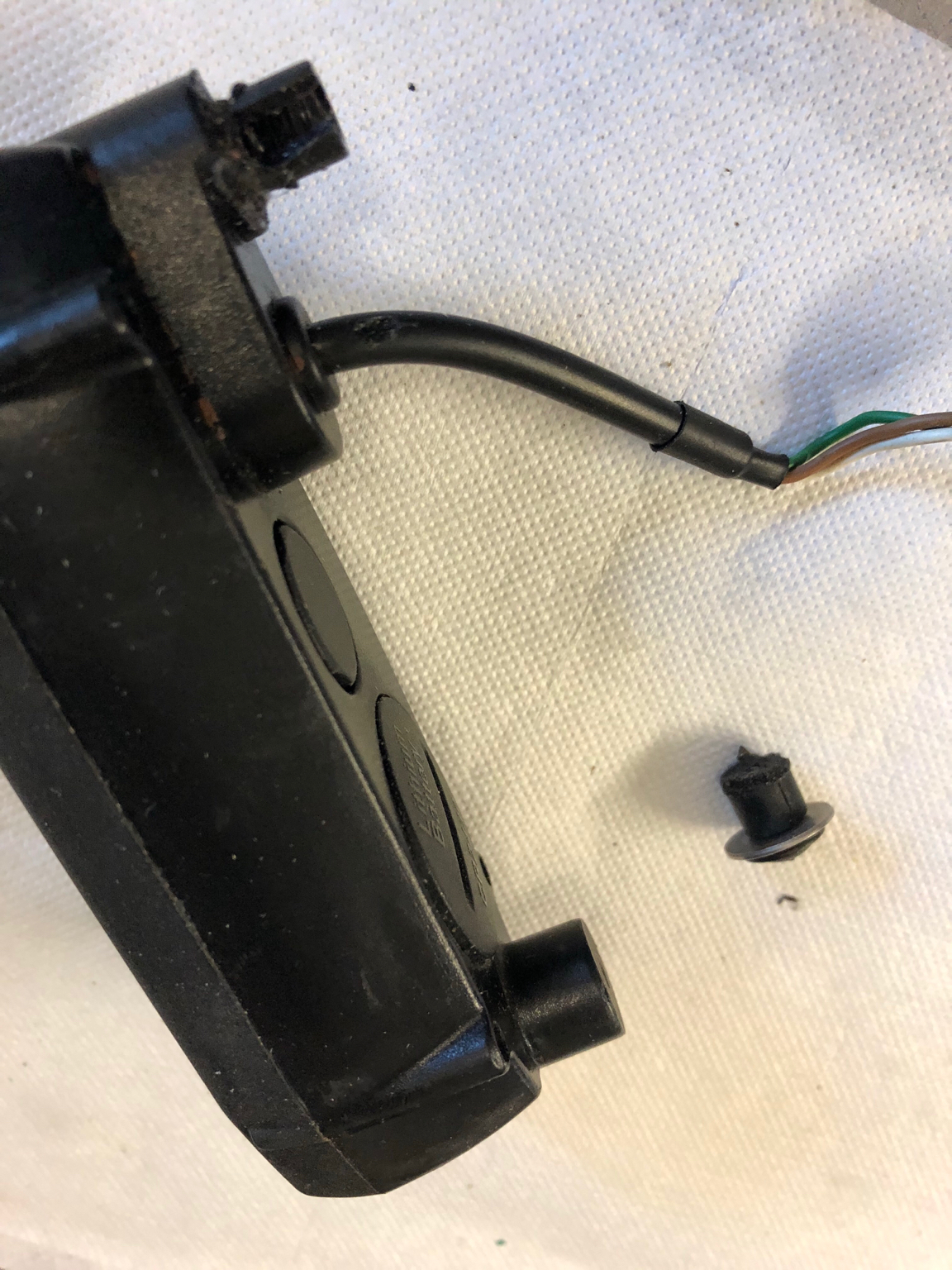

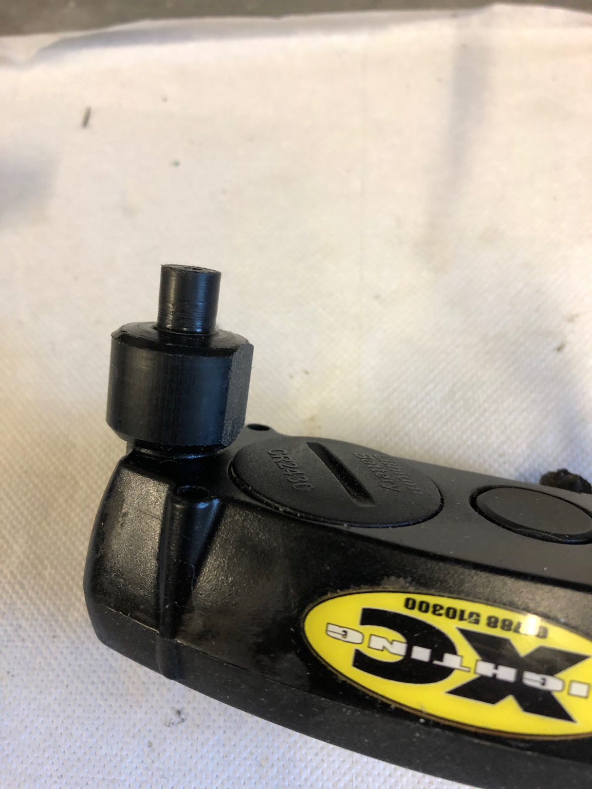

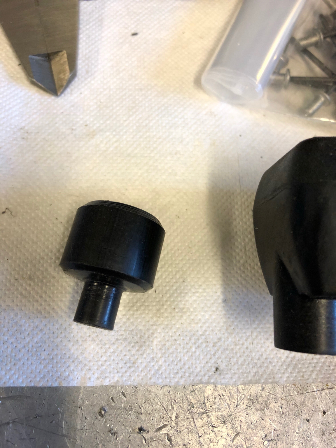

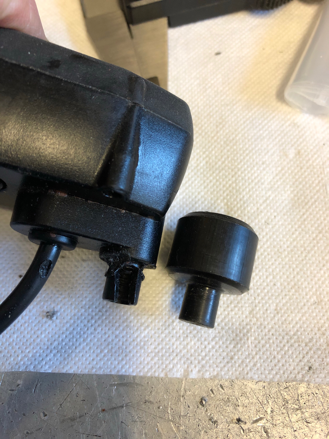

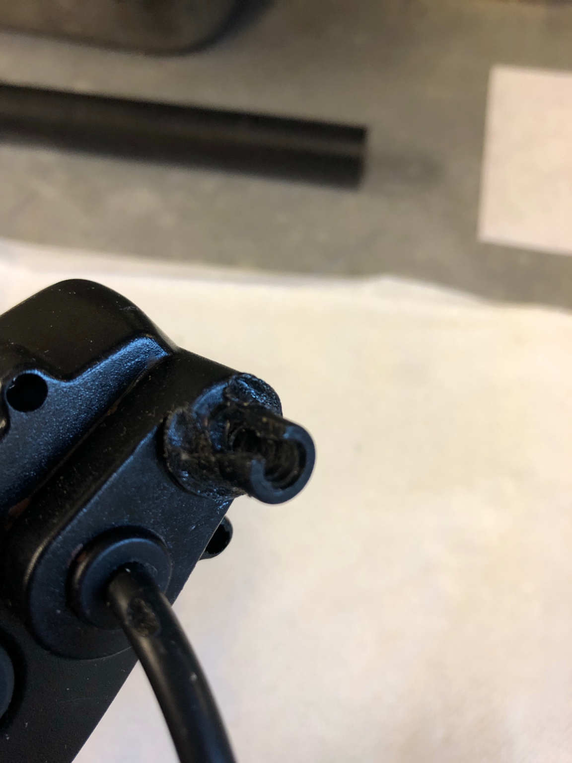

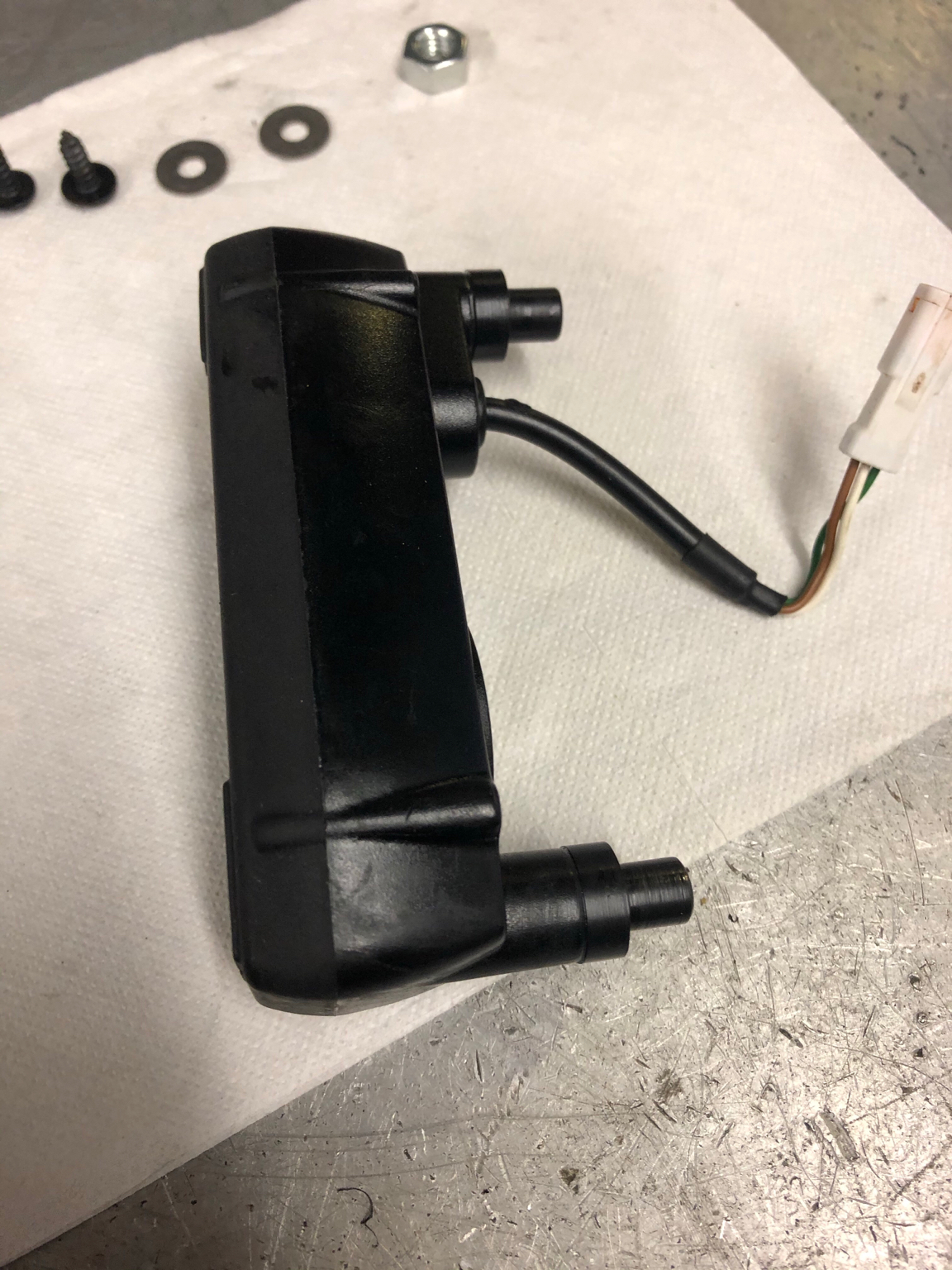

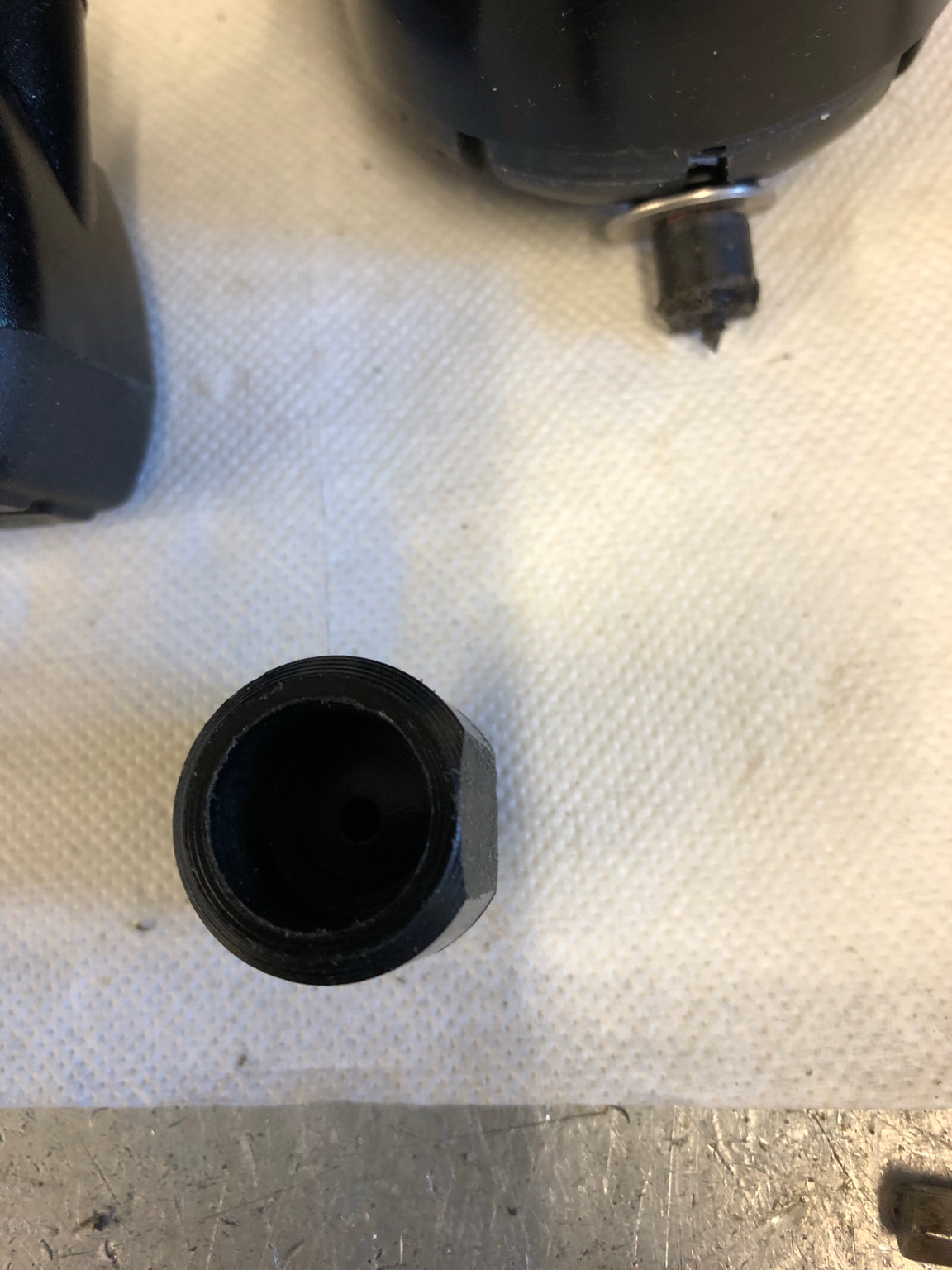

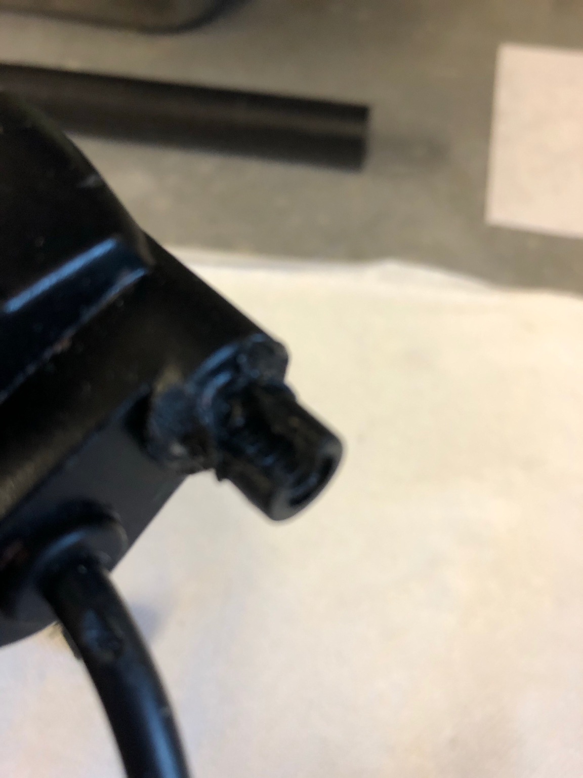

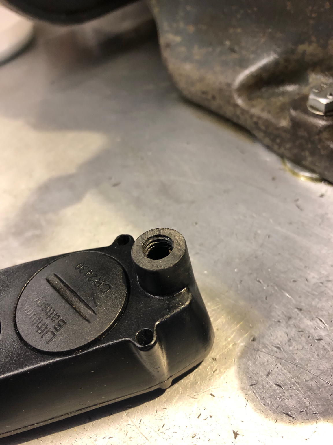

I’ve been dealing with something different recently, I have just bought a Honda CRF250RE for a bit of green-lane, enduro and MX riding. However the speedo/odometer has a broken mounting peg, which the previous owner has repaired.

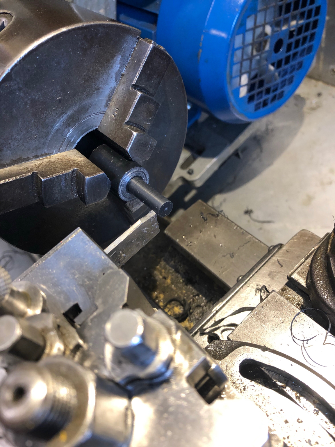

To remedy this I opted to make some new mounting pegs, I thought that making a socket to fit over that I could clue in place.

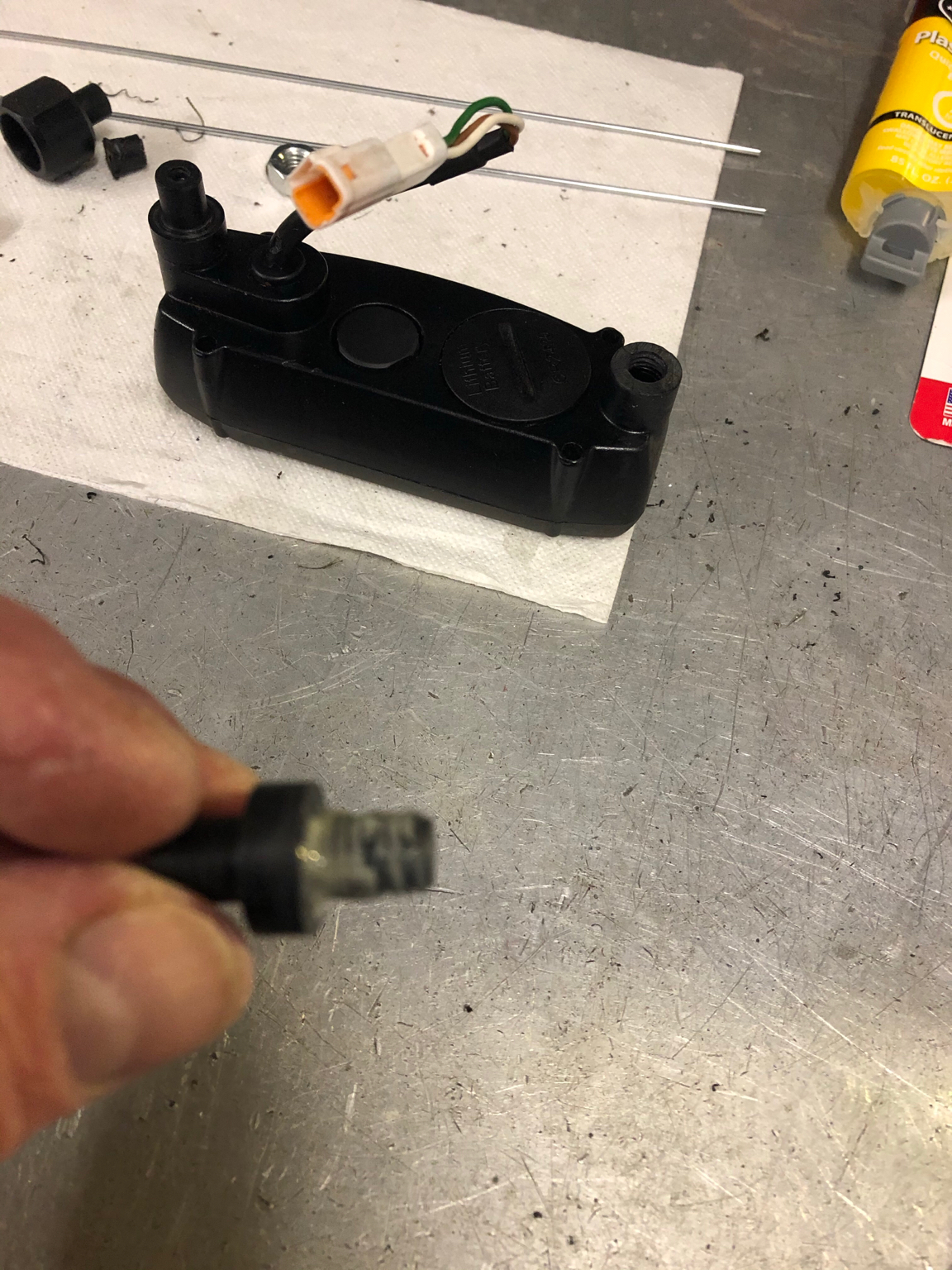

I decided to use acetal, but then realised about nothing is able to glue this stuff, so I then tried nylon 6.6. Nylon can be glued, but the bond isn’t that strong. So I thought about another way to fix the problem.

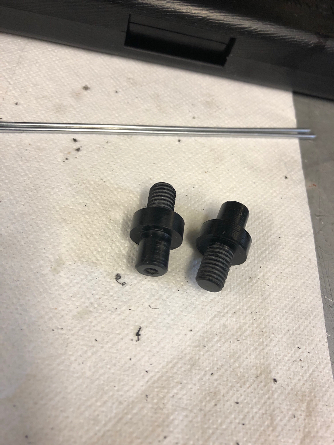

Rather than have a socket and gluing it. I’m going to use an insert with a screw thread and screw and glue the insert/mounting peg into the housing.
I started to make the plugs however using M6 was my folly as I managed to snap the threaded section off, so I’ve opted for M8 to ensure there is more meat on the plug threads.
I’ve used epoxy glue to act as a waterproof barrier and to lock the plugs into place. The threads are sufficient but the glue will help the joint become permanent.
