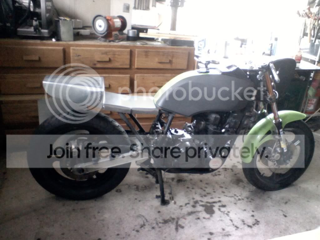

Got my seat pan and cowl all made up, next step is the bellypan.
Started out with the seat being as tall as the tank, but decided that without a fairing, it would be too much so I cut about 3" off.

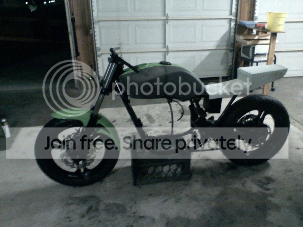

Got the belly pan all finished up. Gonna pull out the engine now, make the mounts and powdercoat.

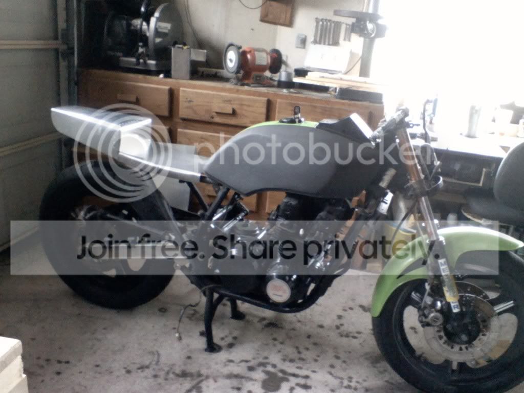

Grabbed the spare and slapped it on there. I think it looks surprisingly good. Might need a different set of gauges maybe Trailtech.

Re: The Ferrous Mistress
I've done that with a headlamp before and it does indeed cast a pattern not too friendly at night in the turns :o It really DOES look good there though! I'm interested in seeing if it will help to change the reflector or not, given the "skinny" width sideways since it is standing upright.
