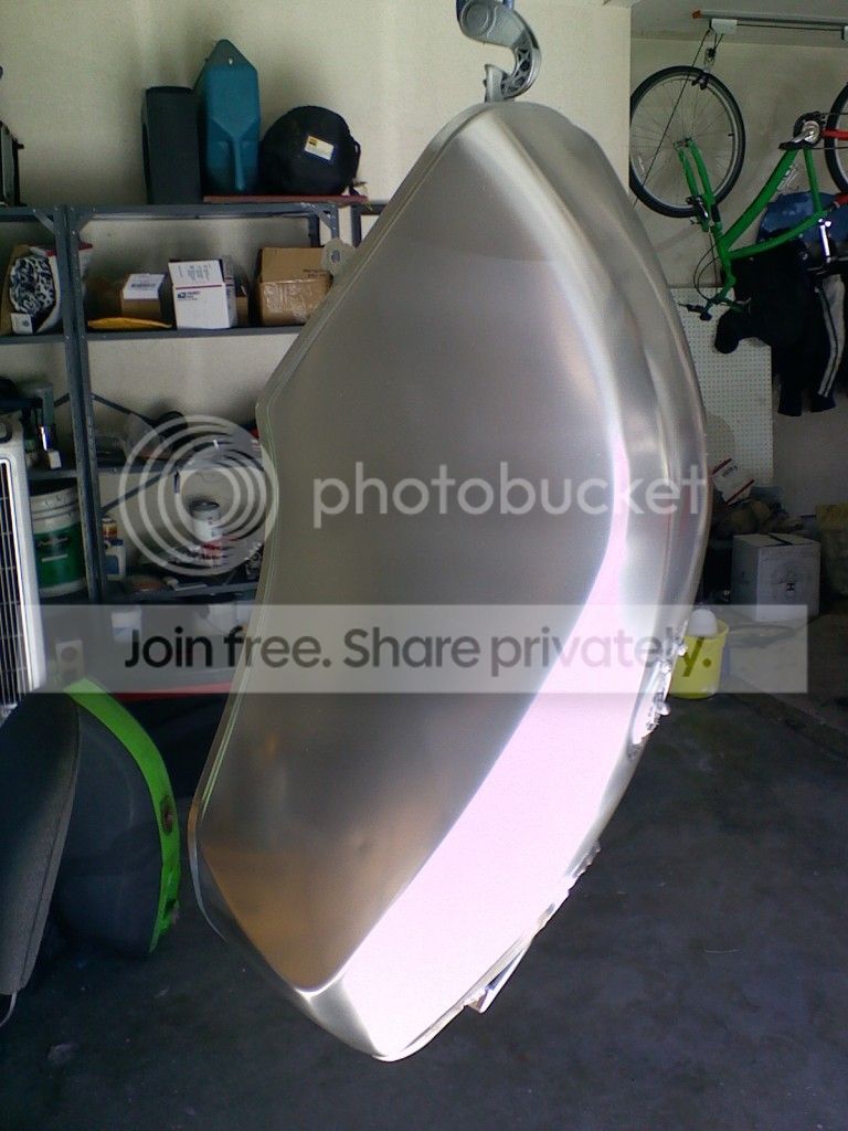

Got my new tank in, and although, it was in worse condition than the ebay listing described, I have lined it with POR5 and bondoed it up. Not an amazing job, but the best I have done so far, so I am happy. Primered everything and laid down a metallic base coat. When the spraymax 2k gets in, I will apply the silver specks and clear. Hoping to be up and running by weeks end.
Also thoughts on the gas cap, leaving it the way that it is. I kinda like it.
And I have no idea where to mount the license plate, any ideas would be appreciated.

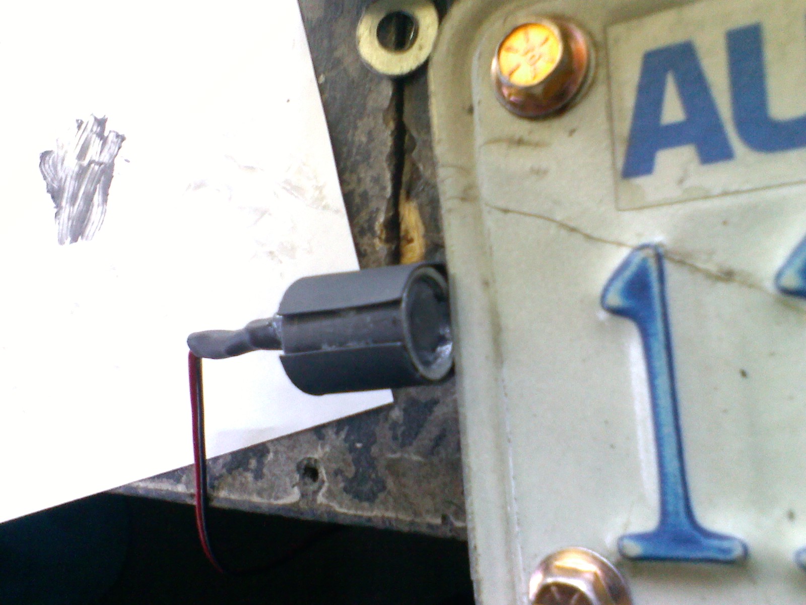

Got the license plate mounted up. Just reinforced the base of the tail light and mounted it straight to it. Then wired a resistor to a 10mm led and siliconed it into a socket and mounted that on the side. SO close, I can't wait to ride it!

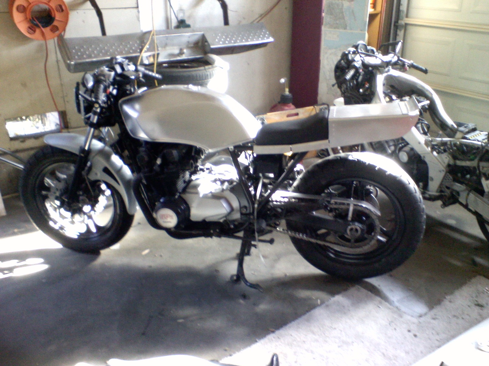

I finished upholstering the seat today. Decided to just make a wood pan and bolt it to the tail. With any luck the clear will be in tomorrow and painting will be done.

Finished painting everything and not much left now! ;D
