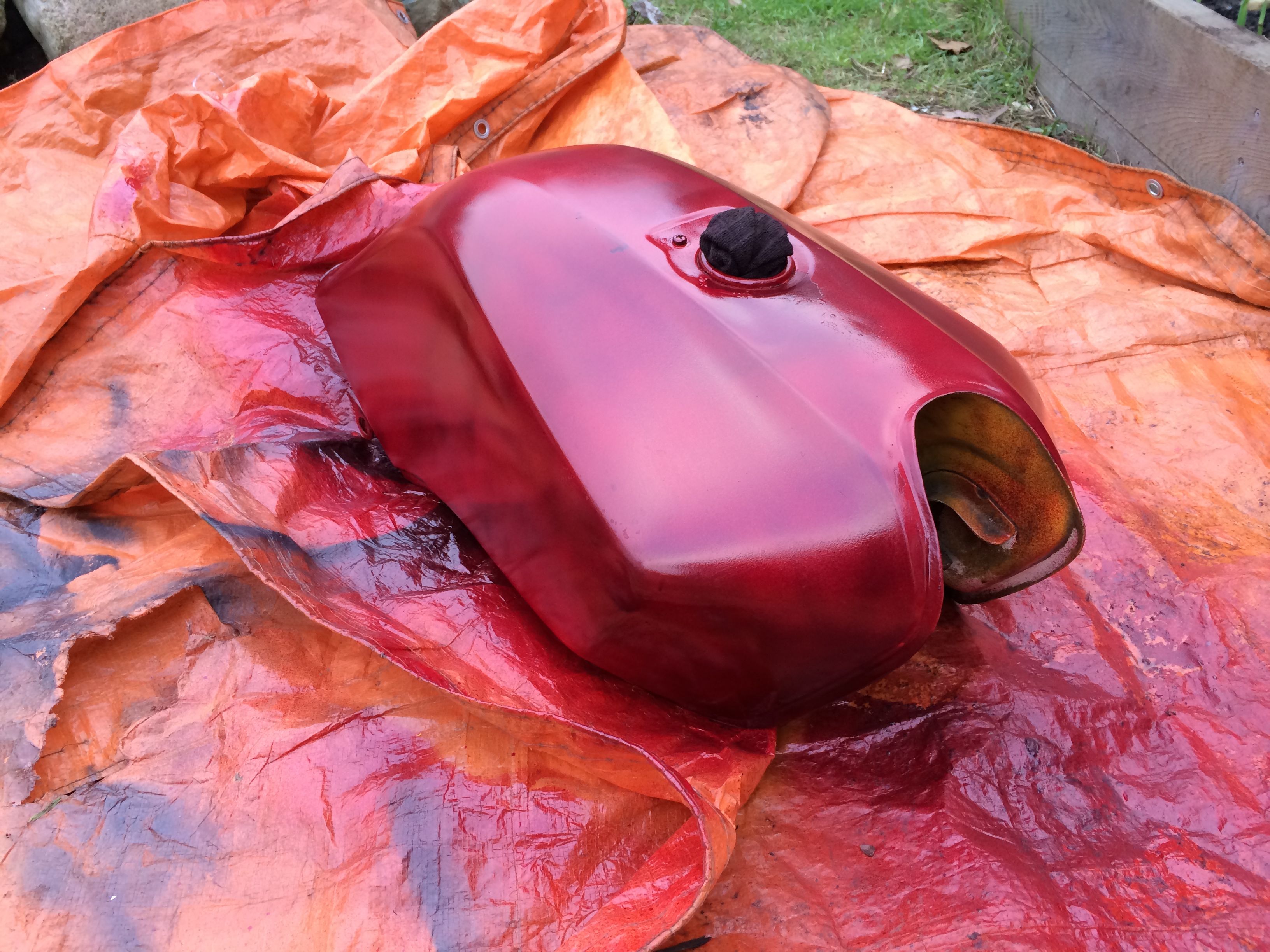

Then I started painting the gas tank, and fender. The fender has a few coats of satin black, now. A big improvement over the yellow. I may finish it with matte black. I'm also considering blacking out the rims. And if I remove the wheels, that gives me an excuse to clean up the swing arm and maybe even paint it.
I scuffed up the paint on the fender and the gas tank with 120 grit sand paper. There were quite a few spots where the paint had bubbled, or chipped away. Some rust spots. I sanded everything smooth, and wiped it down with a damp cloth.
I used a full can of the duplicolor "todeador", which was about 10 light coats on the gas tank. Next time I get at it, I'll wet sand it, and then paint it again. And sand, and paint, and sand, and paint.
I'm going to buy some gold paint and brush "Goldie" on the side of the tank. I guess I'll have to practice that a bunch, so I get it right.

Do longer stokes, all in the same direction, then angle them for the next coat and continue on that way next time you do the tank. That will help eliminate the tiger stripe effect. I would advise against going full flat black on the fender. After a bit of time flat black gets a white haze to it and looks like poo.

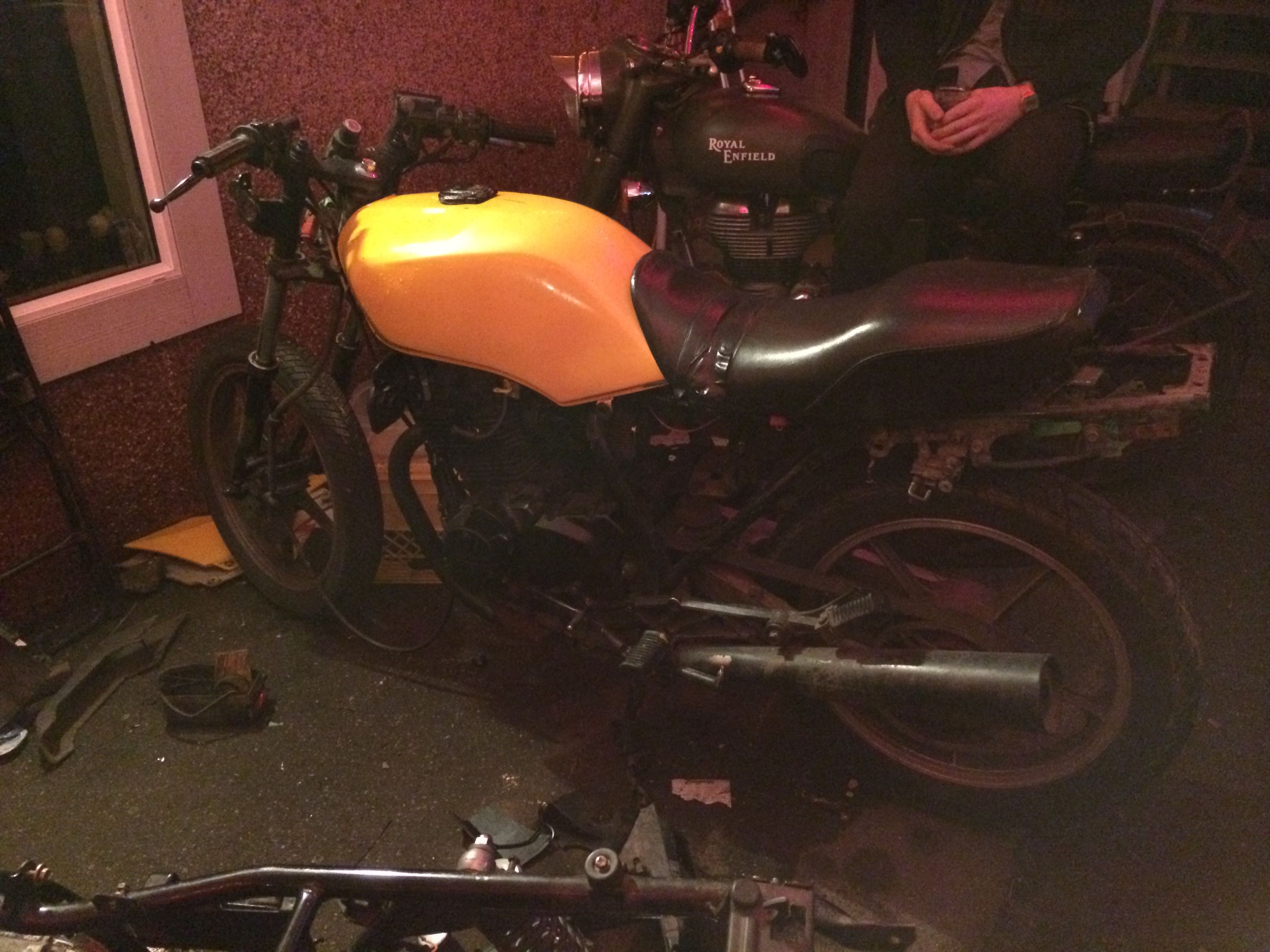

The GF will take the Enfield, and i'll take that red Suzuki from your pics hahahaha

Thanks, D4N63R. I appreciate the advice on matte black paint. I was growing partial to the semi-gloss, anyway. The tank has a bunch of runs and tons of blotches. I am going to sand it down next time I get at it, and hopefully apply a more consistent layer of paint.

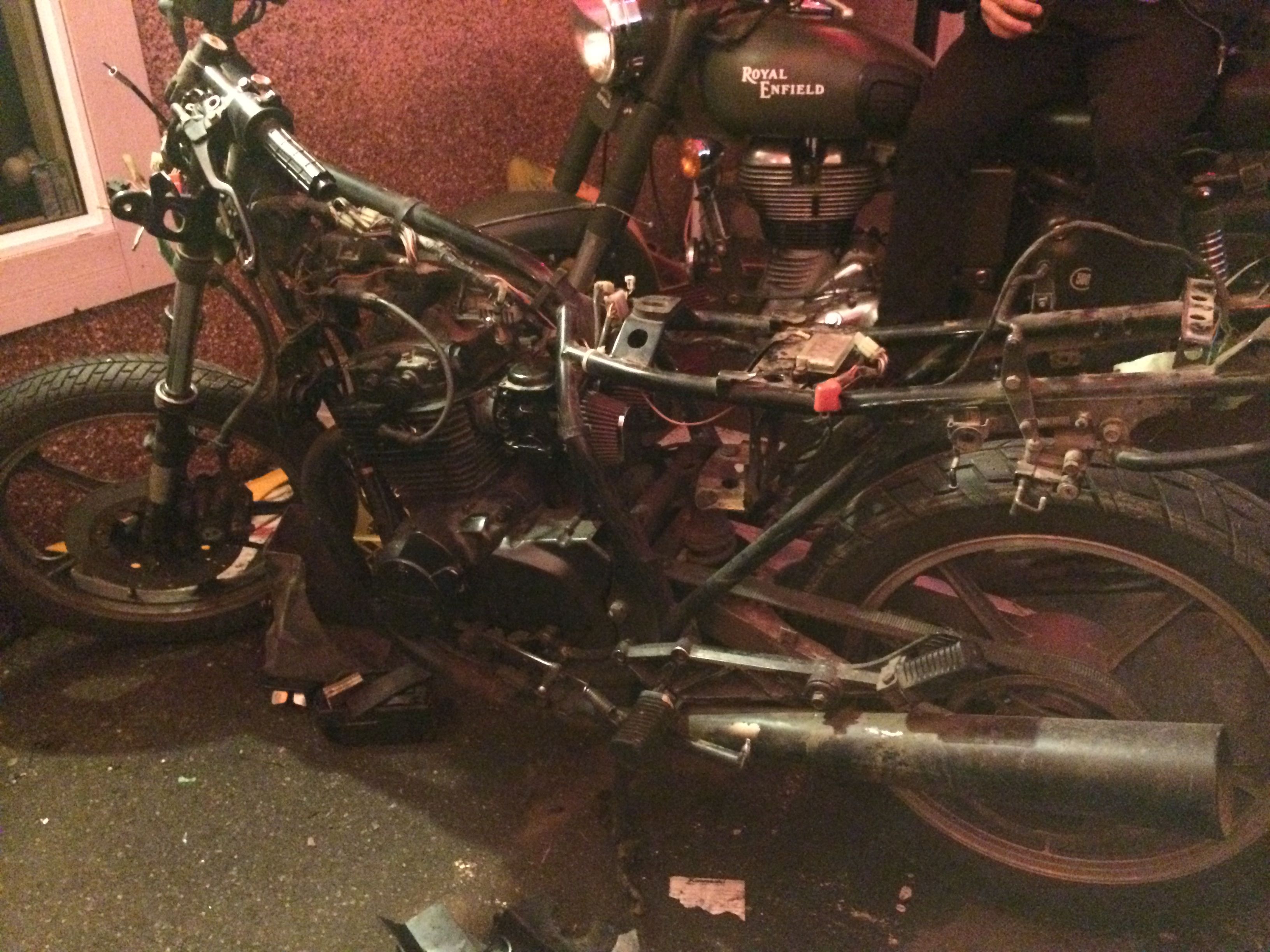

The Enfield has been a lot of trouble for my friend. He has been hunting down an errant electrical problem for several weeks, and he finally sorted it out this evening. Hopefully!! I took it for a rip after it was fixed and I gained a lot of appreciation for that machine. It pulls nice and hard, rides extremely comfortably, and looks amazing. I don't know if I'll ever get an Enfield, but it was a blast to ride around.
The Suzuki is a GS400e that another friend is working on. It's full-on rocket-stance on that bike. He has been tuning his carbs, since replacing the airbox with pod filters, and he finally got it running well, over the past few days. It's a lot of fun, too :)
