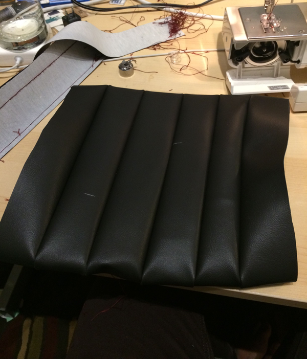

I did a test run this evening with my sewing machine, taking some uneven strips of marine vinyl, and sewing them together. I had a few problems with the machine jamming, but adjusting the tension seemed to solve the issue. I'm going to buy some vinyl of the same thickness, in a chocolate brown, and start sewing the real seat cover.
