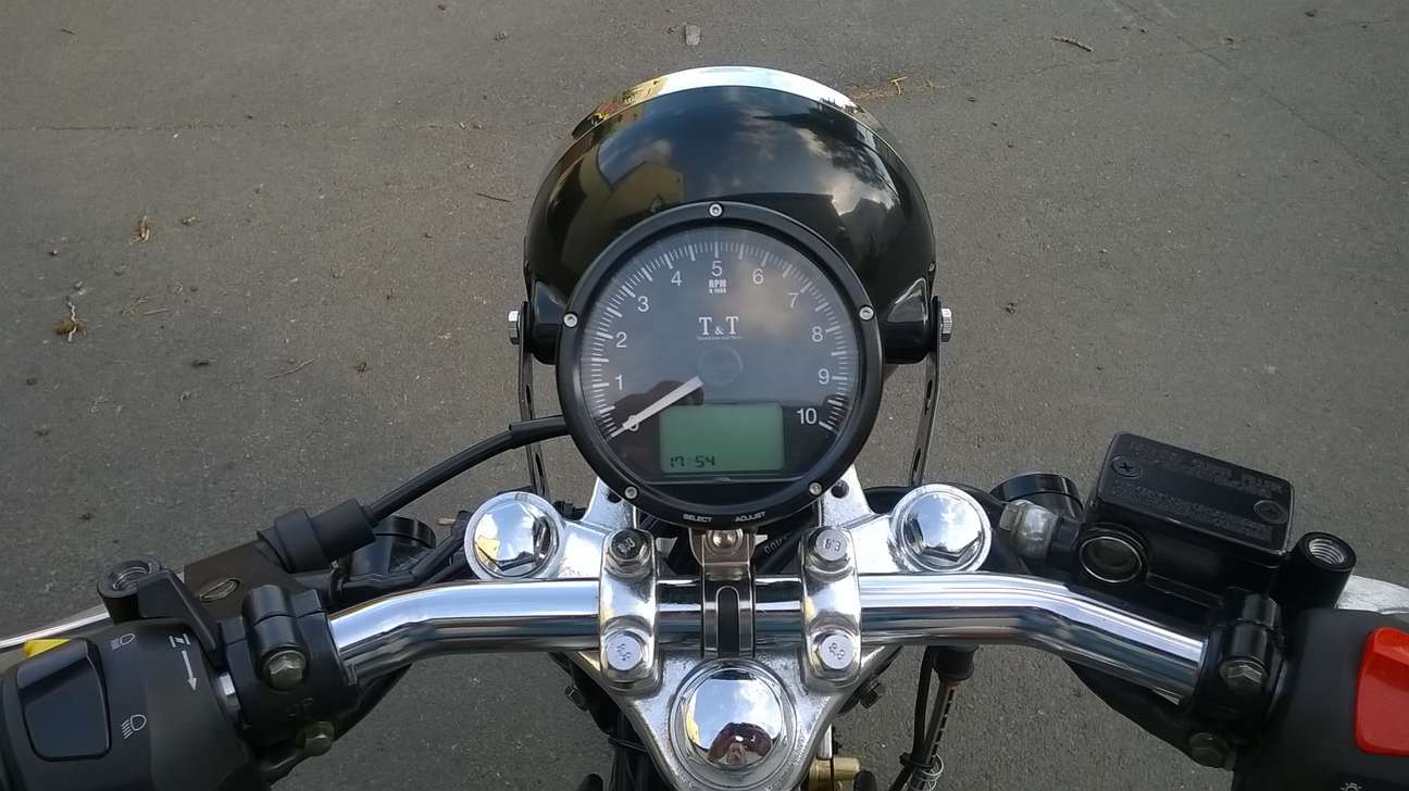

Starting to look at installing my new speedo/tacho. See picture below. Most of the wiring translates easily to existing wires used by the current status unit and speedo.
Just wondering about what to use for the earth, positive and post ignition switch wires.
Thinking the earth can be a green wire that is already used by current units.
Not sure which existing wires to use for the battery feed and post ignition switch feed and how best to tap in to them.
Suggestions welcome.

Yep, it looks great. I will post pics on the weekend. Everything works fine BUT tachometer is all over the place. See the main skyteam resource topic on here for more details. Have tried a few things, next is to insert a diode in the circuit over the weekend to try and clean up the signal. After that I will work with a local mechanic to troubleshoot before taking the supplier up on their offer of returning the unit and getting a replacement (from NZ to Germany :-( )

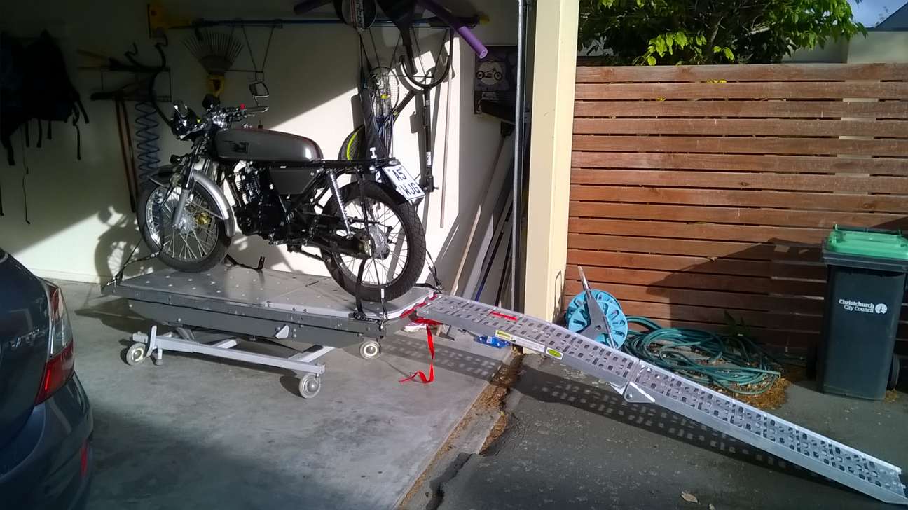

Hospital bed is great and now with a nice long ramp, not at all worrying to get the bike on and off without straining my troublesome back.

The tacho/speedo will get mounted lower and further forward in the void between the bars and the headlight.

Wiring was not hard. But a bit of a fiddle for me, as I had not done any wiring before. I bought good connectors (and lots of spares so I could stuff it up), a good crimper and took it slowly. I still haven't got the tacho working correctly yet though. The supplier has been very helpful, they even offered to send me a special pick up unit and/or a replacement unit. I suspect the Ace though. Some noise in the wiring somewhere.
Over the next few weeks I will...
Try rerouting the cables to keep the whole length of the tachometer wire, from pickup to the tachometer, away from the coil and ignition wire. I think as a trial, I will also take the unit completely off the bike and run the wires out 90 degrees to the side to see how that goes.
Try running standalone positive and earth direct to the relevant battery terminals. I will put a fuse in the postive wire just in case.
Try it on a different bike
Try a friends tachometer on my bike.
I really, really like the look of this unit and can't imagine using anything else, so I will keep going at it until it is solved. When it is resolved, I will look at getting the bracket below to remount the unit on the standard instrument holes and that way it will be further forward and down filling the space between the bars and the headlight. I will also then see the speed without having to tilt my head down.

joeylimzy..... Tacho now works perfectly! Go for it.
I unwound the coil earth wire which the factory had wrapped one and half times around the wire from CDI to coil.
Shortened the wires that tapped in to the CDI to coil wire.
Replaced all the supplied connectors with my own, crimped and insulated to my liking.
Went for test ride to get speeds vs gears vs rpm then checked against:
http://woodsware.aciwebs.com/gears/
Called up the entry that is loaded in there for the Ace and changed rear sprocket to 34 and stock tyre size to 80/90/18 which gives roughly the circumference of my wheel. Very, very exact results.
Not sure what exactly fixed it, could have been any of this, I didn't test as I went along.
If any one else runs a tacho like this the key settings that work for me are "1890" mm circumference, "5P" number of magnets, "Lo" rpm pickup and "1" which means one four stroke cylinder firing every 360 degrees.
