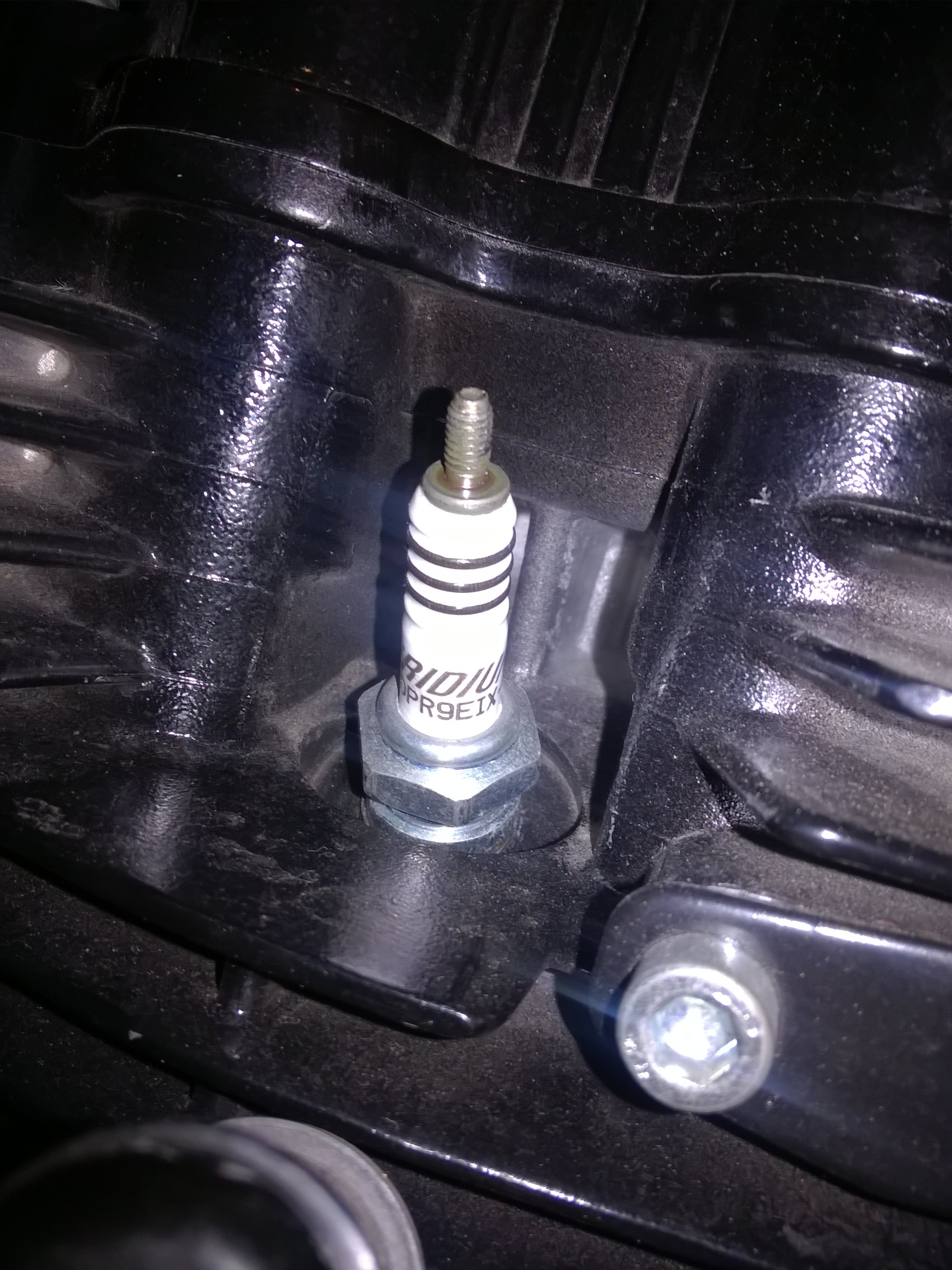

How did you get the original sparkplug over the NGK Iridium DPR9EIX-9?
Mine wont fit at all :(
Cheers mike
The standard spark plug cap should just push straight on. Although later I changed to an NGK cap and that pushes straight on too.
Ok now it works...
just had to pull the spark out and but it on outside the motor
maybe because the new spark is a bit bigger
