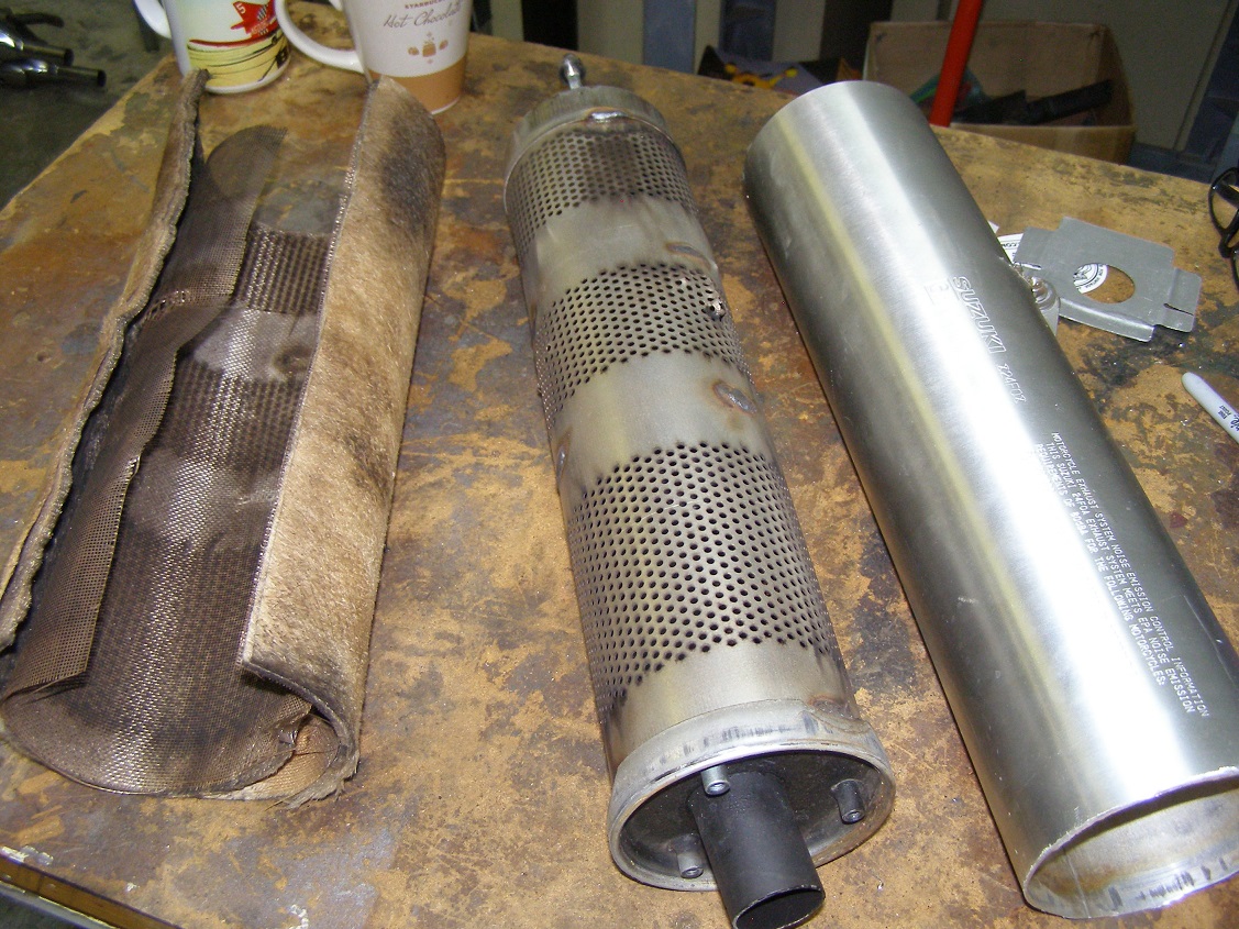

First group is of me chopping the stock cans from that hayabusa exhaust. I figured..why let it go to waste?

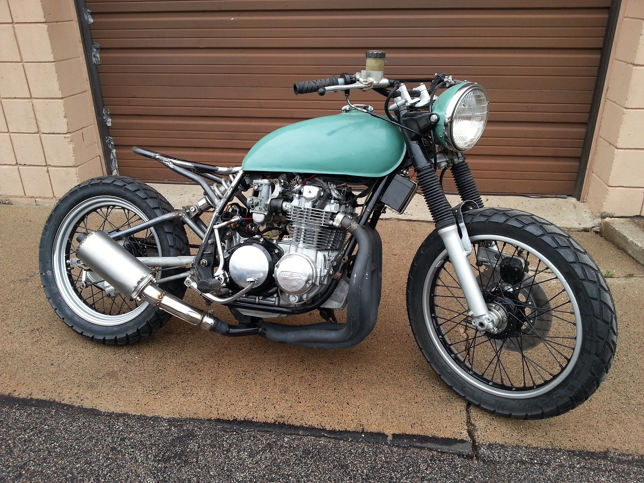

Got 1.5 miles of "almost" street legal driving in! Went to my local Honda shop to say hello to the sales team. Great group there. Just put the original Speedometer on it, as it wasn't on for this run. A few more shake-down runs and waiting for new jets (so I don't have non-professional DRILLED jets in there ;) ) Then final welding, seat needs to be made, and all the "little" things of course. Can't wait to take her off road!

I just realized you have the battery strapped just behind the forks. wow, thats pretty inventive....
Re: 71' CB500 monoshock with no name...but she runs now (vid on page14)
I'm not sure if this is sarcasm or not. So I'm going to say...Thanks! I found the max travel on the forks/tire and made it so it couldn't hit. Works quite well, and gets cooling. I'll make a little case for it so it doesn't just look like a battery sitting out there, some sort of "cage" around it that looks decent.

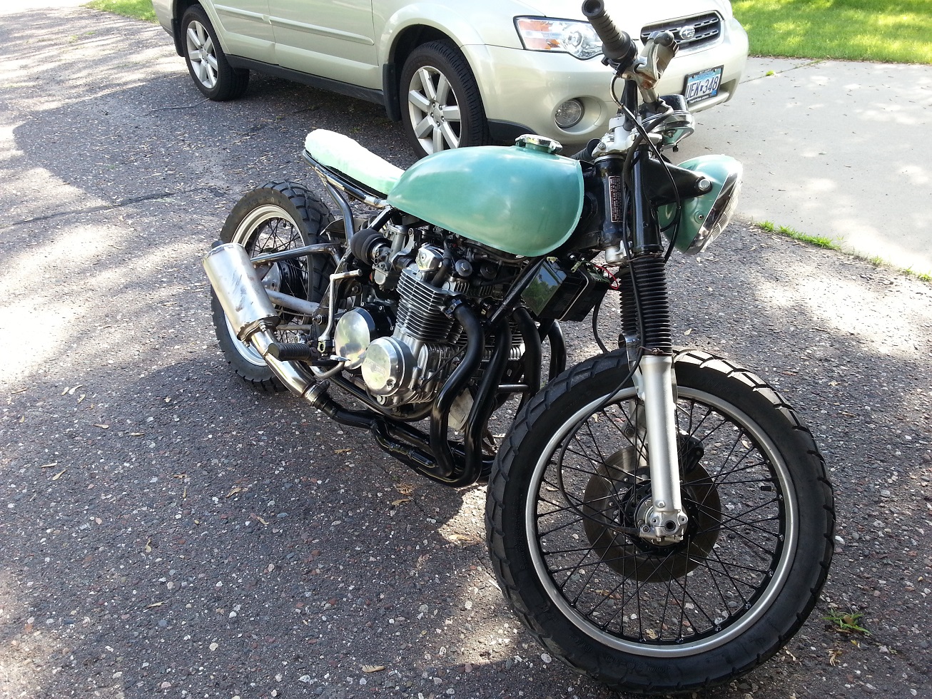

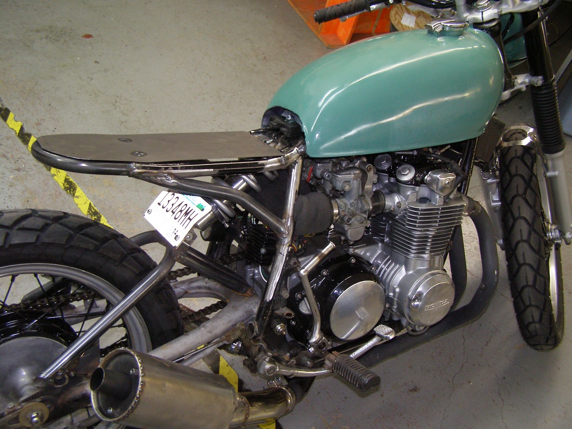

Started on the seat pan, foam. And started the shakedown runs. I tuned the bike to the completely open exhaust, and then swapped to the hayabusa headers, thinking the flow might be similar...it is definitely NOT. It's more restrictive than I thought it would be...so I'm running insanely rich now :P Got about 15 miles on her, she wanted to kill at lights, but the top end of the rev range was fun! A bit more tuning and then it's time for finish welding, paint/powdercoat on this thing.

She's at home in the garage. There's another 71'CB500 on the right, and a CB550 further back in the garage ;)

What is the deal with the holes and rivets???
Got the idea from another member on here. They are screw rivets. So when I get my seat cover stitched by my wife, I can pull the material tight and screw down (with 8-32 bolts and washer) to capture the material nicely and it lays flat on the bottom. I've tried stapling to wood in the past, gluing, and all sorts of ridiculous methods, one even looked like a corset with laces to hold it together... this seemed very clean and nice. Now if I could just get my wife to finish up my seat cover :) ;)
