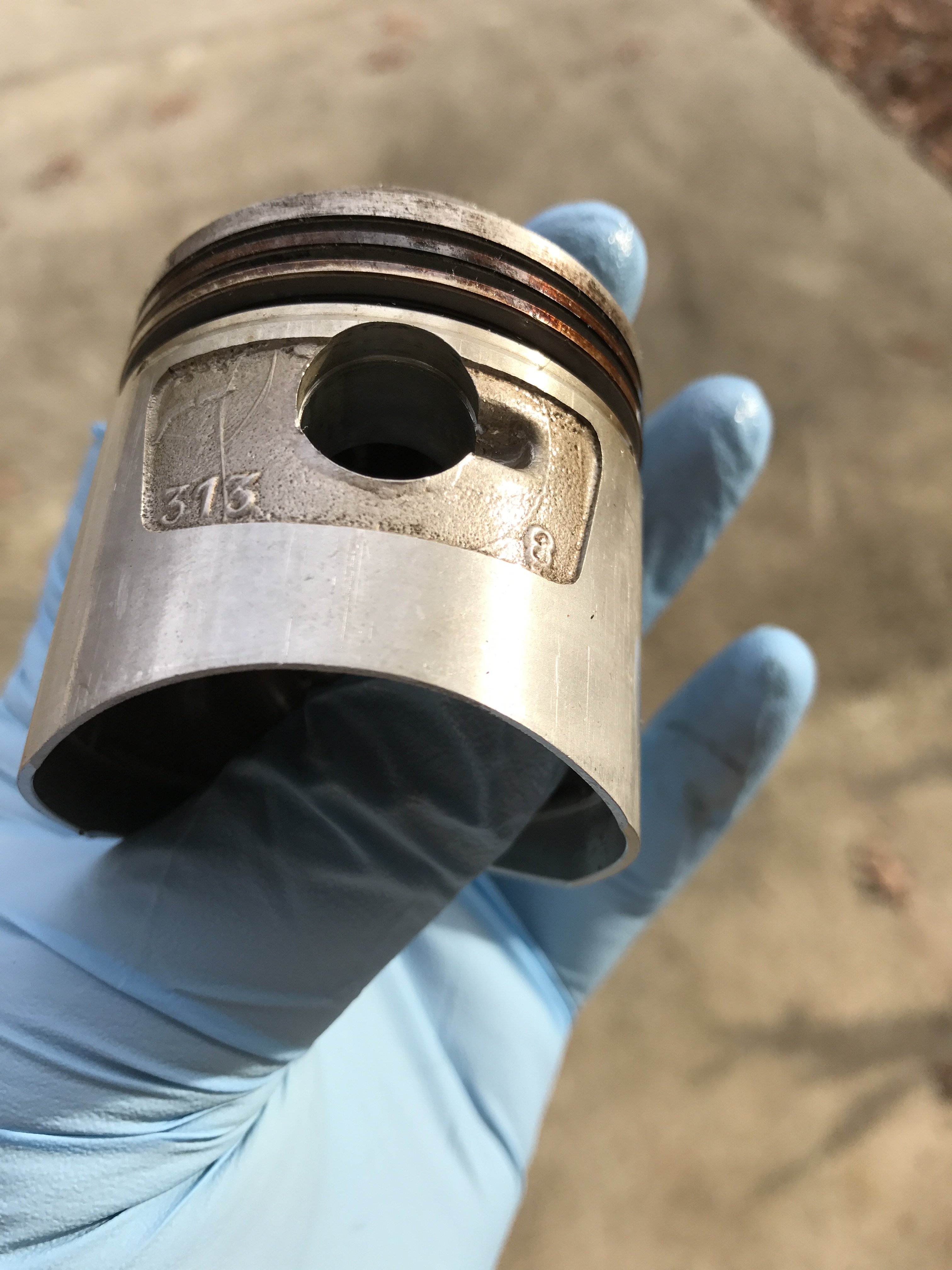

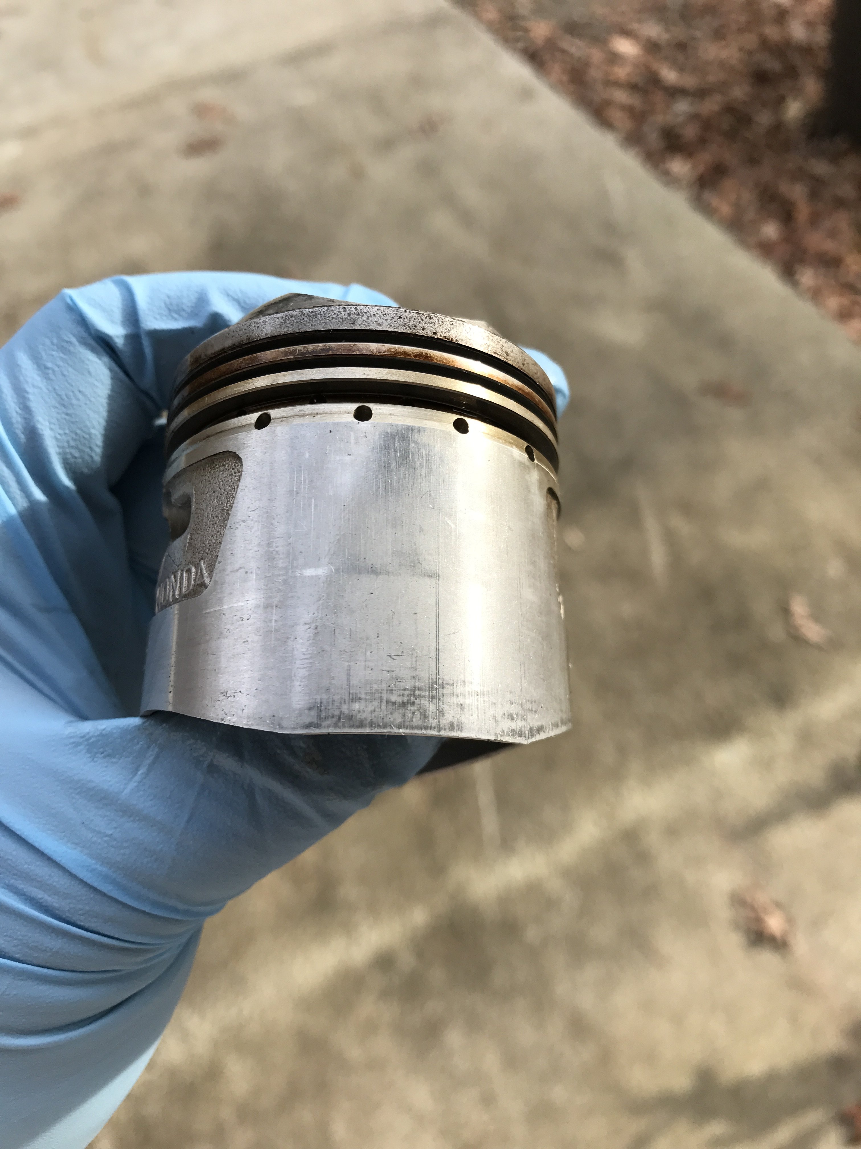

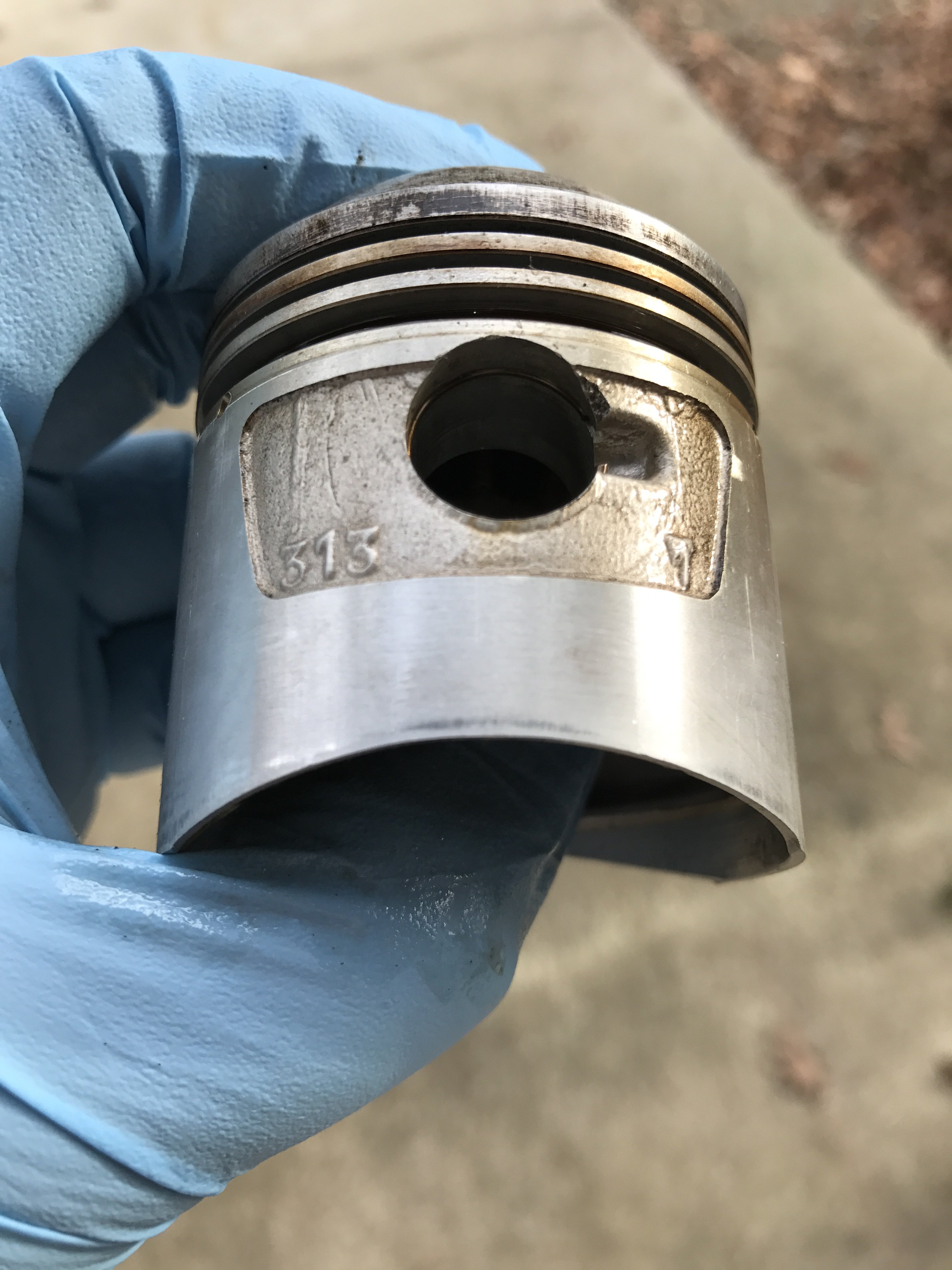

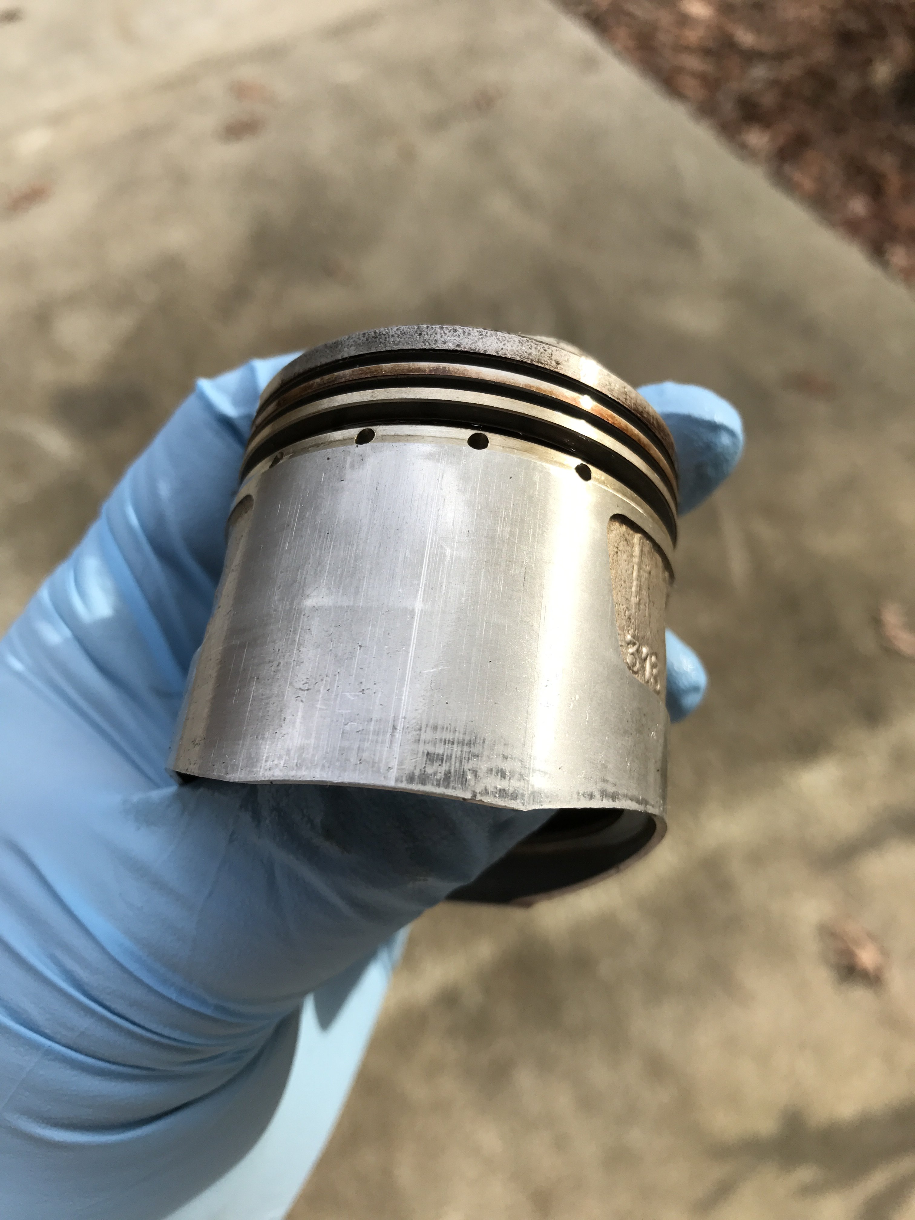

'72 CL175 engine trouble?

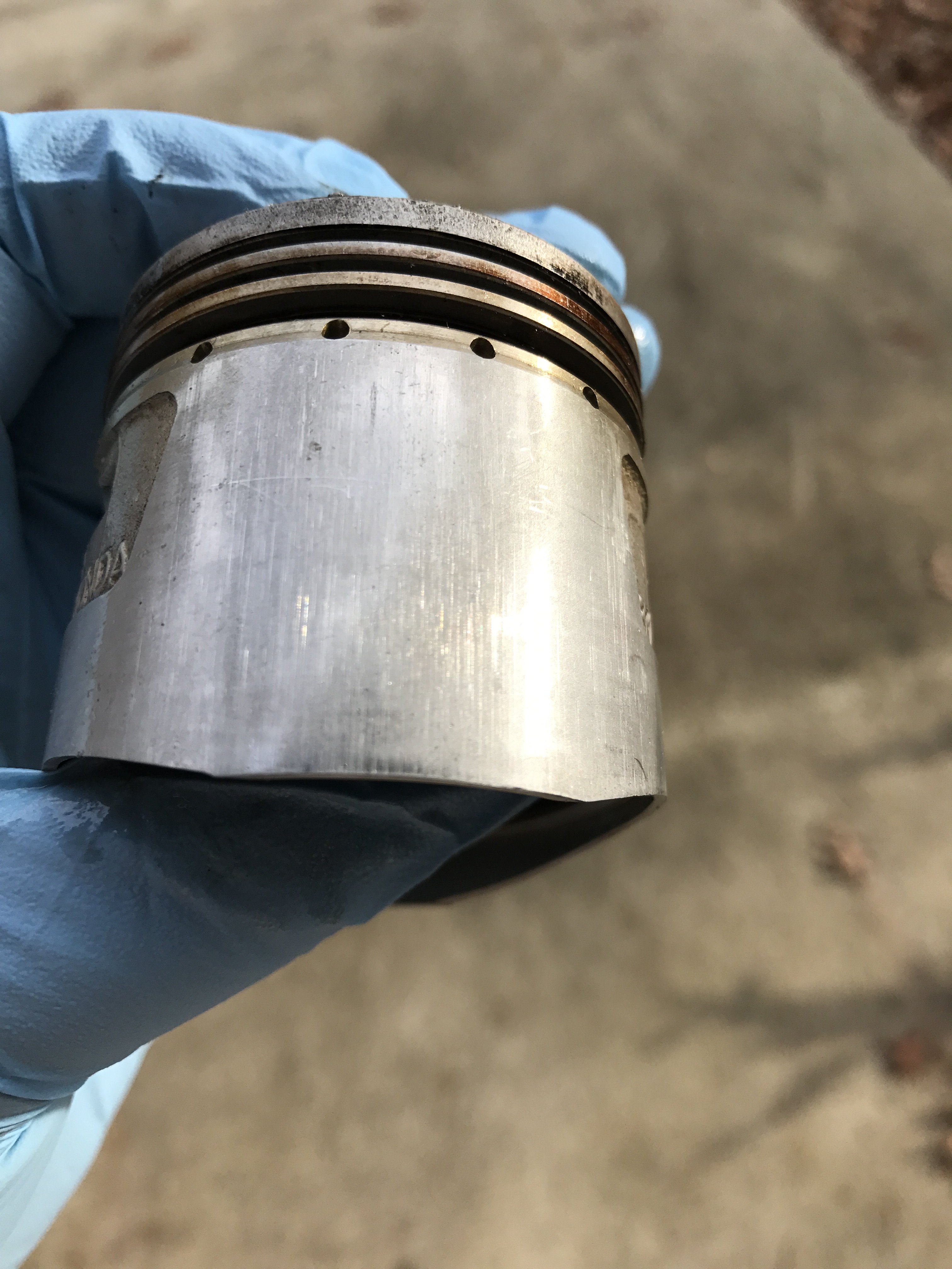

L piston

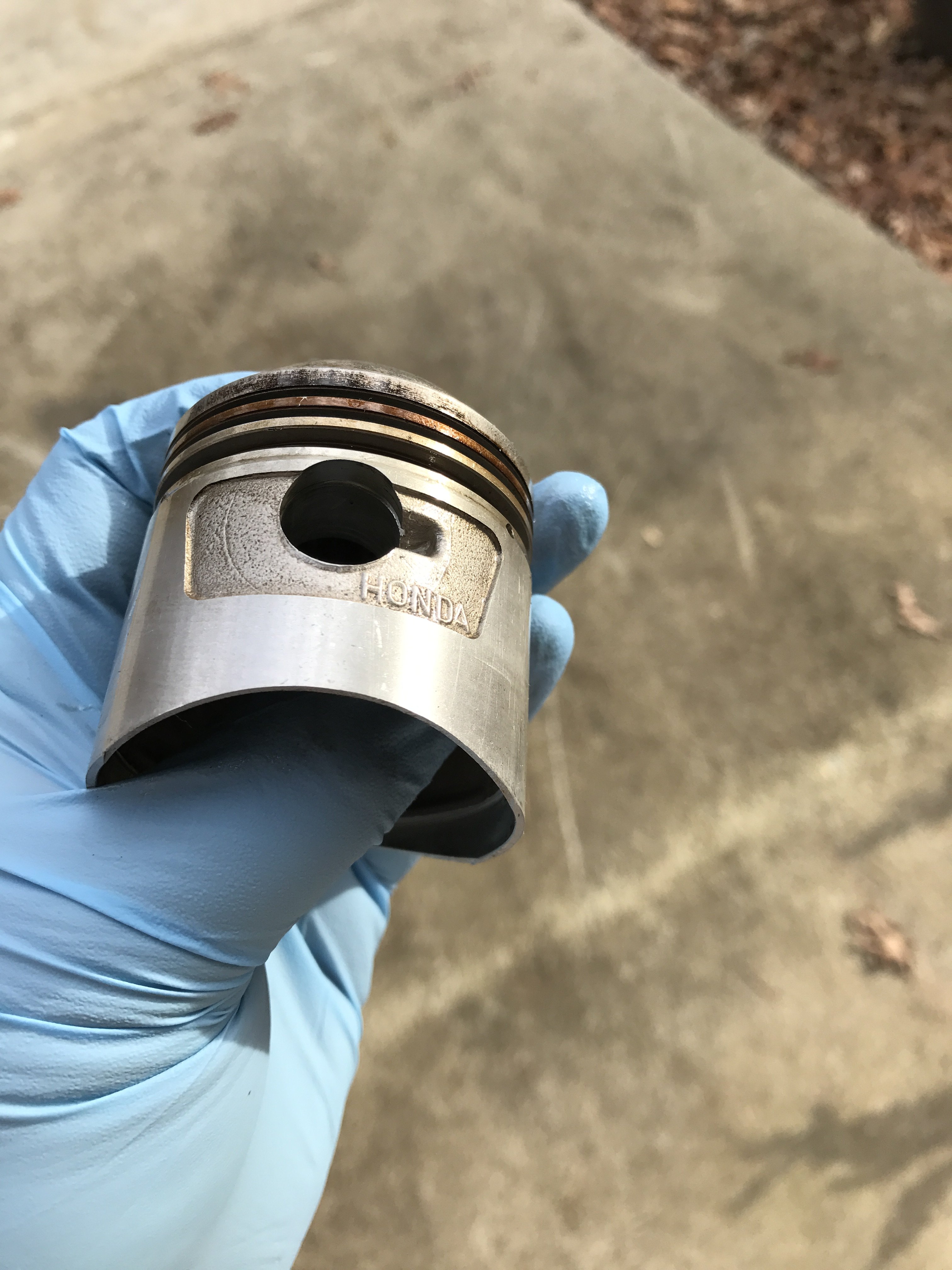

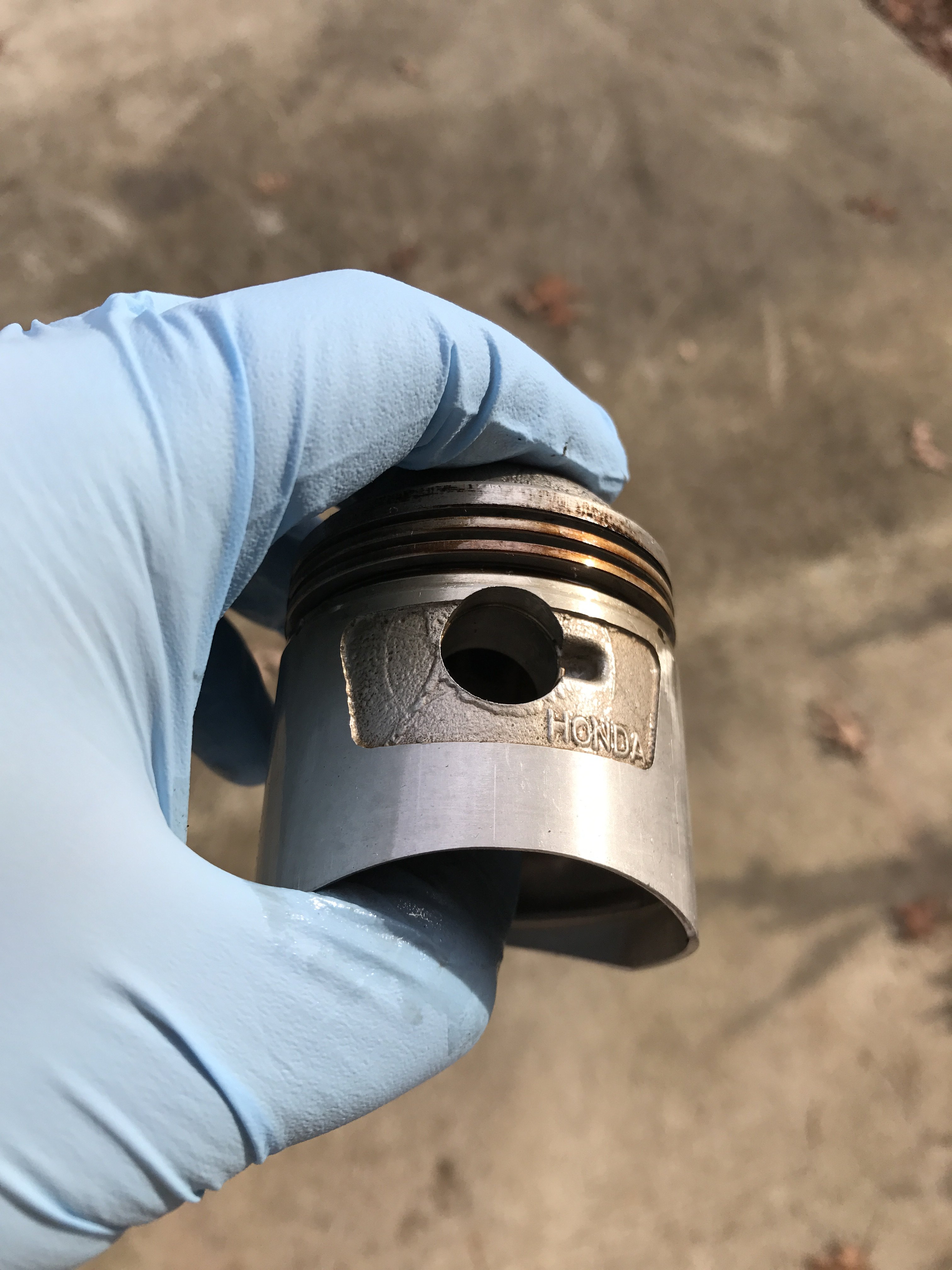

R piston

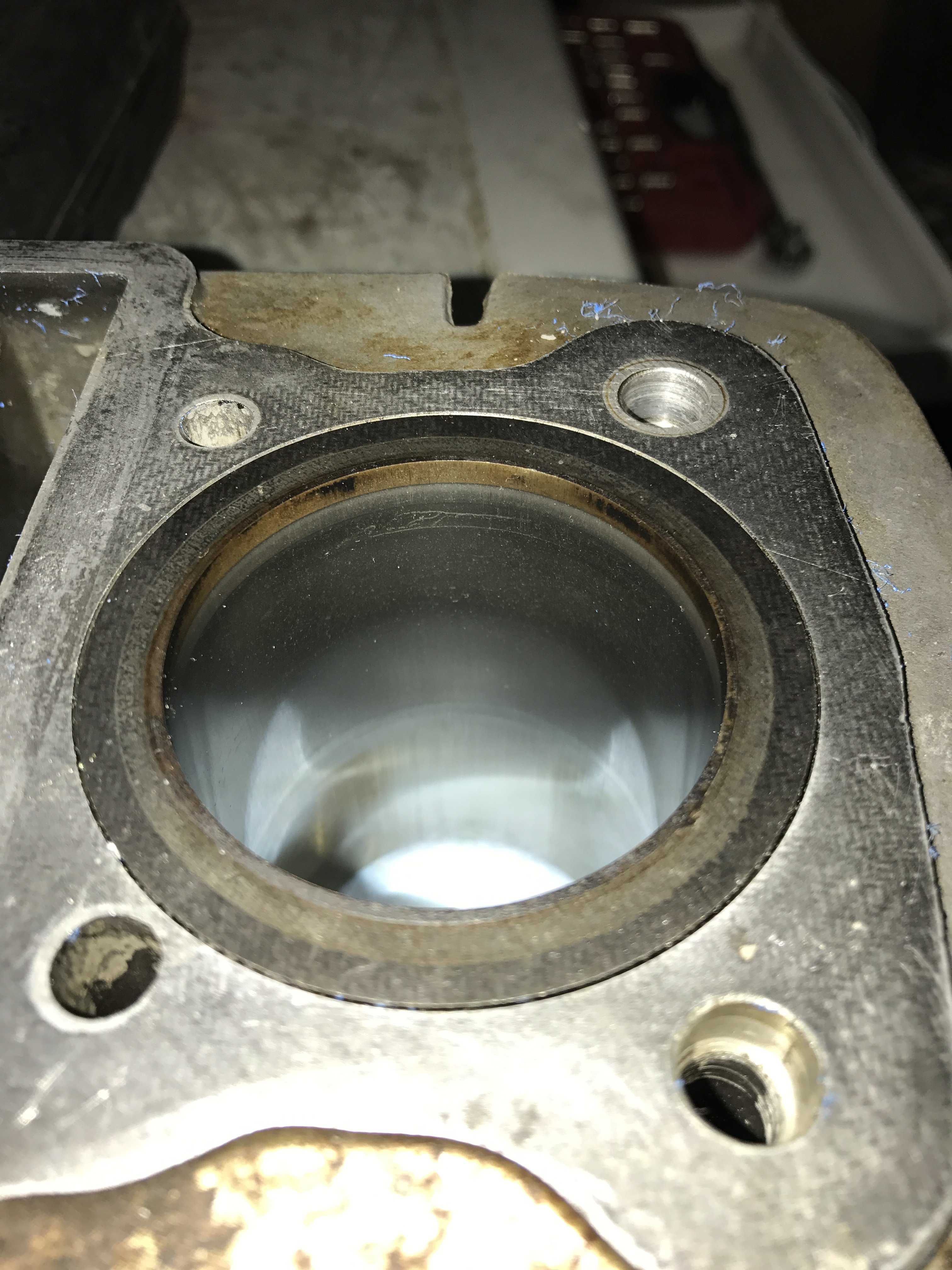

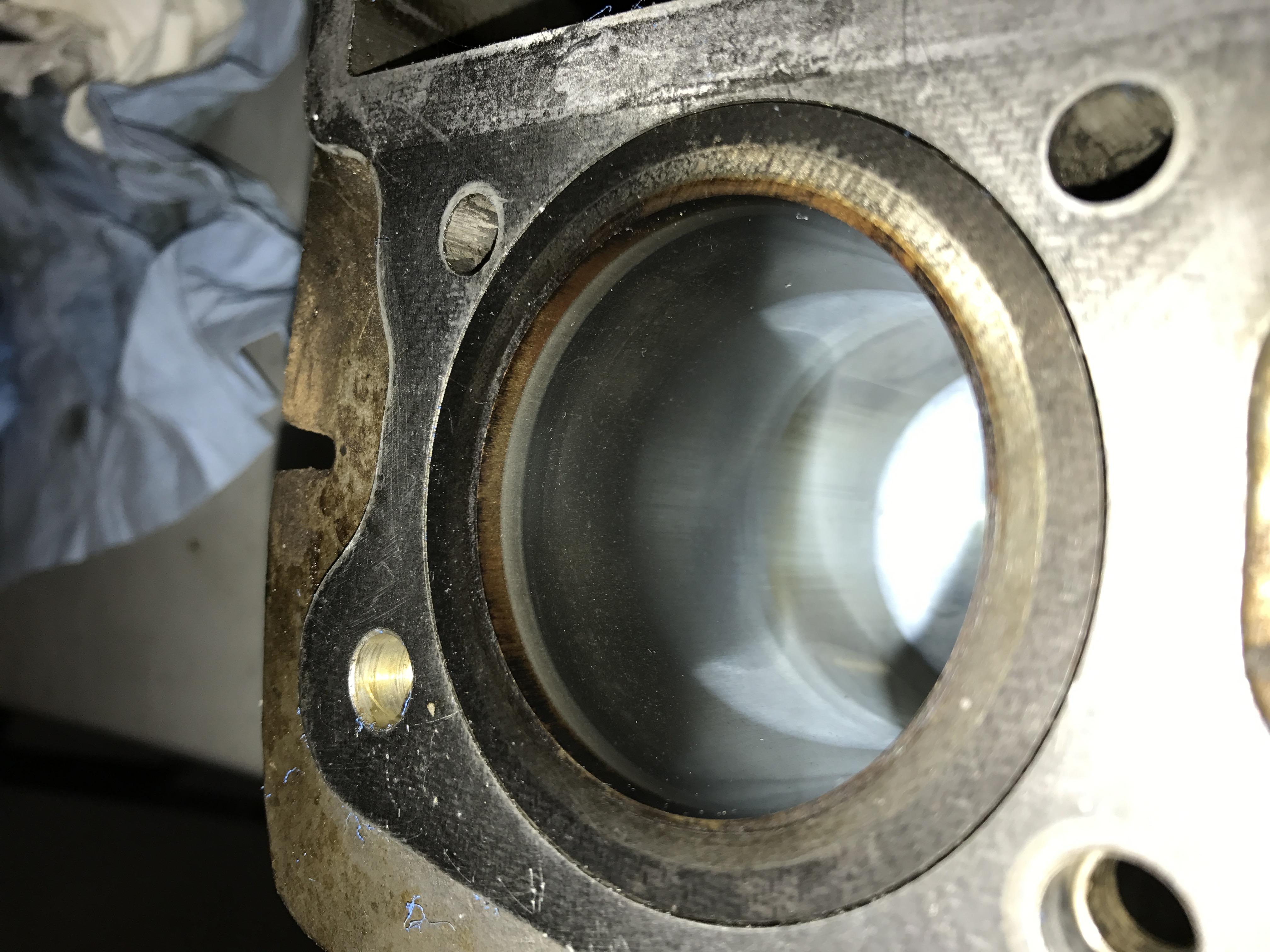

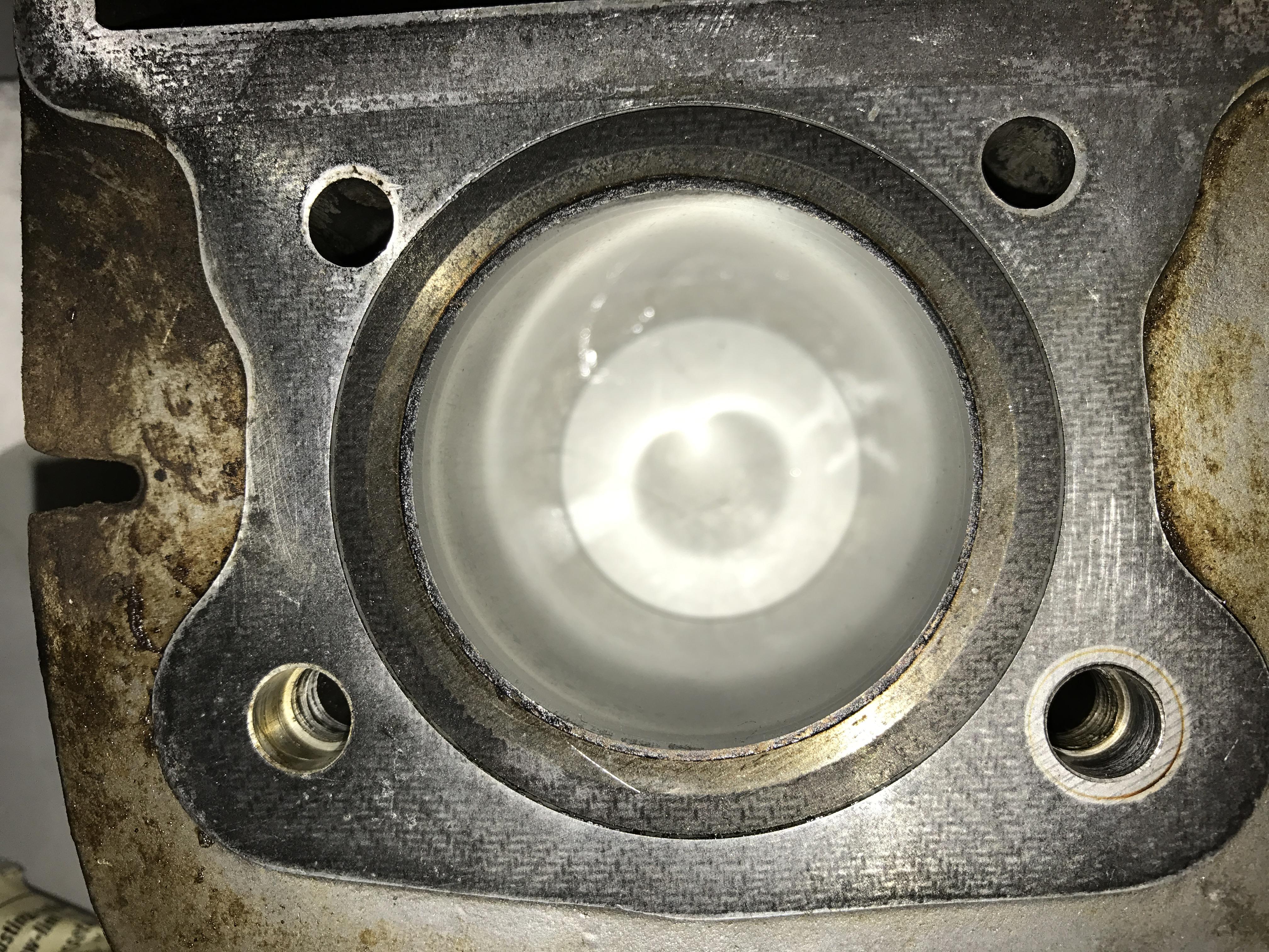

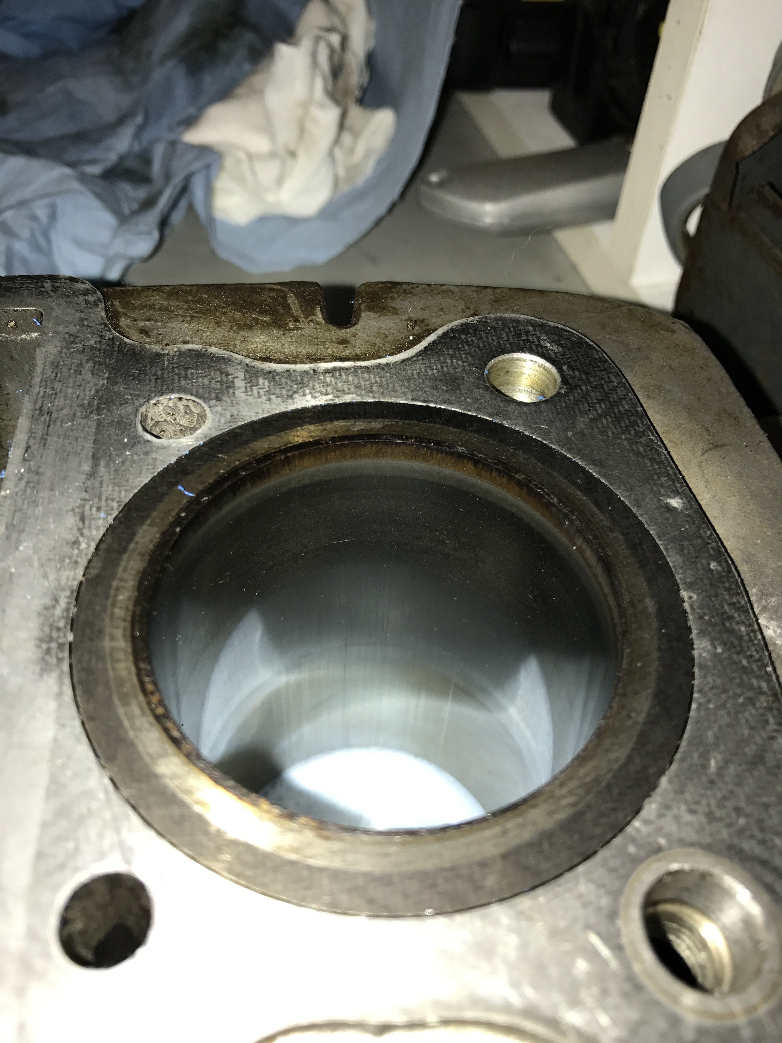

Pistons don't look too bad. Looks like the head gasket was sealing OK. Cannot see the bores in those pics.

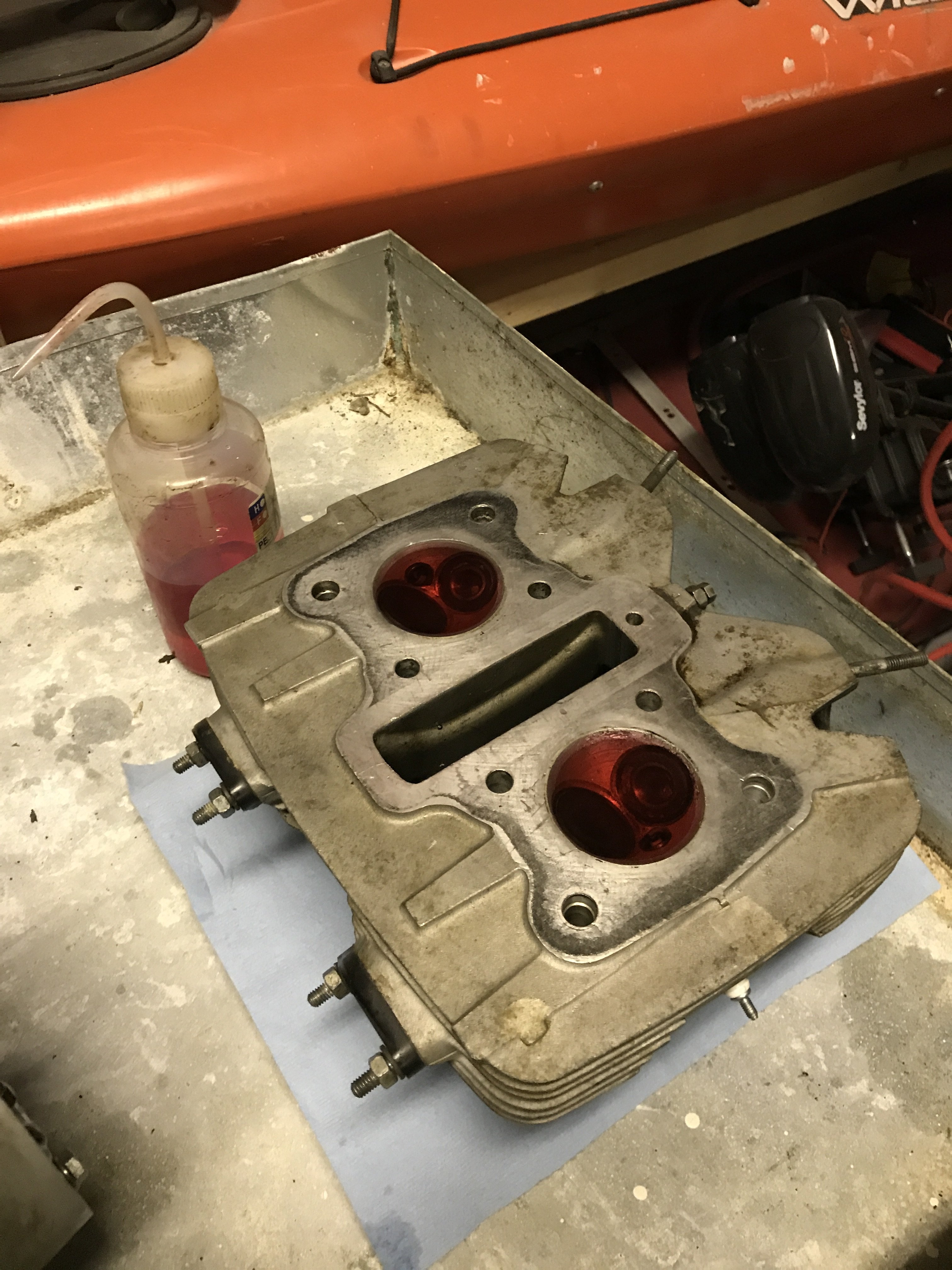

Let us know what you find when you leak test the head. Preferably before you strip the valves out. That way you will know it that was a problem.
Started my leak test this evening on the valves, look like the right hand cylinder drained about 5 mm already after just a few minutes. It appears to be coming from the intake valve. I checked to make sure the source of the leak was not the spark plug hole. Hmmm that was the cylinder with the higher compression. Next I will post some better photos of the bores.

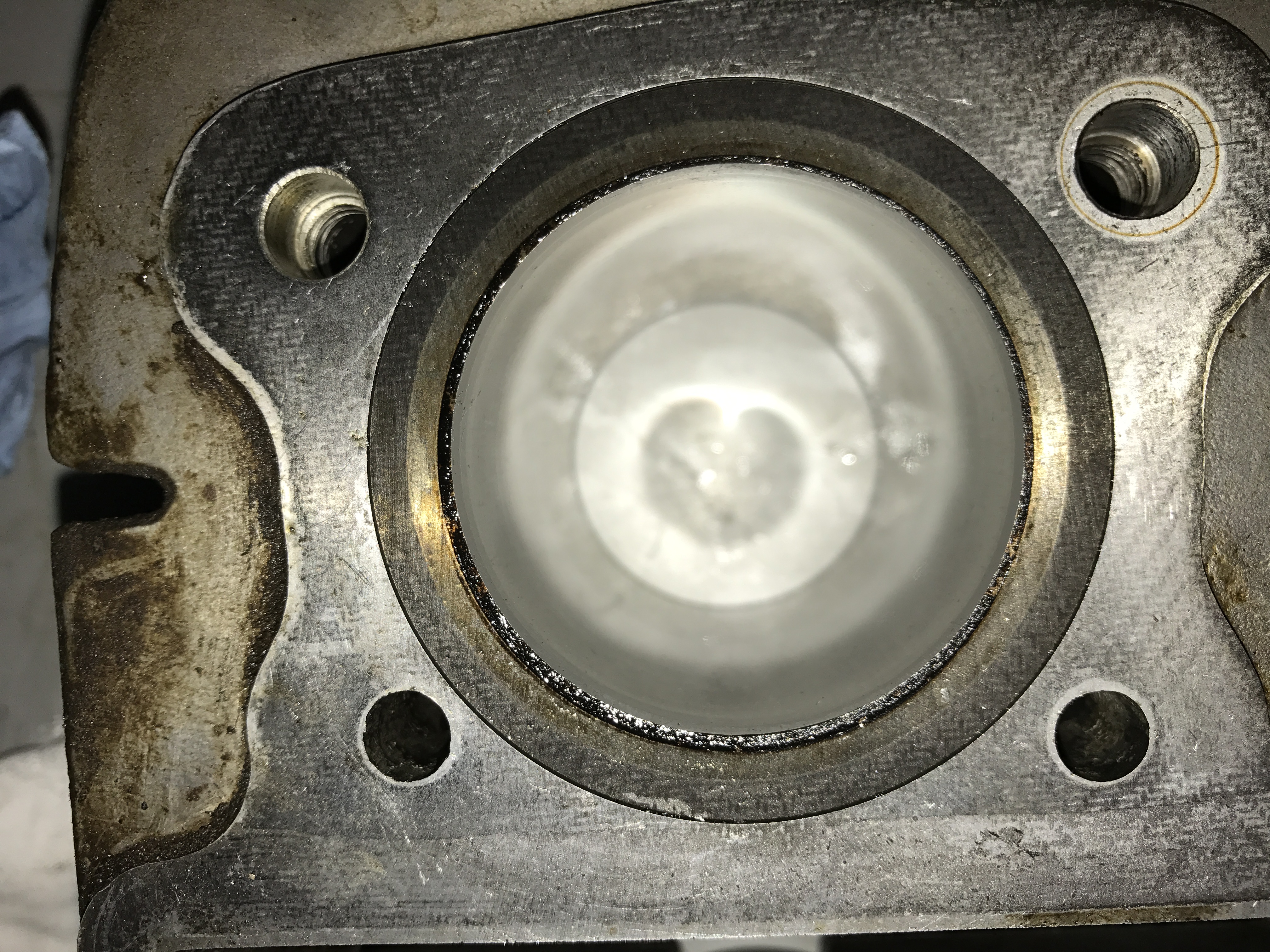

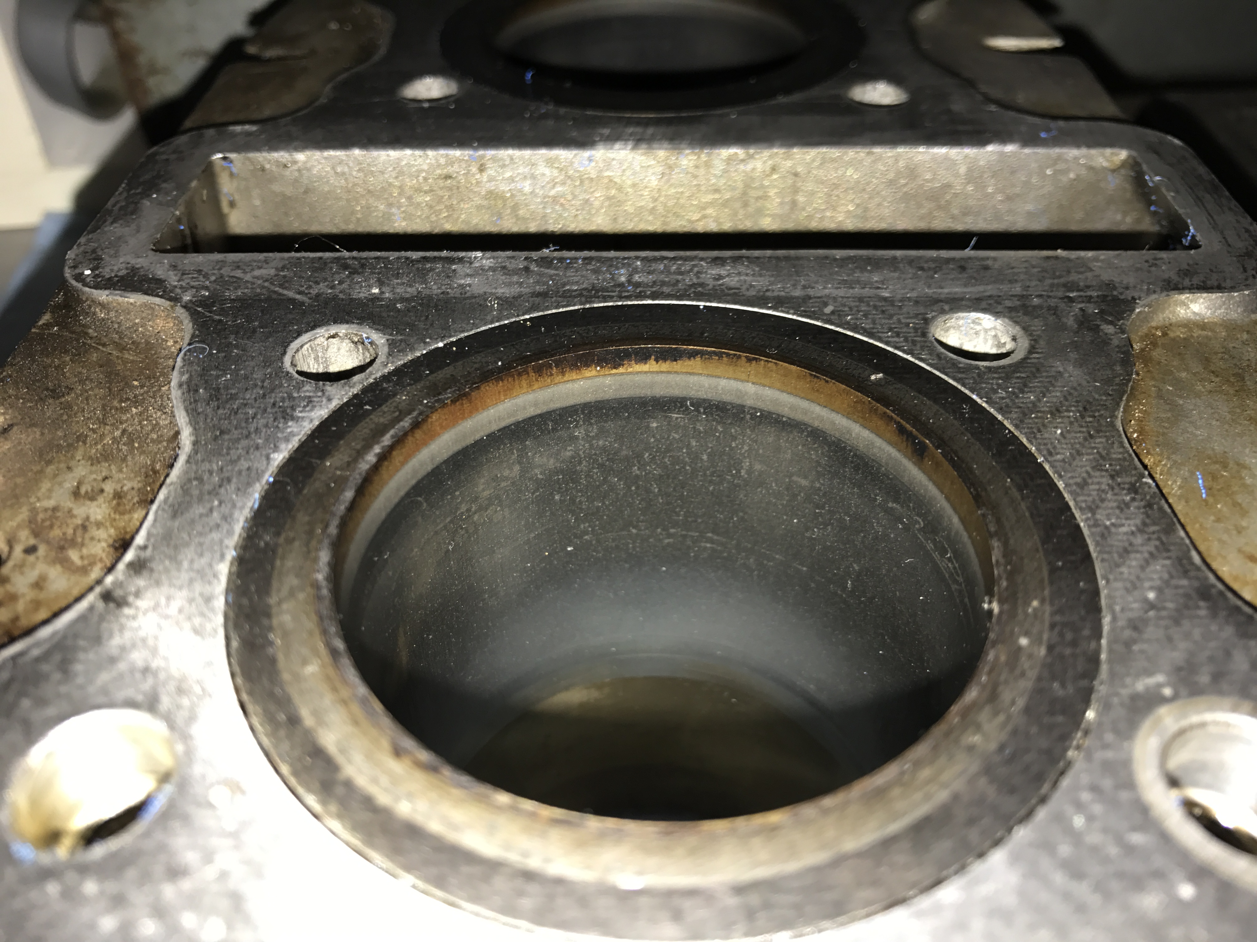

L cylinder

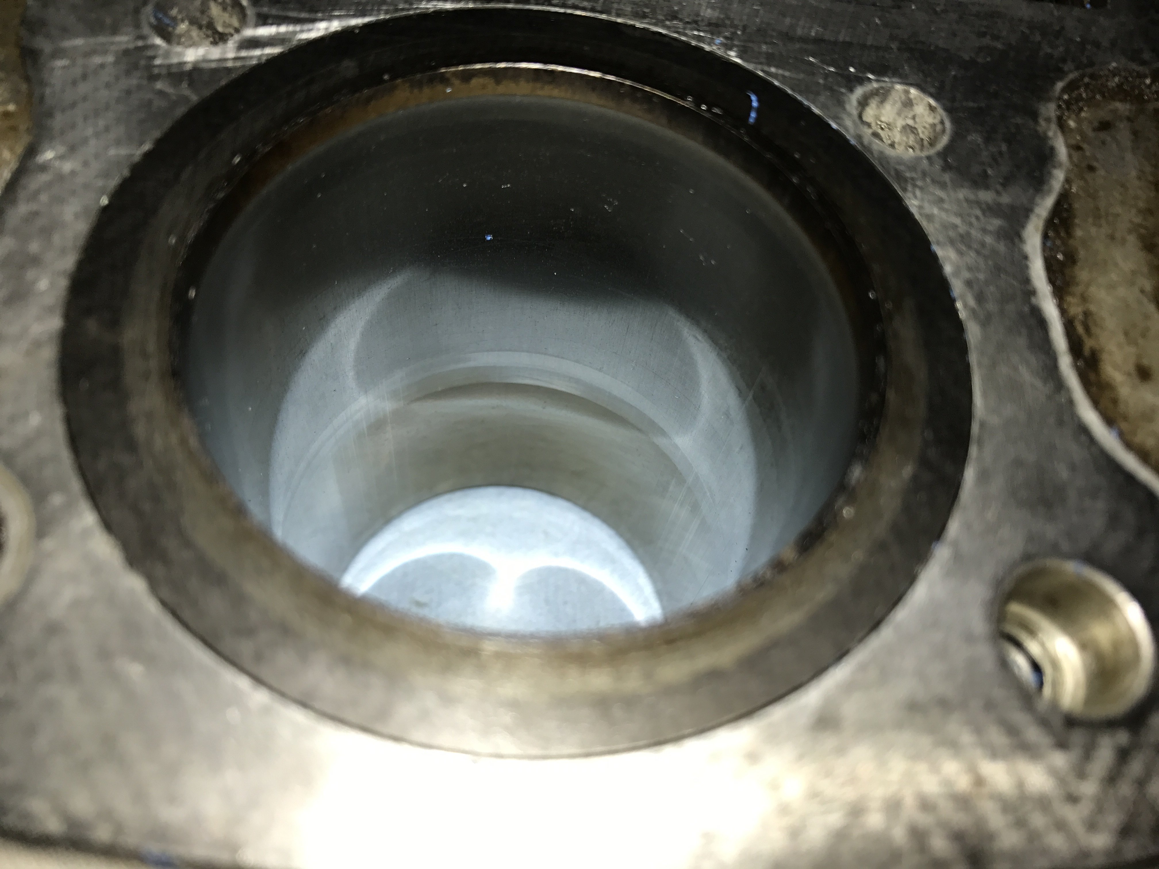

R cylinder

If the gas in the head didn't just pour out of the ports, it suggests that the real leak is past the piston rings.
The bores don't look bad. If you have the budget, I'd suggest new pistons and a rebore and if cash is really tight, glaze bust the bores and fit new rings and then do the head and button it back up. Pistons are not expensive but boring costs money. Someone here had a cheap recommendation not too long ago.
I was wondering how much it would cost to overbore it. Maybe I can call some local shops to see what they are charging. I am waiting for my new bore micrometer to arrive in the mail so I can calculate the out of round, taper, piston clearance, etc.
A local shop I called can do a 0.5 mm overbore for about $80. Thats not too bad, I would say its within the budget. Hopefully 0.5 mm over would be enough to clean up the bores pretty good?

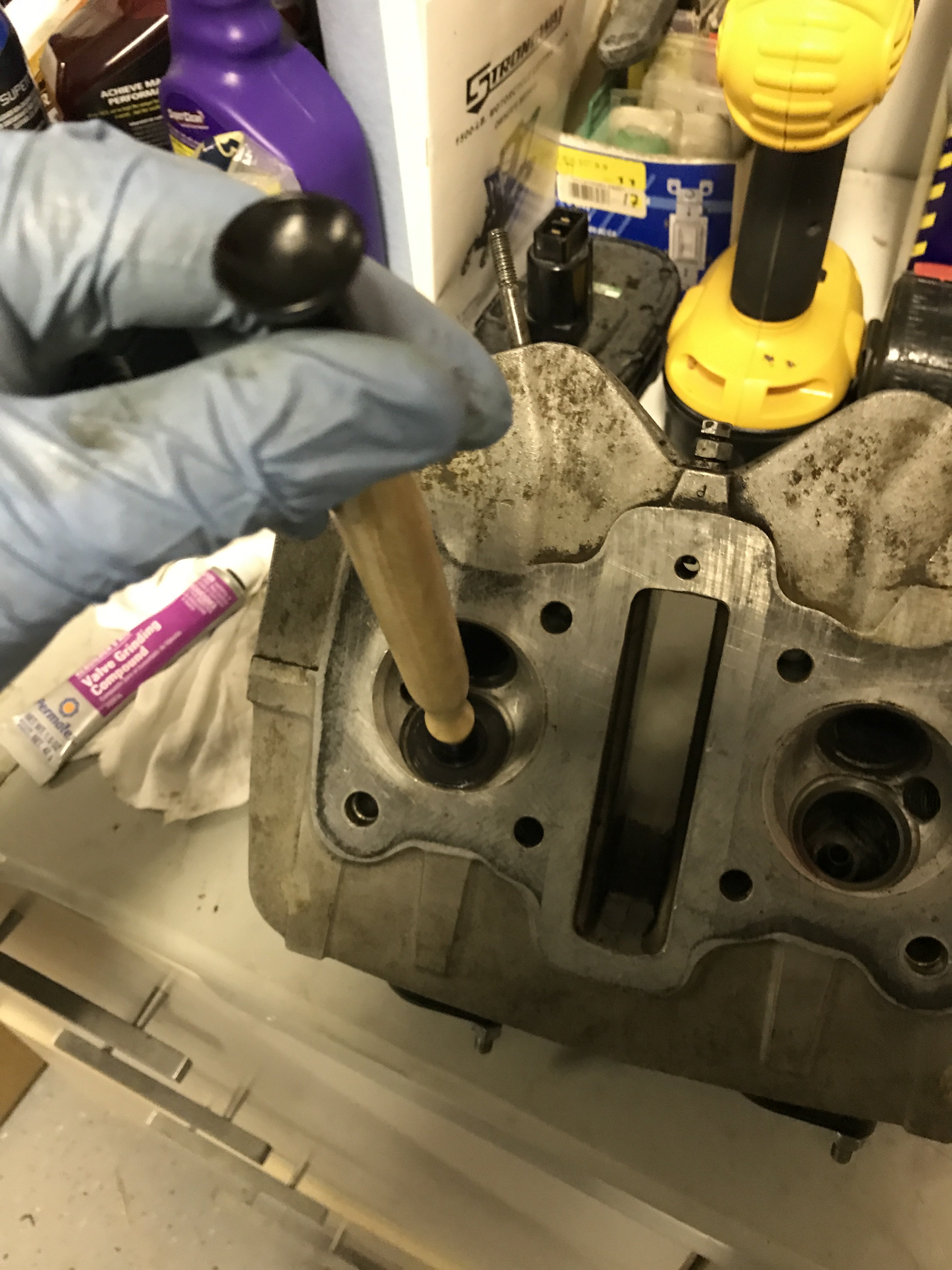

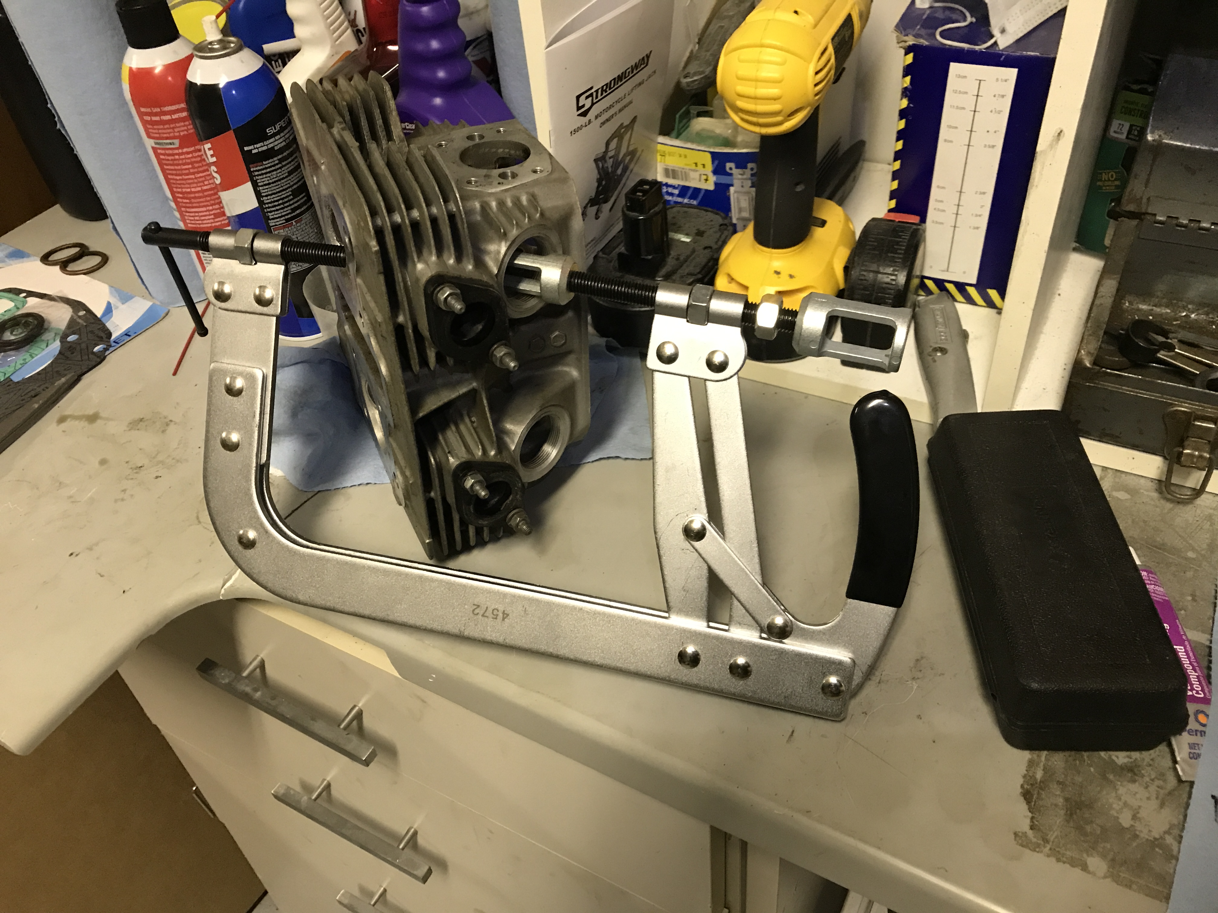

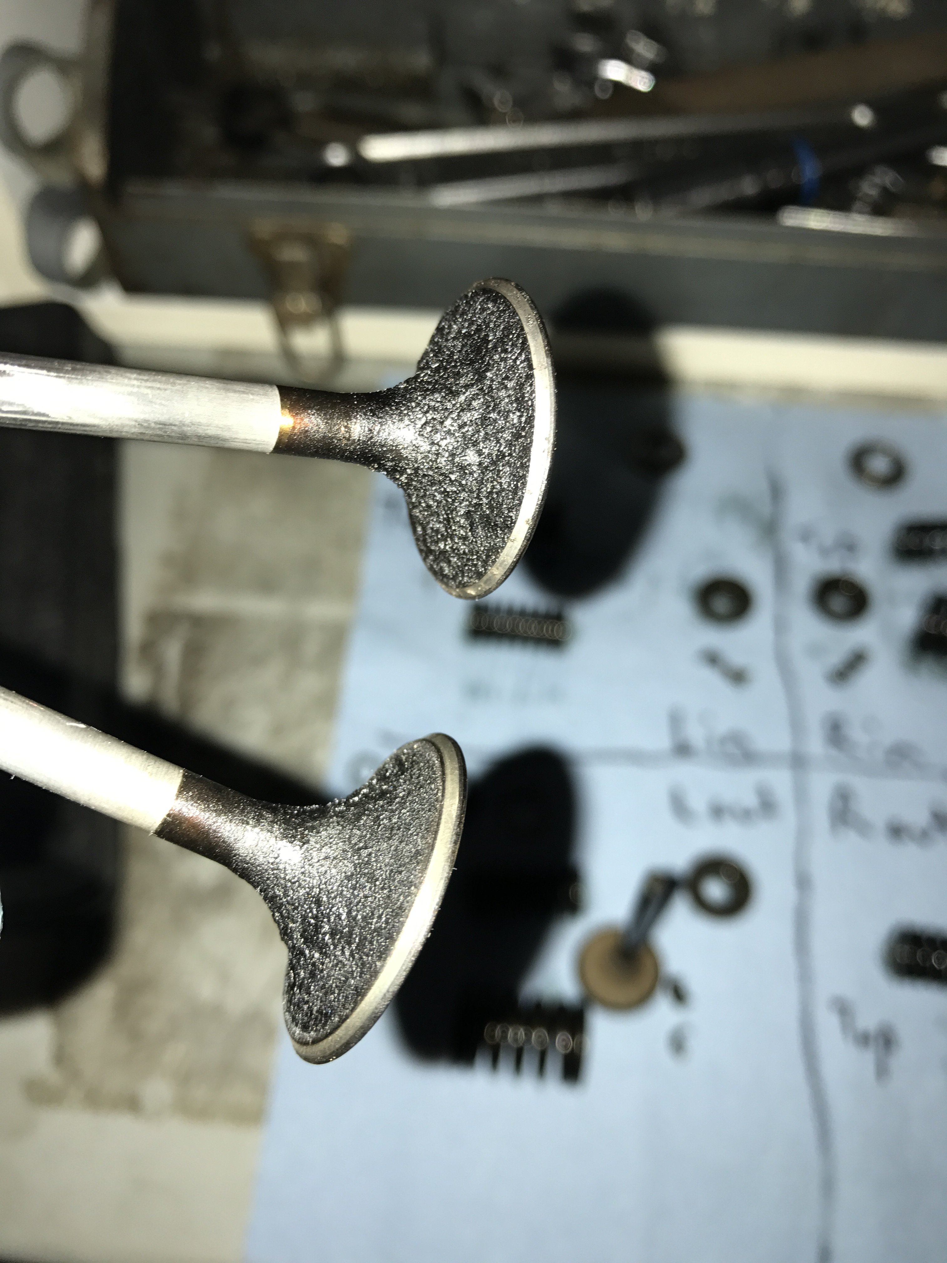

I did my valves this evening and I think it went well. The seats came nice and clean. I made sure to clean off all the grinding compound off (I don't need any liquid sandpaper eating up the valve guides or cylinders). It's not as easy as it looks to use the lapping tool. Kept having re stick the suction cup. And it would seem as you spin it you have to press hard enough to cause abrasion but too hard and the valve does not move. Anyways it was a learning experience as always. Next I was gonna wash the head out real good with soap and warm water - immediately dry and oil the steel valve guides, journals, etc. then reassemble the head and repeat the leak test. But first I was going to try to get some new valve stem seals. The only rubber parts that came out with the valves were on the exhaust side. Do the intake valves not have seals?
Valve work pics

Honda changed the seal design a few times. IIRC, CB160 had no seals. CL175 sloper had an O ring design on the exhausts. 175 uprights had a real seal but only on the exhausts and CB200 had proper seals on intake and exhaust.
So called upright motors are still inclined a little - 8 degrees I think, so oil tends to collect at the front of the motor. In general, intakes need seals because they are subject to low pressure that tends to pull oil down the valve stem. Exhausts by comparison are under higher pressure, so there's less tendency to suck oil. CB200 guides will work in a 175 head, but that's a lot more work than necessary if the guides are OK.
Ok I found the exploded diagram for the valves in the shop manual. Looks like only the exhaust valves are supposed to have seals. I have ordered 2 seals but cannot find the o-ring cushion that sits underneath it (#8 in diagram). Wonder if I can get away without it? The old ones are no good.

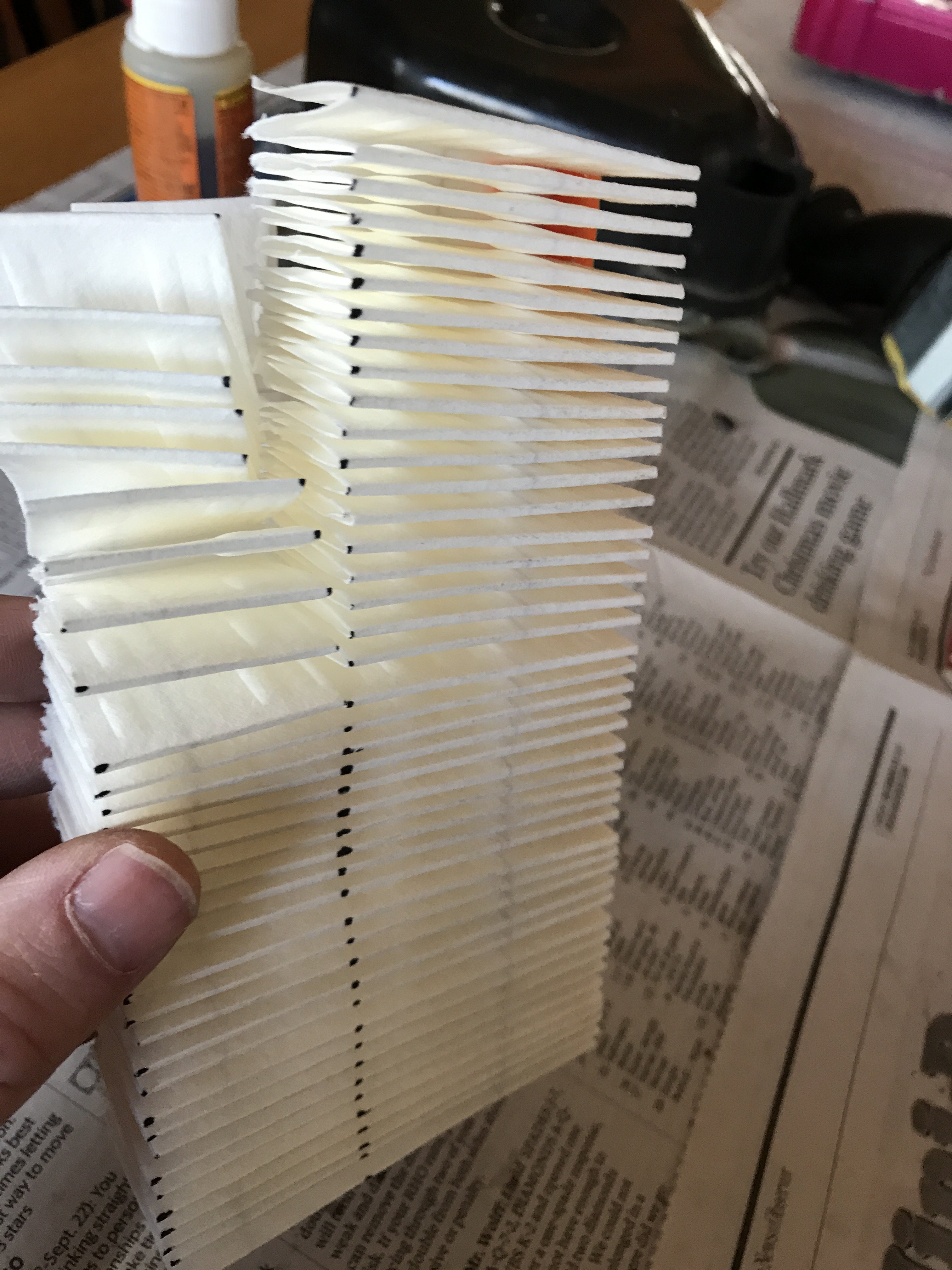

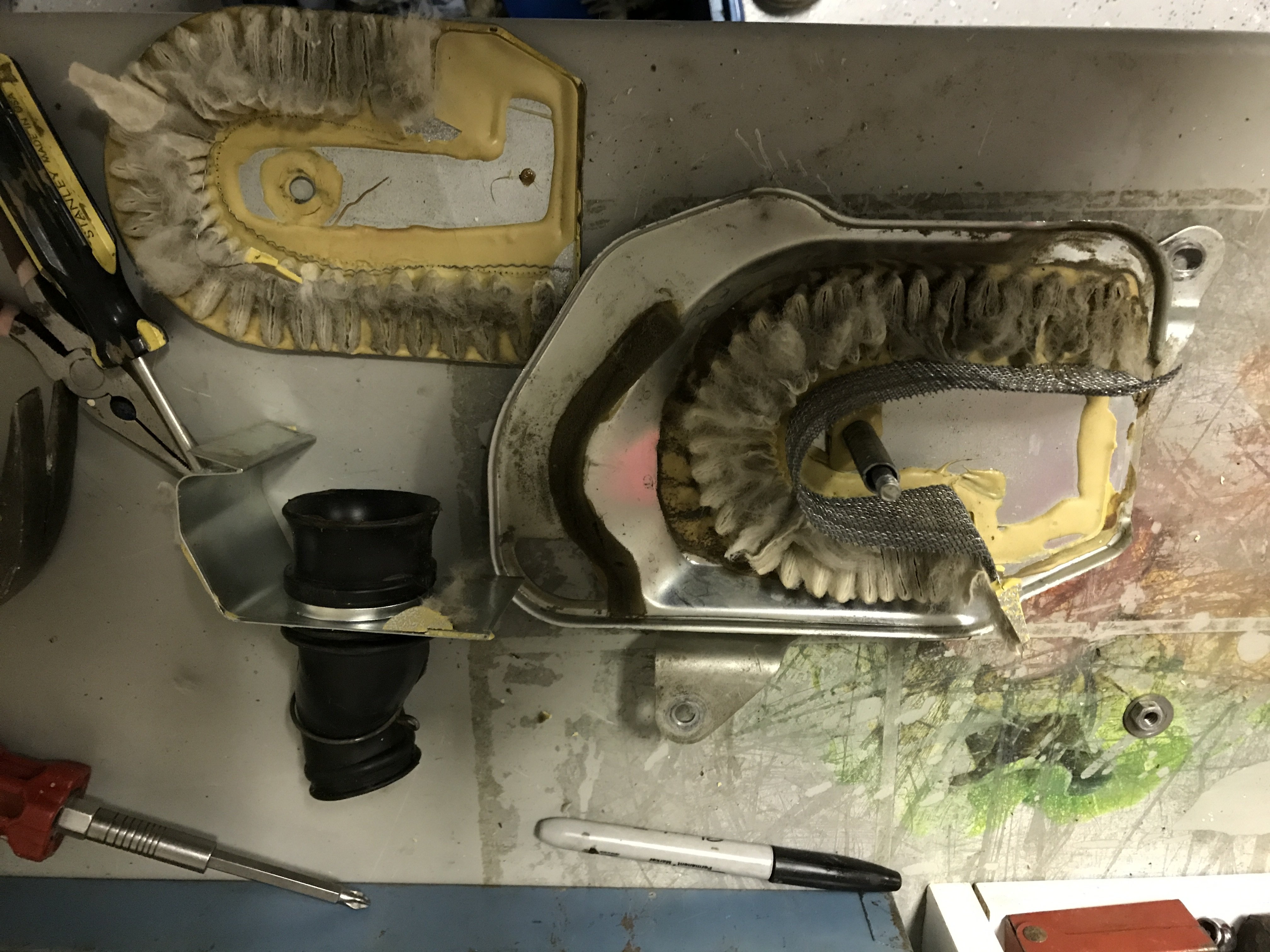

Lastly, I decided to rebuild the air filters. I cut out the old filter material as much as I could with a razor knife and burned out the remaining filter and glue after soaking in kerosene. It comes out real nice with a putty knife when it's hot. That was kind of fun actually. A Fram auto filter was located with the same size pleats and cut up for new filter paper. Finally glued it in with gorilla glue (it expands to fill all the little gaps). Not a bad result for $15.
Air filter rebuild pics

More air filter rebuild pics
