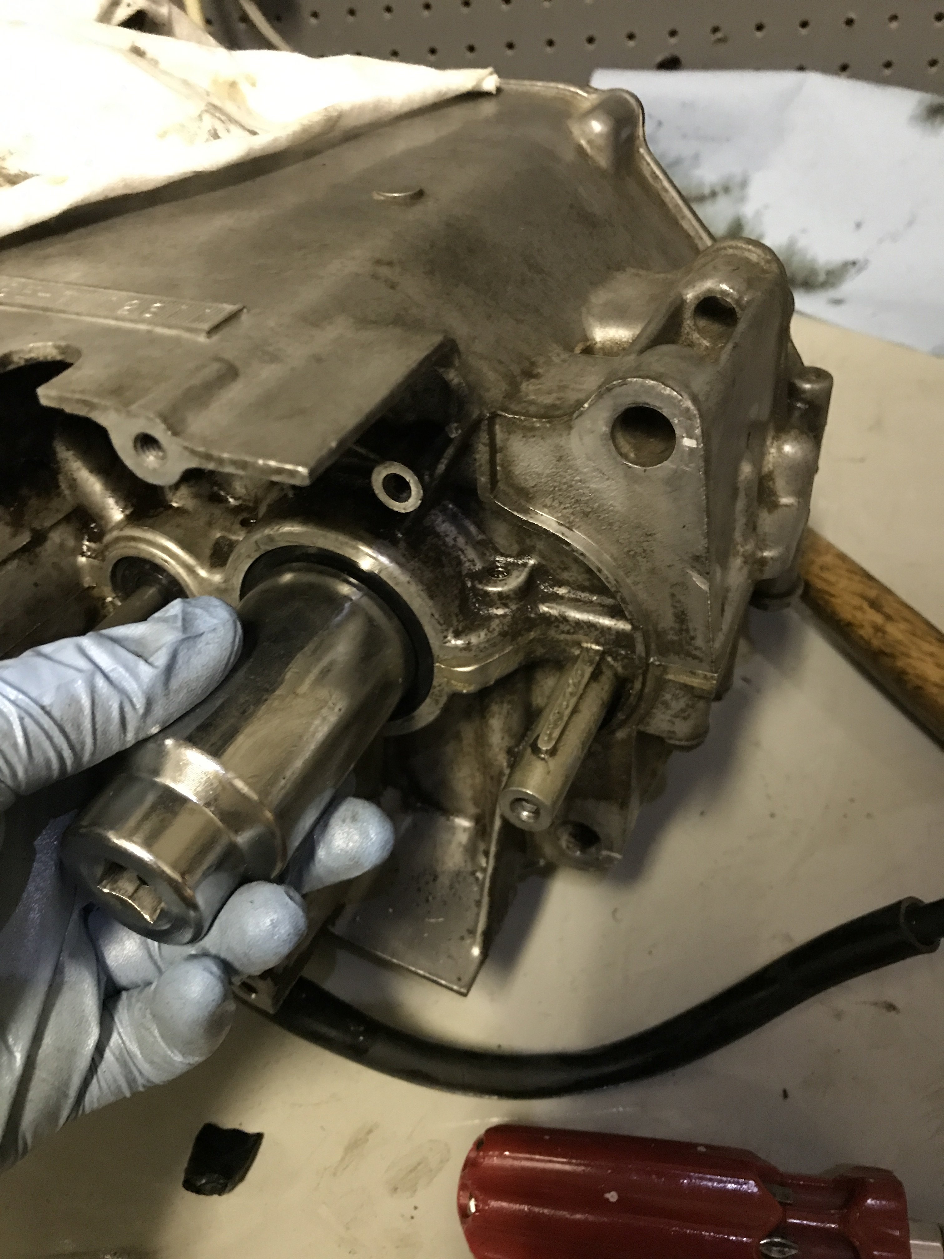

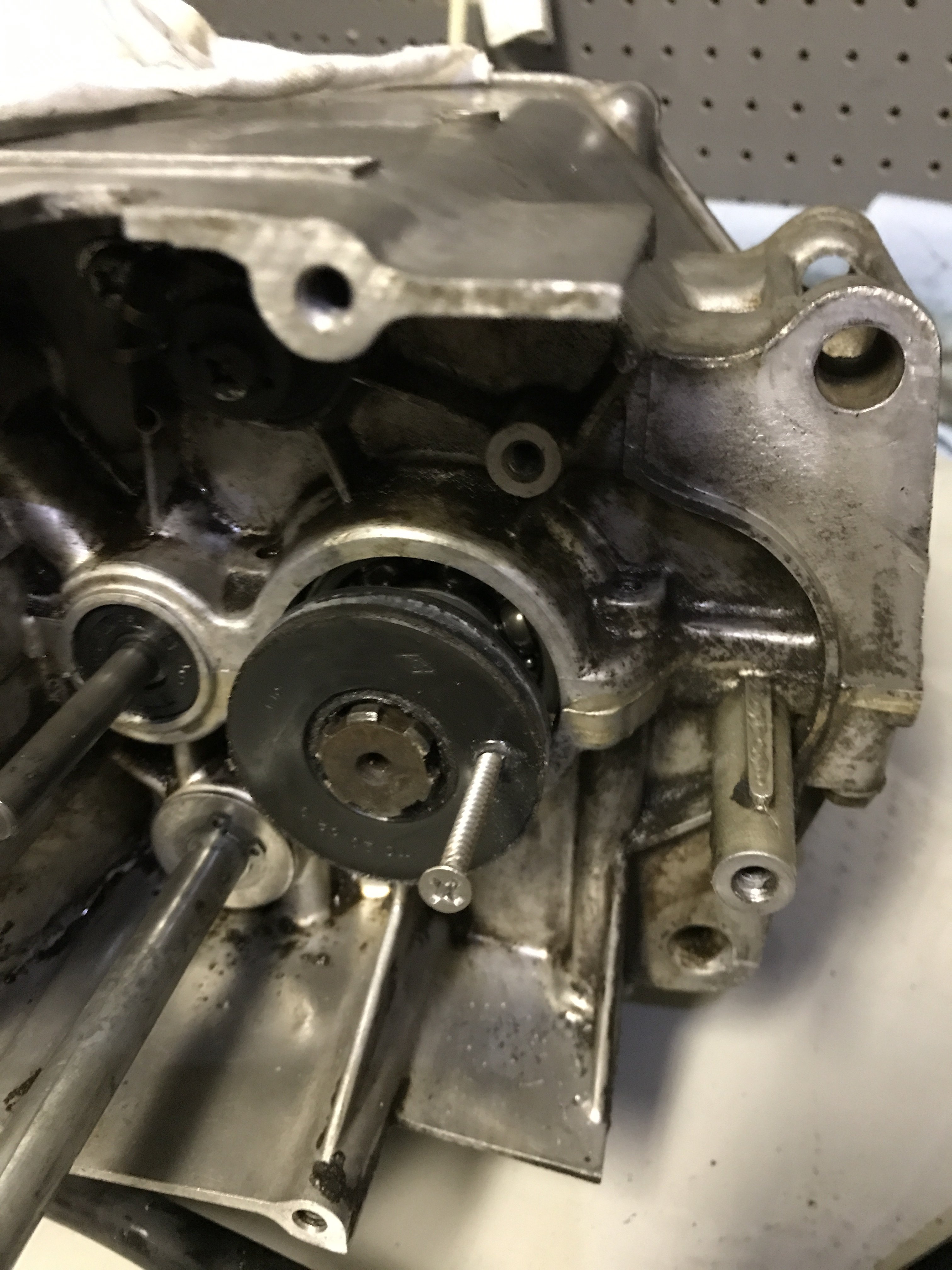

While waiting for the pistons to come I pulled the side covers off the cases and replaced the oil seals and gaskets. For each seal I drilled a tiny hole in the side and put a wood screw in just slightly, making sure of course not to go too far in or go anywhere near the seal interface. Then I could pull on the screw and pull it out. The big drive seal was intimidating and I was worried I was not going to be able to pull it but it turned out to be the easiest one! Just put a pry bar on the head of the screw and leveraged against the end of the shaft. I drove in the seals with a socket a bit smaller in diameter than the seal. The old seals were flush with the surface of the case but the new ones I drove in slightly beyond flush. Should they be driven in until they bottom out?

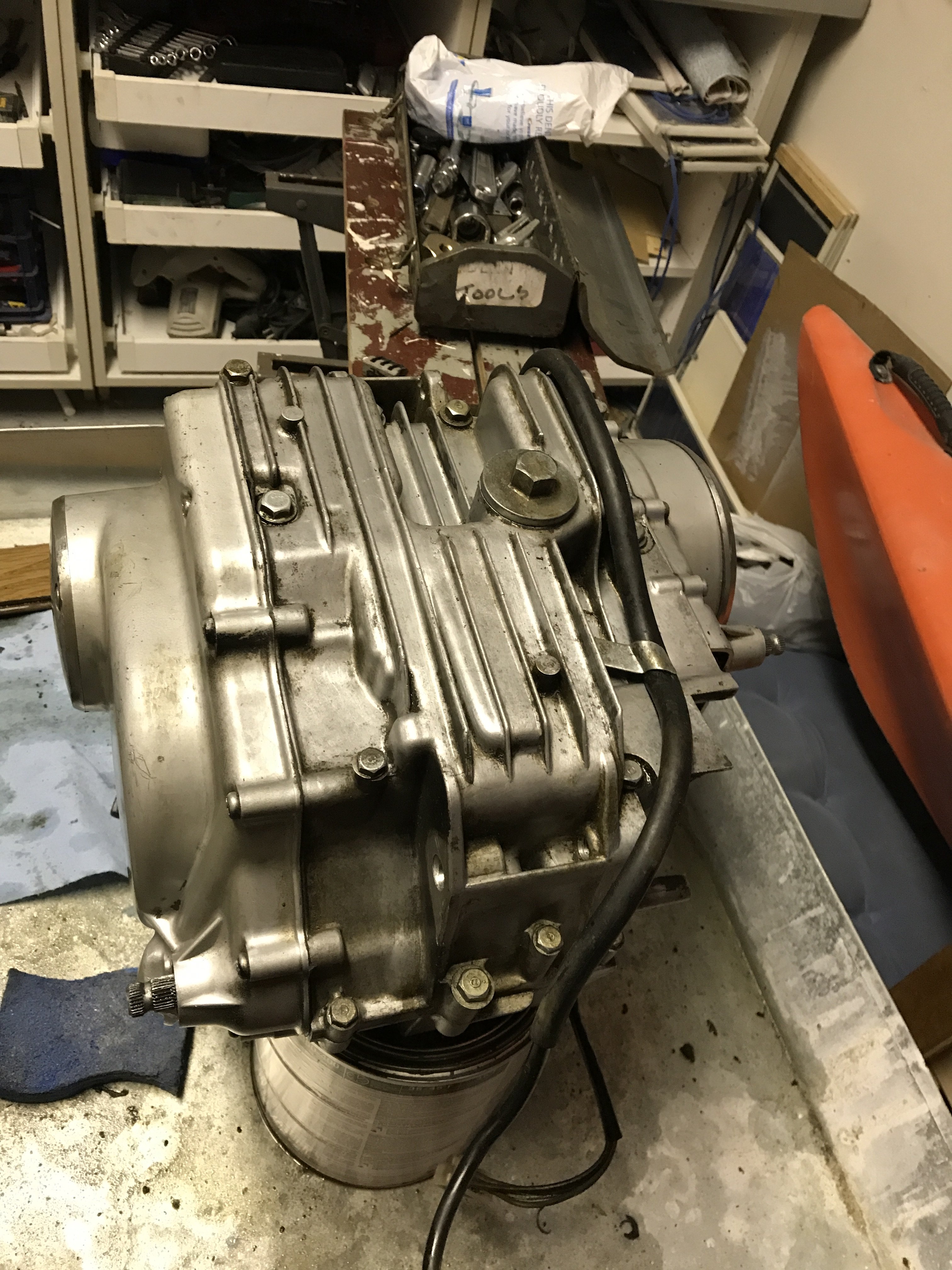

I flipped the motor upside down and rested the case on a paint can to do some cleaning. Nothing fancy but it kept the stress off the studs. The whole underside had the brown grime coating. Got the majority of it off and it's looking much better. Not as good maybe as you guys with your solvent tanks and yer media blasters (I'm working my way up to that, right now it's all elbow grease). ::)
