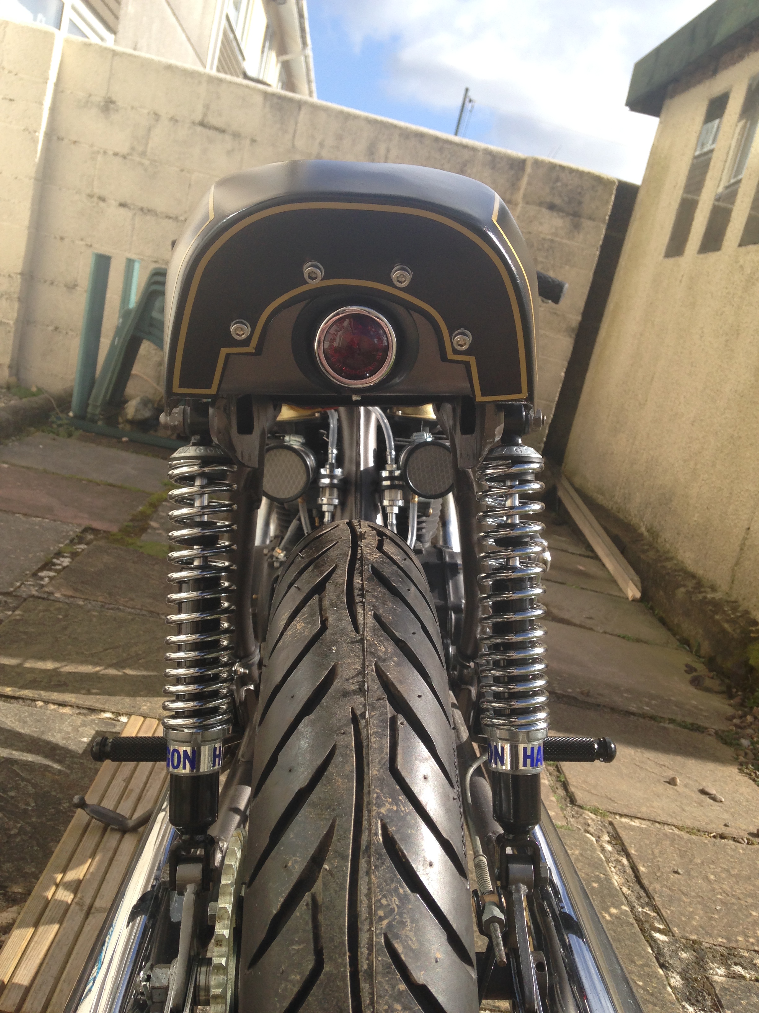

Soon I'll get that motor out and check the entire bottom end out. But in the meantime, whilst I was sat in the garage I noticed the rear had gotten a lot softer recently somehow, so I dropped the bomb on these! :D
Certainly are. Really itching to get this done and dusted now, but I there's still just a few things to sort out. They look frigging awesome on the back though!
